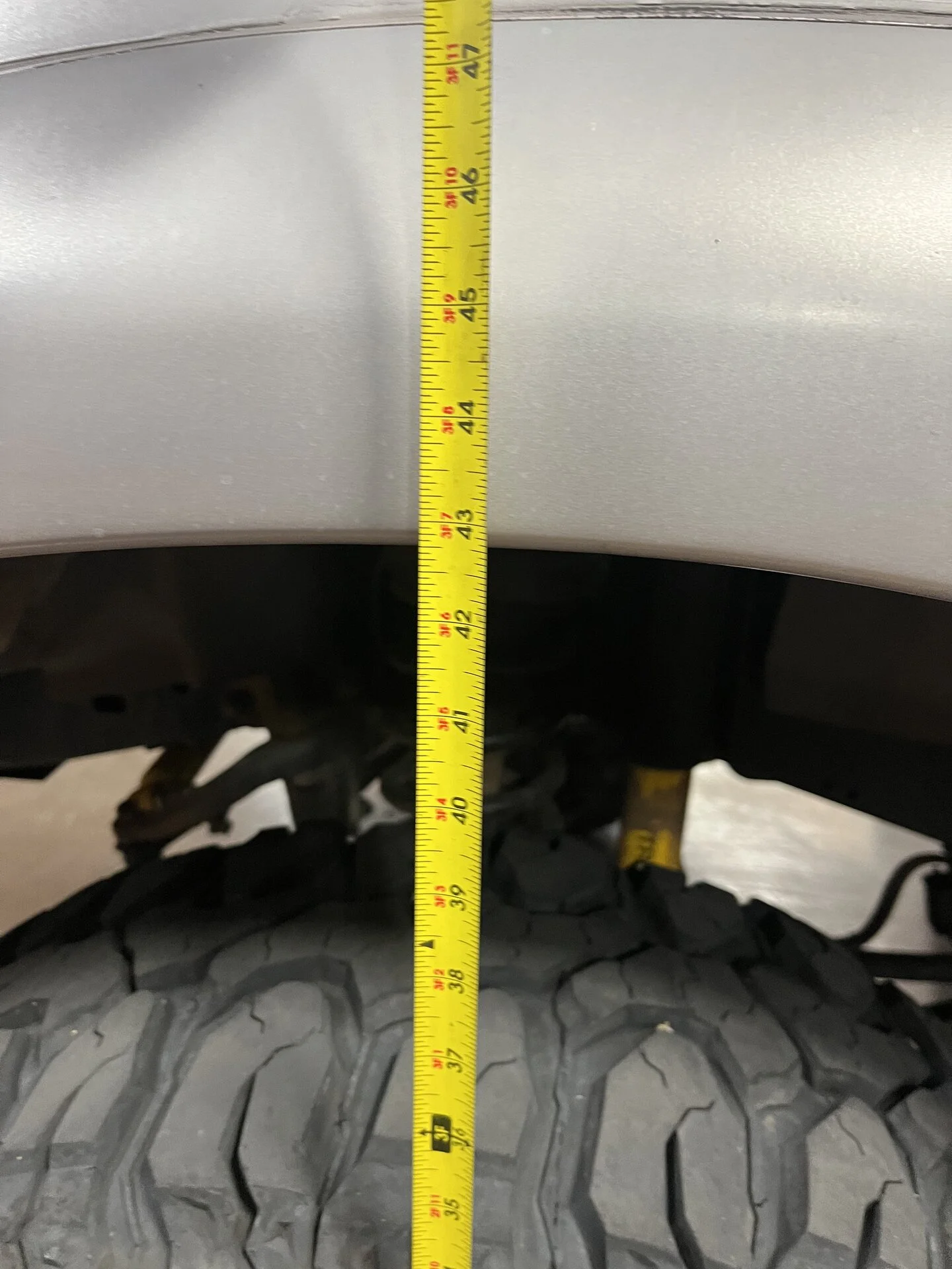

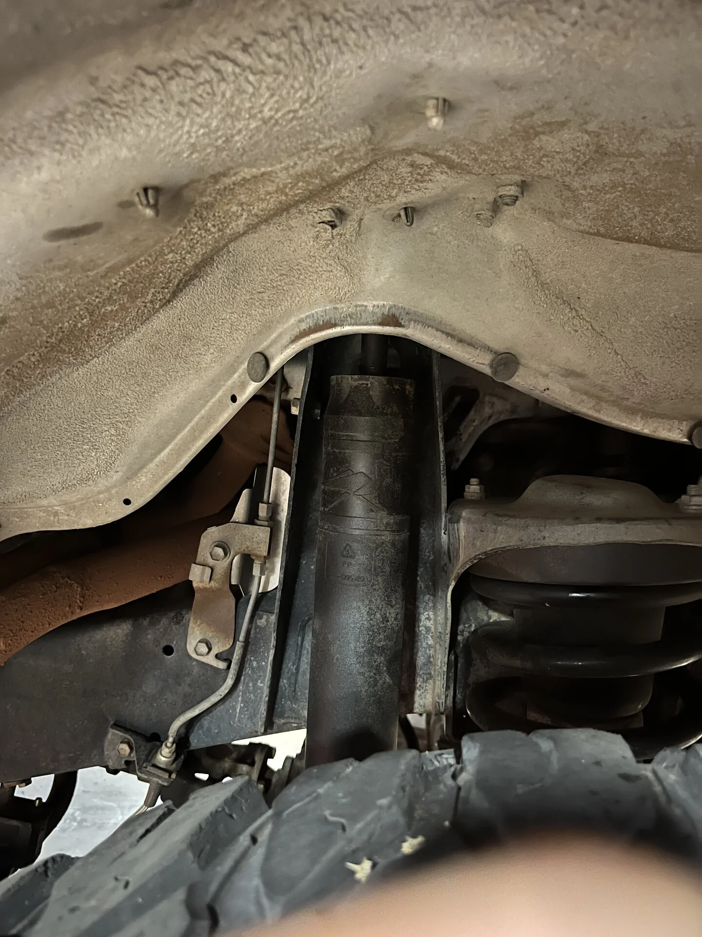

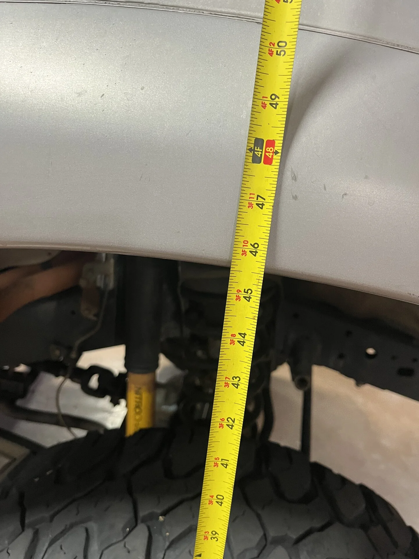

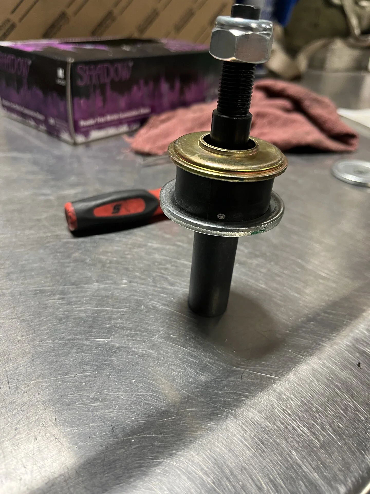

Ended up just trying some shock extenders. Got almost 3” of extra droop. “Not flexed”. Doing broken arrow sat. See how it works.
This works great!! Btw. Thinking of adding a pair to the rear now. According to the dirt line on the shaft with stock bumps I still have 1” of shaft left. So they aren’t bottoming out either
Another vote against DT shocks. They were fine on my long armed WJ, but way under-gunned on my 80 series. OME are a relatively durable budget shock… but loaded down in a family rig, they should do fine.
The extenders are probably a good temp fix for you. I used them on a Tundra for a month, but would be wary of them long term ( more points of potential failure). Good luck!
