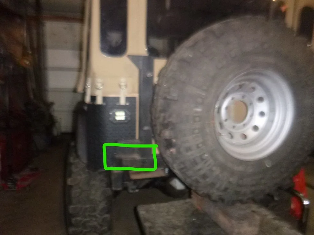

time for the spare.... in some of the things I do, we're required to haul a full sized spare.... I don't agree but I like doing that - so time to make one that doesn't rattle
These are cool, but I don't think I'll use them... or maybe...
finally something the warn winch can lift
the only issue is my tow points are higher than the spare... I could use the hitch, but that isn't there for recovery.
it's really not as low as it seems from the back.... still, If I carry a spare, it will be smaller. I have patch kits, tube, welding wire and dowels to fix a flattened tire - if I need to use a spare, I can put it on the front and unlock the hub (or pull a shaft on the rear)
