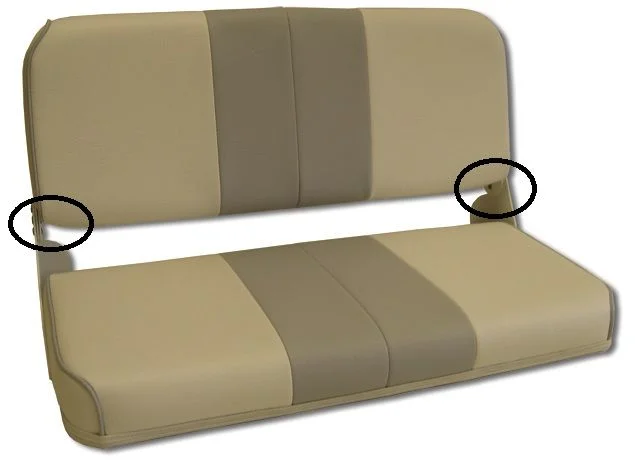

What are your ideas for the actual seating surface? Are you planning for metal seat surfaces, webbing, cushions? Should the seat back pivot bracket be taller to account for your seat surface choice?
I gave up on rear seats in mine, too hard to get in and out of the back.
metal backing, wire springs under the seat, metal back, foam, high density foam bottom (2 kinds), then some kind of canvas covering...
yep, similar to that.... hmm, that gives me fabric ideas...
