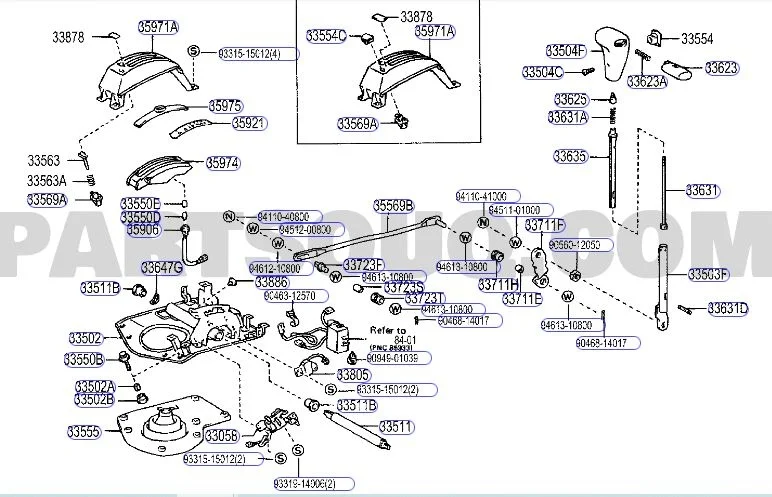

The shift linkage on a FZJ80 with the A343F transmission is a solid rod running from the shift lever assembly down to the transmission. The parts diagram shows the rod (35569B) as being horizontal, but it dives forward and down from the underside of the shifter assembly plate to the right side of the transmission.
Has the transmission ever been out of the vehicle?
