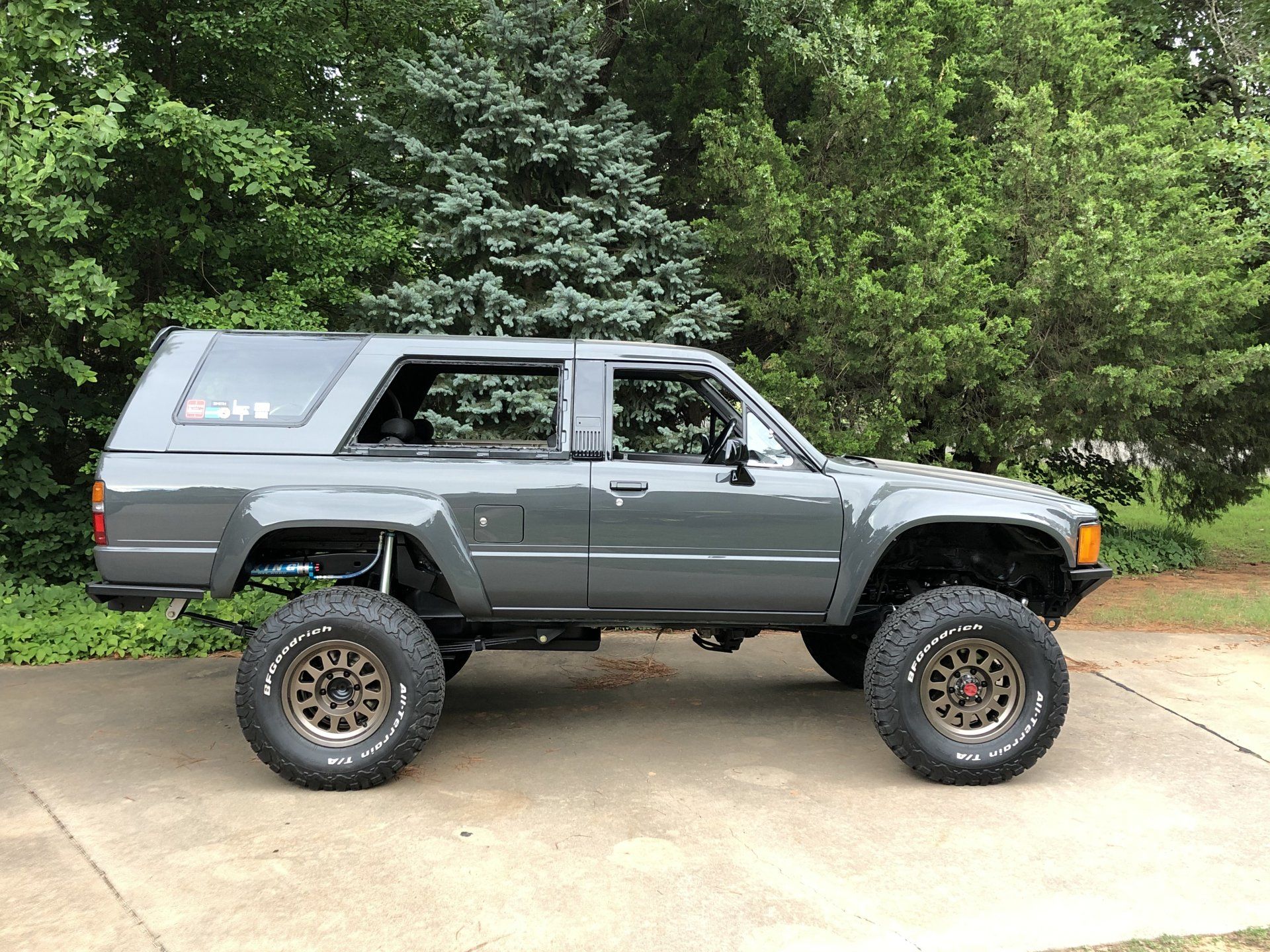

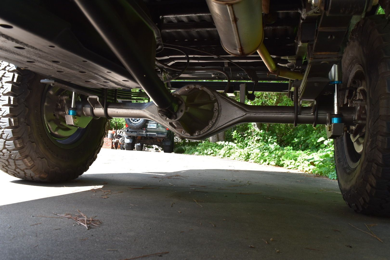

Finally out of the garage. Brand new CV axles have some wiggle so may have an issue with both of them which seems unlikely or something with the front diff. It also looks like I’m going to have to cut every mount off the rear axle, raise the pinion big time and have a custom and extended double Cardan driveshaft made to fix the vibes I got and the very little engagement I had on the slipjoint.
That looks really sharp!!
Got any plans for unique side windows? I've been thinking of doing something because those parts are starting to fail on mine. There's a guy who makes one piece, opening side windows for FJ80's (similar to the "win-doors" on some truck bed shells) but he didn't respond to a request that he look at doing the same for these trucks.

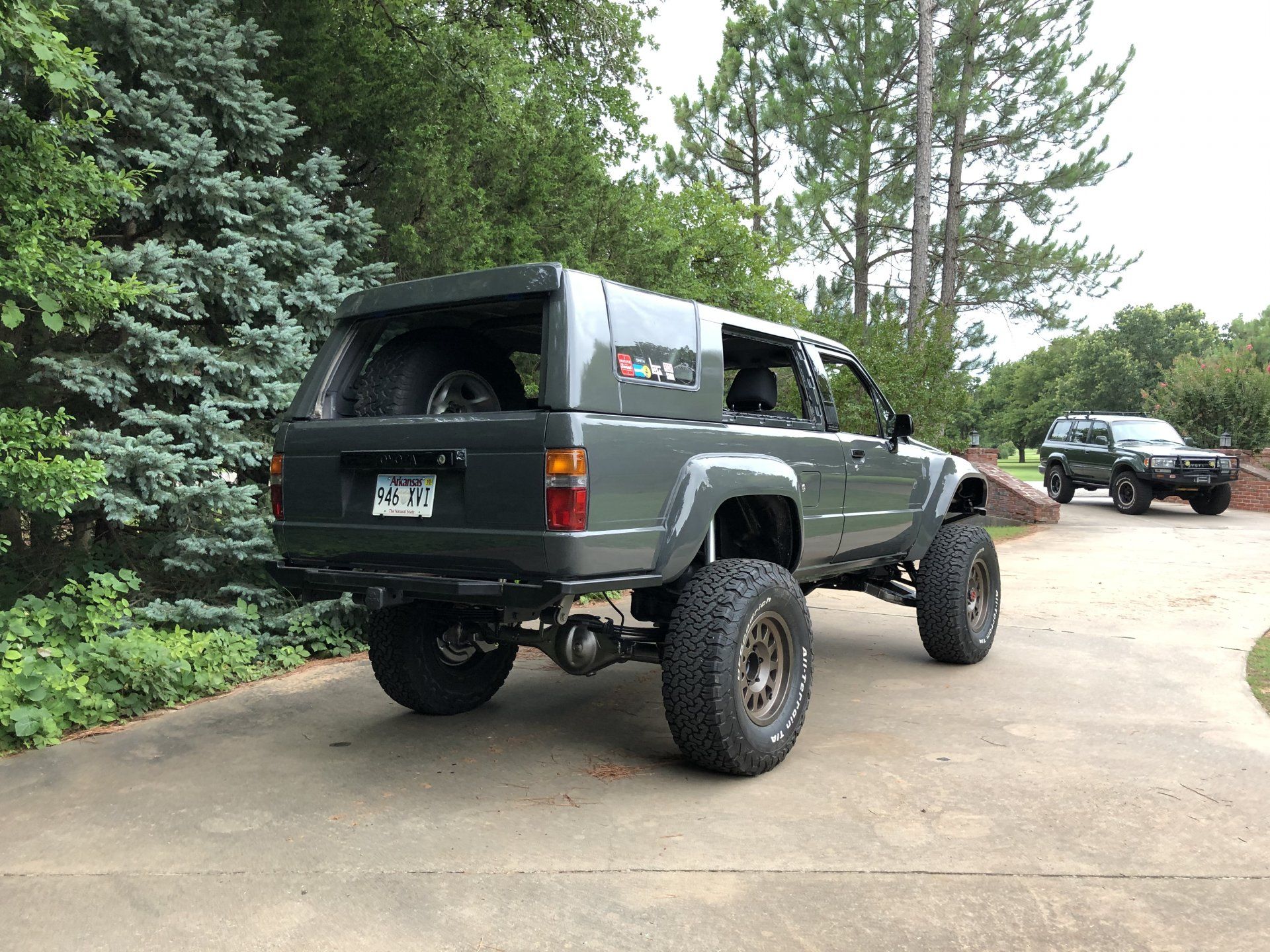

Thanks...I would like to do some flip up gull wing windows there and I’ll probably play around with designing some down the road if I don’t just design a new top, but it’s not something I have time for right now. I’m actually moving tomorrow and with this thing not running, I’ll have a 5 hour one way trip to get back to work on it on weekends. For now, the crappy slider windows will go back in with gloss black L trim pieces.
Well since moving to KC for work at the beginning of July, I’ve been commuting back on the weekends to wrap up the build. The gasketed windshield has been a huge PITA with sanding one down until it cracked and then getting the next one in 99% of the way before it cracked. Third time will definitely be the charm and I’ll video it/write up a detailed guide for those in the same boat as myself. Anyways, ceramic coating, paint protection film, window tint, rear bumpstops, and reinstalling the dash and it will be done for the time being! About 1300 hours of labor all said and done with most of that since March.
@SUMMIT CRUISERS Jr that looks incredible! Well done. More pics!!!
Thanks! I just snagged these pics real quick before leaving town but once I wrap up those last things, I’ll be sure to take some more before it gets driven in the elements and wheeled
Oh no! You can't wheel that! It has to live in a climate controlled garage and only be driven on clear days, for parades and such.
Haha looking underneath at everything being so clean and nice had me cursing myself for making it too nice. It was supposed to be a weekend warrior replacement to keep wear and tear off my cruiser. Anyways, it’s super fun and has already skated across some chunky gravel corners and down some washboard and rutted roads at speeds I’d never drive my cruiser on and barely flinched. Too fun to not use at this point granted I’m not trying to destroy it.
