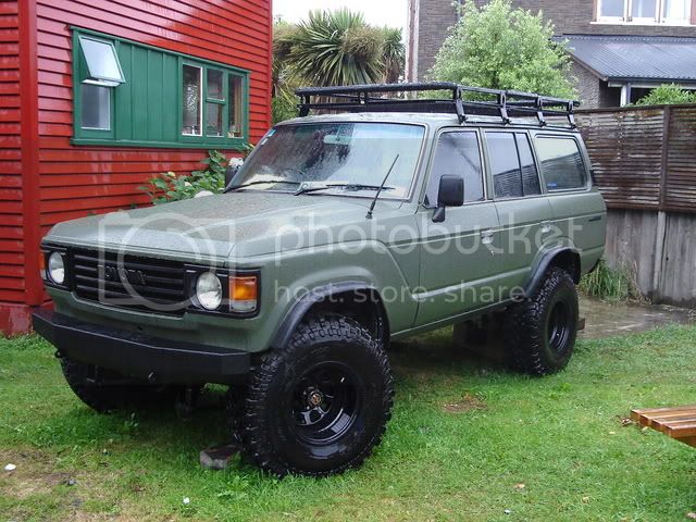

And, in case there is ANYONE left who thinks I might be reasonably sane... I am thinking that the side and rear middle panel, the one that usually has the disco stripes, (like photo 2). I am thinking of spraying some paint through some expanded metal mesh to create a snake skin effect. Ideally it would be Gator skin, but there's no easy and cheap way to create that (see last pic). Totally nuts?

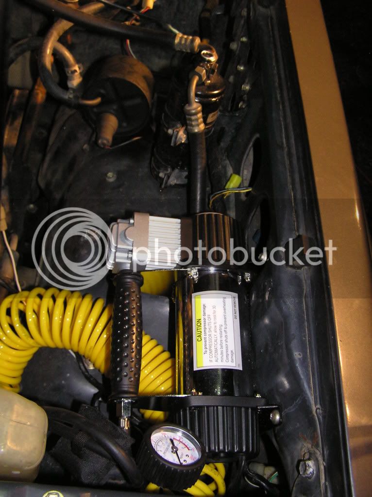

I removed the diamond plate base, mounted it sideways to the inner fender, and ran the power cable under the top of the core support. It has battery cable clamps, which are disconnected until needed. This air hose easily reaches all four tires and tucks nicely and securely under the unit and out of the way.
