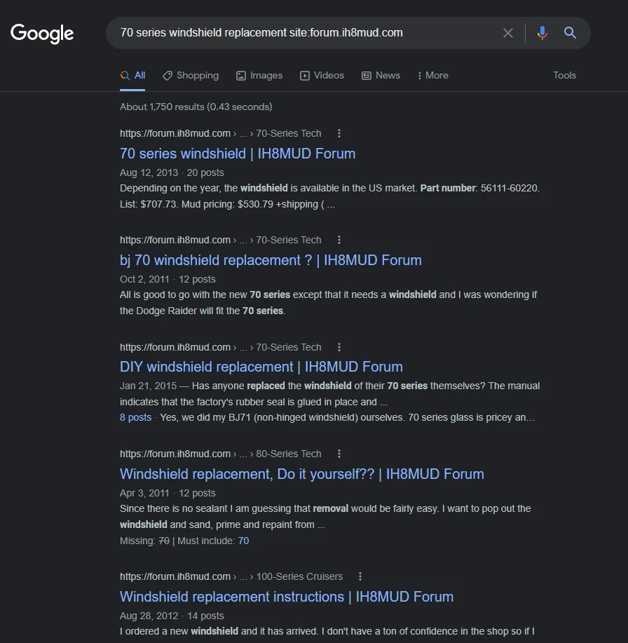

If you type (whatever your search term) site:forum.ih8mud.com It will only return results from ih8mud. Which is better than the built in search function on here.
Example: 70 series windshield replacement site:forum.ih8mud.com
