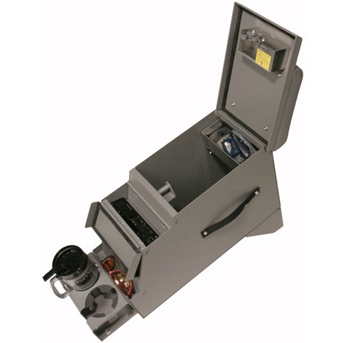

The ham will now be a Kenwood with a front firing speaker mounted in the stereo cubby in my Tuffy center console (the bottom is open and the top will be open during use so it should get enough ventilation - if not I'll be adding a 12v fan (from a computer).
For the CB I think I have decided to switch from a standard box and mic unit to a Midland Handheld CB that will be clipped to a mic holder on the dash during use. This way I avoid the speaker issue altogether and when not in use everything can be stowed away from thieving eyes.

Can you post up a few pictures of this center console? I have been thinking about this mod and doing it to the LX. Same setup of going with the ham in this console and either getting rid of the CB or going to a hand held for trail communications.
Did you do the install yourself? How many :banana: job did you think it was?
Thanks,
Pack Mule
It is the "stereo" Tuffy console
In the FJ60 it is pretty easy to install... easier if you pull out the seat(s) first. Be sure to know where the console should sit in the space between the parking brake and the passenger set before you bolt it down... leave room for you to get your hand around the parking brake lever. There MAY be brackets specifically for installing this in a 60... I made my own.

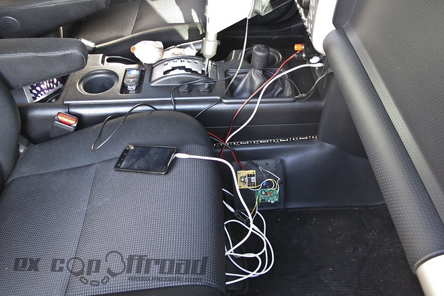

Guys, I have an audio mixer in the works that I hope to have available in a month or so. I have the prototype circuit cards on order. This will allow mixing of CB, ham, etc and stereo inputs to the aux jack of the car stereo. It converts the mono from CB/ham to a stereo output. I have a thread running on it on the blue board now.
http://www.fjcruiserforums.com/forums/stereo-electronics-electrical/162848-audio-combiner-works.html
Initial testing went great but I had some frequency response issues with the stereo side after mixing with the mono inputs but we resolved that. Right now we're testing a second audio amplifier chip to reduce some the number of components thereby making the package smaller. This isn't some "hack a day" job but actually a box that has some engineering and design thought going into it. feel free to pop over there and have a look and offer any feedback you may have.
This was just a quick test of the power supply and a single amplifier. The box at the moment is 5x5.5 and I'd like to shrink it to at least half of that.
