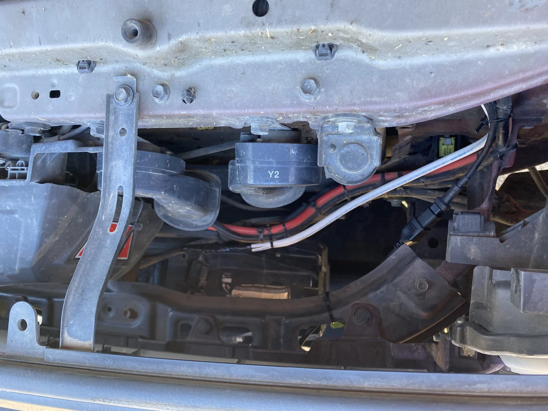

Our rig is heavy and we'll be towing a bit and this popped up in my searches as one of the bigger trans coolers that will fit. However, I am concerned about space since we have our winch controller and wiring taking up a bit of space in the area.

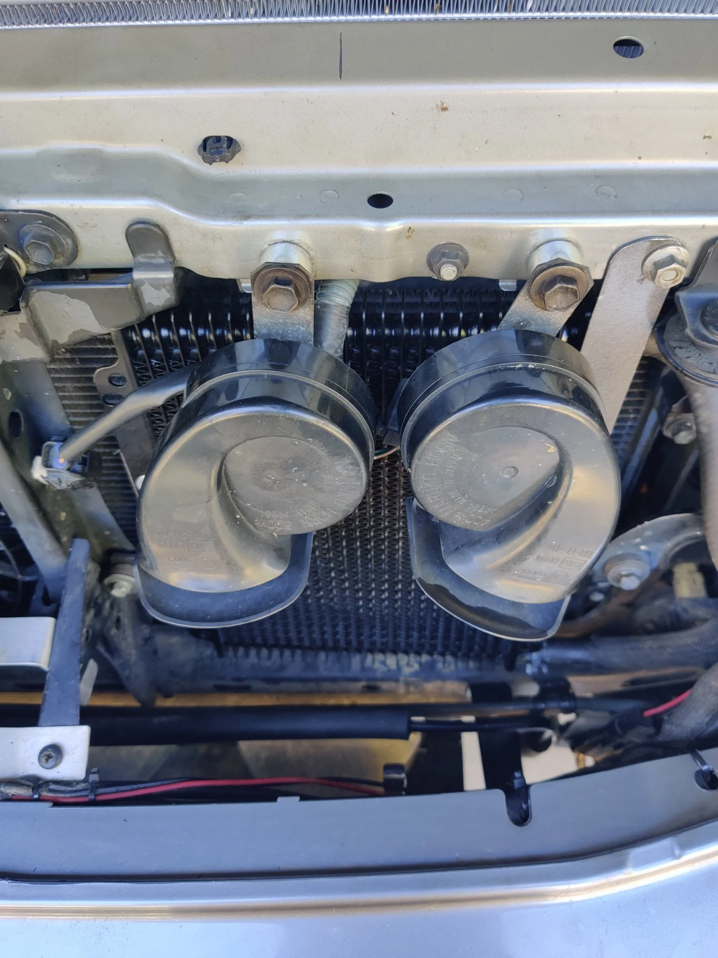

I am in the middle of installing a Hayden 678 in my GX470. I did not buy the kit (I think the Mountain Passes kit is the only option) but opted to fabricate a simple mount out of some 1" steel flat stock. It's not a hard job if you can do some welding (I'm using a $200 HF flux-core welder). I've had to make a few bends in the flat stock to get the mount to work, but that is easily accomplished with a vice and a hammer. I also had to move the horns outward a little bit to get everything to fit, and extend the horn wiring harness (just spliced in some extra wire). If you have some basic fabrication skills it is not hard to make a mount and fit it in. It would also be an easy job for a shop to complete (probably 2-3 hour timeframe for a professional fabricator).
FYI the Hayden 678 is around 3X the size of the stock cooler and only costs around $45.

I have the WAT unit on our rigs and they are basically the same thing but with a bracket and hoses and fittings etc. You just need a place to mount it and to connect the transmission lines from the oem radiator to the new cooler. So not hard AT ALL. We ended up using a fin mount for her cooler to allow for the winch similar to this: Amazon product ASIN B0186N7YB0
Neither of us have any issues with heat etc with 4.88s, a nomad valve body, the added cooler, and the valve body adding a manual torque lockup. We just hit the button in the hills or long straights and the transmission stays super cool and we haul butt.
