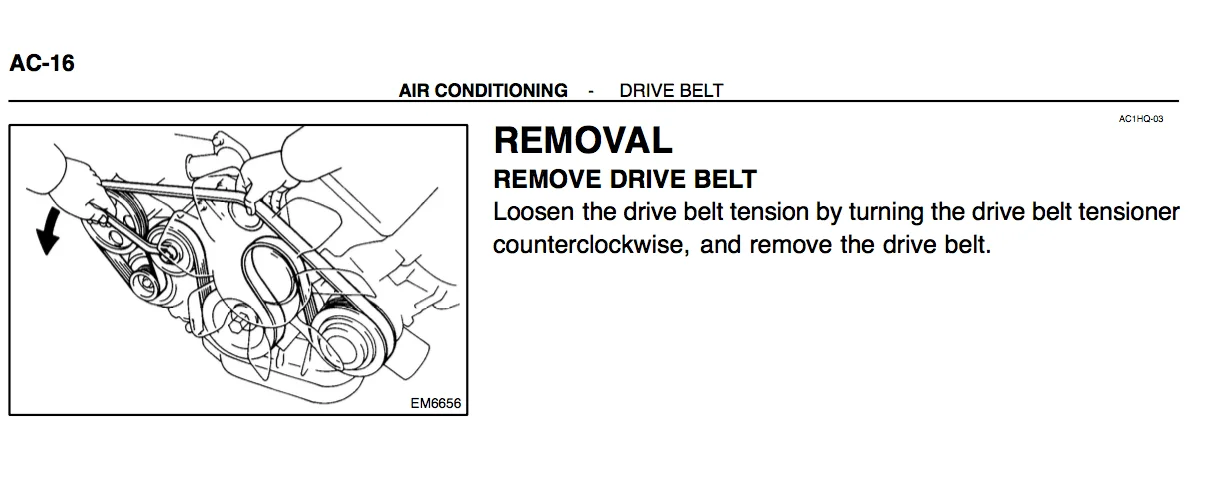

The FSM doesn't seem to agree with the statement that the tensioner thread is left handed. Can anyone comment or resolve the discrepancy?

Turn counter clockwise to loosen the belt tension for belt removal.
Turn clockwise to remove the bolt/pulley.
Oh got it, thanks.

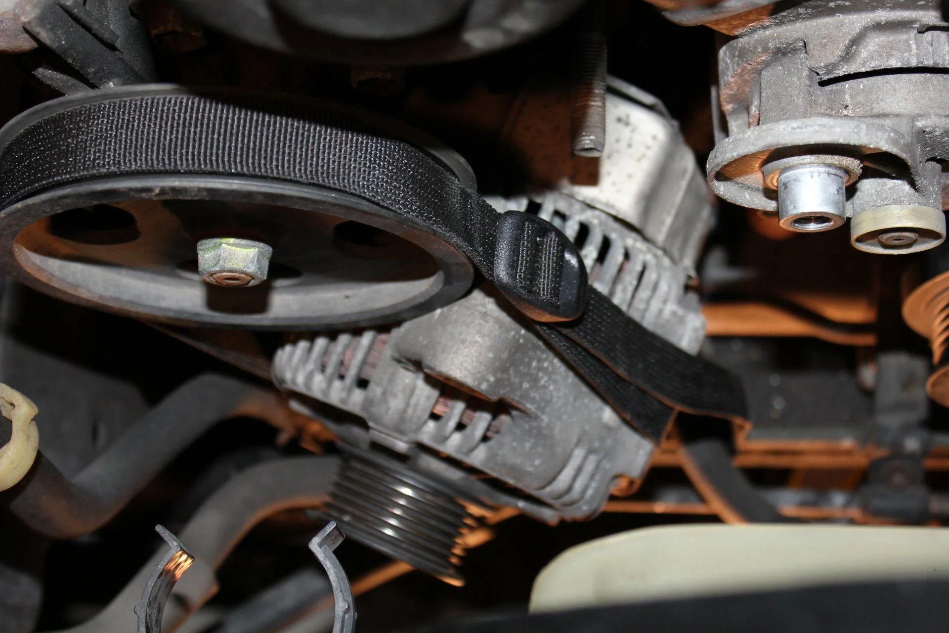

Some notes from my changeL
1) remove the tensioner pulley - just gives you more room
2) on alternator removal - on my 98 it came out without having to touch the PS pump or pulley.
i used a strap as shown in the photo to suspend the alternator so the alternator wiring isn't taking any load. (see photo) I did the work from underneath and slid the alternator into the strap such that it acted as a sling. Hang the strap off the PS pulley as an anchor and then go underneath to set the alternator into the sling. You can push up on the alternator with one hand and tighten the strap with the other.
3) When putting the alternator back on, its easier if you put it on the upper bolt just a bit and then thread the bottom bolt so you can see that bottom bolt threading in. if you slide the alternator all the way on right away its just a little harder to get the bolt started.
