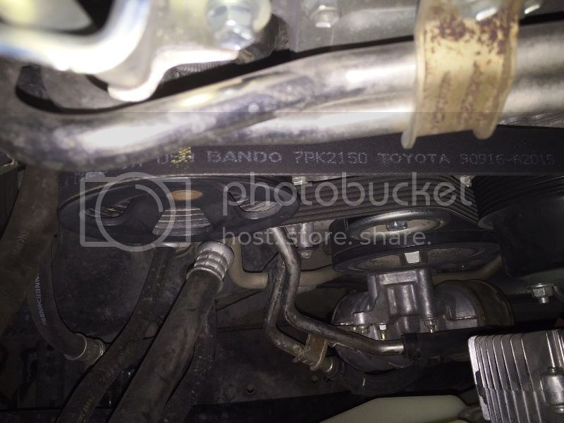

I was basing the purchase of the Bando belt on the post in the Blue Room where the op says that Toyota belt on his fj is made by/and labeled Bando. Why would Bando sell an inferior grade than that of one of their rebranded belt? Would it not be the same belt?
Toyota belts are made by mitsuboshi, ive never seen a bando as a Toyota oe belt
I dont see a label on my '11 fjc. the picture below is from the link above from the blue room.
Well now thats interesting.

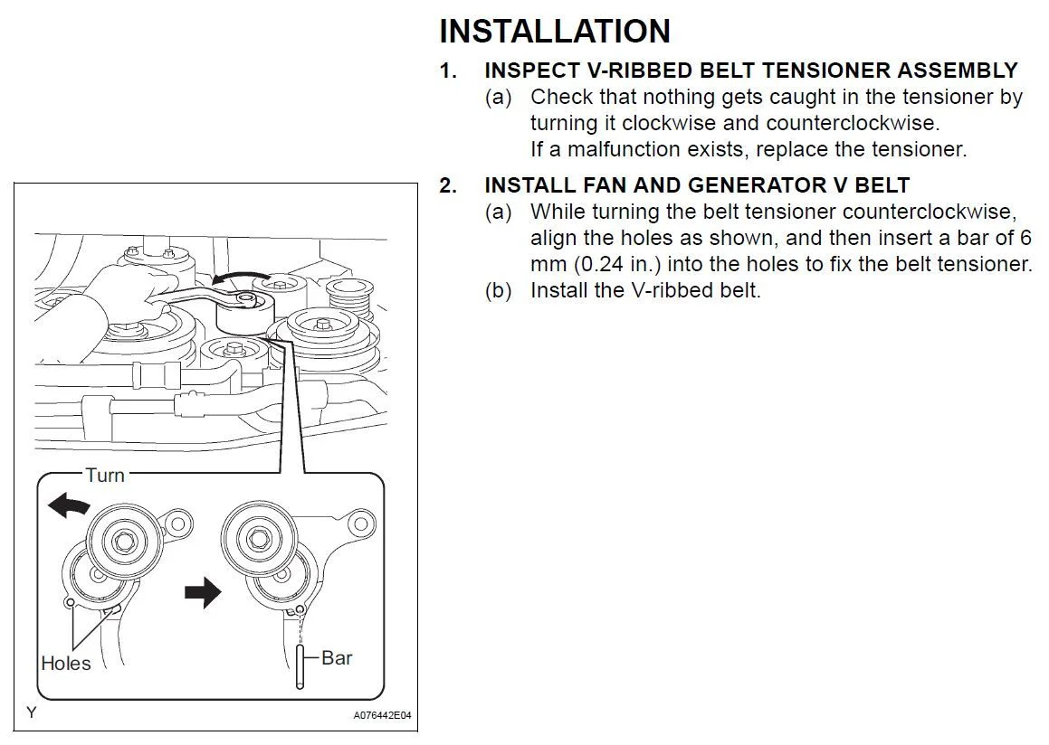

Just replaced the belt in my 2008 FJ with 100,000 miles. Original belt had minor cracks and was stiffening with age. Sseemed like a good time to replace. Used the Gates K070834 serpentine costing about $25. Took 15 minutes to change - only because I had never done it before. Next time it will take under 5 minutes. Easy job! I always run with a spare belt in my vehicles and will keep my OEM as the backup spare for the FJ.

Changing the belt takes about 3 minutes with a socket drive and a deep 14mm socket. I use a 4mm Allen wrench to insert into the "lock open" hole on the tensioner pulley armature. My pulleys have only been changed a few times and it was mud and water that ruined the first set that was on the truck. I don't do muddy water crossings as much now so they seem to last longer.
