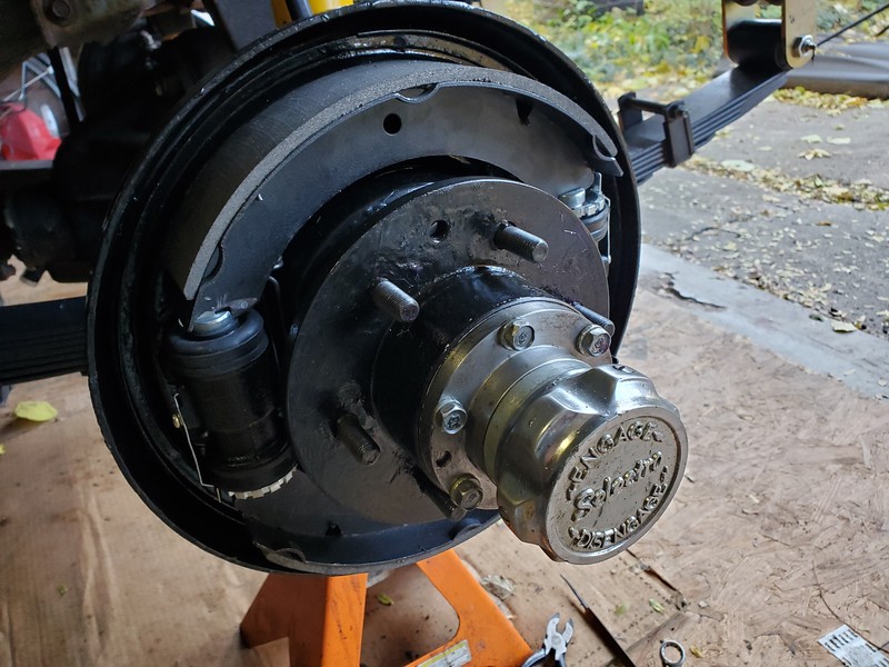

Reviving an old thread here. I will be replacing the Selectro locking hubs with a pair of Warn 30 spline. (1977 front axel) Question: Do I need to source cone washers? I'm not sure if the Selectro hubs have them and I'm not sure if the Warn kit includes any. Is there any other additional hardware that I should get?
Thanks.
I went from Selectro to Asco and I’m pretty sure I needed to source cone washers (76 fine spline). But, I’m old and have a proclivity to aimlessly meander. :hillbilly::hmm:
Yes, you are correct. I removed one of Selectro Hubs in order to verify. There are no cone washers. Order has been placed. I believe that the cone washer OEM part # is 42323-60030.
Thanks again.
I don't recall there being any cone washers needed for the Warn hubs. For the Aisin and ASCO they are needed.
