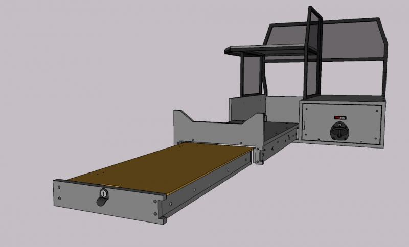

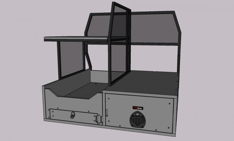

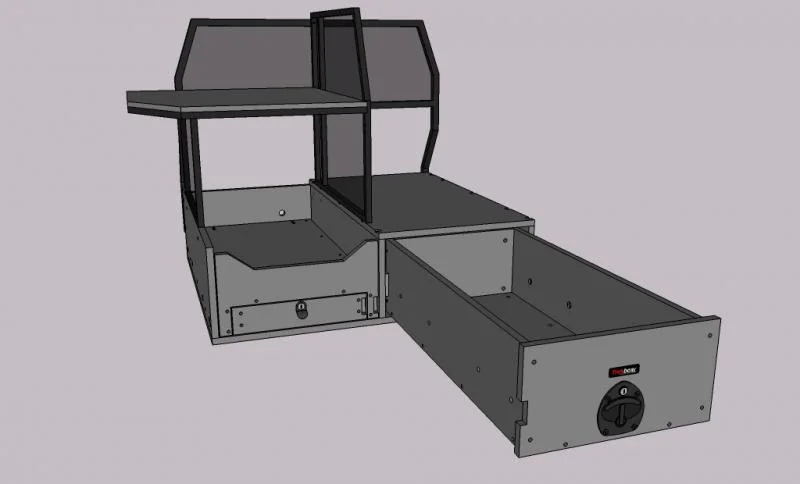

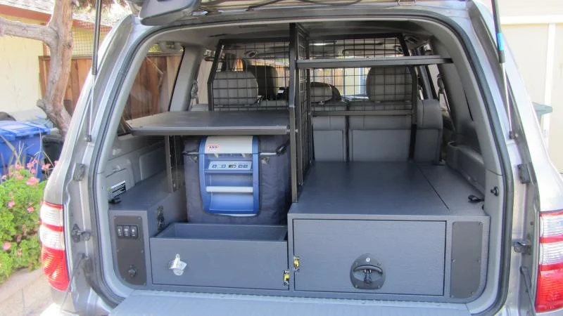

A few preliminary pics- all comments welcome!
Great looking setup David. I have a couple of questions. I anticipate installing identical side by side drawers (and a wing kit to run electronics and other accessories) and later add a fridge and slide to the top of the unit. Do you plan to offer some modular options that would allow this, or are you only selling the whole setup in your pictures? Thanks.
Not selling anything yet, but yes, I plan to have a 2-drawer option, for sure. The only real issue (for me) with a two drawer system is the fridge height. Tembo Tusk's Loadspotter fits the bill nicely, as long as you can spare the space it takes up. Do you plan to use a drop slide?
Good to know. I will try to offer a rolling top as well. Thanks for the input!
Also, to clarify- the above design is shown without the wings and side faces- they will be available on the finished product as shown in my build thread. I'm still working on mapping them out precisely. I was thinking of including pre-cut abs covers for the face of each side, so you could easily cut them to fit whatever switches, air lines, etc. you wish. I'll post a pic when I'm back to my computer...

The color comes from the Line-X. I don't know what colors Line-X runs, but if they run a tan you could custom order a set of these to be tan. Or you could ask for the system to come unpainted and paint them tan yourself? Or, most don't like this, you could wrap it all in the stock carpet. There are a bunch of ways to change the color, but 1407driver offers his drawers in gray and black because this is what Line-X is offering to him at the moment. If I understood the post correctly.

Here's a picture showing the wings and accessory plates on the front of the wing faces.
That's about the only way to make a low fridge work. Without the shelf any space above is almost useless as it has to be moved for fridge access. Further, things want to slide into the fridge valley when it's pulled.

Also, regarding the view out the back- it's great! Even the passenger side shelf on my system is above your sight line, but this shelf has been deleted in the final design anyways. I find that it's a bit too small to always be useful, and more often than not I wish for a few more inches underneath. Also, one of the reasons I put the fridge on the driver's side is to not block any of the view when looking over your shoulder to change lanes.
Absolutely. I pull my fridge out daily, usually many times a day. I can't imagine having to unpack all around it each time! Also, If you are the type to have the fridge out day to day and just installed for trips, the full-bottom fridge slide as opposed to a "skeleton" design is handy for grocery store runs.

I agree on the tan. I just want to make it as cost effective as possible for those folks that want tan. I'd rather not have an upcharge if we can just get a sort of tan group buy every once in a while. It will all depend on volume. Maybe I won't sell any, who knows.
The bottle opener works when you pull the fridge out- but understand that is a picture of the system I built for myself, which is a little different than the one I'm producing. You could put a bottle opener wherever you choose!
As far as price- I don't think it's within the scope of this (tech) forum to discuss- but I wouldn't know yet anyways until I've made a few final systems. I will say that the drawers, fit kit, cargo barrier, and divider/shelf will be available as separate units and my goal is to be competitive price-wise with an arguably better product (my opinion only).

How about those of us that want the traditional double drawer like the ARB that's all one level? I would still be interested in the connections in the wings too, but without all of the cages and shelves, unless they are removable and adjustable. Have you run any preliminary cost for the buyers? I'm looking at getting something in the near future and would be interested how much these would set me back.
As stated above, I'm not sure on cost yet but they will be competitive. Yes, I will offer a traditional double drawer system. The cargo barrier/dividers/shelves are bolt-on options. They are completely removable. The only adjustment is in the shelf- it will have 4 possible height positions, but each one will require a different height fridge barrier. This is to accommodate most of the fridges on the market to maximize useable space.
I'd like to ask, just for my info, why would you prefer a traditional double drawer system? Would you put a fridge slide on top of it or would you prefer a rolling top? Also, why do you see the need for the cage bits to be removable? Thanks for the input!
I use my truck for hunting too. i want to be able to throw large gear bags full of decoys, or even a deer in the back. To do so, I would need to be able to lay the second row seats down too. Also, I would use it as a sleeping platform.
Sorry that I missed the other info. I read through everything VERY quickly.
Ah, gotcha. The shelf, fridge barrier, and center barrier would remove with 6 bolts. The cargo barrier another 4. There is approximately 13" between the top of the drawers and the bottom of the cargo barrier. There's no center support, so you could load cargo or sleep underneath without removing it if you wished.
Since you asked, my 2 cents...
The way you have it sketched out, each drawer is approximately 21" wide (42" total width). I say size the fridge side for the ARB 50QT, as that is probably the most popular size. The fridge is 15" wide. Add 1.5" on each side (or whatever the minimum is) and you have 18" total width. That would give you a 24"+ wide main drawer.
Locate the fridge on the passenger side. Now, with the 24" drawer and the side wing, a person could actually sleep on the 60 side (of the 60/40 split seat).
On your personal drawers, you have a tray located in front of the fridge (closest to tailgate). I'd locate the tray behind the fridge (towards the front of the vehicle). This is a good spot for reserve beer storage. I think people want to be able to open just their lift gate and access the fridge... not the extra 2 steps of lowering the tail gate and sliding out the drawer.
I realize you have a storage shelf above the fridge. Let me think about that some more...
