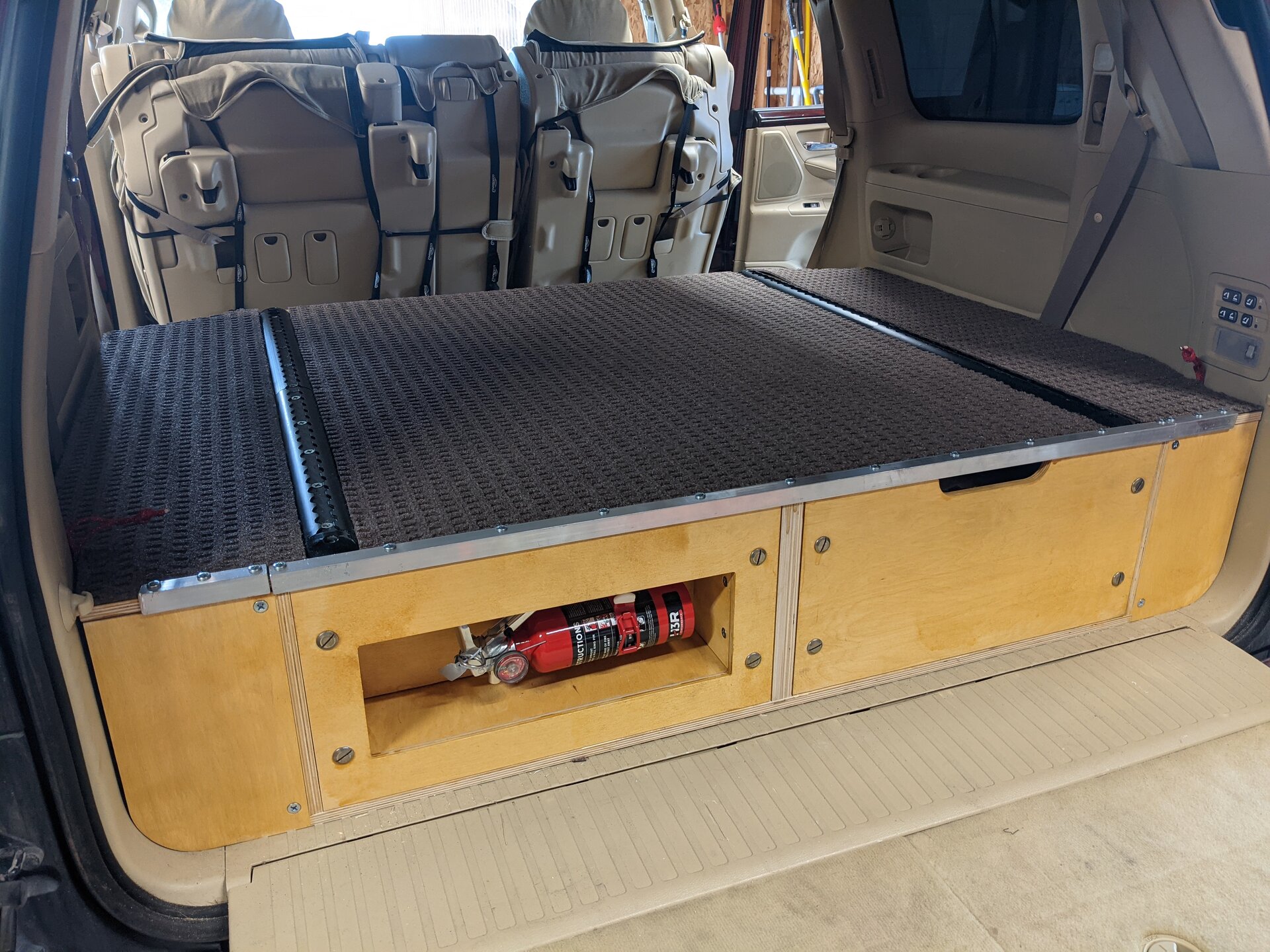

Will get a pic shortly. I should also add that I put the carpet back on top of the plywood and I'm using a 12"x24" piece of HDPE under the fridge so it can "breathe" (actually I was going to build my own slide out tray and then decided just to leave it fixed since I can't open the rear door with my square drop camper attached). So it's hard to see in a pic what's going on.

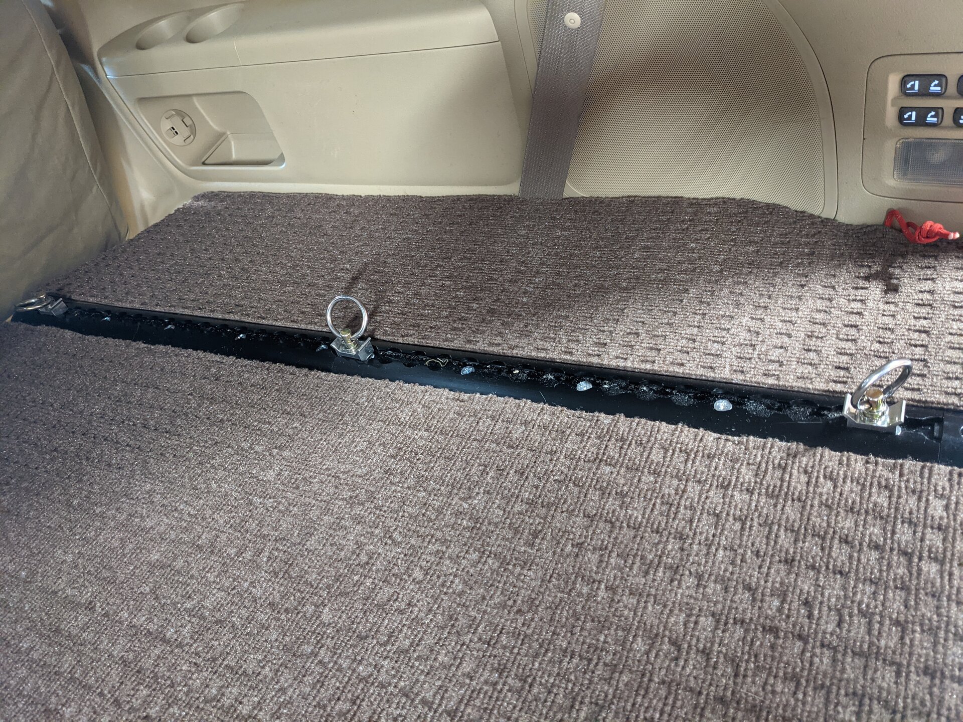

Here are some pics......as you can see in the last pic, the carpet doesn't make it all the way to the seats but no one sees that anyway. And the aux battery and my solar charger controller are screwed into the plywood as well.
Airline L track bolted to plywood which has to be bolted to the floor. If you buy the proper one it is actually load rated. Used alot in handicap access vans and school buses. Us cargo control sells it as well as straps. You can find cheaper l track and the different attachment buckles on amazon and ebay. Just may not be as strong. I am a big tie down afficionado since I pull an open deck trailer for a living.

I did L-track on my drawers. Works pretty well.
