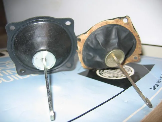

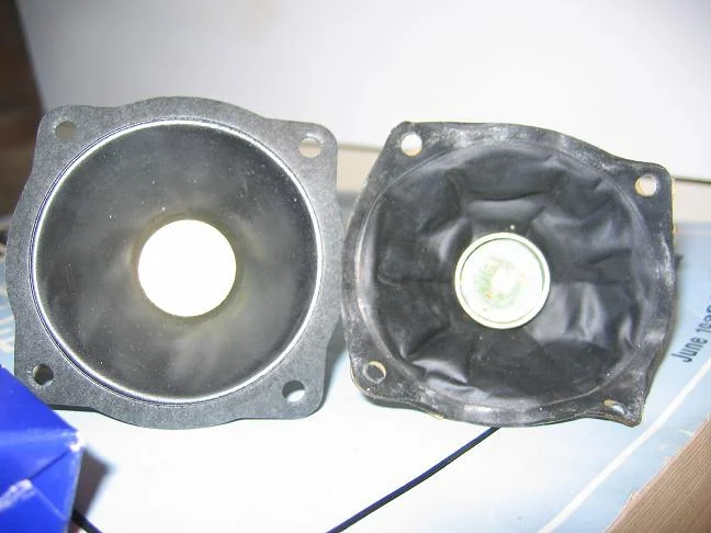

just got the Napa part....
whoa, big difference.. that part was worn out.
