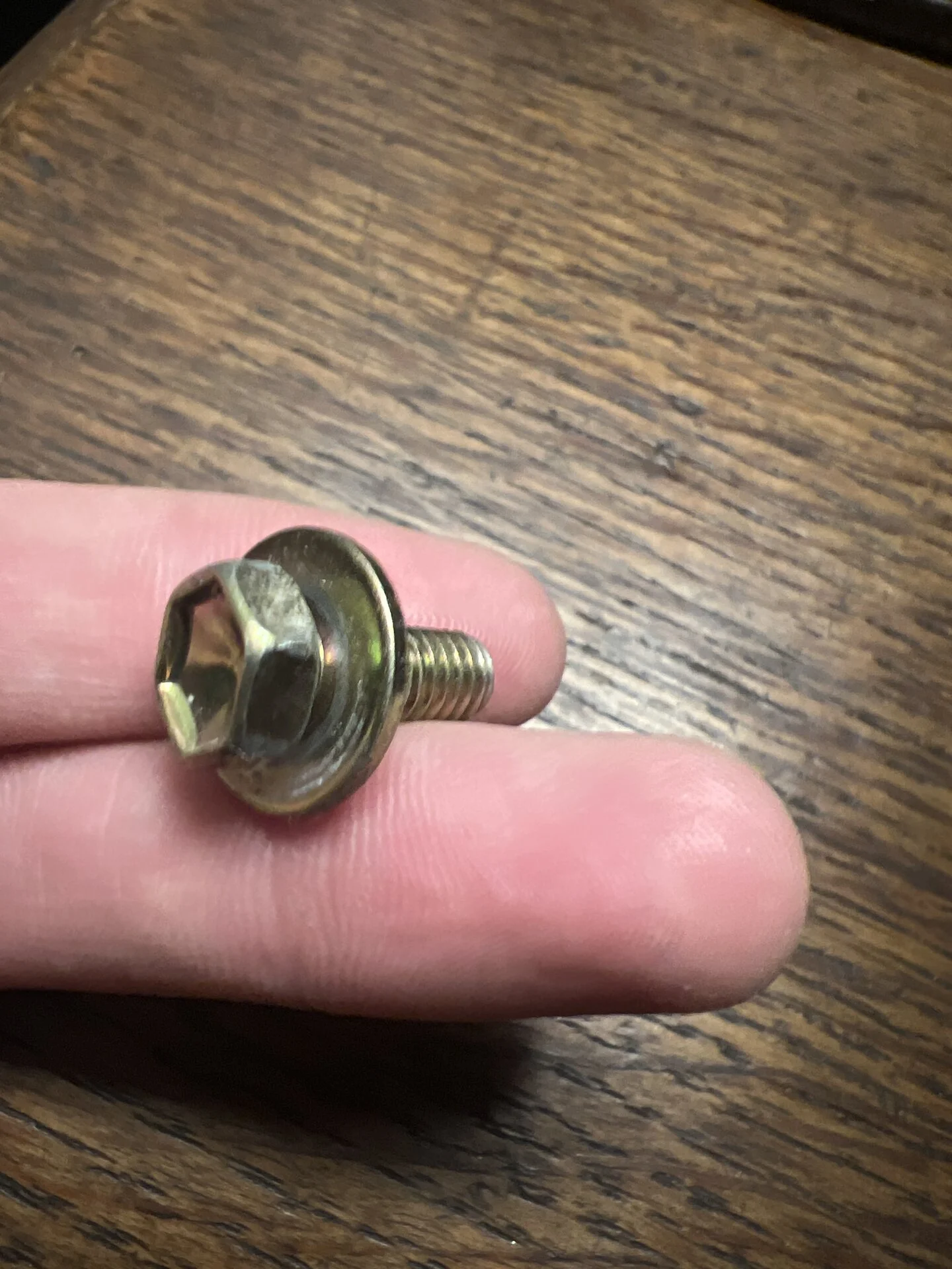

Hello,
I removed my seatbelts to send them off for restoring the webbing and to restore the retracting mechanism.
Somehow I managed to misplace a bolt for the second row seat. The small one that bolts in above the assembly. I’m not sure what to look for to replace it, as I don’t want to throw any old bolt in there. Could someone point me in the right direction to replace this properly? The size of the bolt is a 10mm head and the shaft is 1/2” long.
Mostly looking for peace of mind that my seatbelt won’t come flying out in the event of a crash…
Thanks,
T
What year/model is your 80 Series?
Is the photo showing the bolt that you're missing (taken from the other side)?
Might be 91631-40614, order from your local Toyota dealer.
‘96 fzj80
Yes the bolt is the one that’s missing, taken from the other side.
Thanks for the diagram, I believe that is it.
FWIW the replacement bolt may not look the same unless it's NOS, IME most new production bolts no longer come with the original yellow chromate plating.
