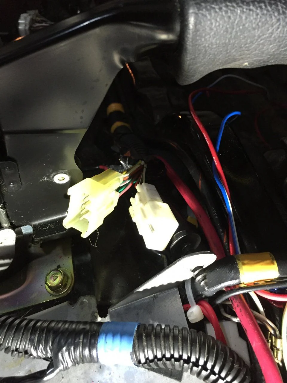

Well with 90% certainty I can say that my 97 LX does not have plugs for seat heat...unless they look completely different than the LC's.
Here are the only un-used plugs found.

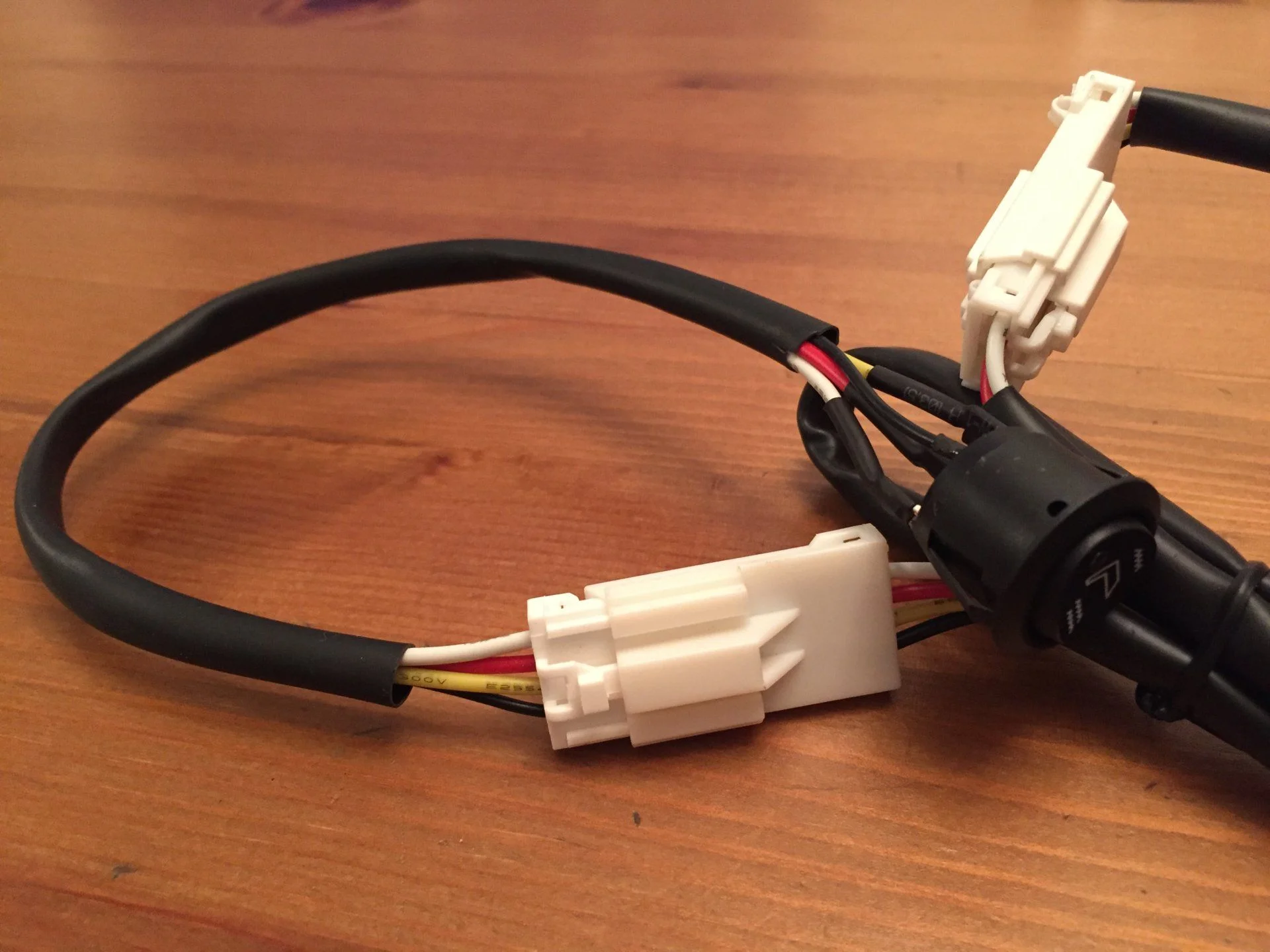

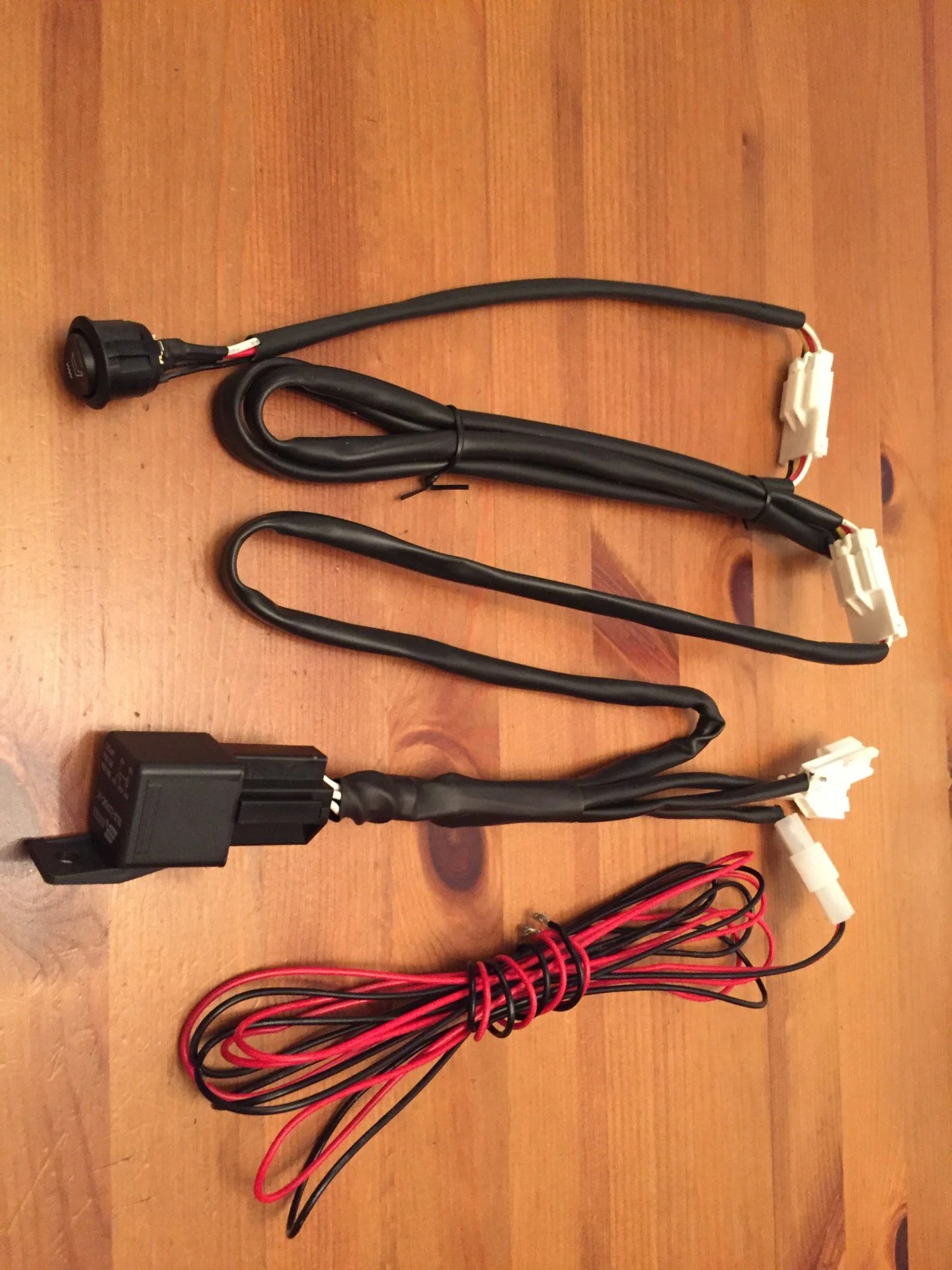

I bought my seat heaters on ebay a while back and installed them when I redid my leather. My seat heaters are the type with the relay. I have the two connectors with +12V & Ground for the seat back and cushion underneath the seat.
Has anyone used this type of seat heater and if so, how did you wire it up? Do I need to keep the relay in the harness or cut that all out? Pics of my harness:

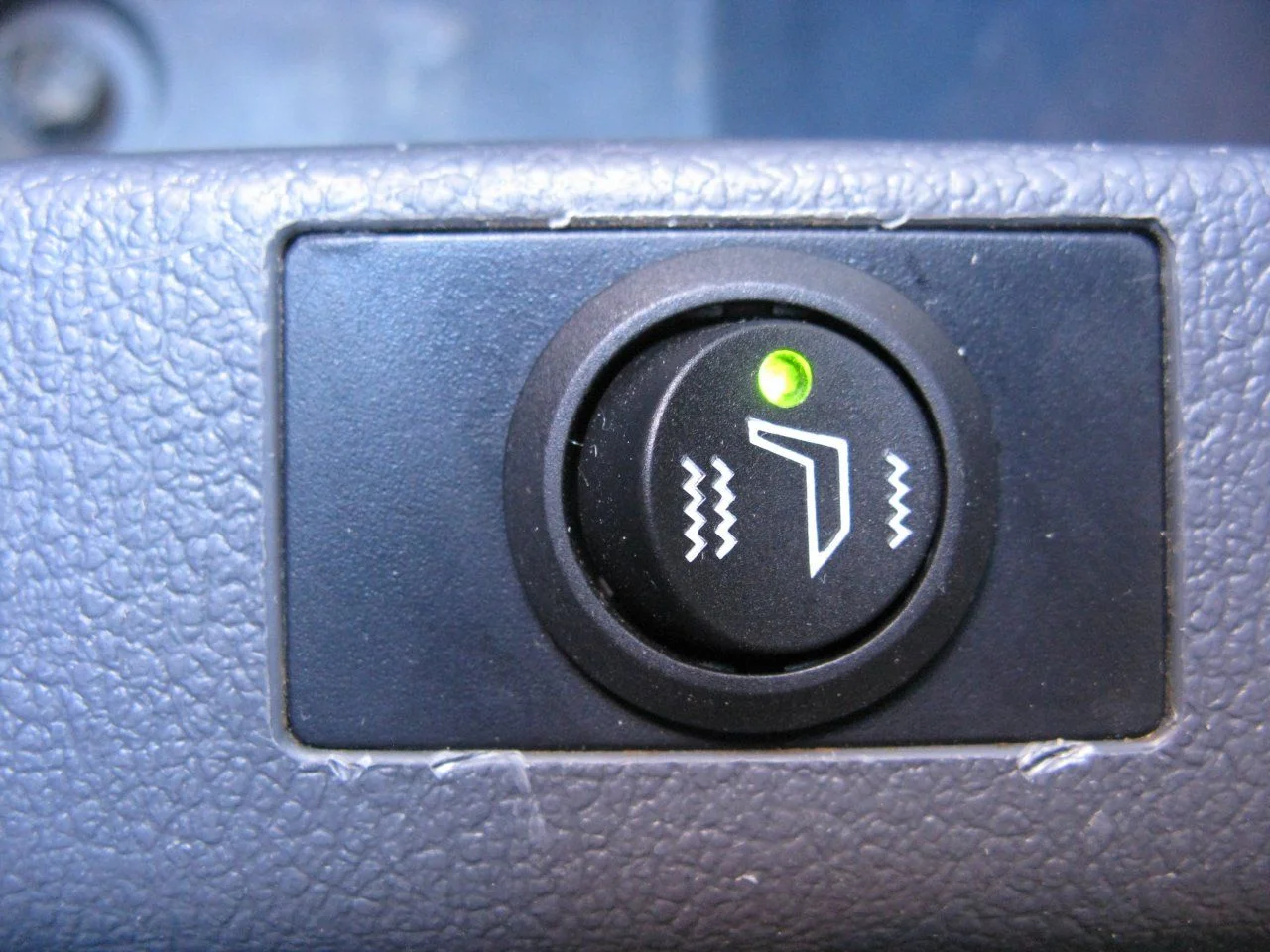

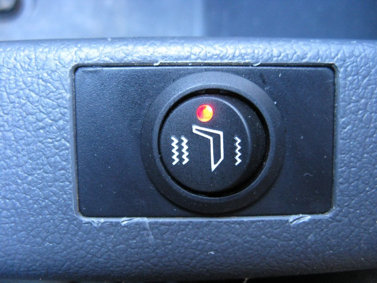

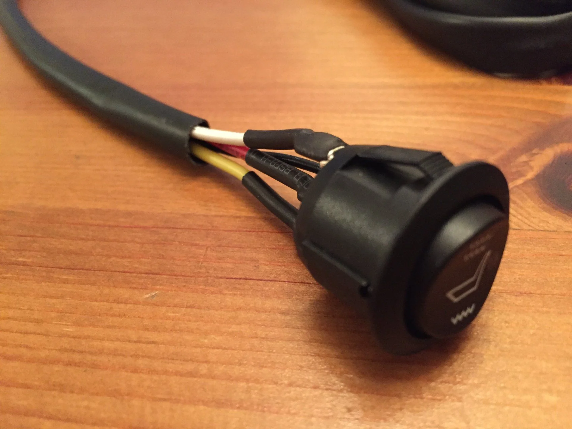

Sold my OEM seat heater switches and paid for my seat heater kit 100% with change. Installed the kit supplied switch in a blank filler in place of an useless coin holder spot. 100% happy with the low cost option.

Do you recall what size hole you drilled to mount these switches? 3/4 perhaps. I have the same seat heater kit and switches.
I know it was a while ago, but maybe you remember. Not calling you old, haha!
View attachment 1592686 View attachment 1592687 View attachment 1592688

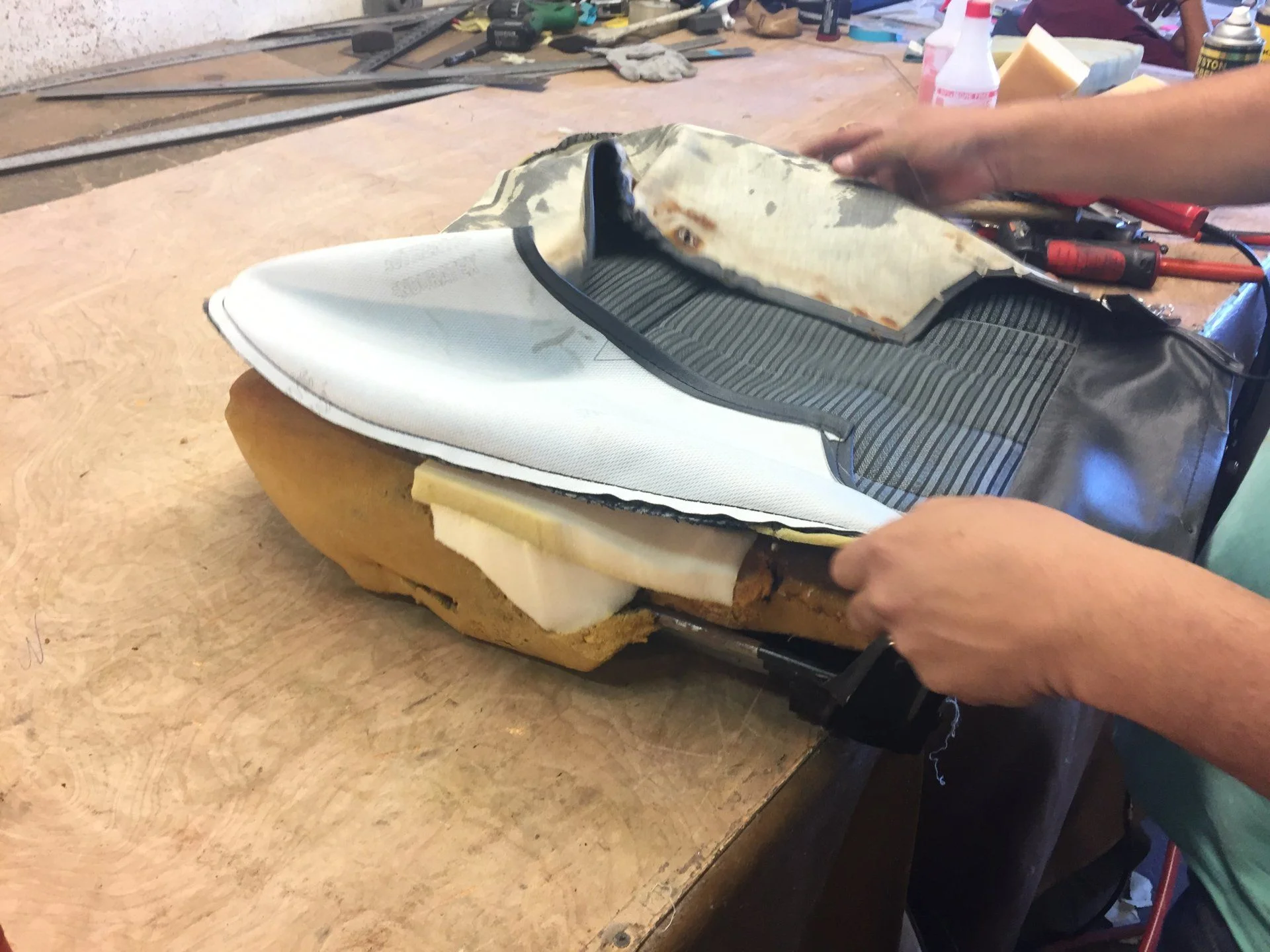

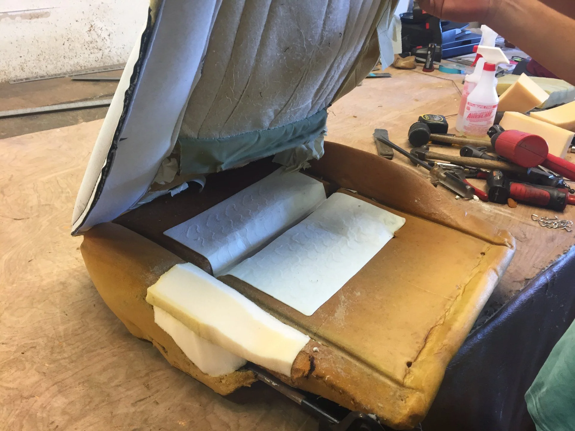

I just put this same set up in 60. I just. Ought mine on amazon, but they look to be same basic setup. Super easy install. Hardest part was taking the seats apart to fit the heater pad in. Although my upholstery guy helped with that since I was fixing a torn driver seat at the same time. I also had him swap the seat bottom cushions. Now the worn out drivers side edge is on the inside of the passenger seat.
As for wiring, just route switches and power and ground under carpet along door sill and mount switch where you’d like. I put mine switch in 2 blank spots on the dash. It is very much plug and play. Leave the relays alone, you need them for low and hi function. Hook to ground and hook to ignition power. Then button everything up. Now you got yourself some hot buns.
Because the hole takes up most of the blank I was not able to drill it I used a porting tool or dremel type tool to make the hole
