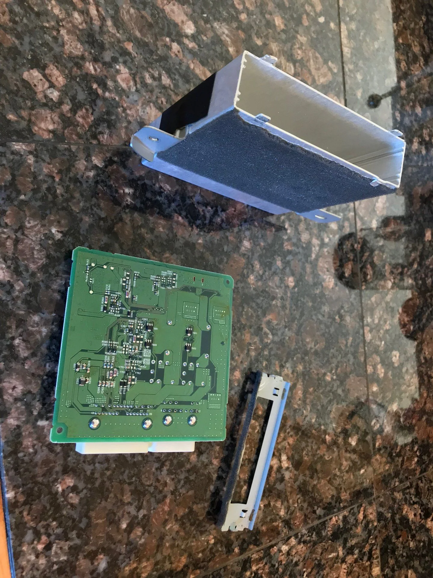

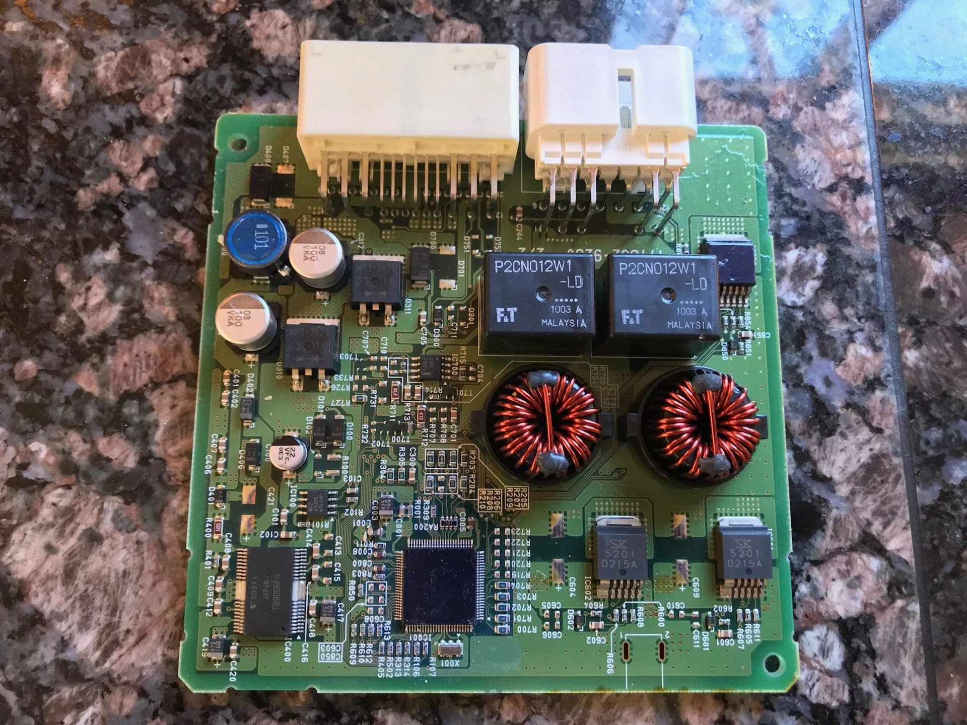

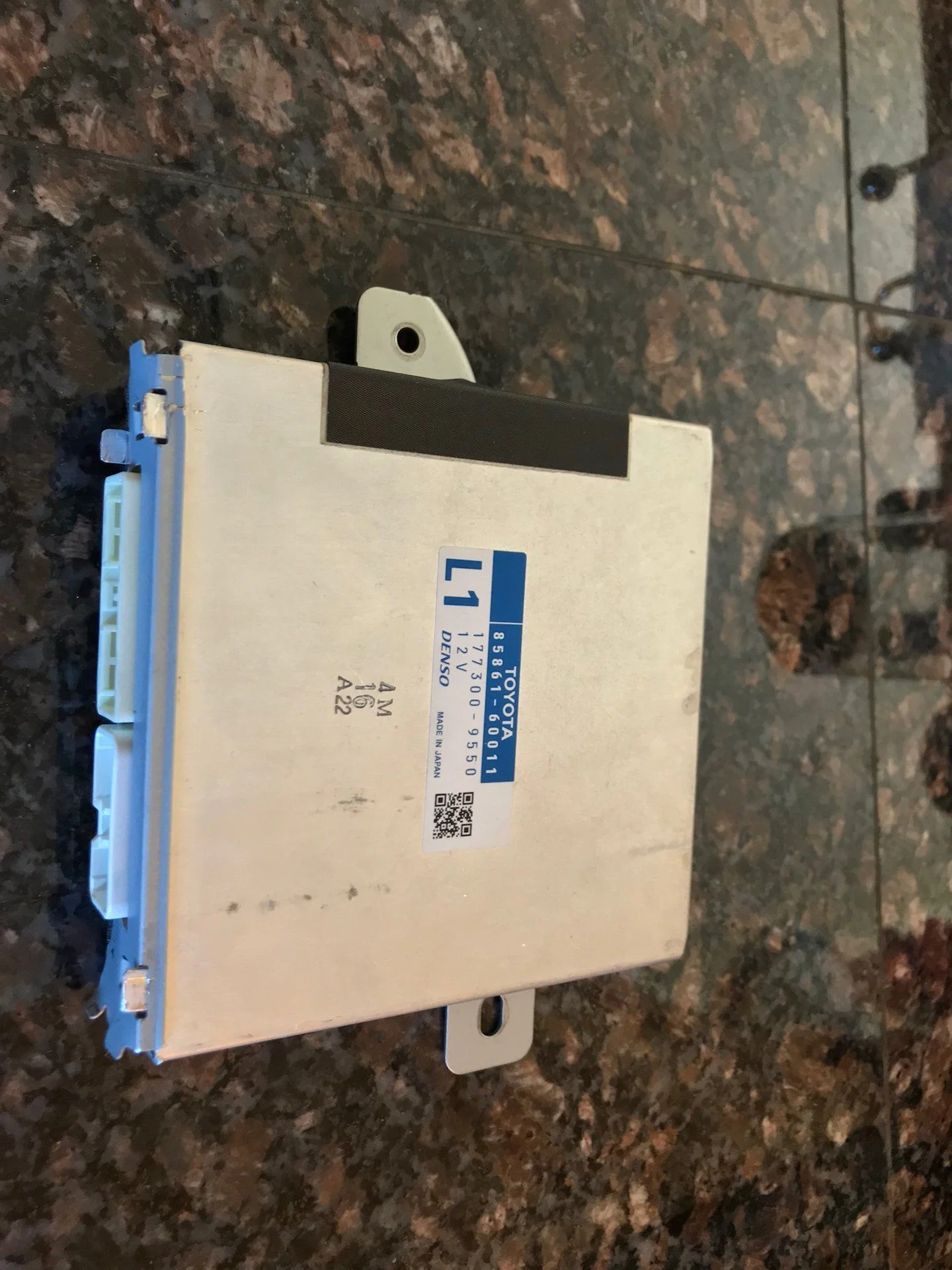

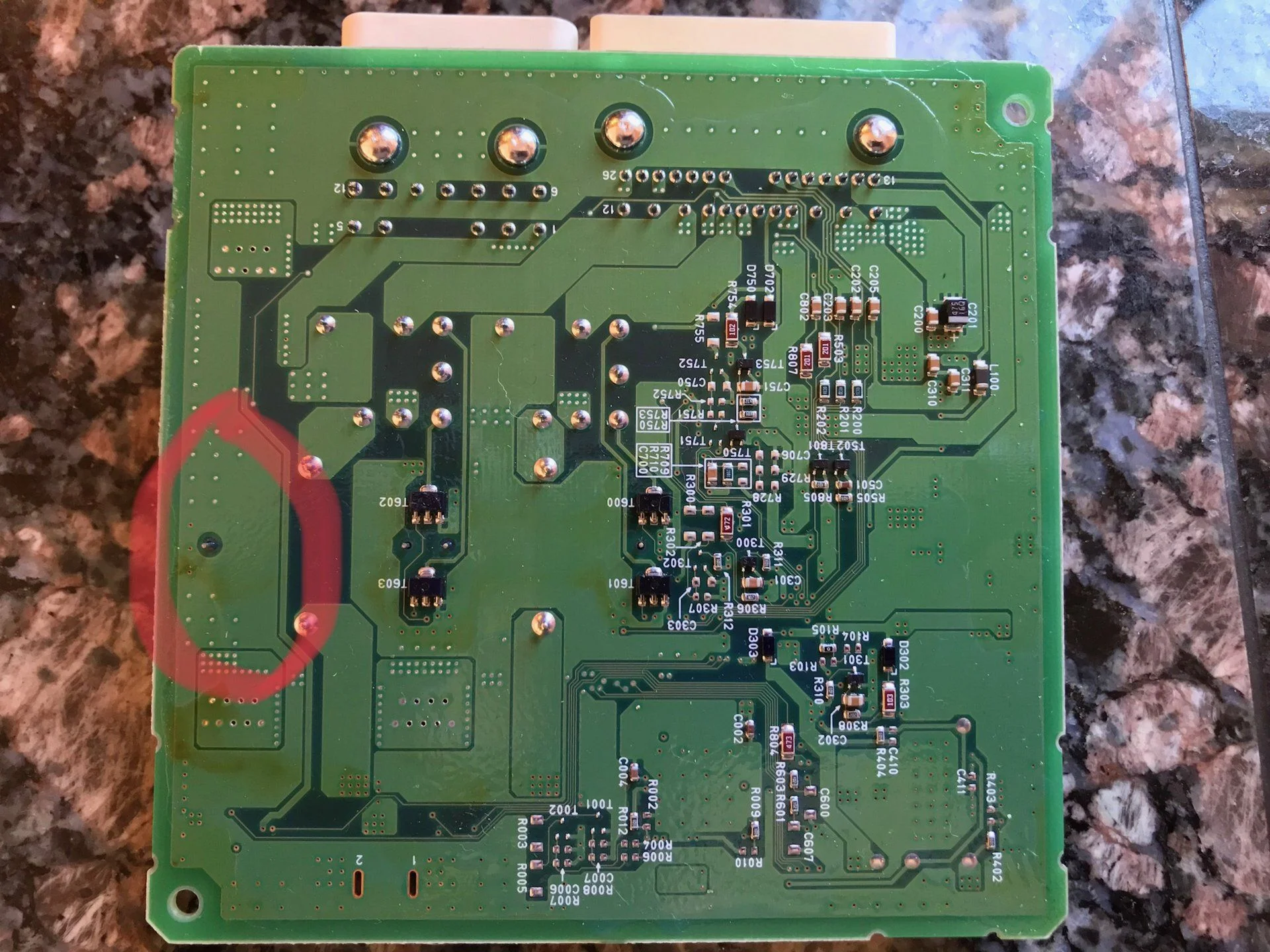

I have the old ECU and will pop it open in the next few days and post what I find if anything.
Well there are no signs of corrosion or any burnt components. I looked at both sides with a magnifying glass and while I’m no electronics guy I certainly couldn’t see anything that would cause an issue. Must just be one of the components failed.
Seems pretty complex for seat heat and cool!
Not disagreeing with TonyP, but my guess would be one of the relays. Caps and everything else look fine.
