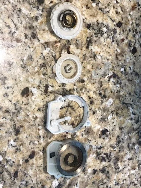

The retract assembly.
In addition to the caution, I came across a number of recommendations to wear safety glasses when disassembling this type of spring.
The first spring you come to in the assembly is the one at the bottom of the photo. Turns out this spring was just fine.

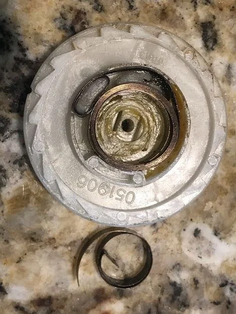

The second spring I came to was the one at the top of the photo -- this was the broken spring.
Broken end removed from the assembly.

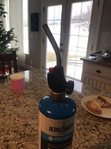

Heated the end of the remaining spring in order to bend it.

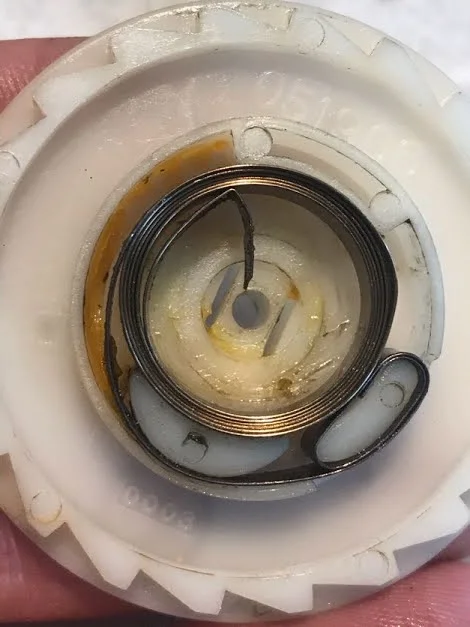

Here's how my end bend turned out. Next step was to reassemble and reinstall in the cruiser.
The spring end doesn't look much like the original shape, but it was close enough to make the seatbelt retractable again.
