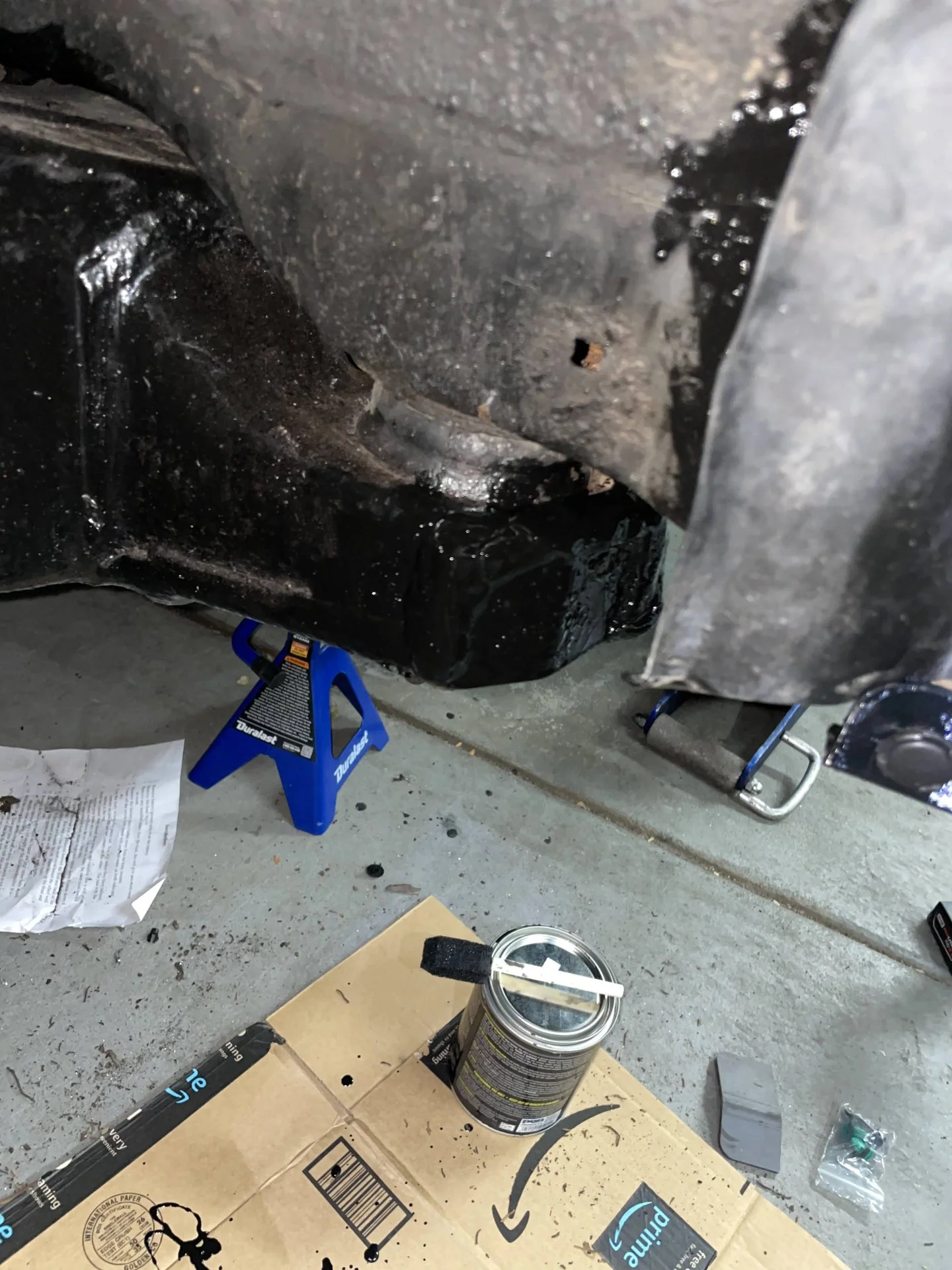

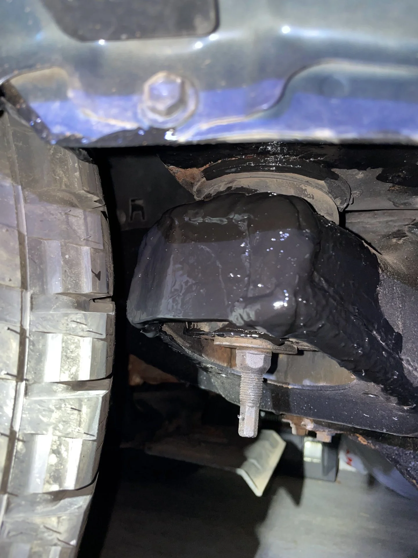

I have laid down the POR-15 on what I could reach from the passenger front fender well with a paint brush. I first degreased it, but got impatient and didn't use the recommended POR-15 metal etcher. Instead I used rust-kutter that I had lying around.
I painted the frame rail, strut tower and areas by the LCA brackets. Painted on one coat and an hour or so later... (while the first coat was still tacky) a second coat.
Definitely doesn't look like a showroom quality paint due to the imperfections from scaling, but it looks solid. We shall see.

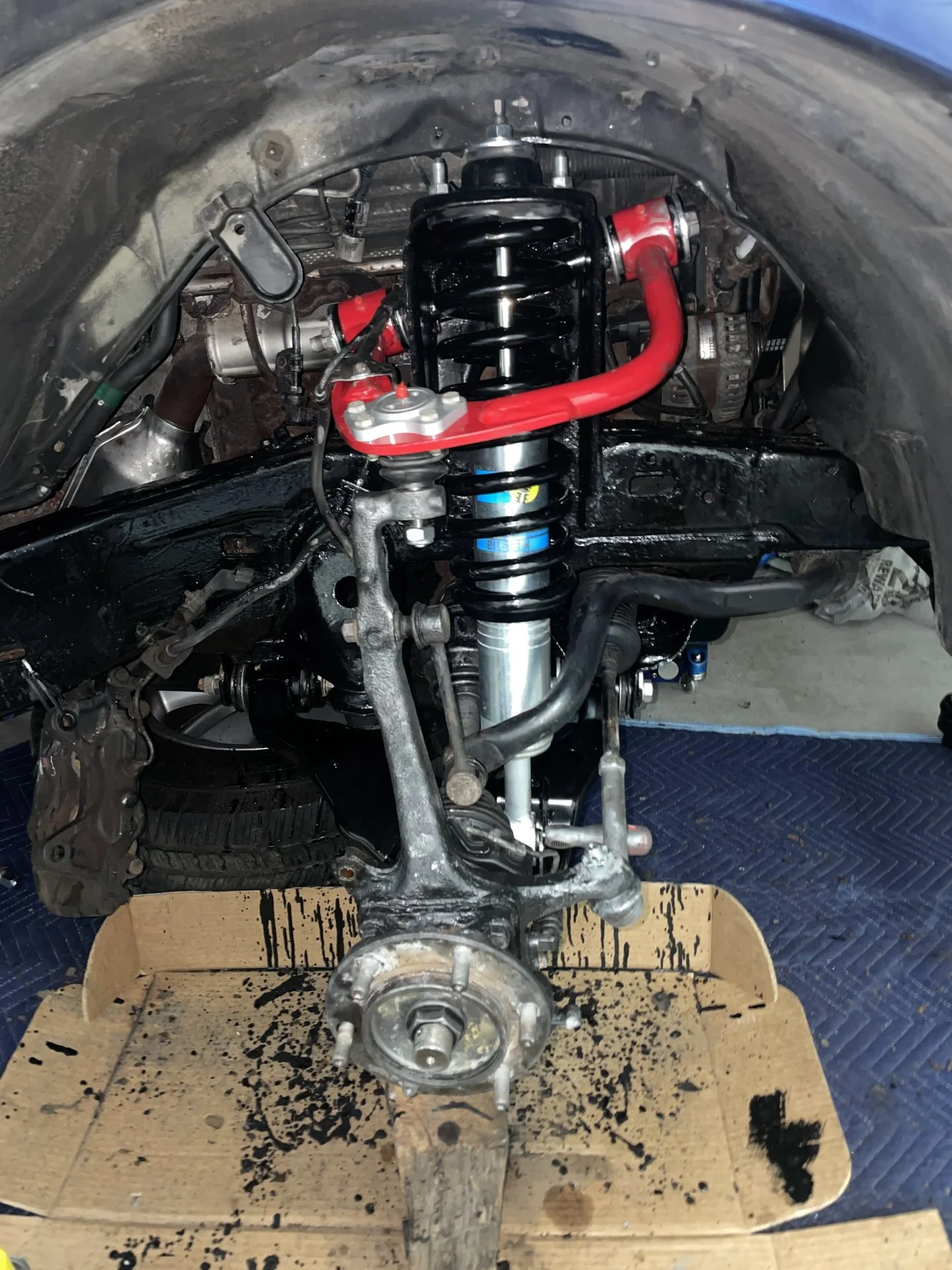

Coming together! Just need a lower strut bolt and the correct size sockets to torque everything down.

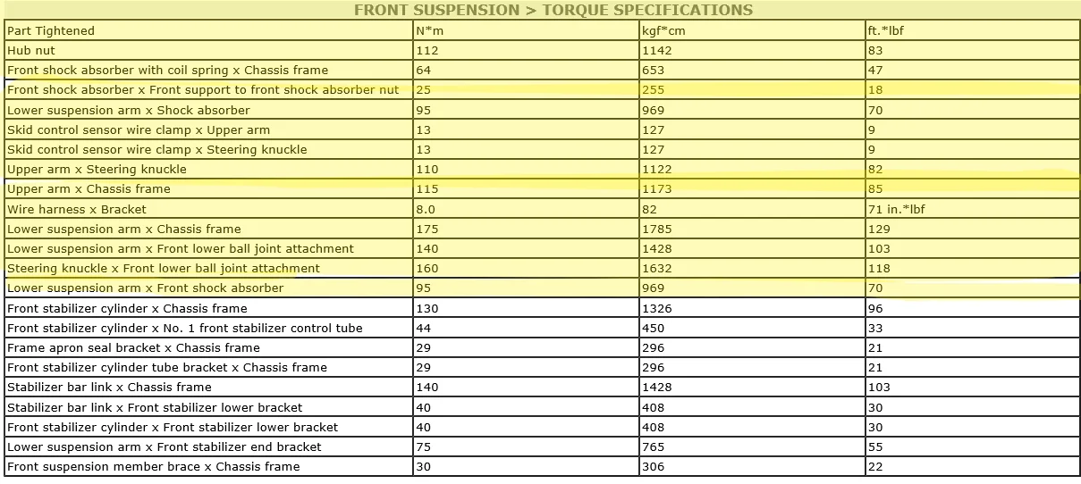

Quick question for whoever might have good insight
These torque specs are for a GX460 as I couldn't find much consolidated for the gx470 online.
Am I good to use these numbers? I know the vehicles are very similar.

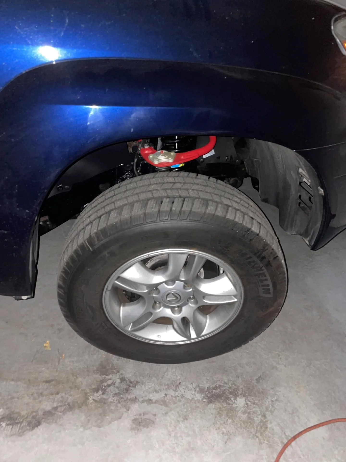

I recently wrapped up my front lift and I am ready to install my new wheels and tires.
I have more clearance than I originally anticipated and couldn't see needing to trim at all based on the clearance I have now.
Based on everyone's experience and the photo below, do you guys think I will need to do any trimming to fit 275s with a -12mm offset wheel?
Stock 265 tire and wheel setup below
I would say minimal trimming if any with 275/70R17s and your lift/uca upgrades.
Just make sure you get a wheel alignment and get a positive caster at least 4 degrees to push the tire forward a little.

My JBA UCA's recommend a 3degree positive caster but I will try for 4 when I get it aligned. I've just been told it can get hard to adjust caster on these gx's sometimes.
Also, I already have my tires and wheels - Went with Wildpeak ATs 275/70R17. And some amazon specials wheels :rofl:
I'm going to try and get the new shoes mounted this Friday. Then an alignment from a reputable shop next week.
Just praying they don't round out my cam tabs.. that's something that i've been worried about from the start. They weren't in the best condition.
Will keep you updated on the rubbing situation.
I have 275s on TRD Pro wheels (+4 offset) with stock suspension and they barely rub on full lock. I moved the front portion of my fender liners forward and the 275s are close, but they clear without rubbing there. If I hadn't moved them, they would most likely rub.
Increased caster and -12 offset wheels will make the front fender liners even more of an issue
This video shows how to easily reposition the fender liners.
Did this mod yesterday, very easy with the video tutorial.

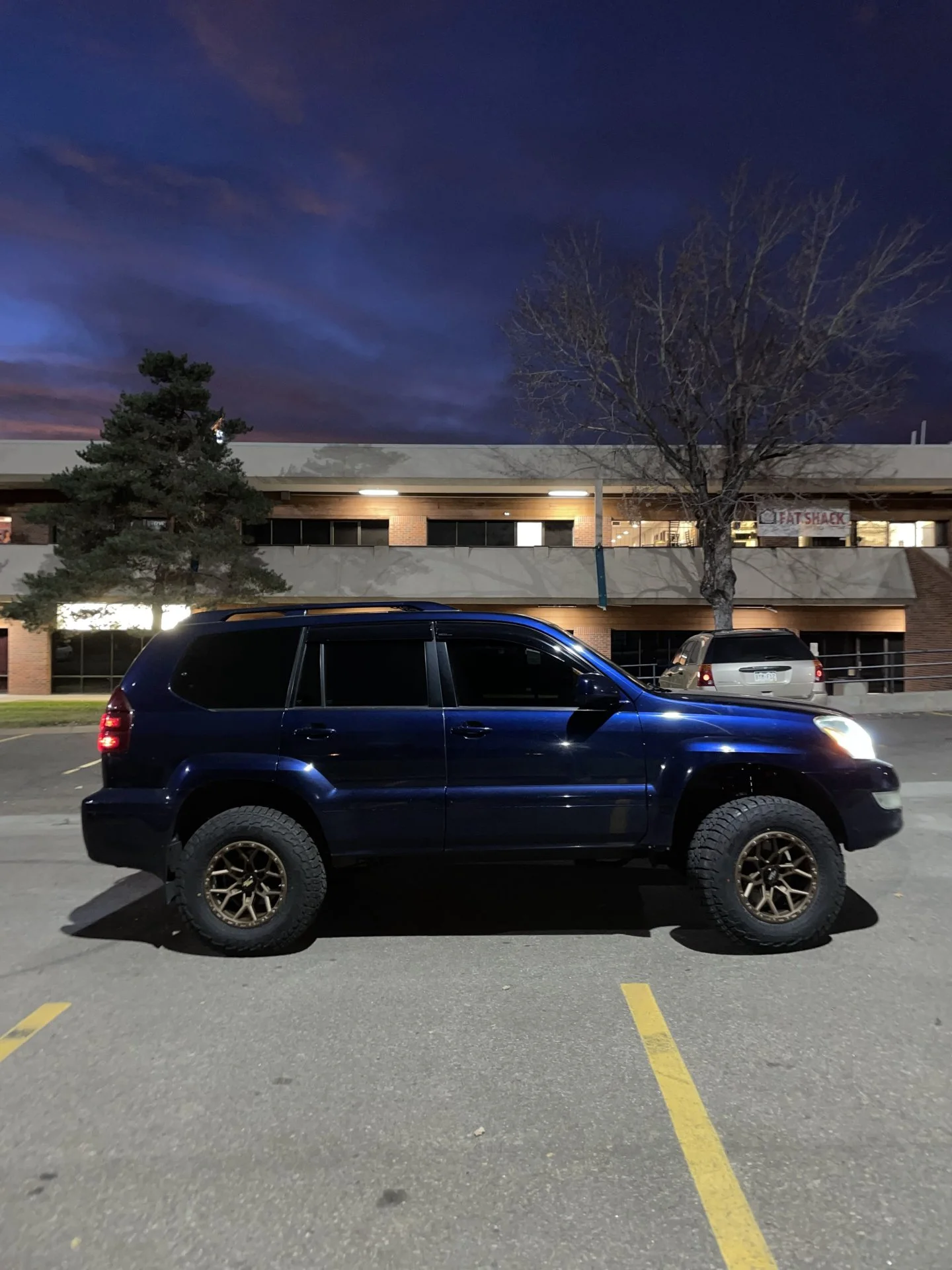

Hoping I dont rub too much on the rear of the front 2 tires. Getting the wheels and tires mounted before the alignment.
I have the new shoes mounted up! Exact look I was going for. (Still need to trick rear bags, in photo bags are on HI)
I am rubbing slightly at lock on left hand turns on the body mount. Was hoping I wouldn't have this issue as I don't have a welder to properly weld up the wedge you're supposed to cut out..
Alignment Is this Tuesday so we'll see how some caster helps.

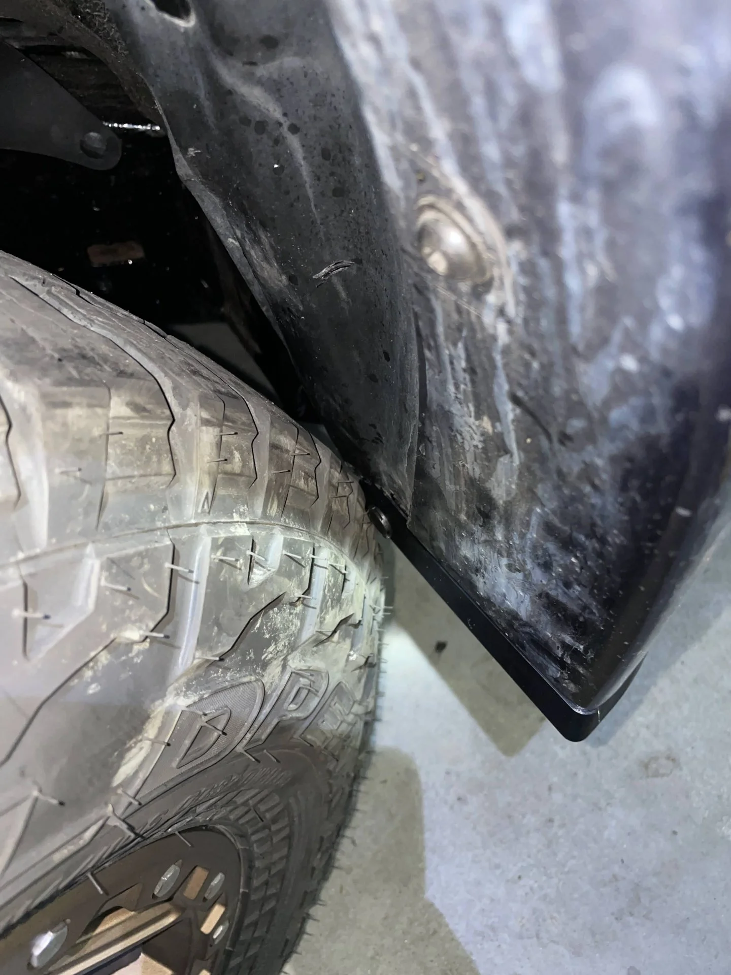

So it seems that clearing these 275/ 70s is tougher than anticipated.
The body mount chop on the drivers side wouldn't have to be readdressed if I did my homework right, but its a simple fix.
My question is how are people clearing the inner fender? (as seen in the 3rd pic)
I bashed in the pinch weld and formed the plastic but now it looks super close to touching further outward of the fender. I do have the 3d printed in caps on which arent helping. Just looks closer than it should be.

I trimmed it in the bottom front of the liner and pushed it forward. I drilled a new hole in the bottom to hold it forward with the existing screw
