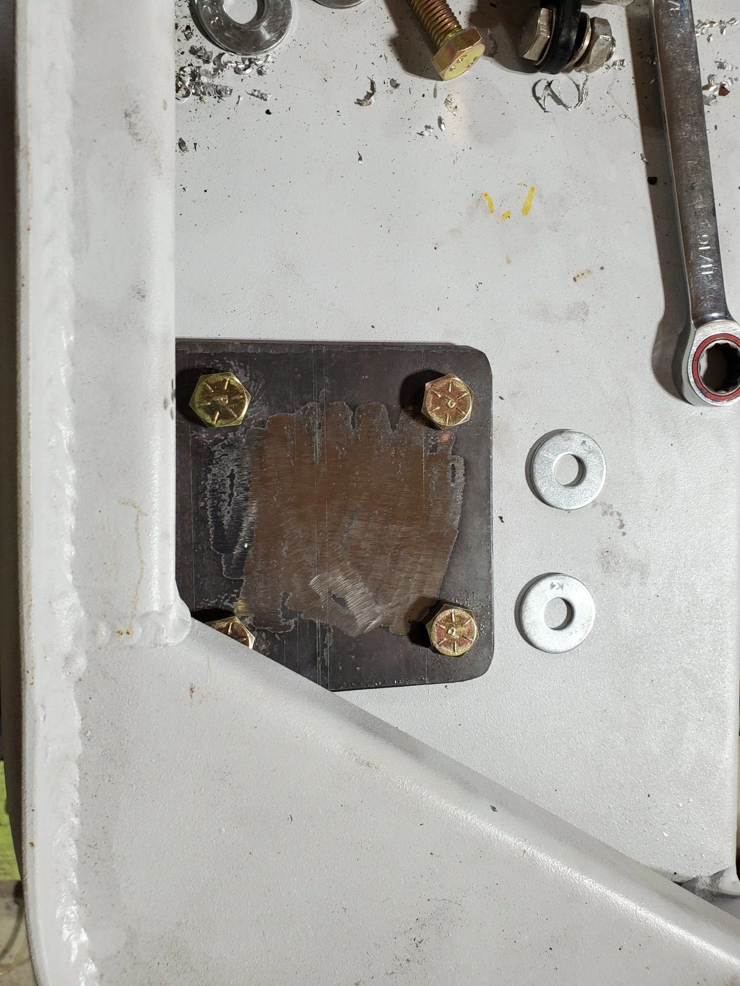

Homemade/Modified throttle pedal bracket. Just hugs around steering column flange but wide enough to give some side to side support.

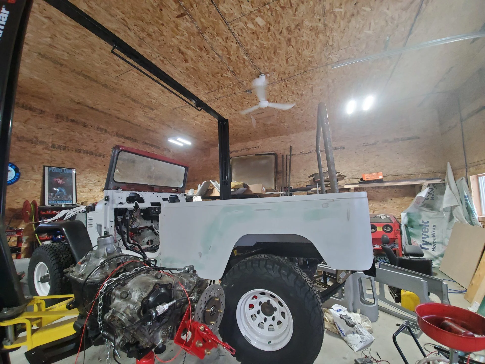

Chose position for rear roll bar.
I made the passenger side longer so that I can tie into the frame underneath and not interfere with my fuel filler neck.

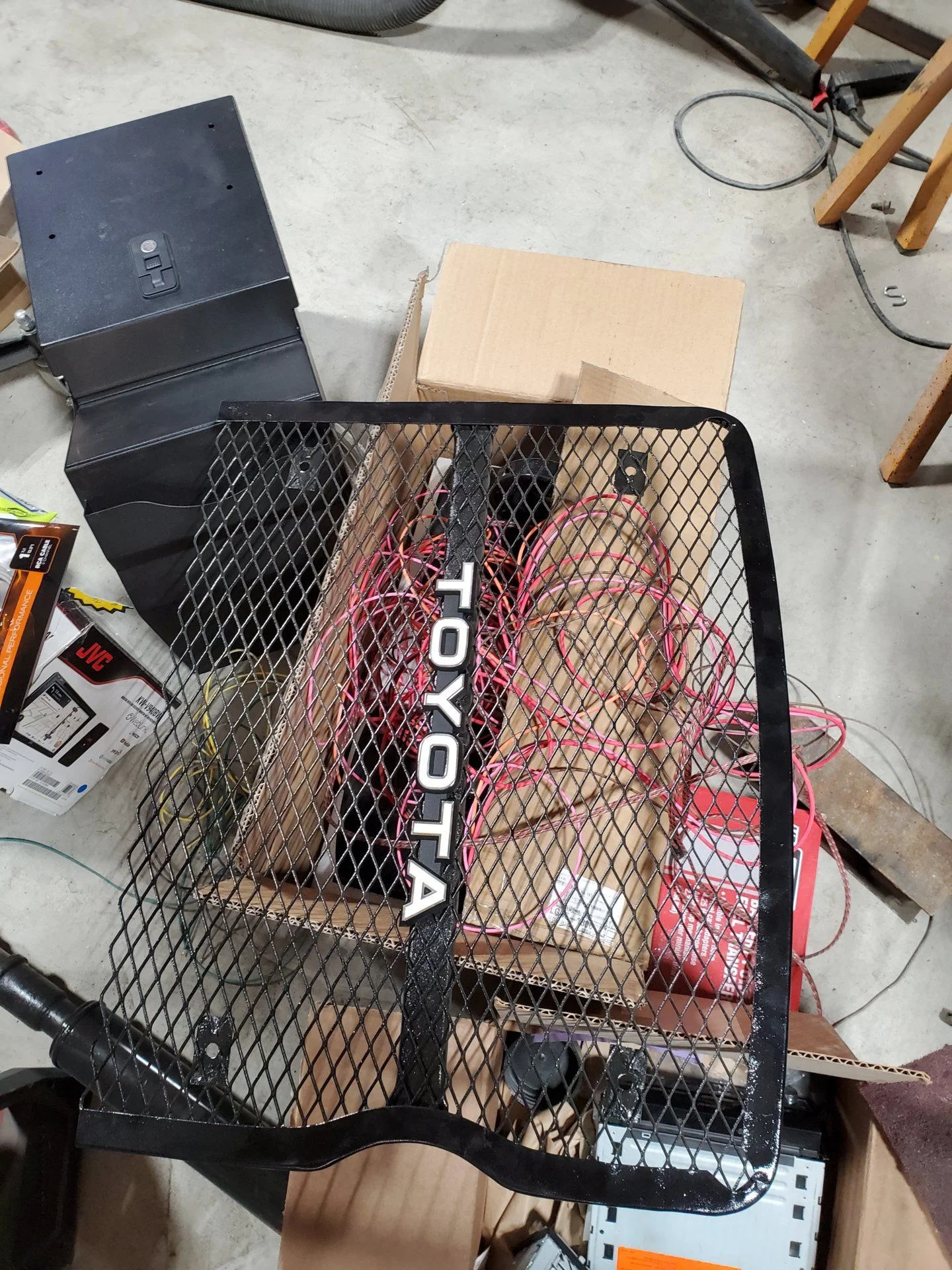

Grille:

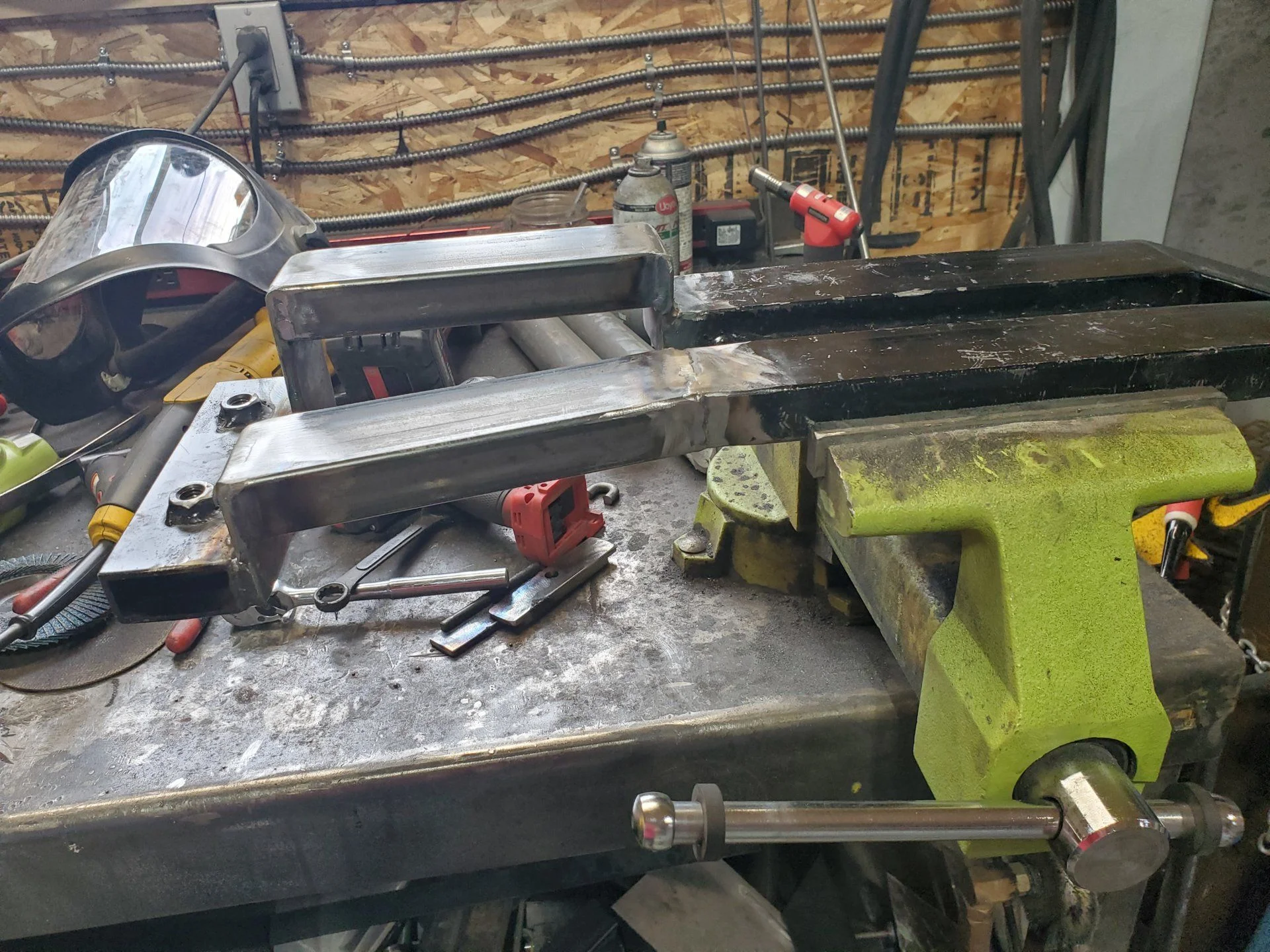

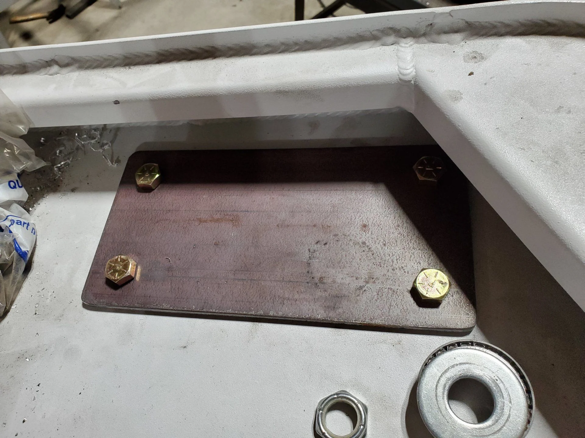

Crossmember 2.0, this one allows for a front driveshaft!

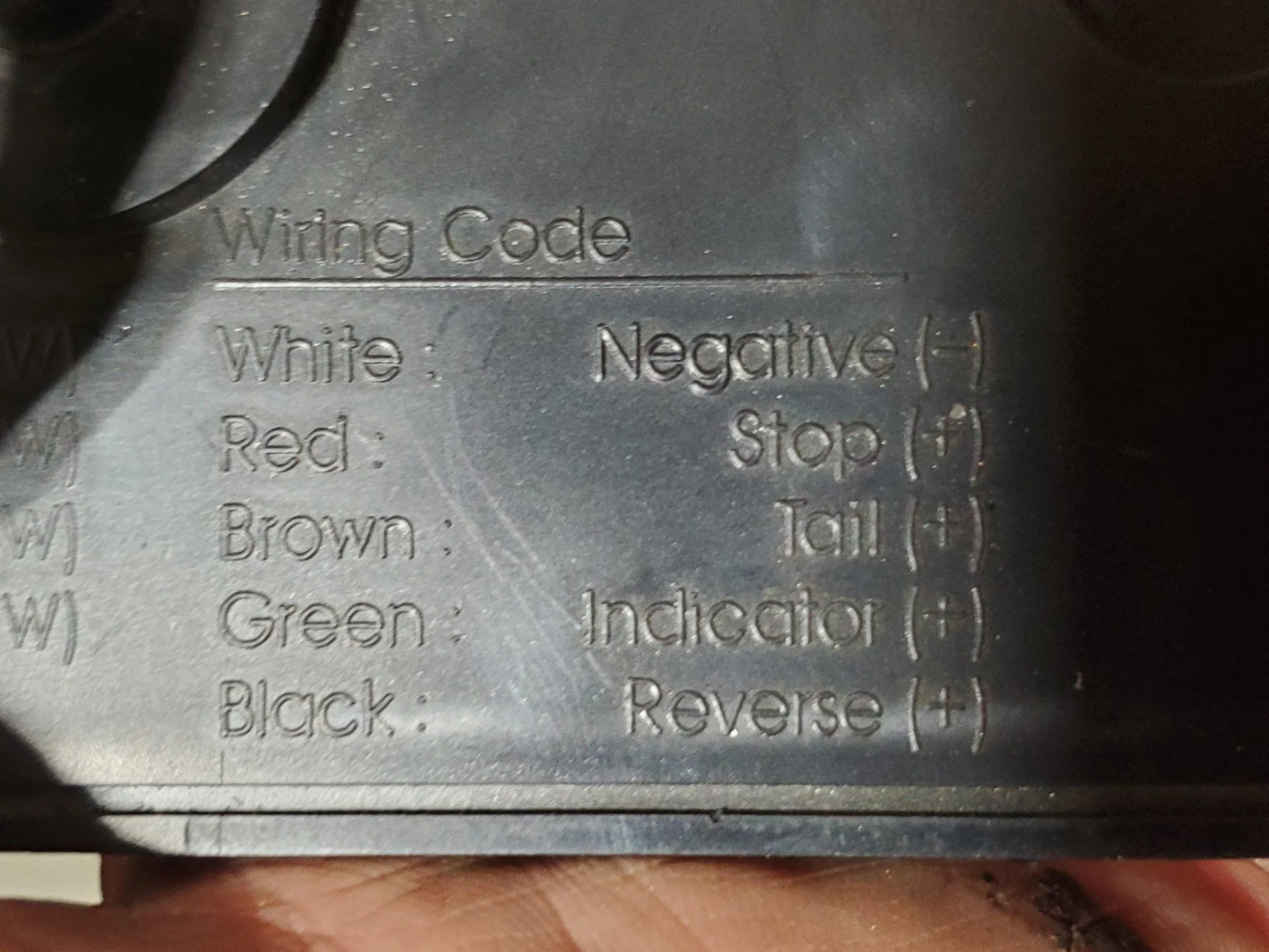

Wiring from Aussie Tail lights, Why they gotta do everything diffren??? @BenjaminCA

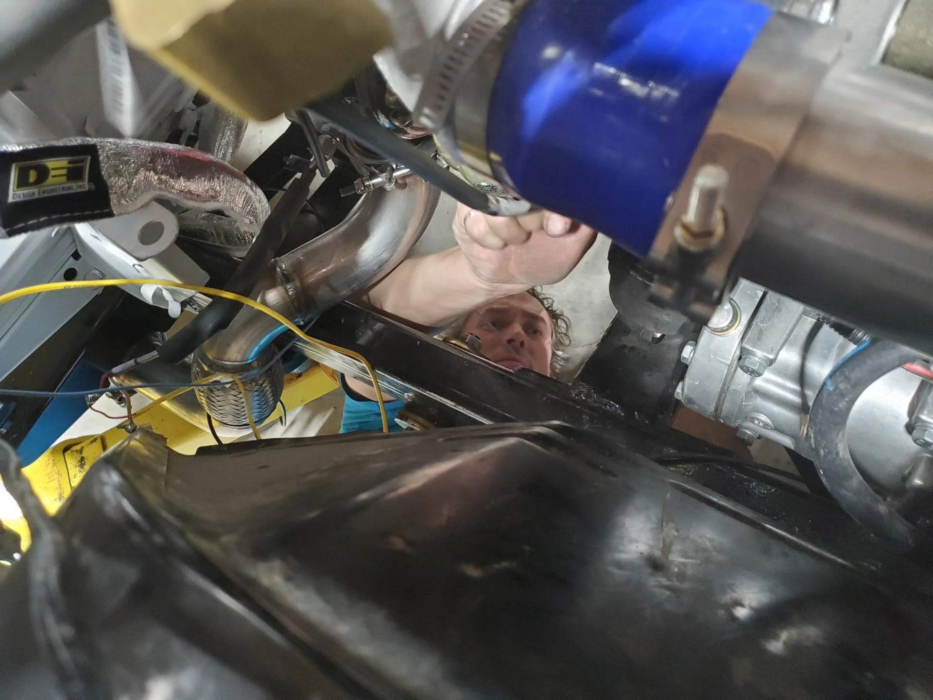

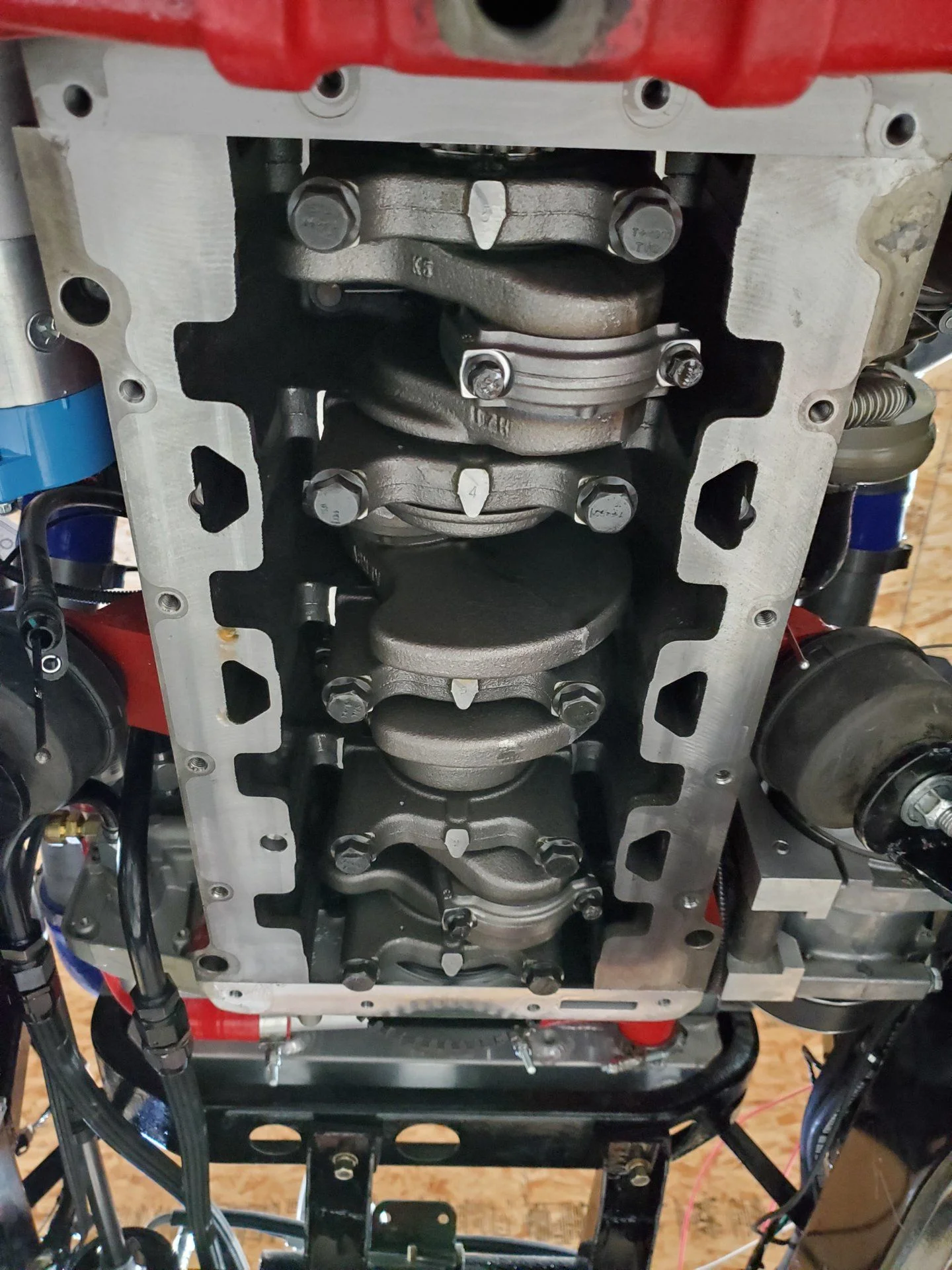

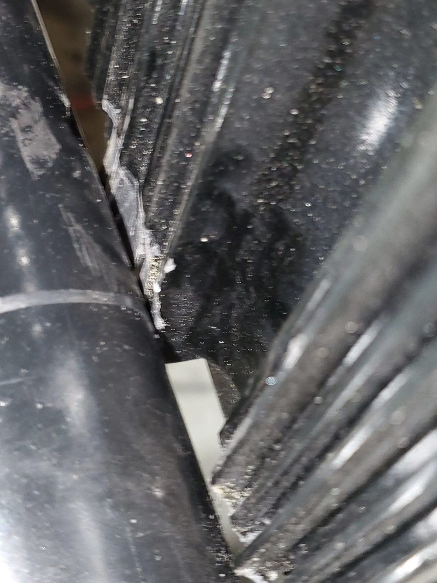

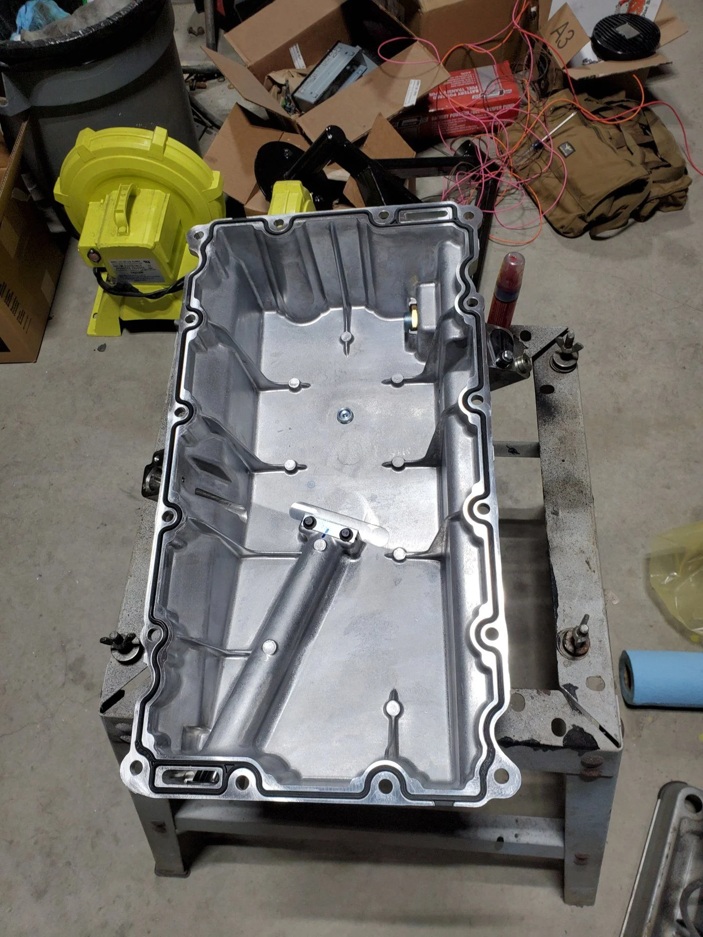

Discovered that with aforementioned front driveshaft the oilpan and the driveshaft were likely to become better friends than I would prefer.
This is after I burred off a few fins and with the truck at full bottom of travel, clearly not going to cut it.
So, a call to Cummins and 2 days later:
Unfortunately Cummins has no clue about any of this repower stuff. So these parts offered on the "R2.8 Shop Cummins" area have no drawings, no support, no instructions, etc. Got help from the facebook R2.8 Engine swap page. This pan is much narrower but deeper at the front, meaning I will have to double check the 3rd member clearance.

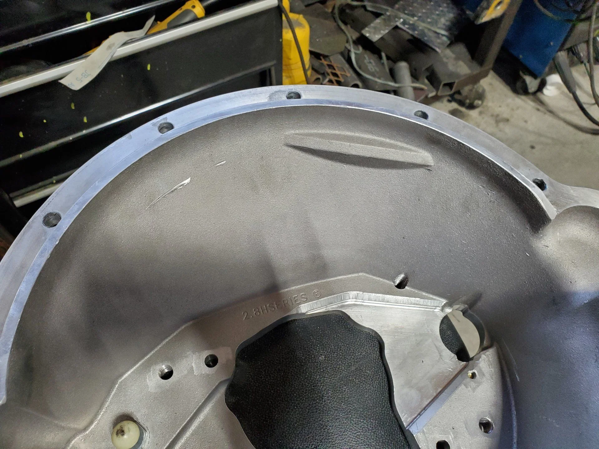

Thanks to @amico I discovered that Chad from Quick Draw discovered a clearance problem with the inside of the bellhousing and the clutch. I hadn't rotated my engine since I fried the battery with the starter so I had no idea about the problem. Unfortunately I had just that day installed my driveshafts.
Out comes the trans and tcase assembly along with the shafts.
This is what I discovered:
The clutch plate was getting stuck at that left scratch and just under the bump on the right.
Chad said that the clutch that he designed based on must have been lower profile than what some people bought. He reached out to everyone who had this bell and offered to send them a machined bell. To me that seemed like a waste of money for shipping AND I would have to wait around for it so I just made the clearance with a burr and a grinder.
That entire bump had to go and up to 1/4" x 8" of clearancing. Lots of grinding!!! but it is done.

Rear roll bar tacked in. It looks weird that it is on an angle but the boss and I agreed that it should follow the angle of the leading edge of the curved window.

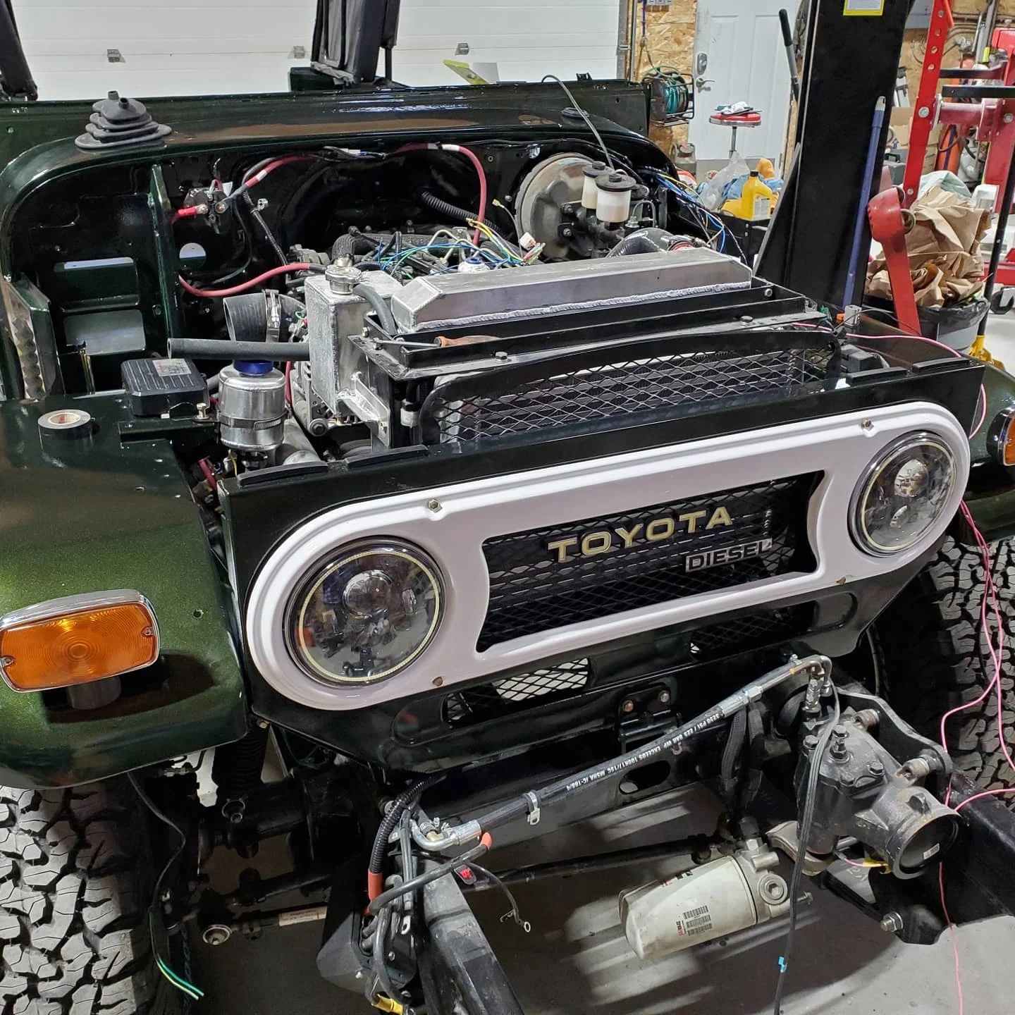

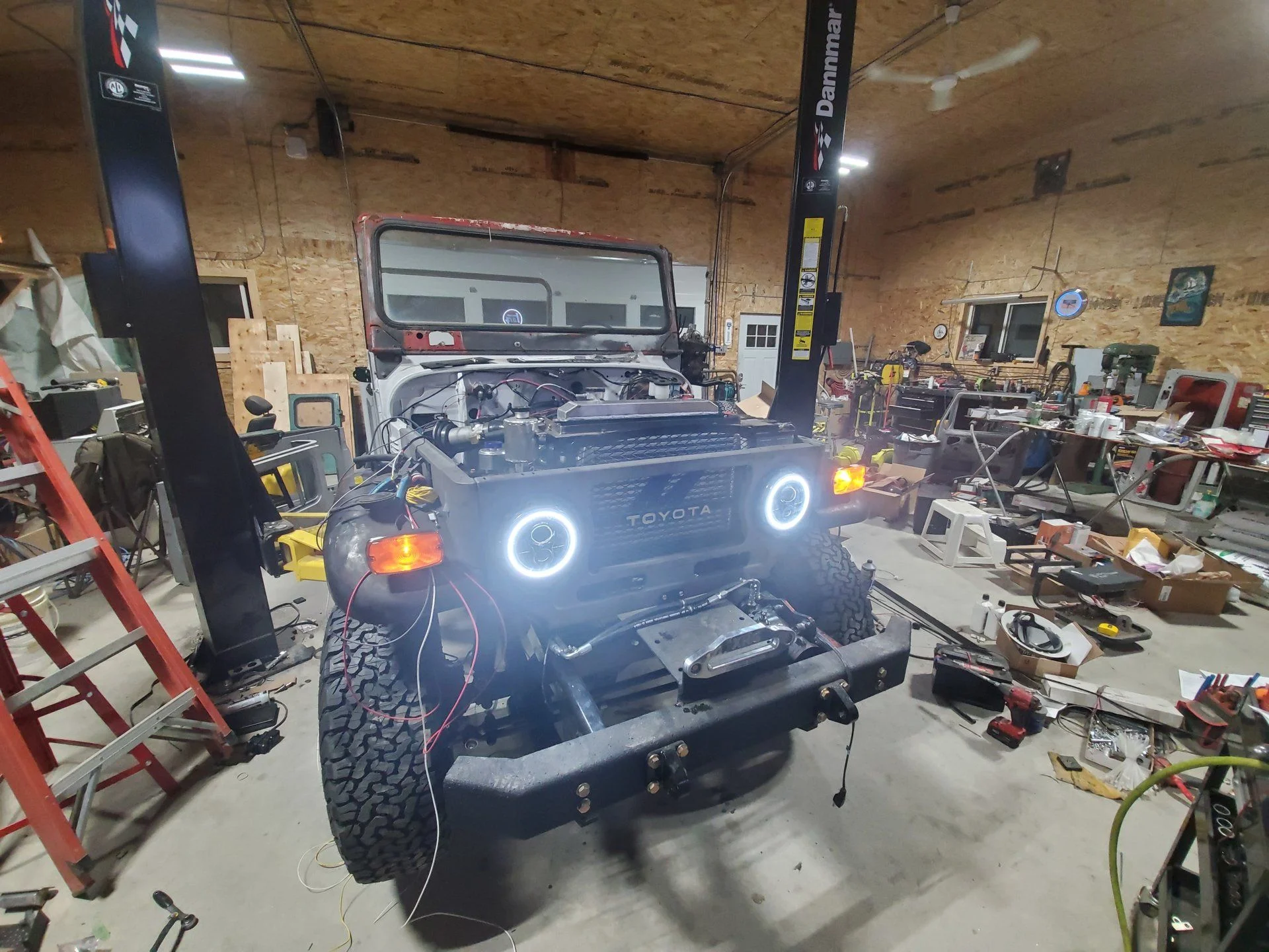

Eyeballs and park lights. Yes, I know the driver's side is the turn light bulb, this has been switched now!
Note the Mishimoto M on the intercooler hiding in the background, I kind of love that!
Power steering lines running behind the winch.

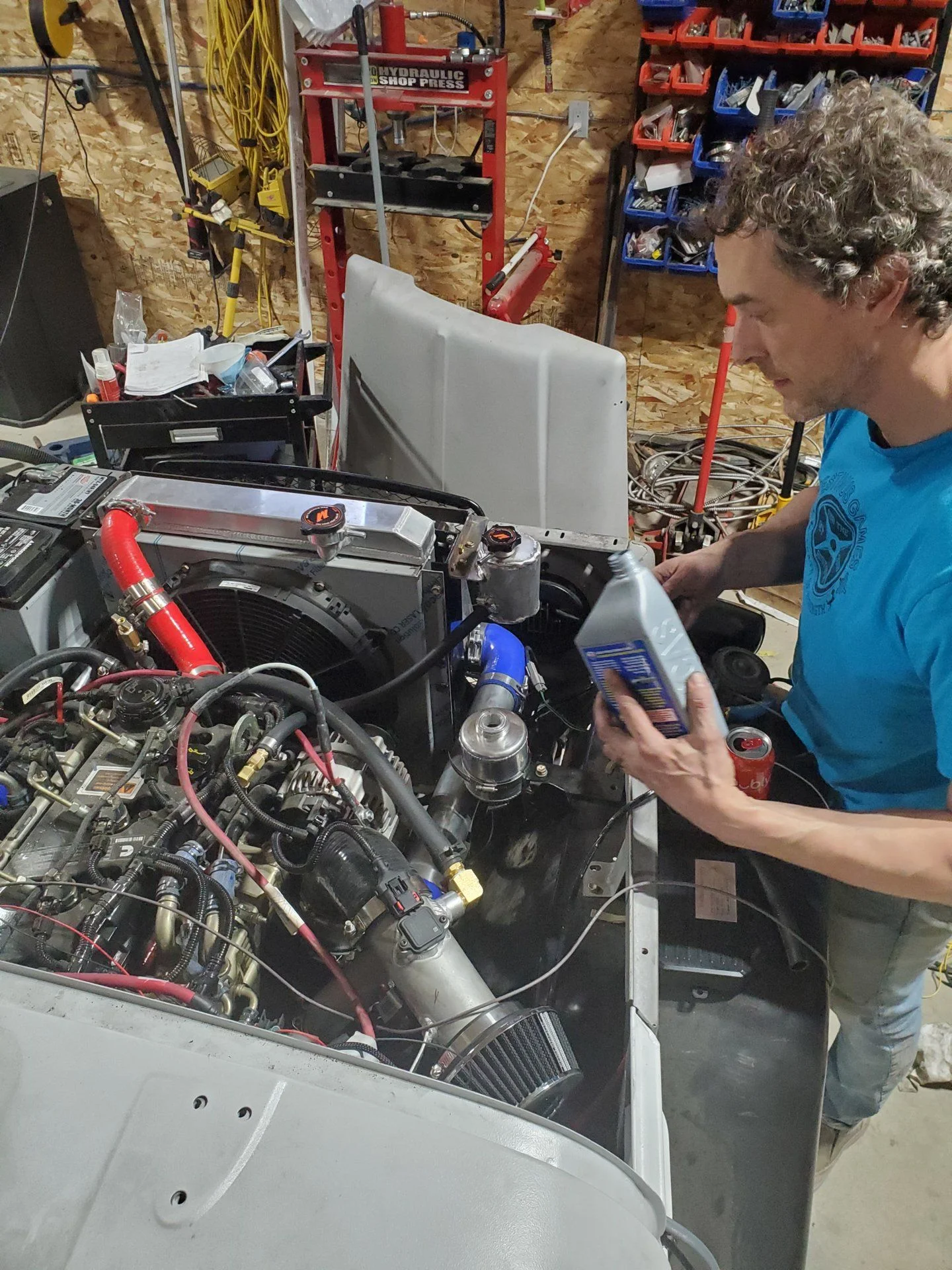

PS fluid going in. I went with non-ATF. couldn't find good answers on which to use. Seems liek the engine is new enough to want the new stuff.

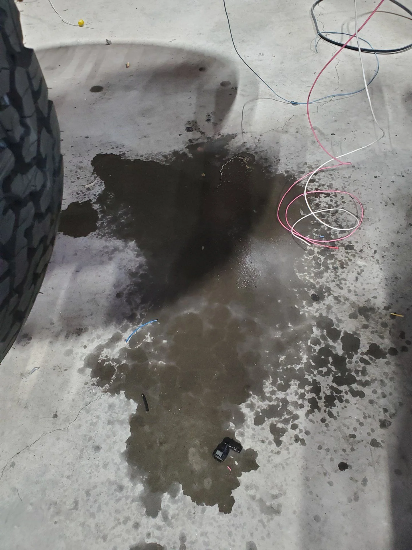

In the morning I read the install guide and learned about the hand priming pump in the fuel filter housing. Once I pumped it up (SNL reference), this happened:
As I mentioned Cummins proper knows nothing of these engines and parts. It had taken me about 4 months with a Cummins parts guy in Winnipeg to get that connector lying on the floor there, including one pair that I ordered, were wrong and had to return. This one was slightly too big and fuel sprayed all over the place.
I had the straight connector to use instead that did fit but its not as nice as a 90 would be.

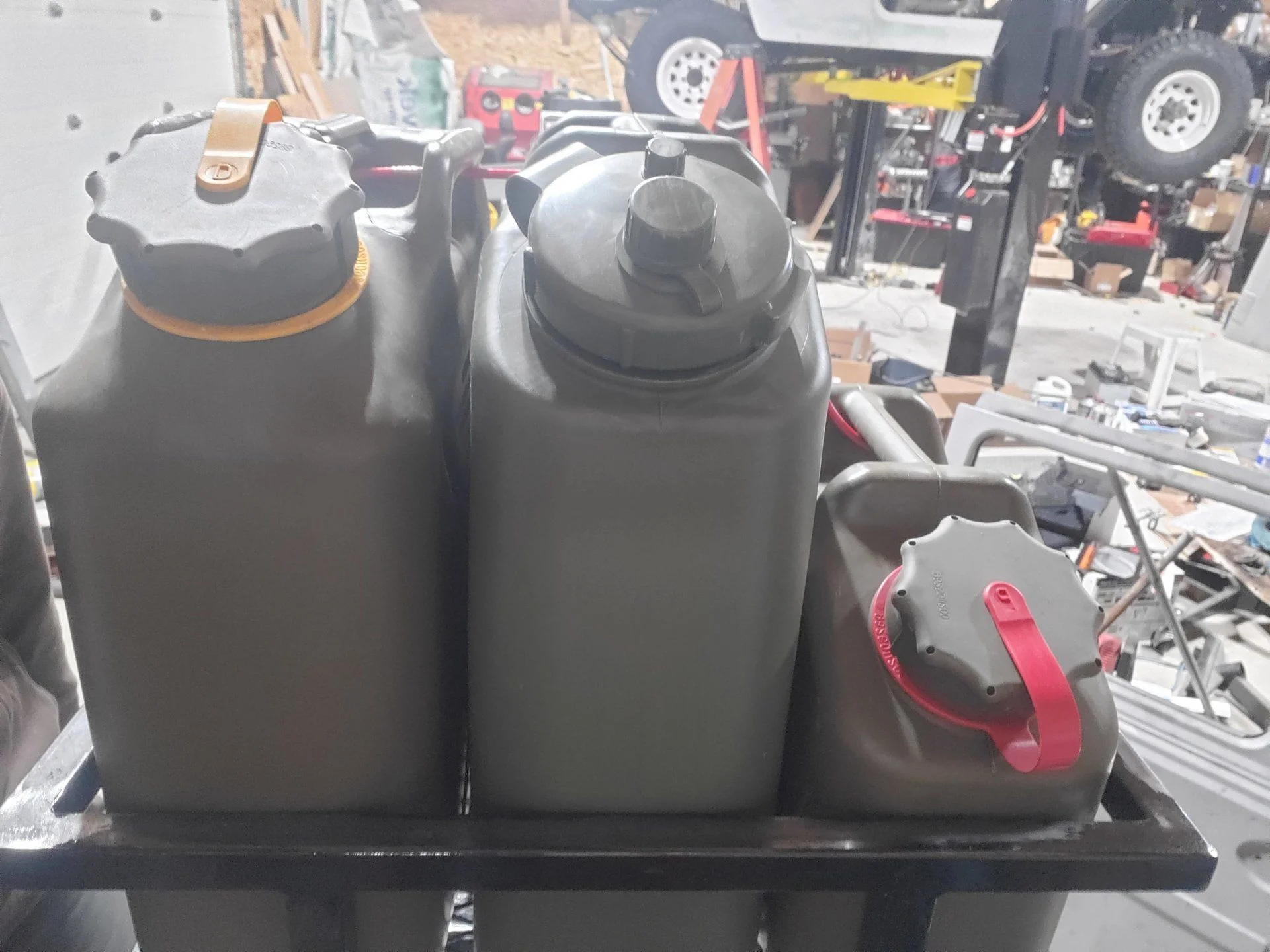

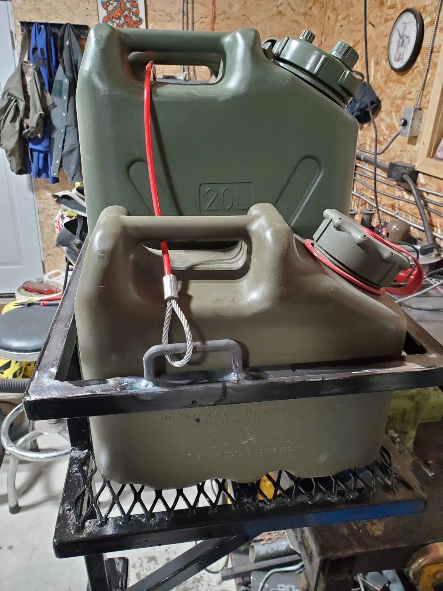

I did some more stuff on the basket too.
It has a custom made cable to lock them down and a bar to attach a ratchet strap for tightening them down.
Tigged the bars on, this one with the cable inside.
I put the lock ring on the underside so it wouldn't be banging and clanging into anything going down the road.

My problem wasn't on the water sensor, it was the one that connects to the fuel pump from the fuel filter housing. That one is a little smaller than the ones on the fuel filter housing. They only provide a straight version of this connector.

Yeah, feels right and all but in my setup I would really prefer a 90 there. Not the end of the world but I searched with all kinds of suppliers just based on sizes vs part numbers and no bueno.
