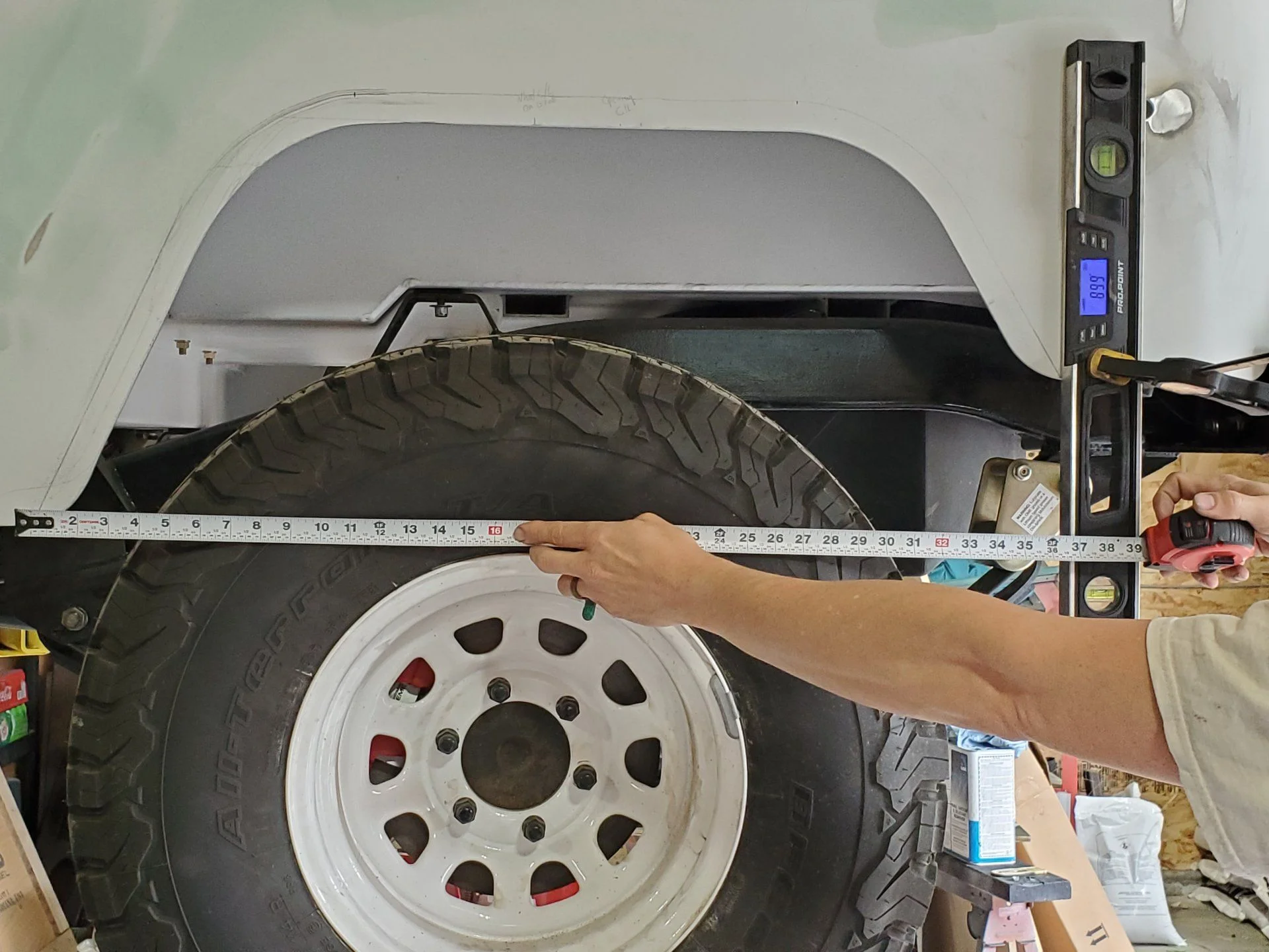

I think I mentioned it before but the wheel location in the Aqualu opening was not correct.
Way too far forward.
I worked with Rene at Aqualu to get a DXF file that I could use to offset the original curve forward and then printed it out 1:1 at a print shop in town. I tried 2, 2.5 and 3" offset. I ended up cutting it to 2.5".
I know a 40 wheel is supposed to be a bit forward so I was happy with this.

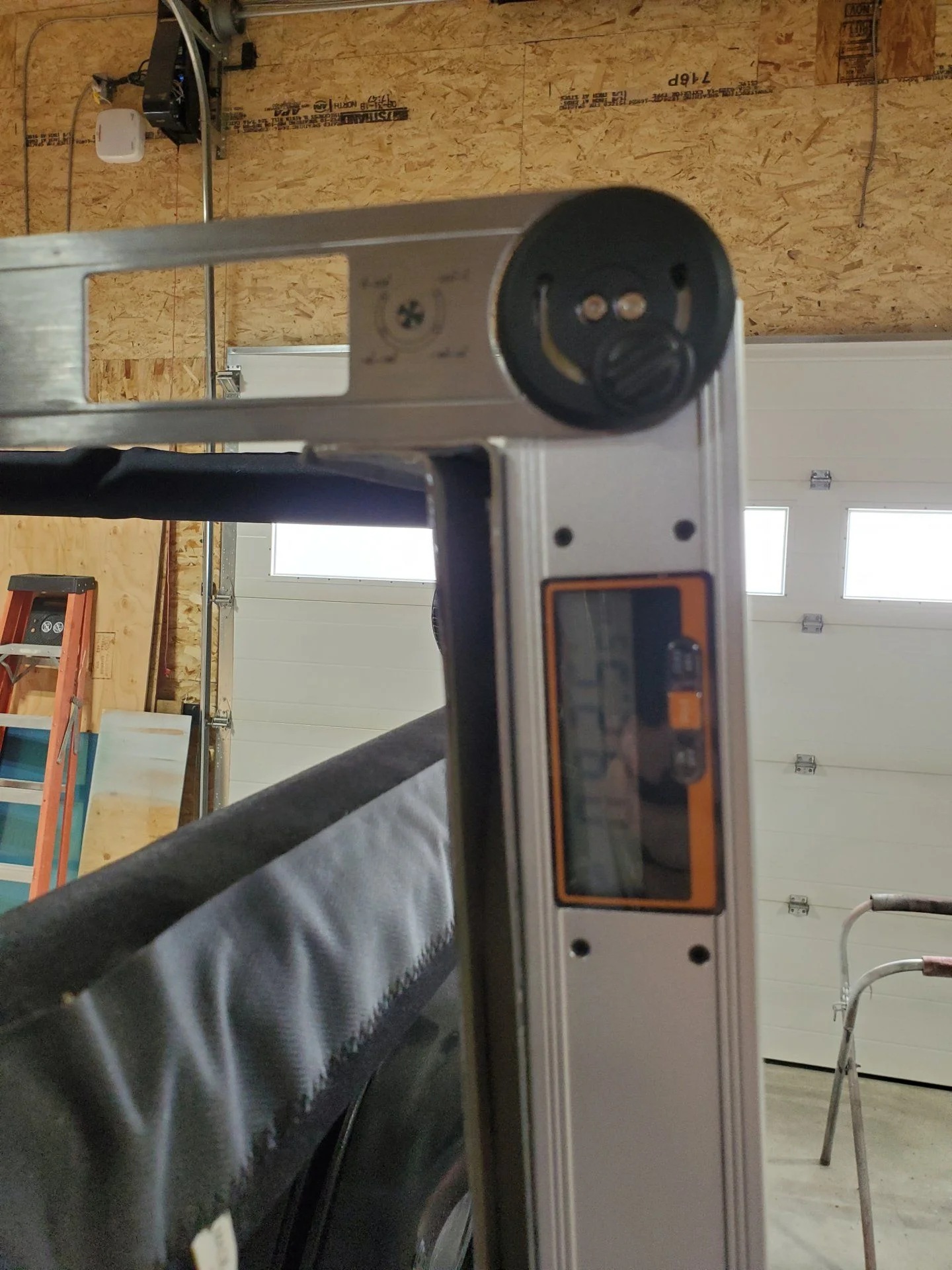

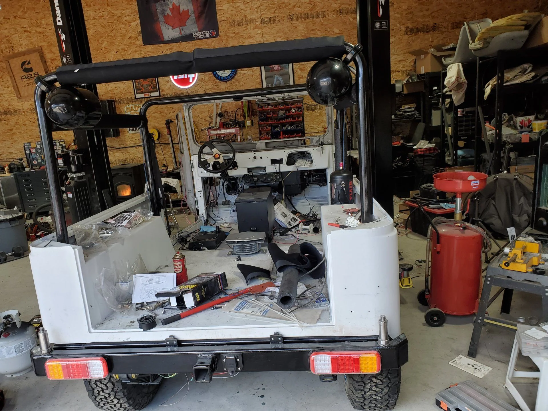

I bought a new welder (MIG only as I have the Synchrowave for TIG Rebel EM215i, nice machine) Anyway this is the roll bar design I came up with. There is a slight forward angle between the rear 1/4 window and the big window so I tilted the rear bar to match and hide between the windows.

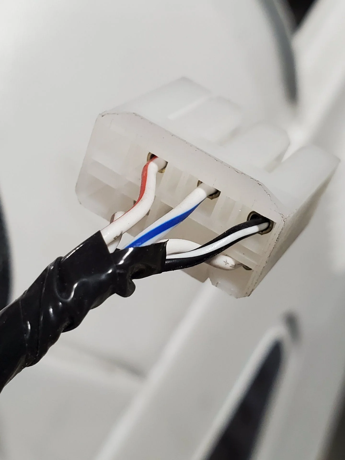

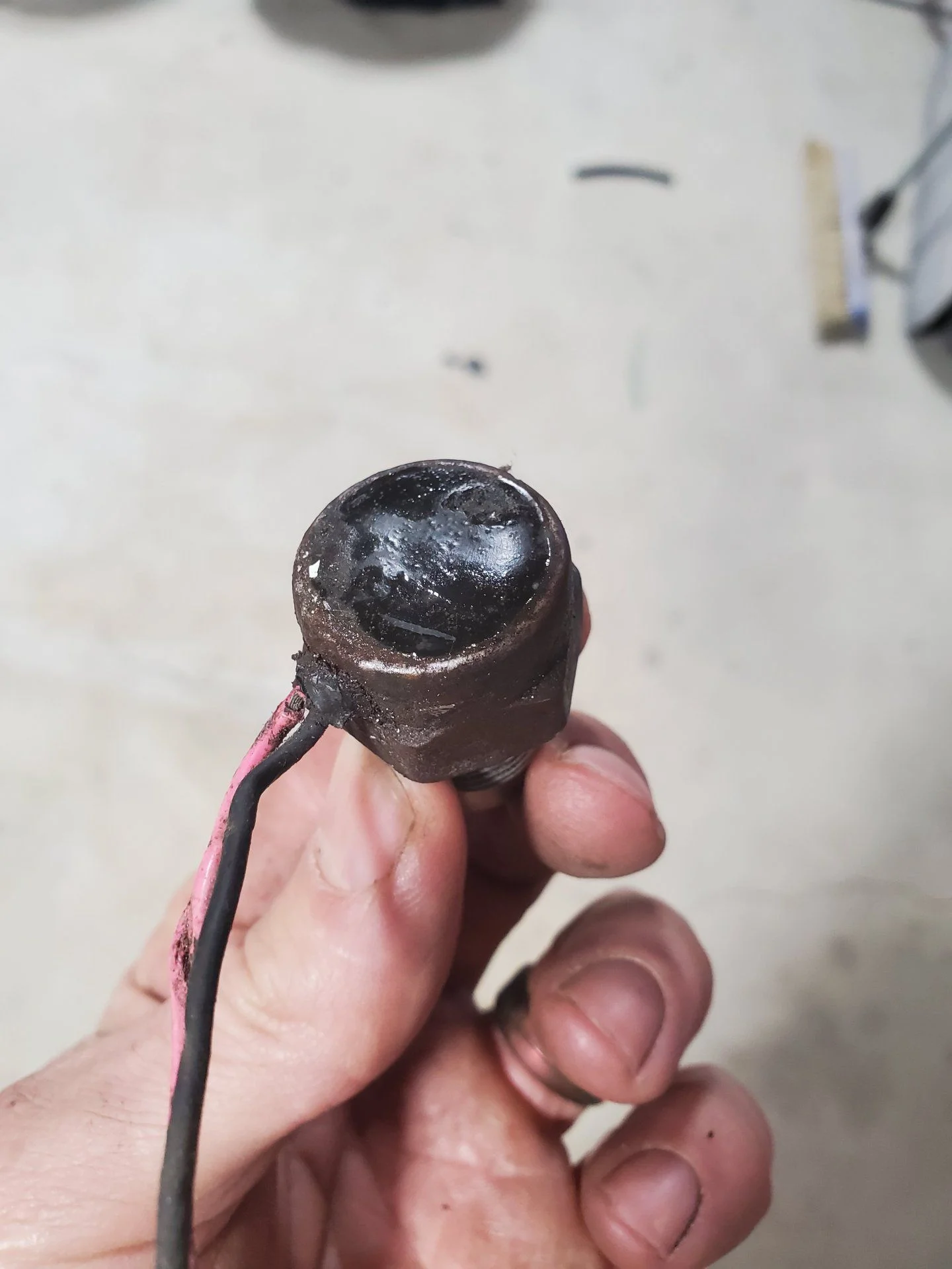

The wires on the 4wd switch are a serious joke. I have 2 now that are messed up. I think I might try to get the epoxy out and fix one.

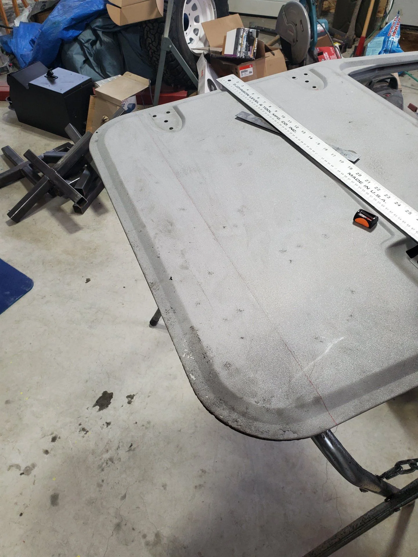

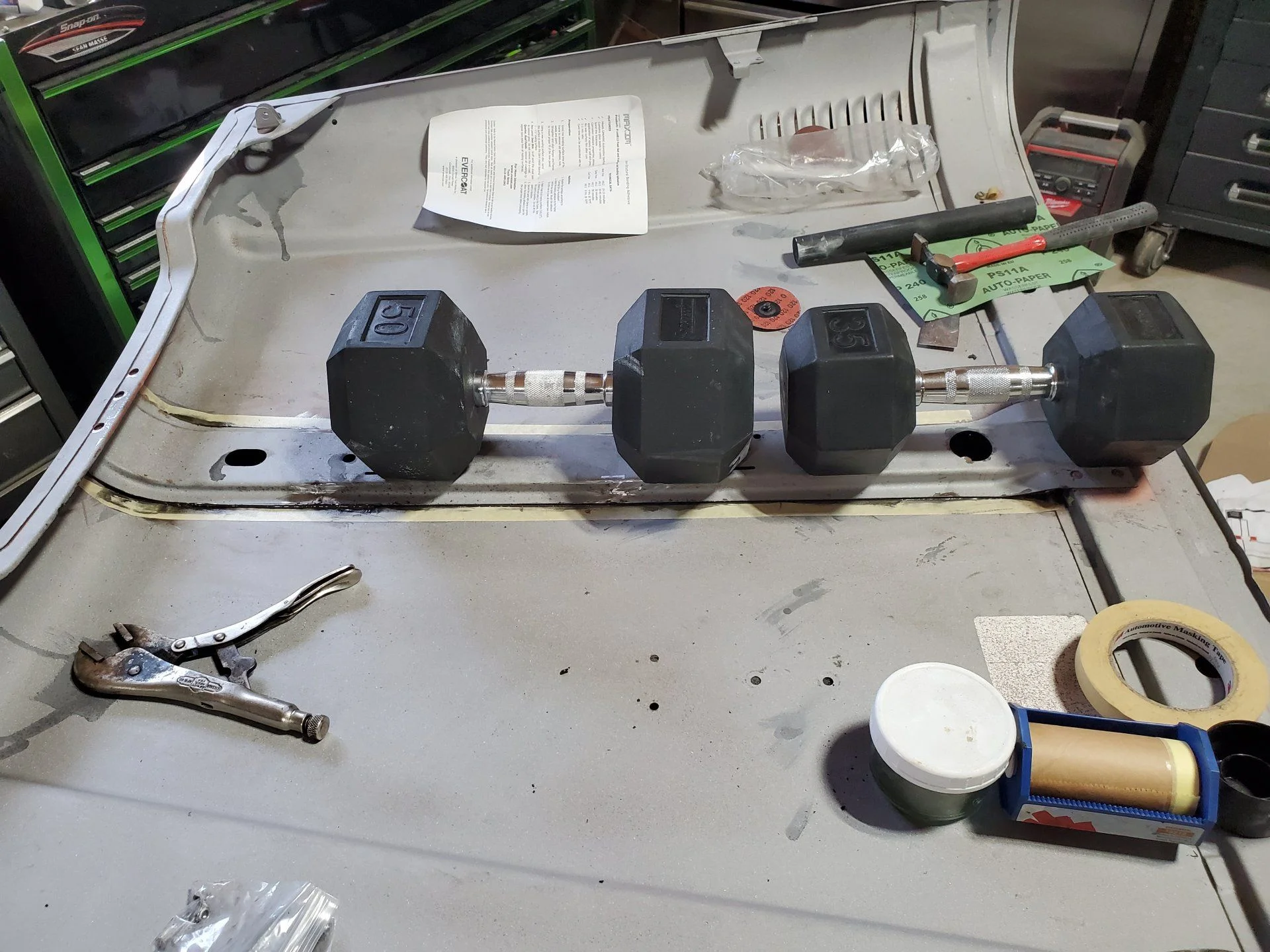

I tried to panel glue the hood support to the hood skin.
It eventually popped off so we just put seam sealer under the edge. I did reweld it into place though.

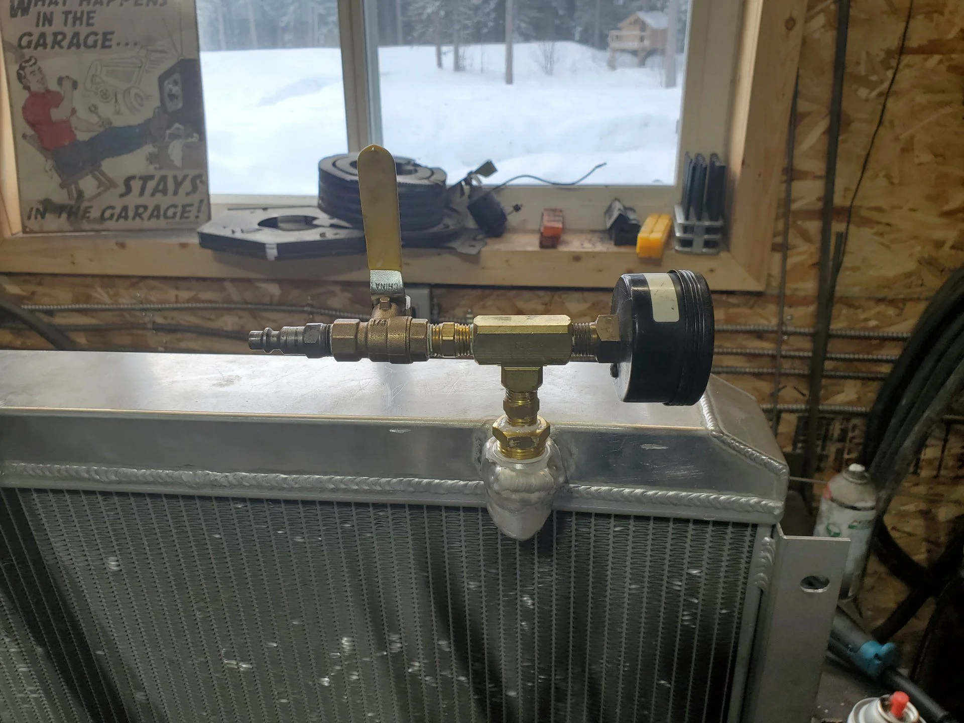

Filler neck on the Mishimoto rad hit the hood, so I had to change it to just a bung.
Pressure testing the Rad.

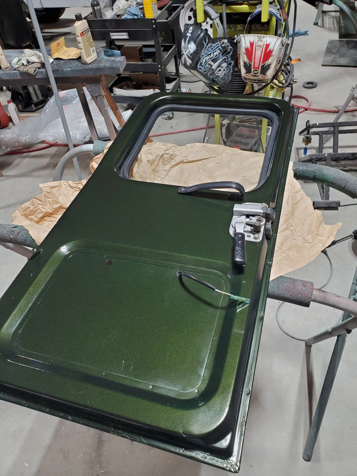

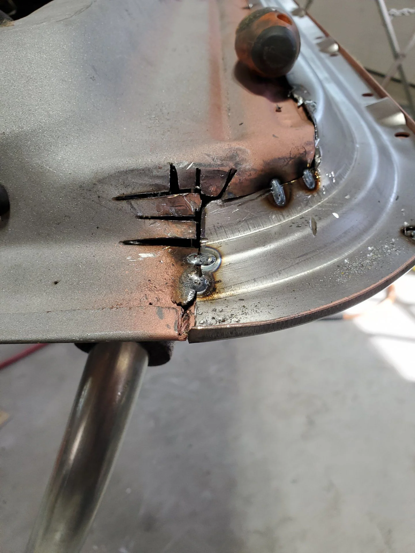

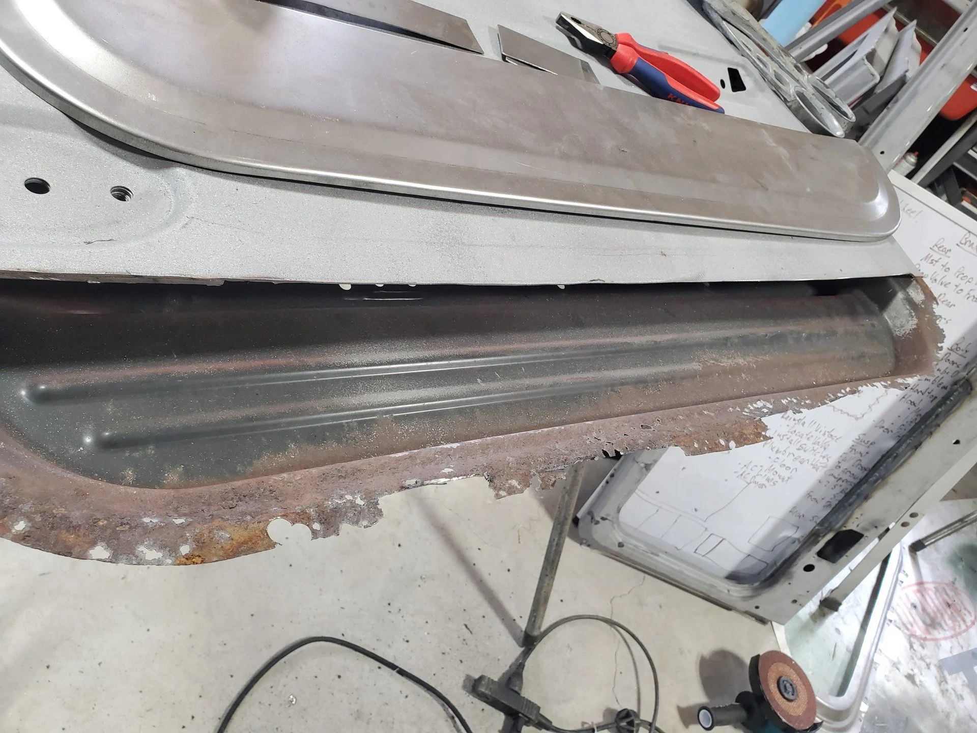

OK, the doors!!! Ugh. The real Steel Cruiser parts are great, really nice pieces.
so, Cancer treatment:
More.

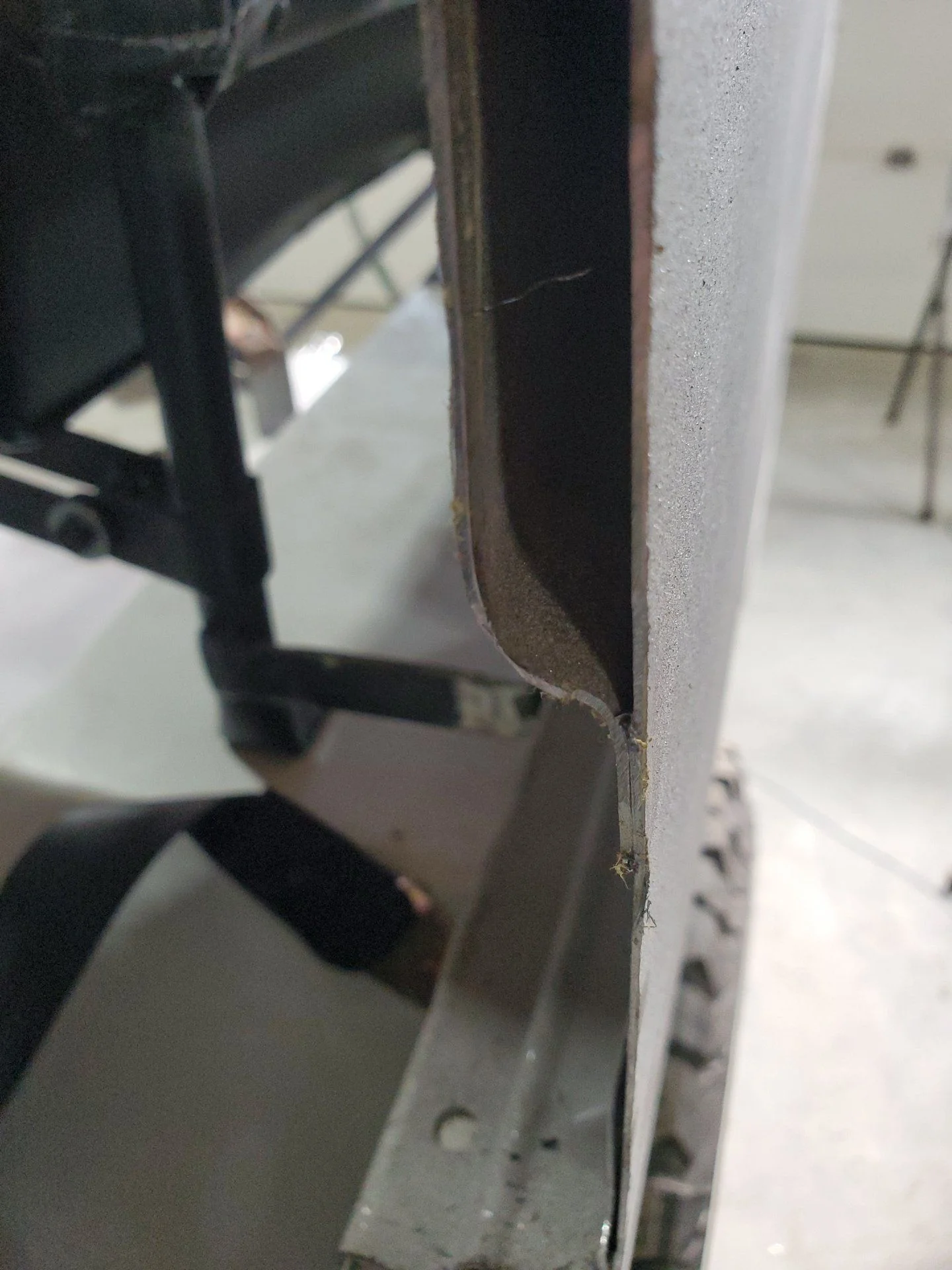

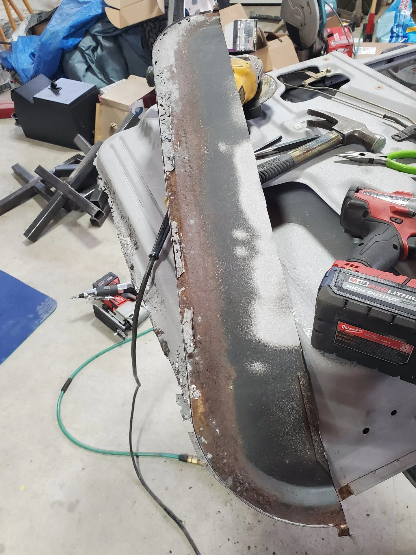

As soon as you cut off the skin, this happens:
This is near the top of the lower door:
This got frustrating so we will come back to it.

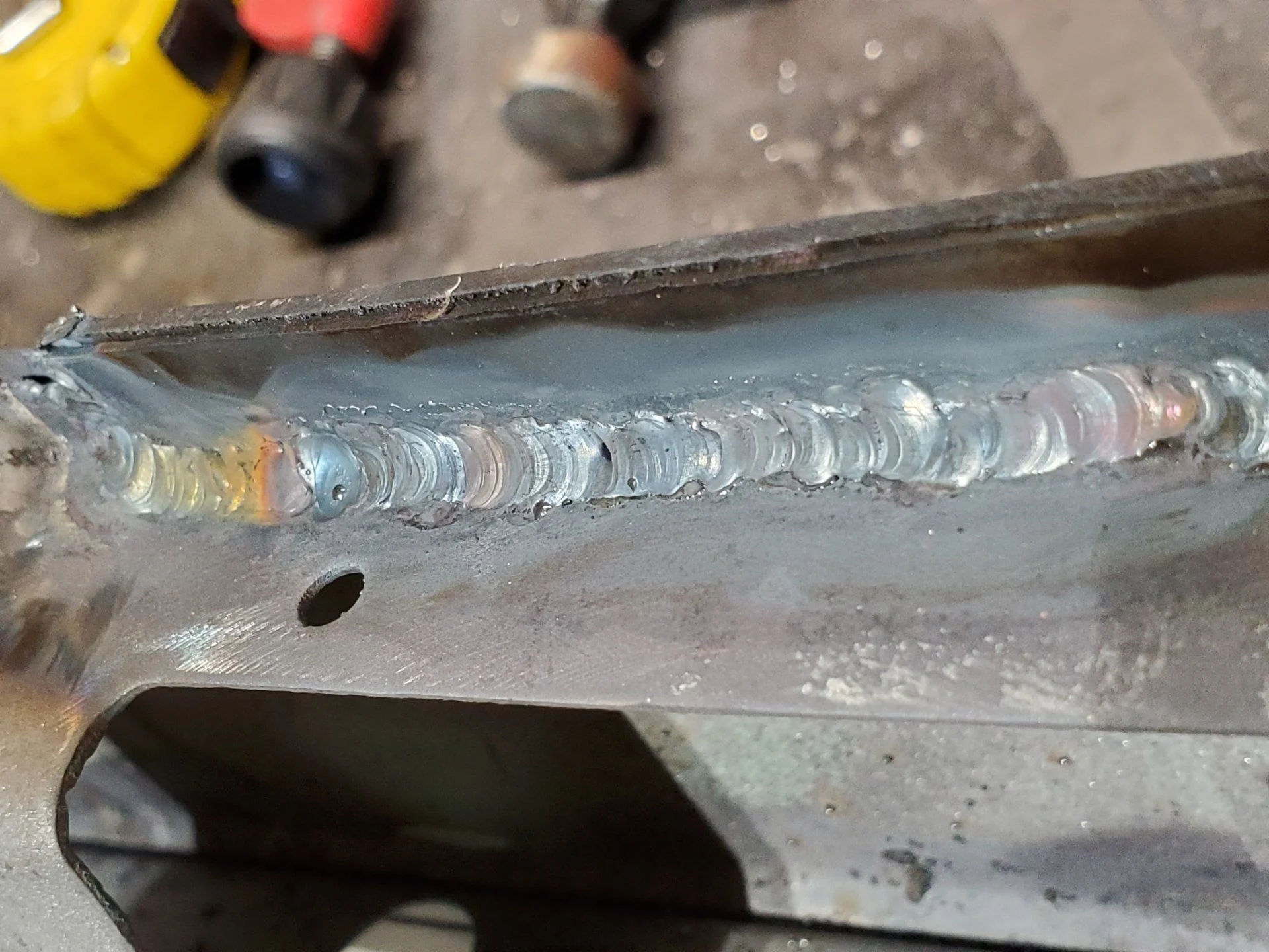

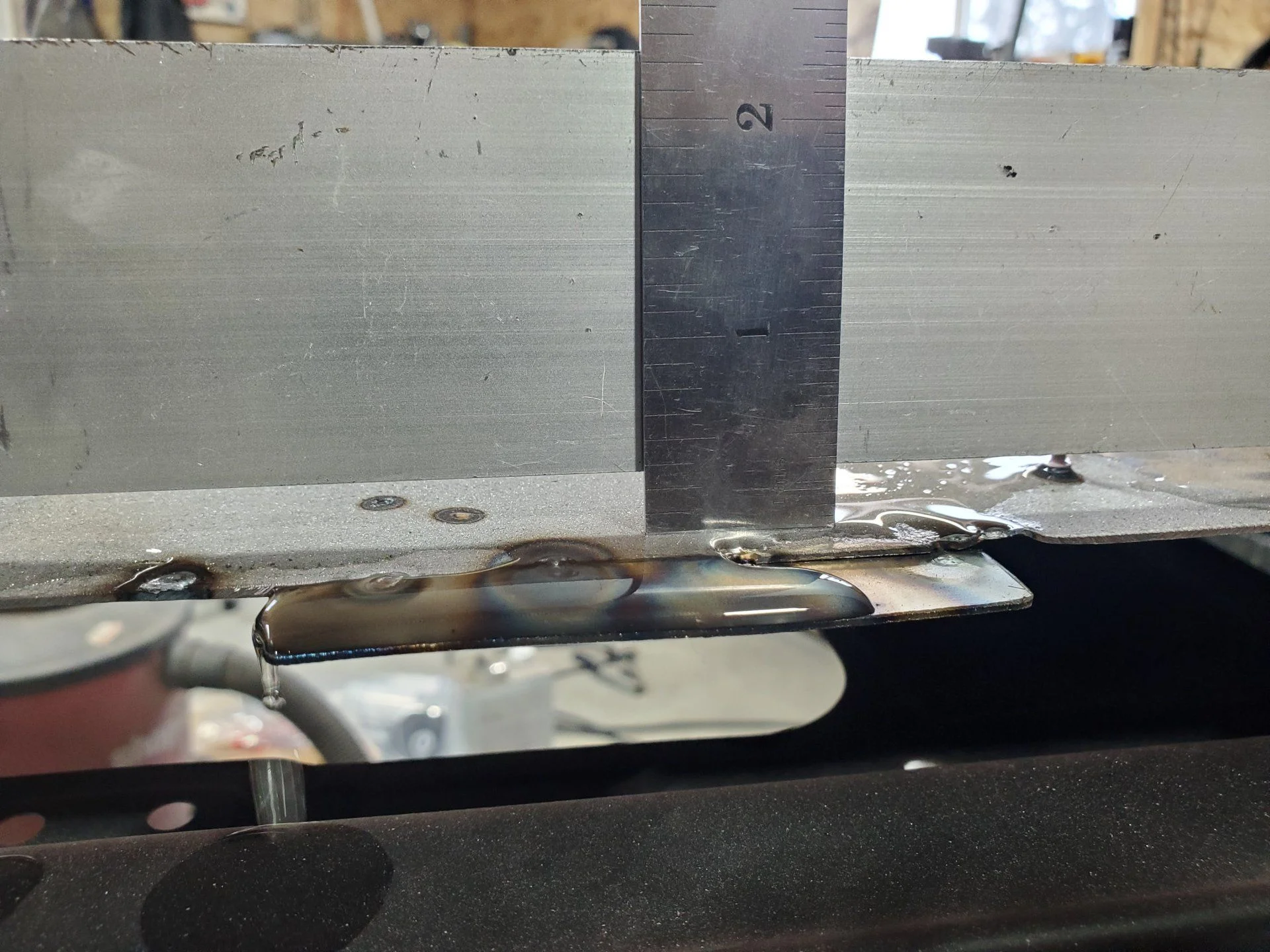

I repaired the windshield lip that was rotten. I decided to TIG it so I could control the bead better, not a lot of space to grind in there!

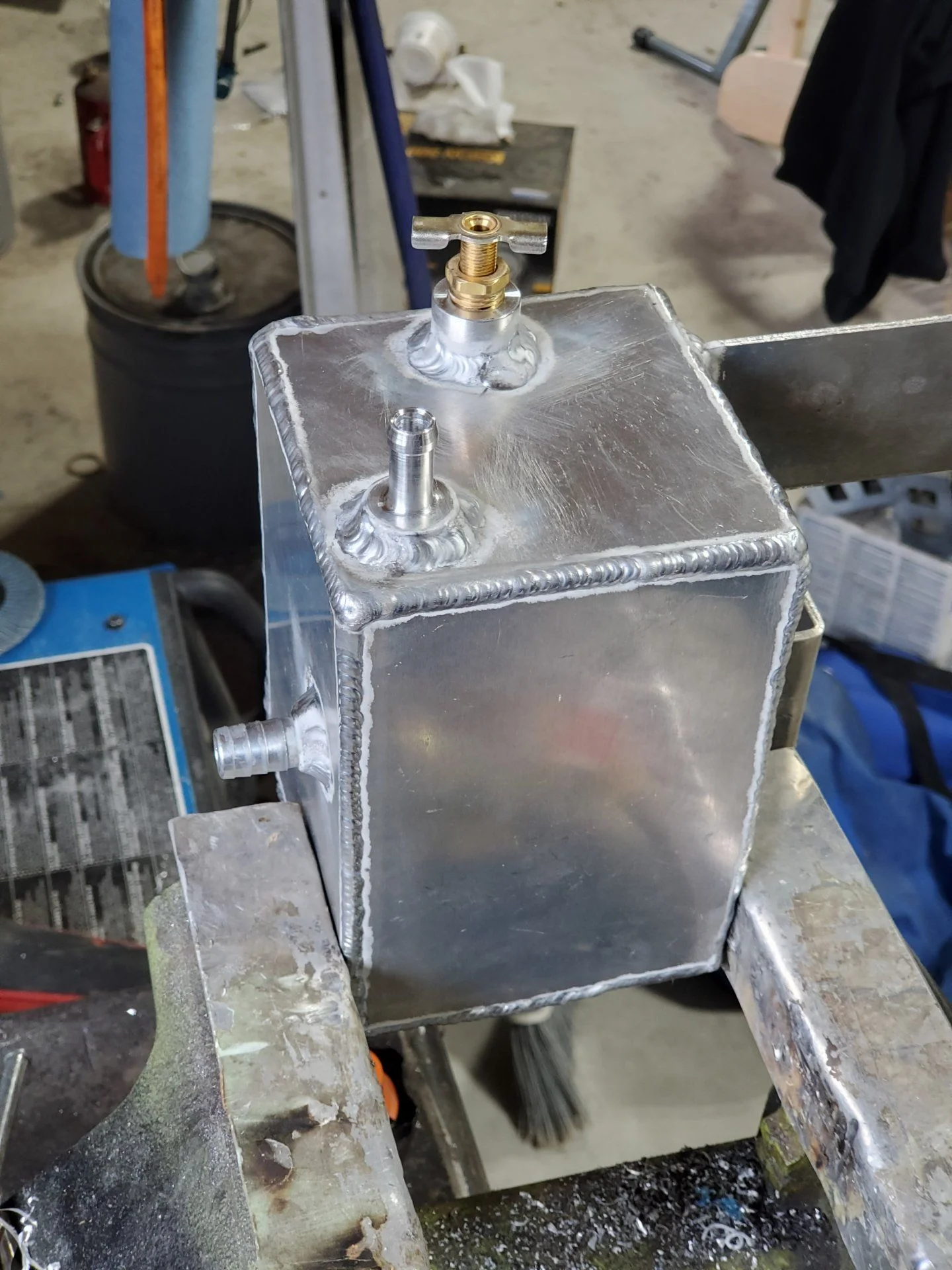

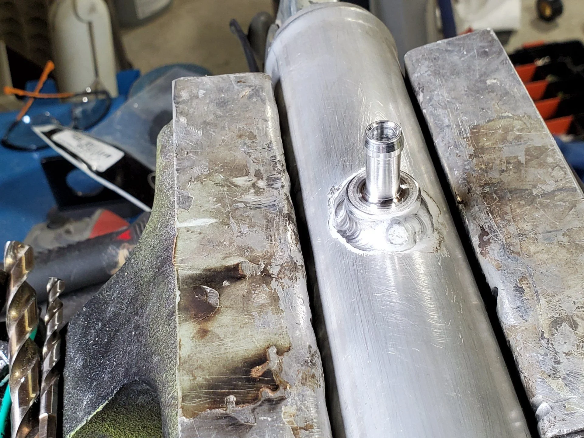

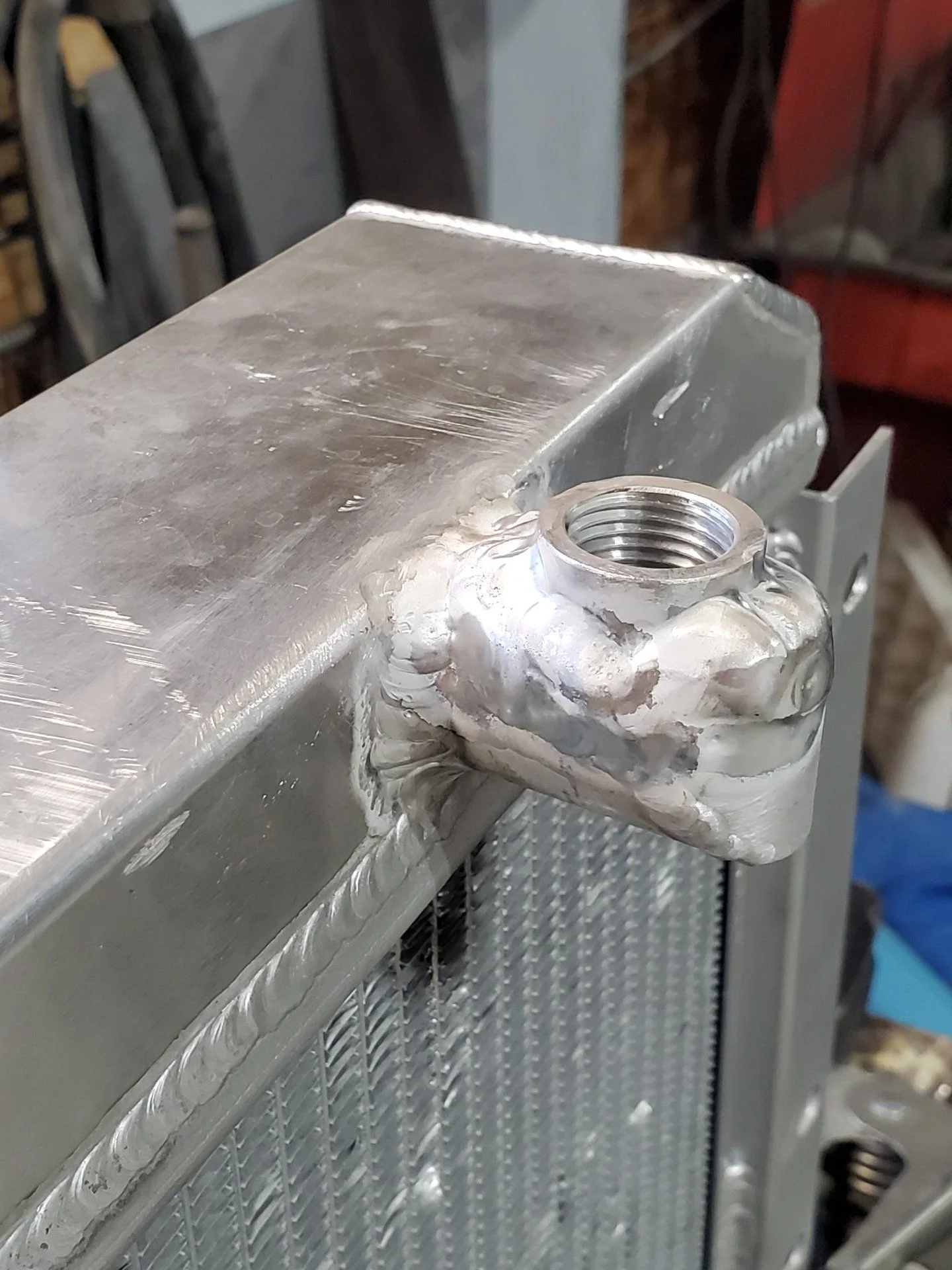

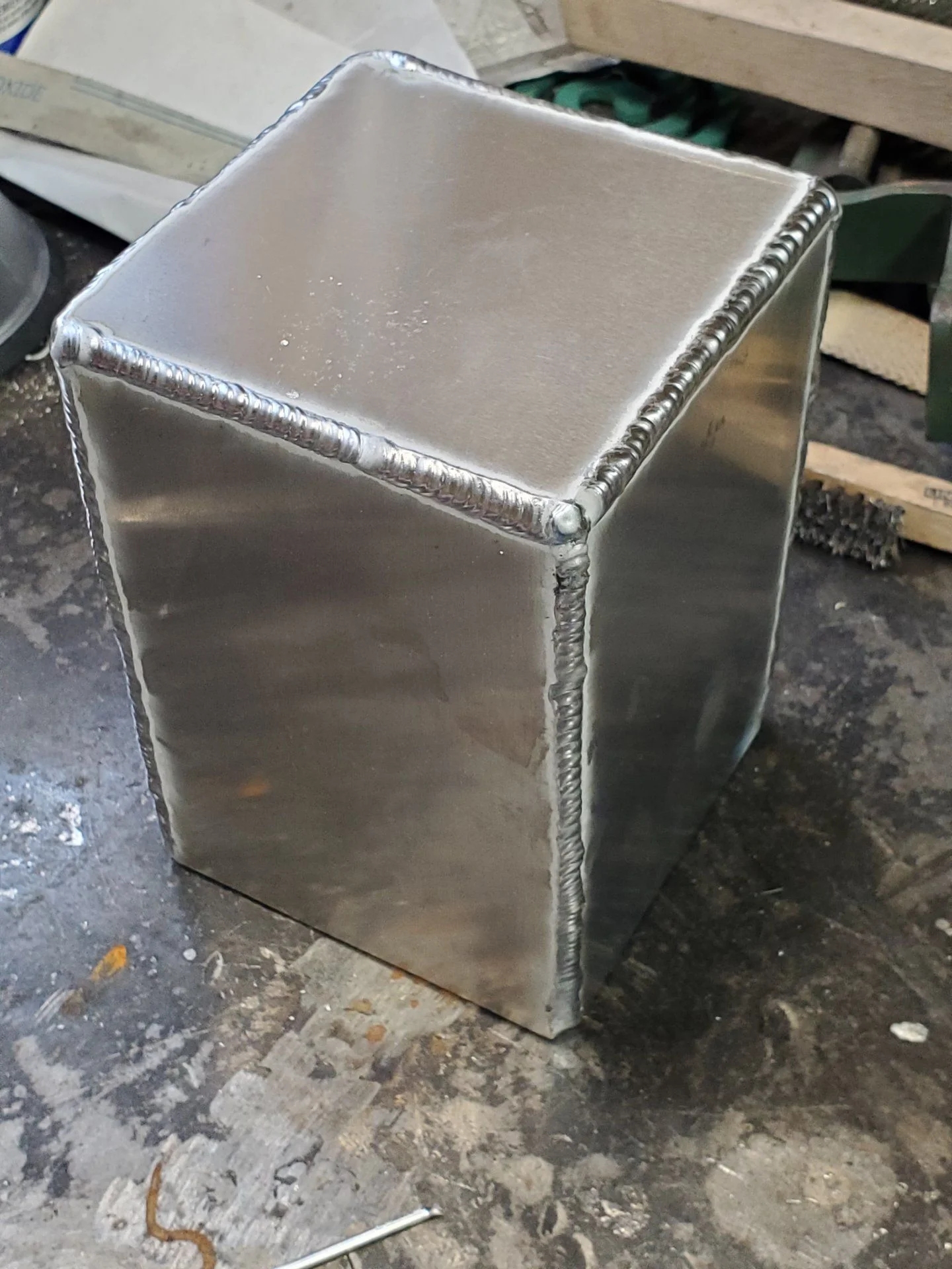

I really struggled to find anything premade I could use for a coolant catch can. Everything I found had ports in the wrong place or some other issue.
I ended up making one with a piece of 3" Al pipe.
This is early into my Al welding practice!

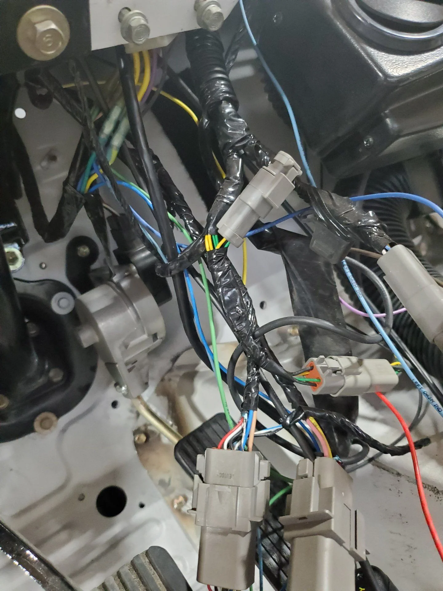

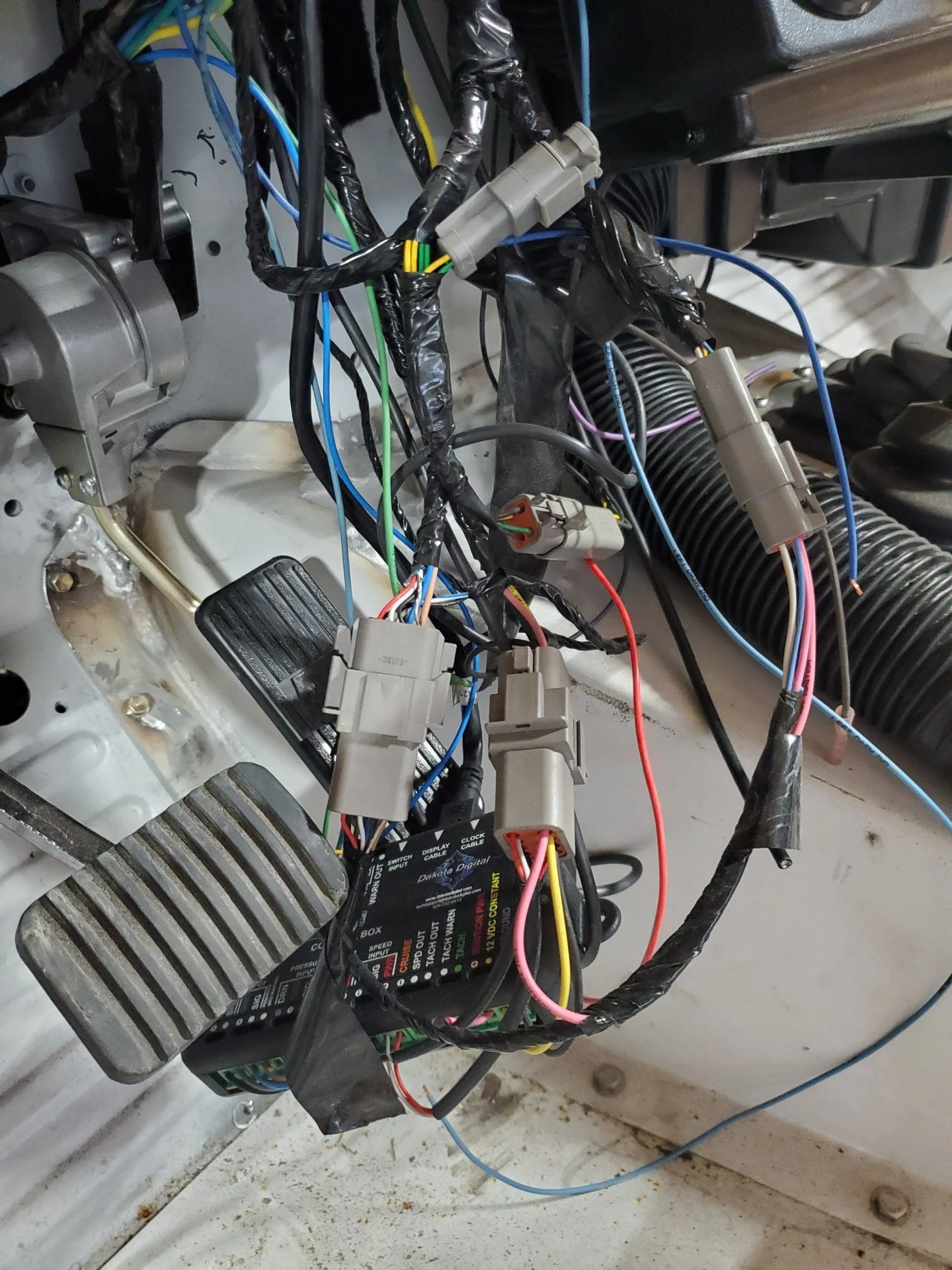

The wiring for the Dakota is a major PITA to keep tidy.

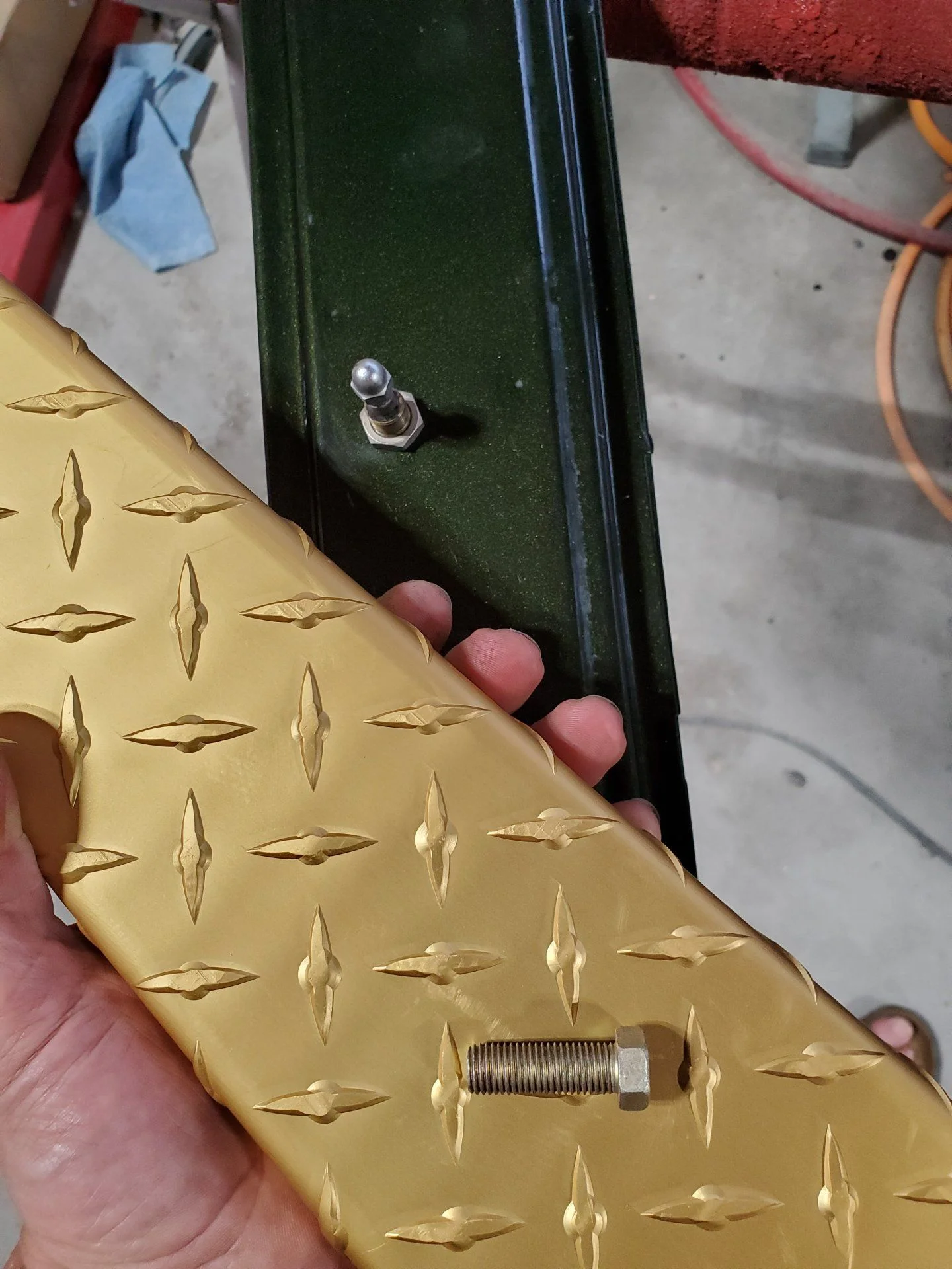

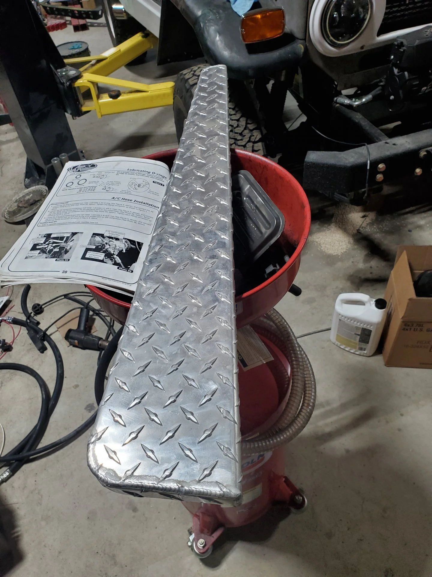

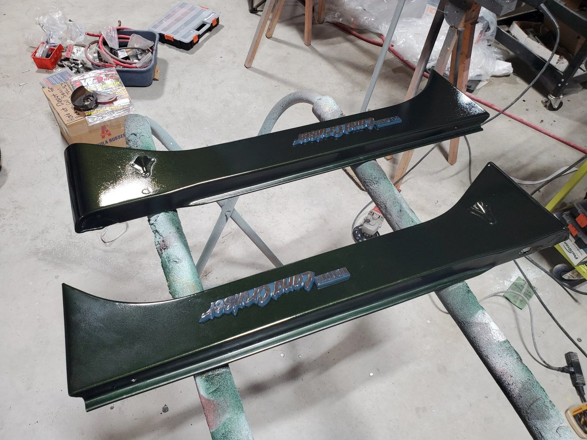

Now, Running boards:
These came with the tub but they are pretty unimpressive.
So I had them Anodized gold. The combo makes me think of Aquaman (The original one)!

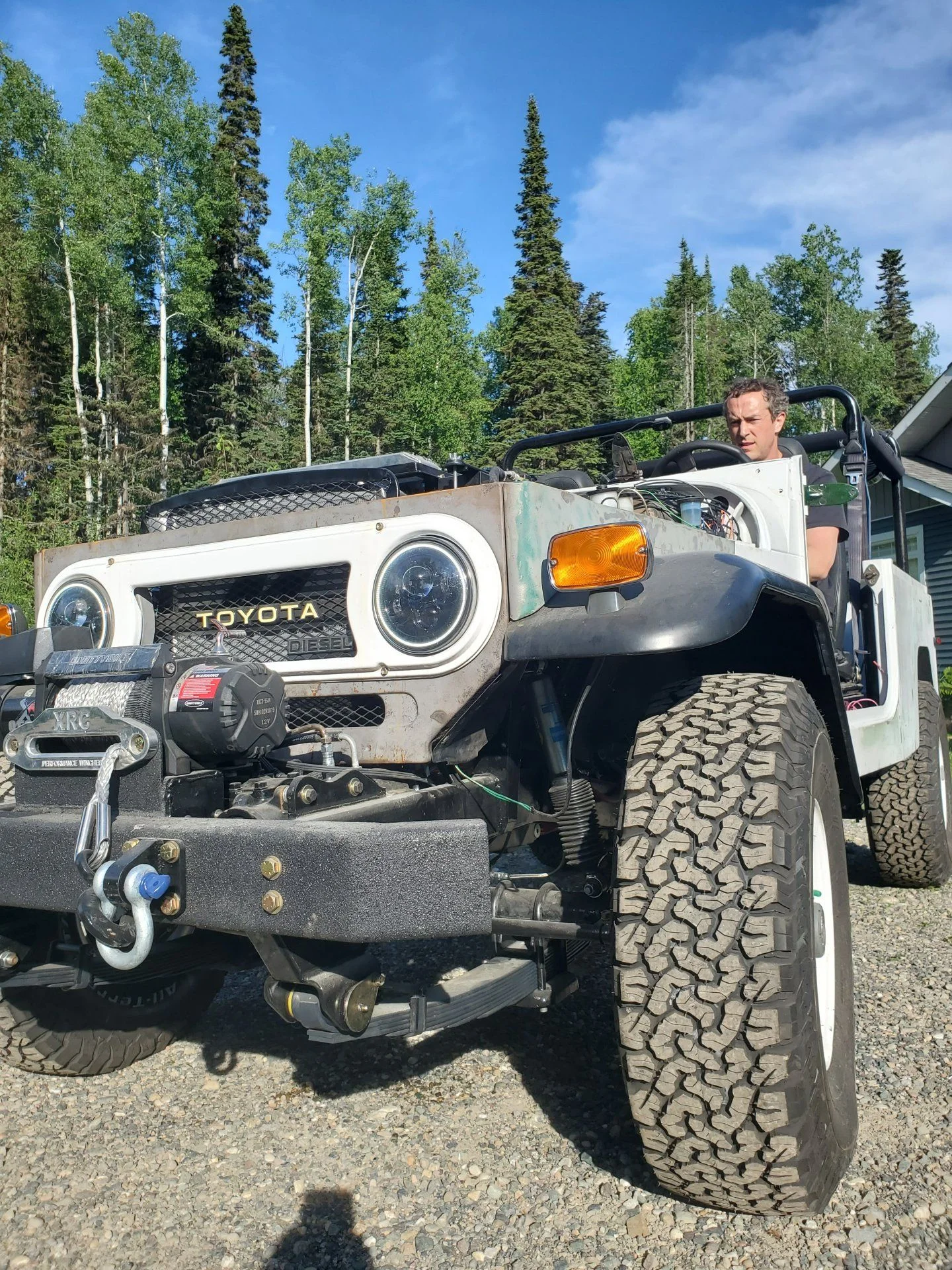

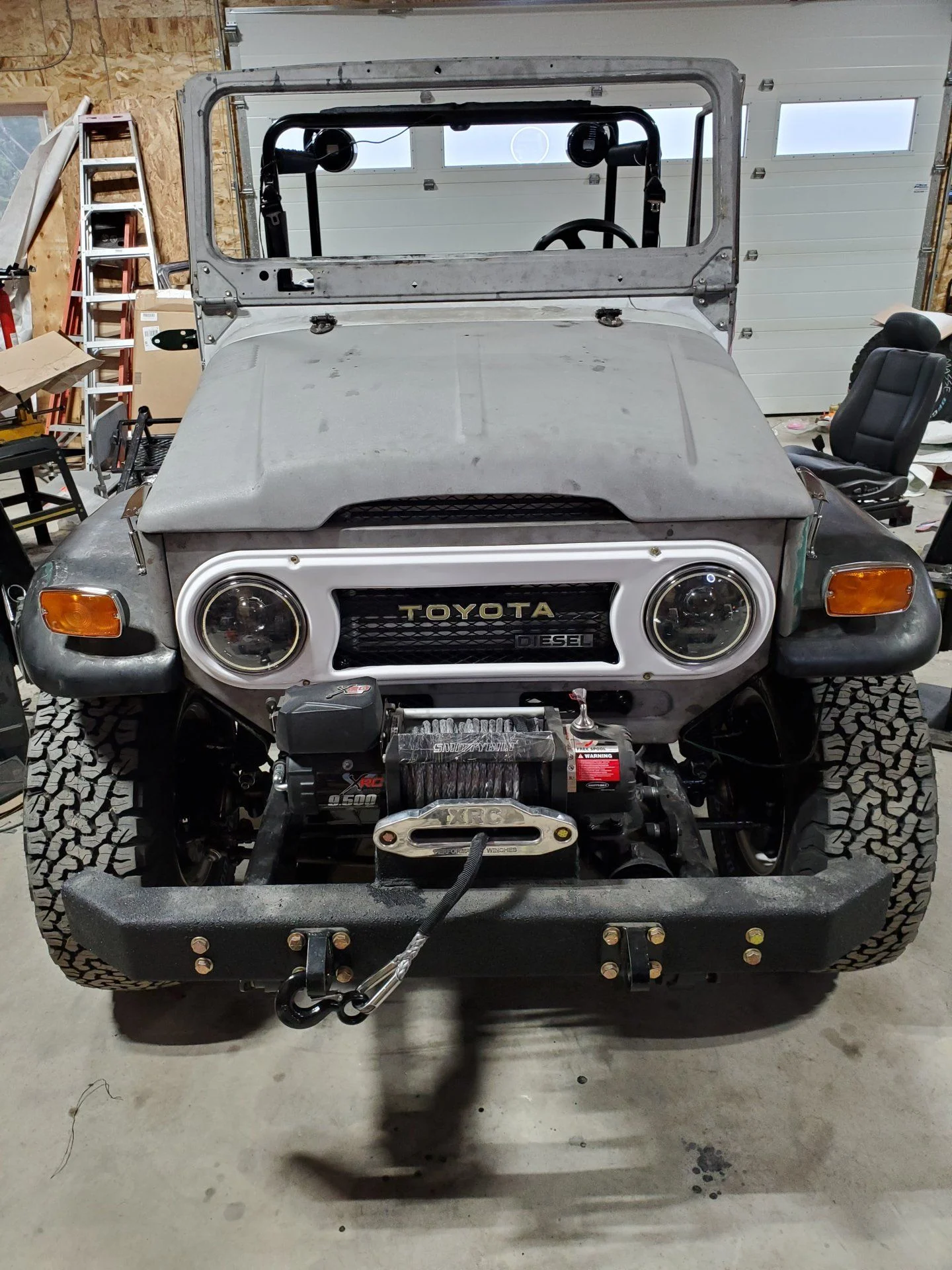

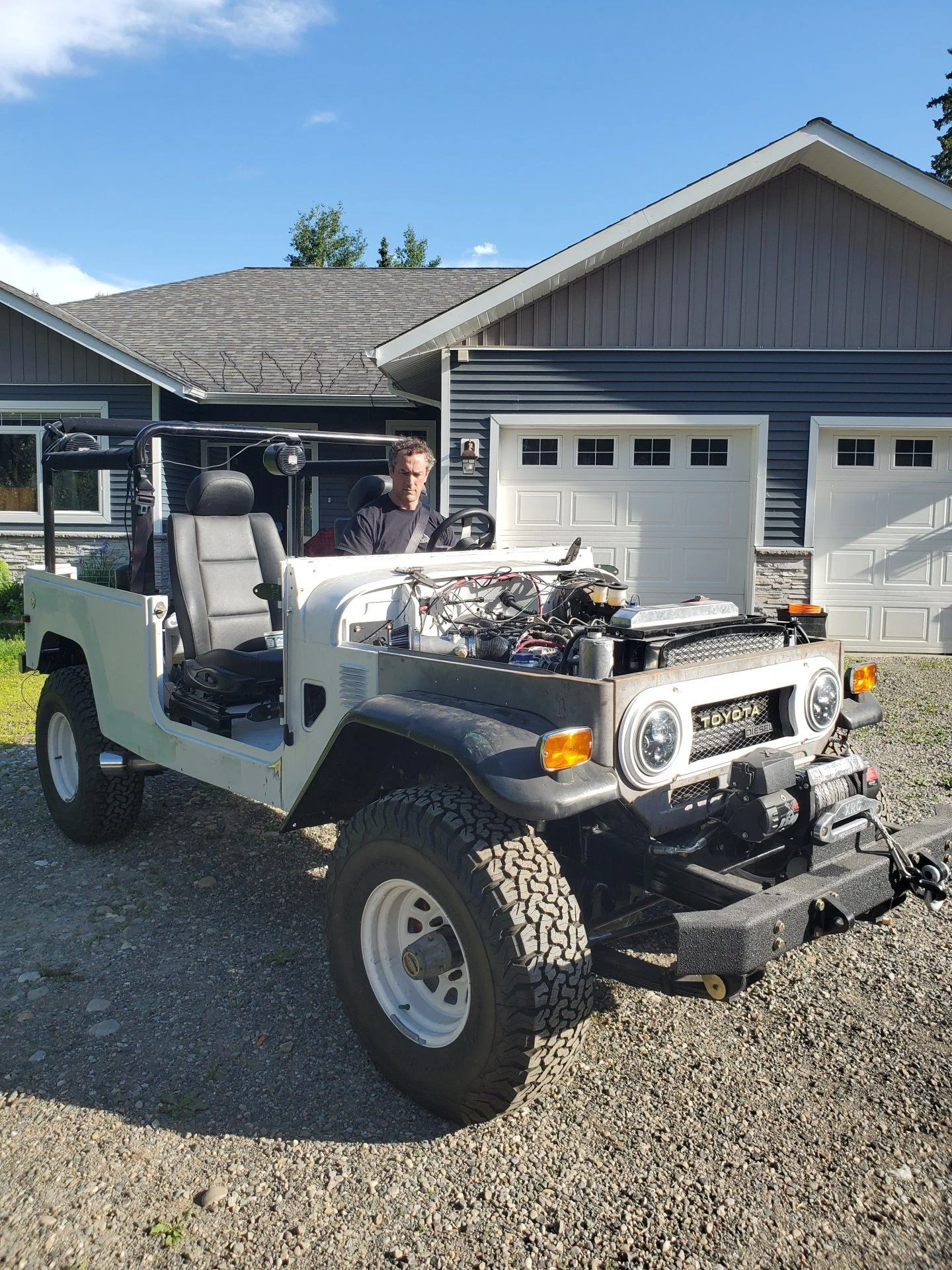

Test run day:
I drove it back and forth on our country road to see what needed work.
I didn't like the intake, I didn't like the coolant tank, and a bunch of other items needed addressing.

And Paint:
More paint in shade/sun:

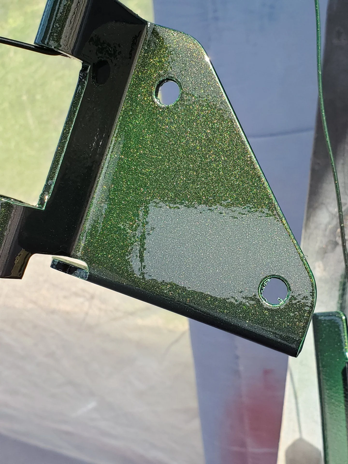

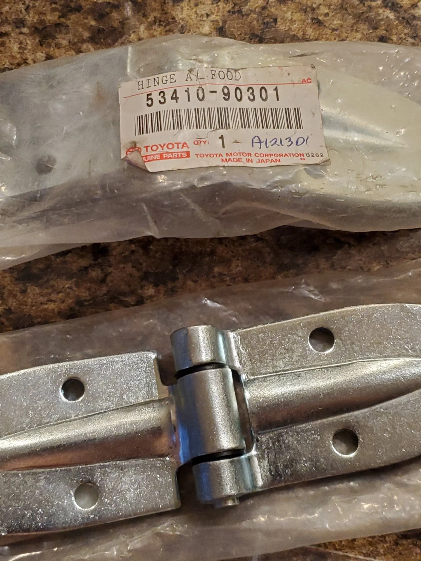

I decided to get the flat hole (non countersunk hood hinges because I wanted to use bolts vs F^(^(%*&%$%$$ philips head screws!
These I don't need because I went with the bronze ones.

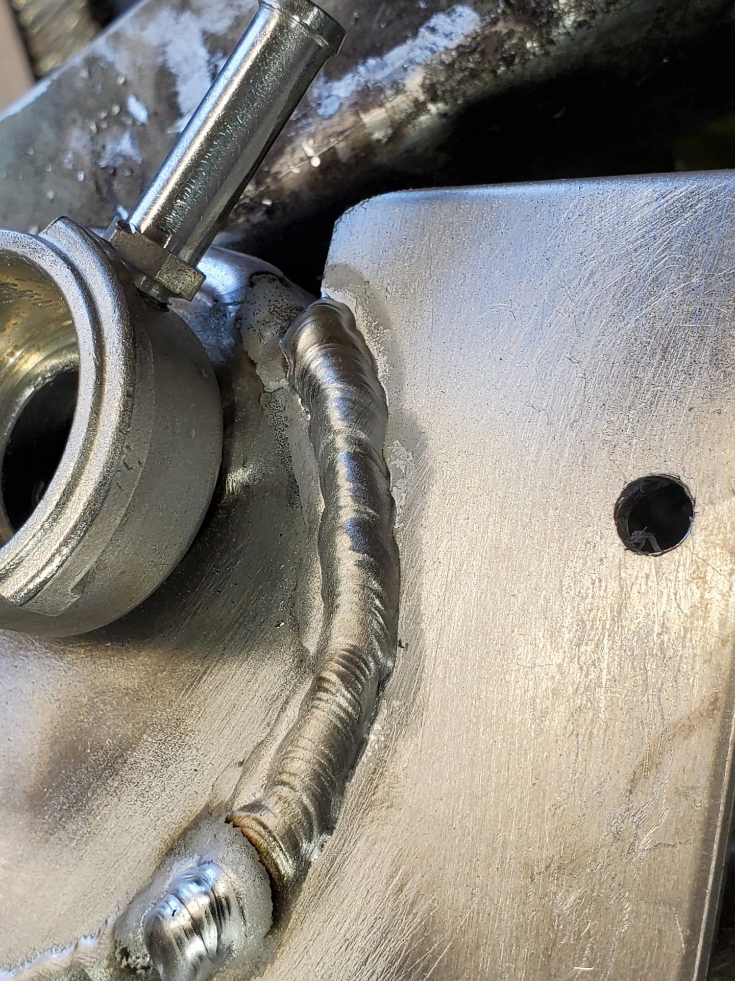

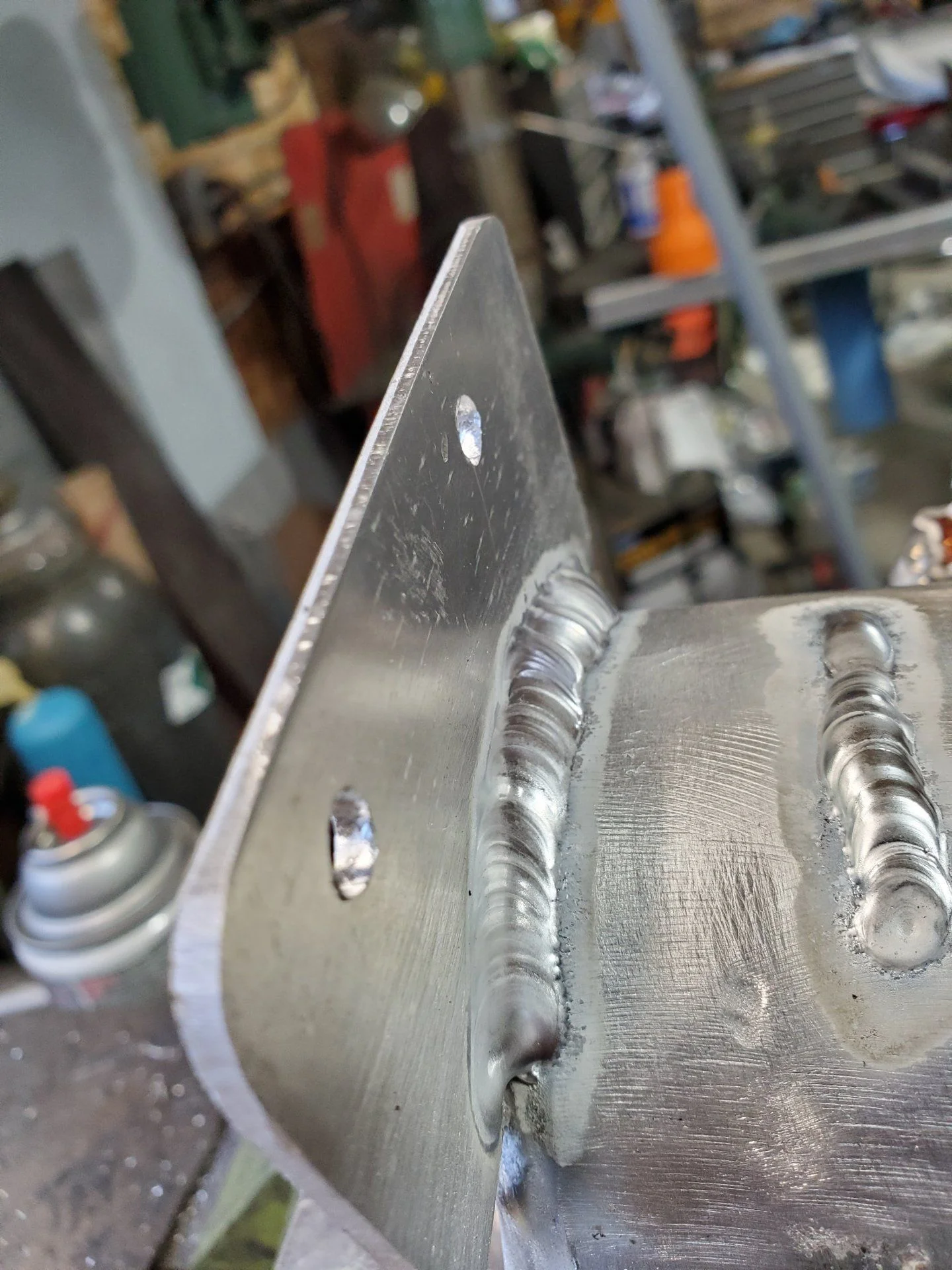

New Coolant can:
My TIG Al is getting much better but these open corners are really easy.

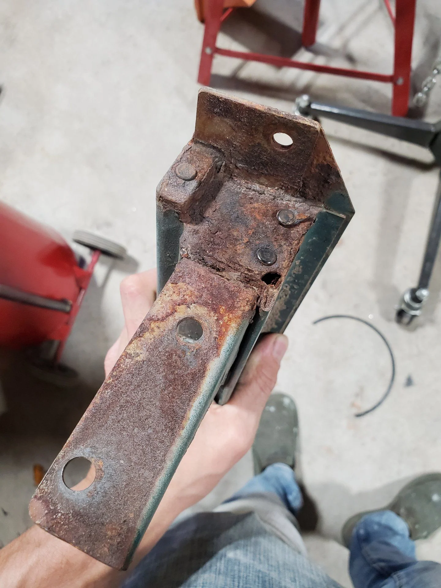

Some rusty bits that need repair. (Roof brace over rear doors)
The new catch can has more ports and a drain and fits into a smarter spot and allows for a forward aiming intake.
I am also now incorporating all the connections recommended by cummins, one from lower rad, water neck and block. My pressure cap is on the catch can and Mishimoto says this is fine, so long as I can get the air out.

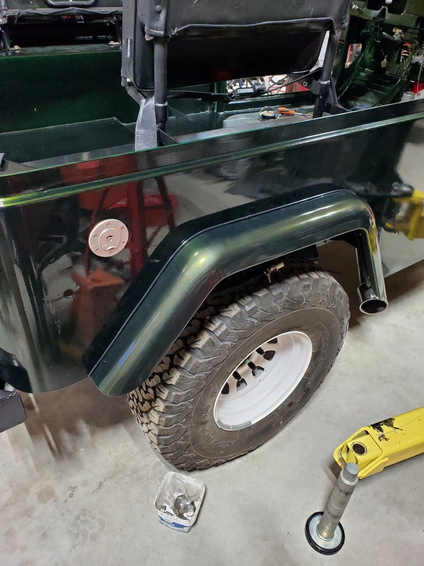

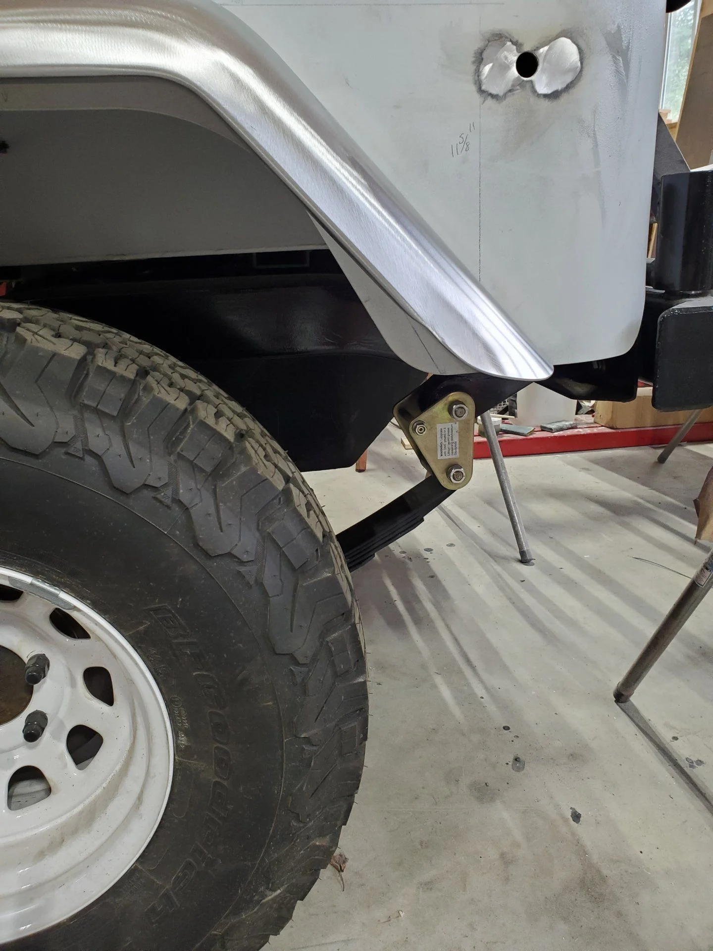

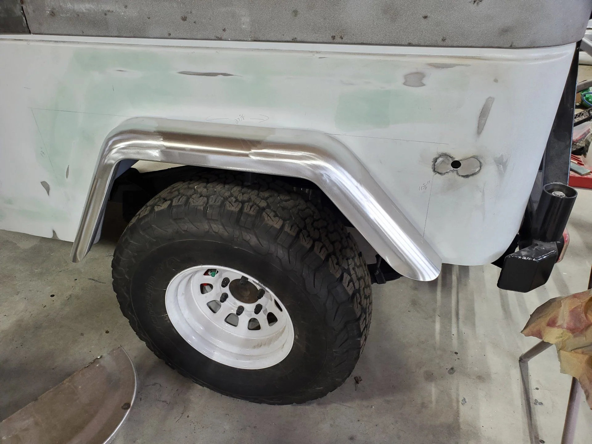

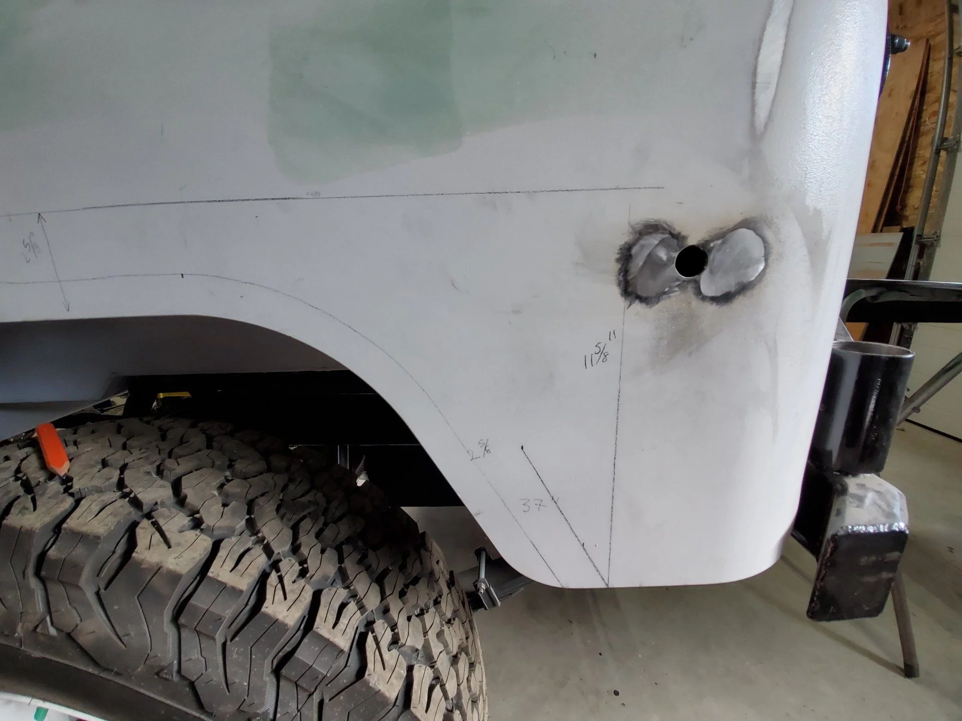

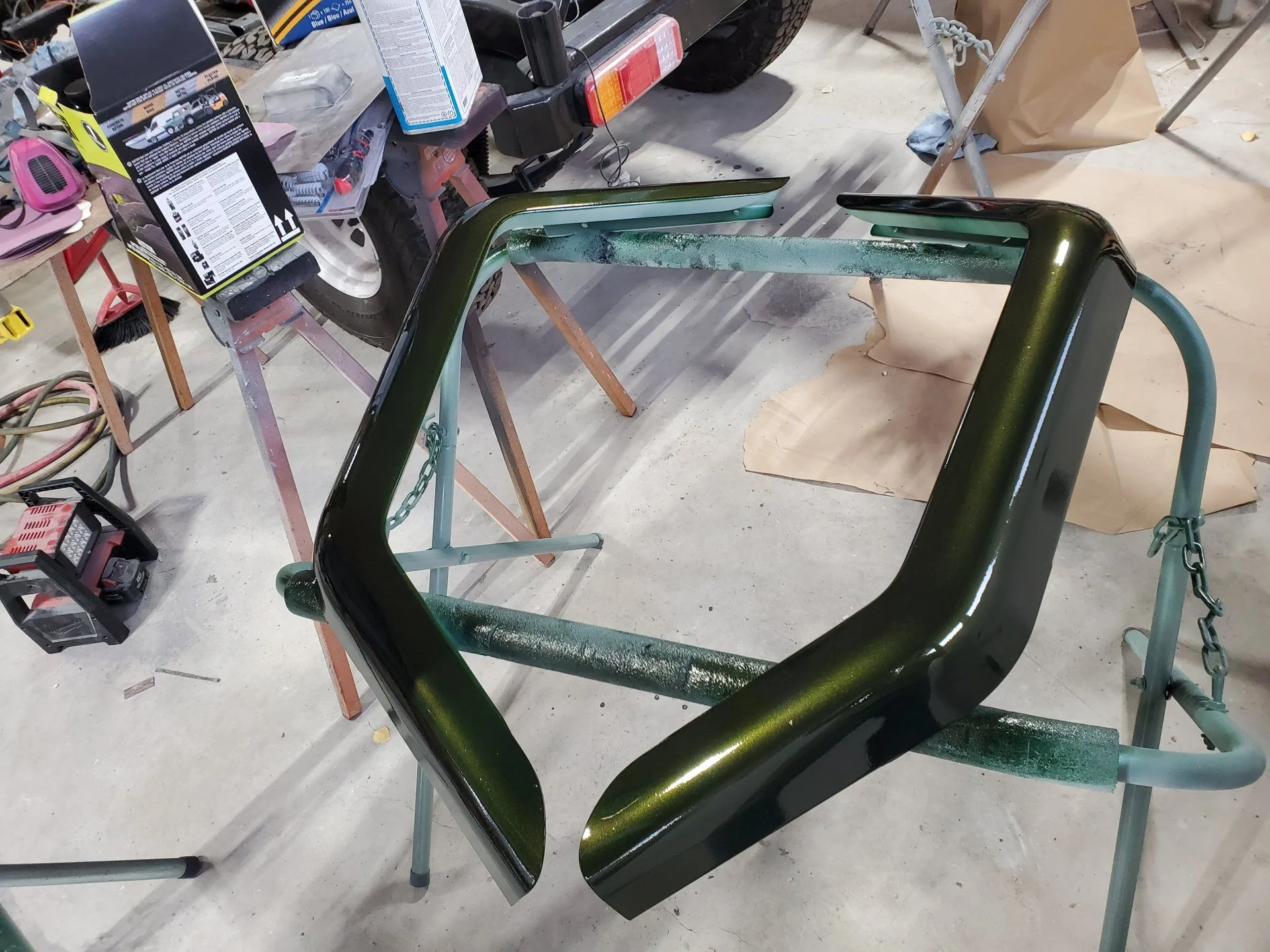

We decided to go with the rear flares since we don't want mud all up the side of the truck but I assumed I would need a different size due to the wheel arch mods I did.
Turns out the flares have nothing to do with the opening size but are designed to look like the front ones in terms of scale! so I just ordered a set of standard "small" flares.
Also, changed the rear marker lights to poison spider units vs the JW speakers. Thats what the welding is about.

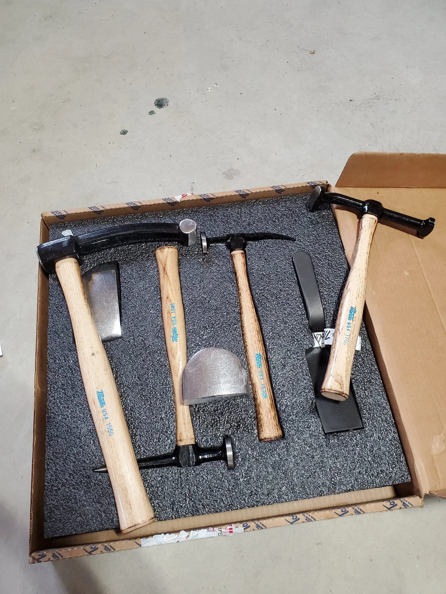

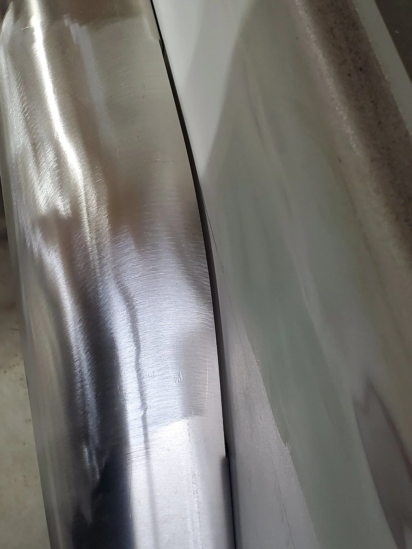

OK, back to the doors. I spent a bunch of time trying to shrink them into shape. I had no clue of what I was doing so eventually got help from the bodyman who did all my sand blasting. He looks at them for a minute then gets a hammer called a horse c@ck! Bangs it a few times and voila!
I carried on after he did a little more for me.
The horse hammer is the one on the left, which I now own along with a few others. An apt name I would venture.

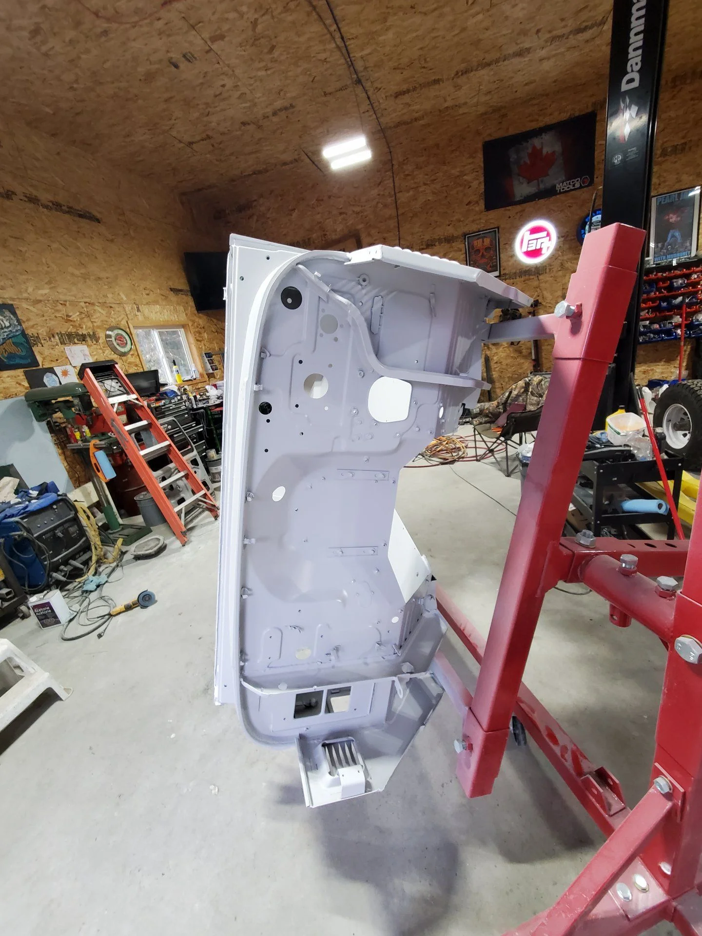

And now the sides, part 1.
There isn't a lot of meat left between the window and the door opening!

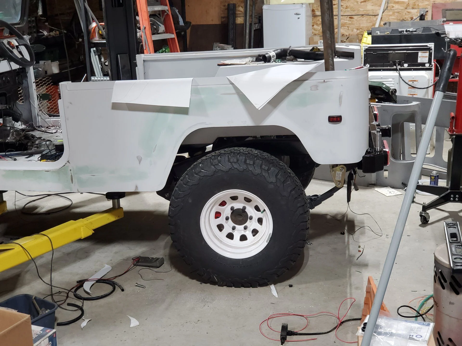

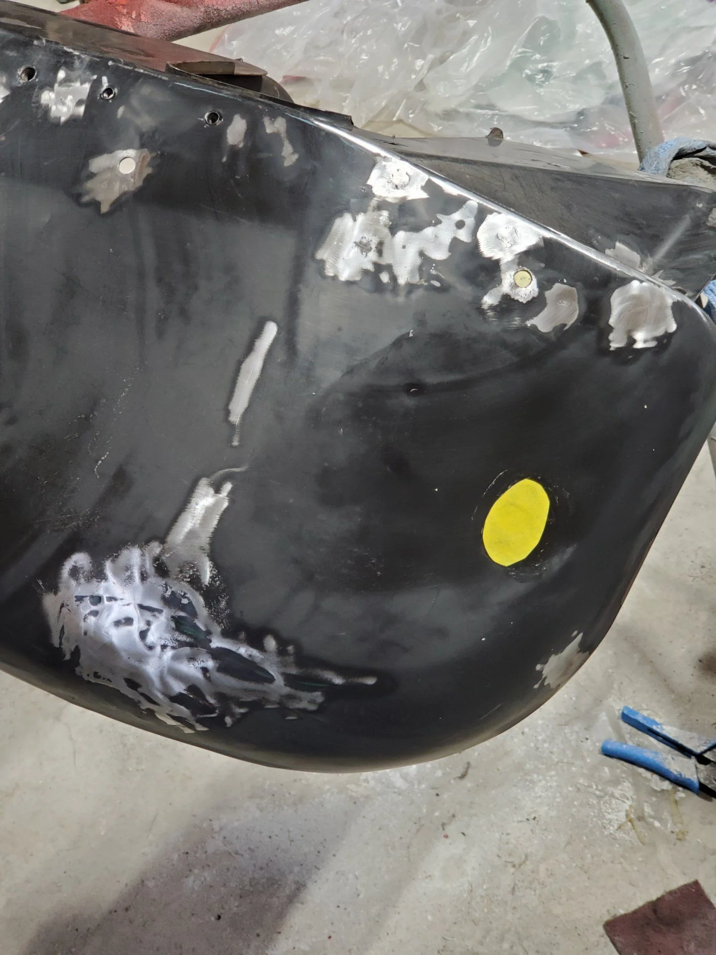

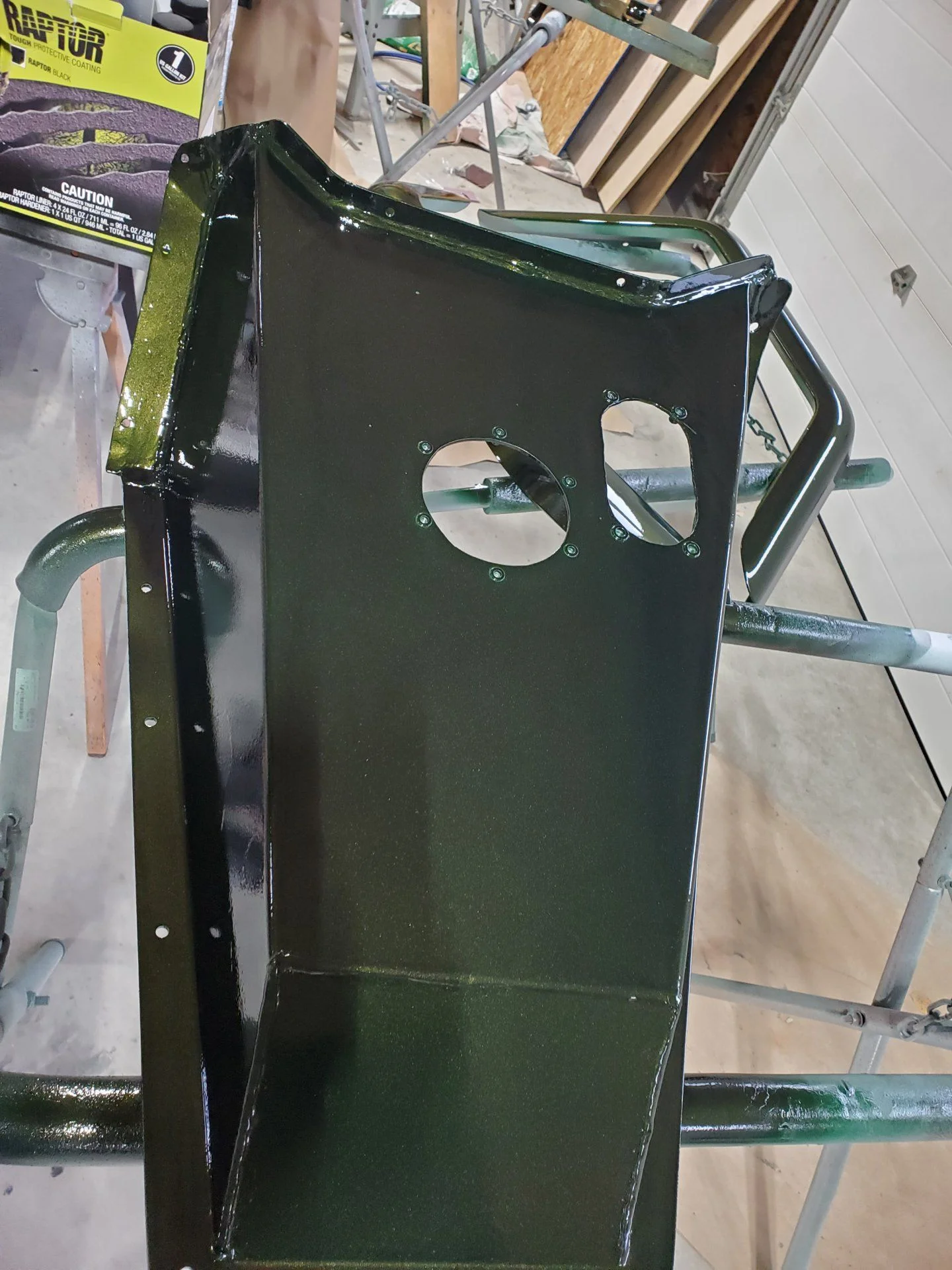

Fender bodywork

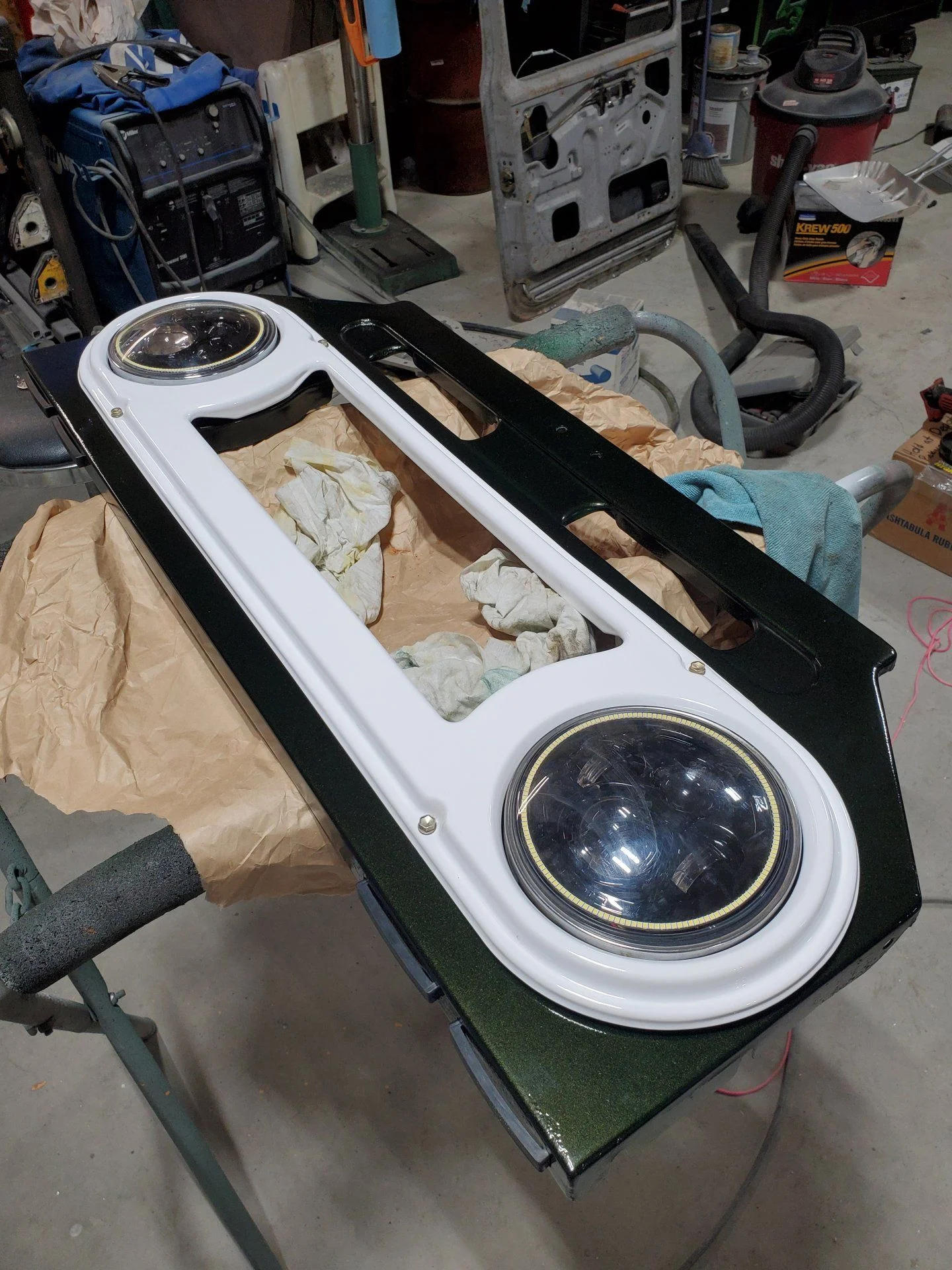

Priming:
Flares mockup:
Decided to trim some of this. PS Jigsaw works great on the tub.

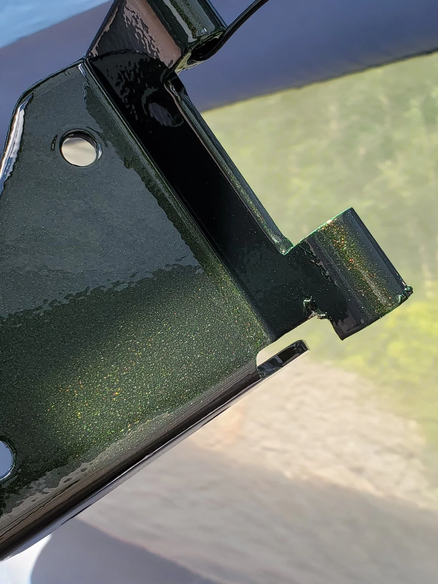

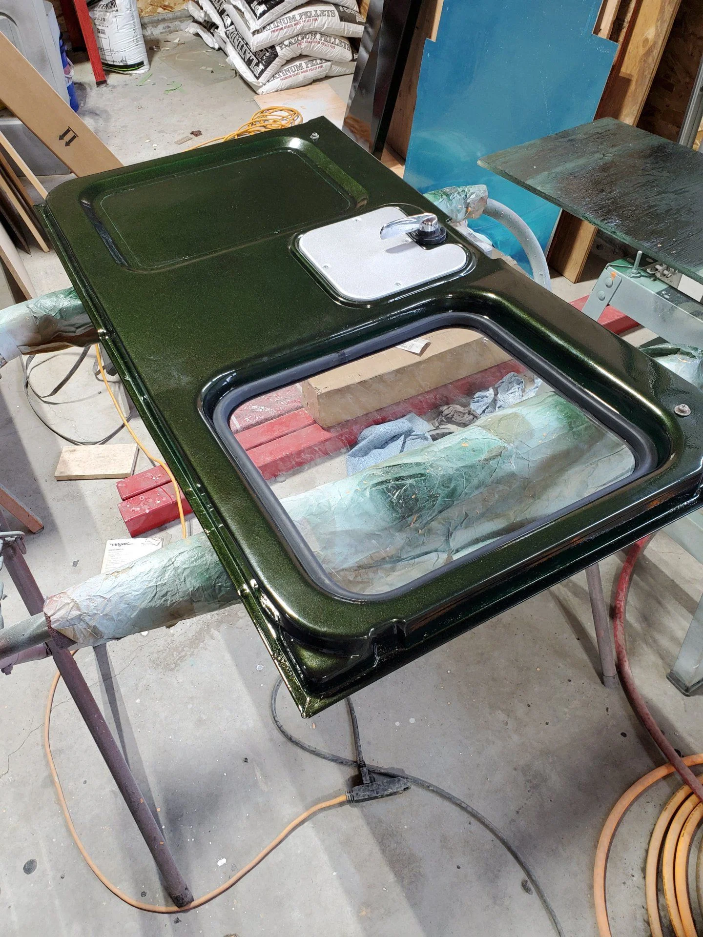

Items that are now Spruce Mica (Toyota 6V4). This is nowhere near perfect and I am no painter but it does the job for us and I did it all myself with some advice from so smart people and some actual real painters.
It is mind boggling that Toyota is still making this stuff!

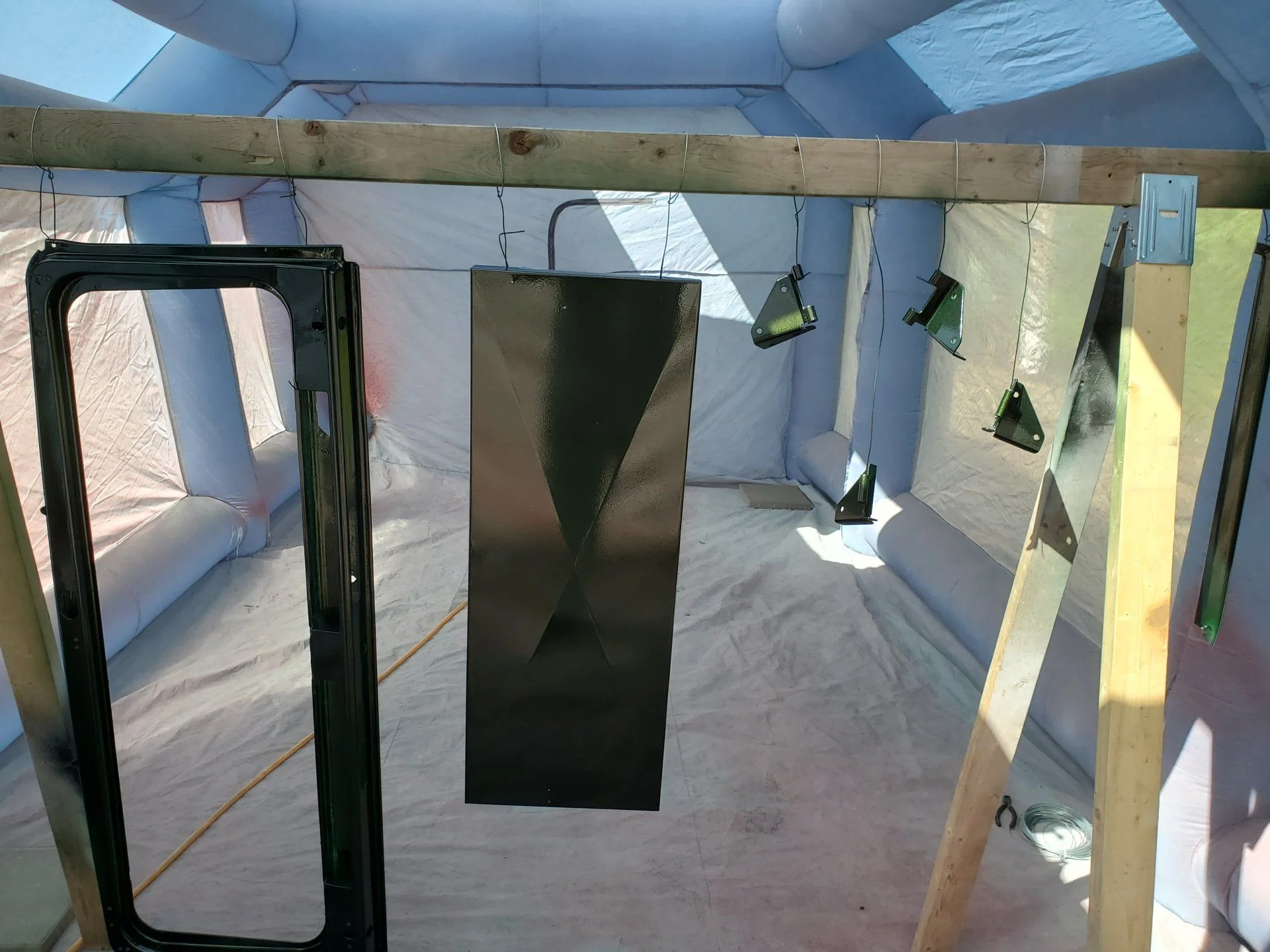

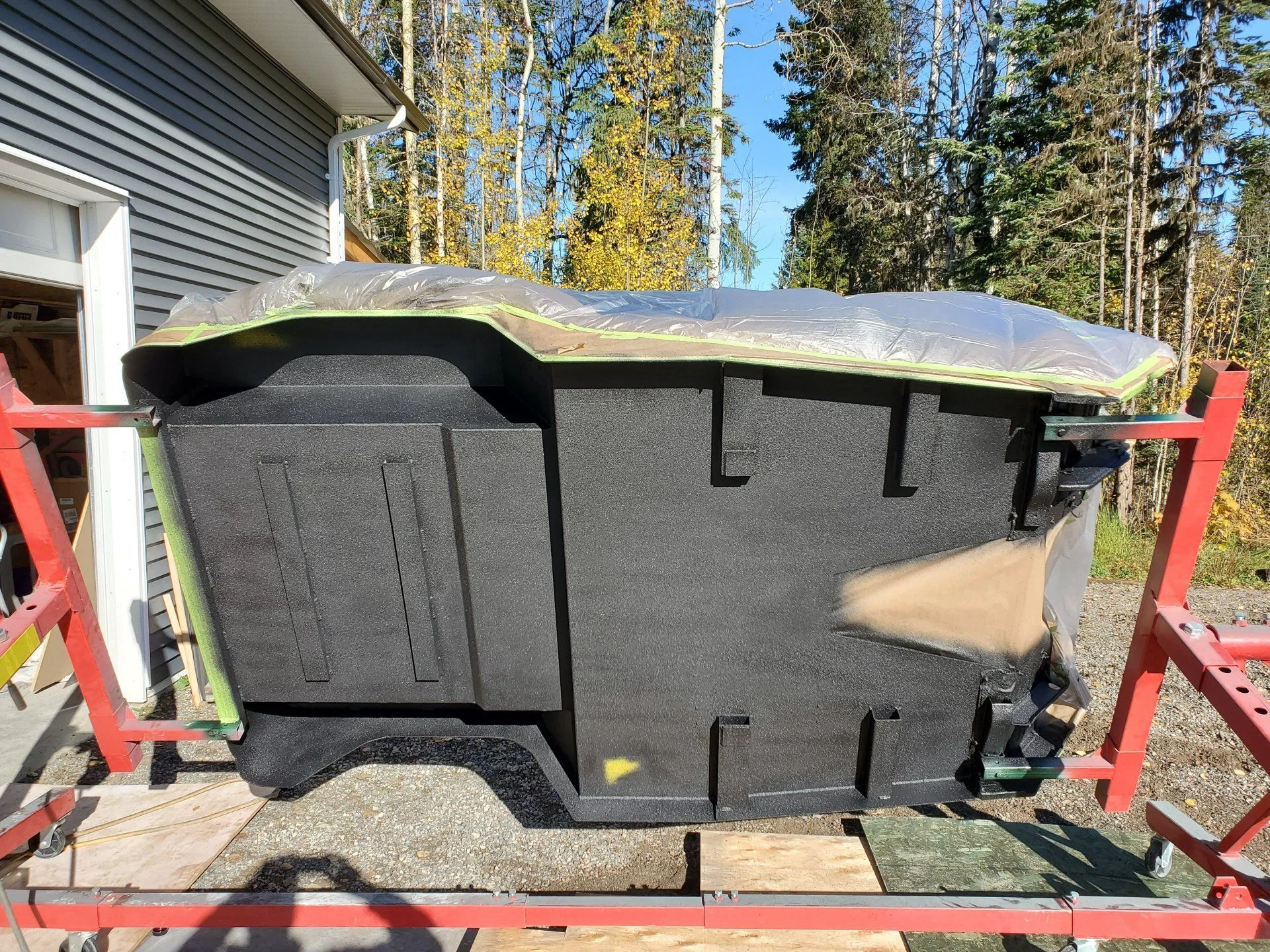

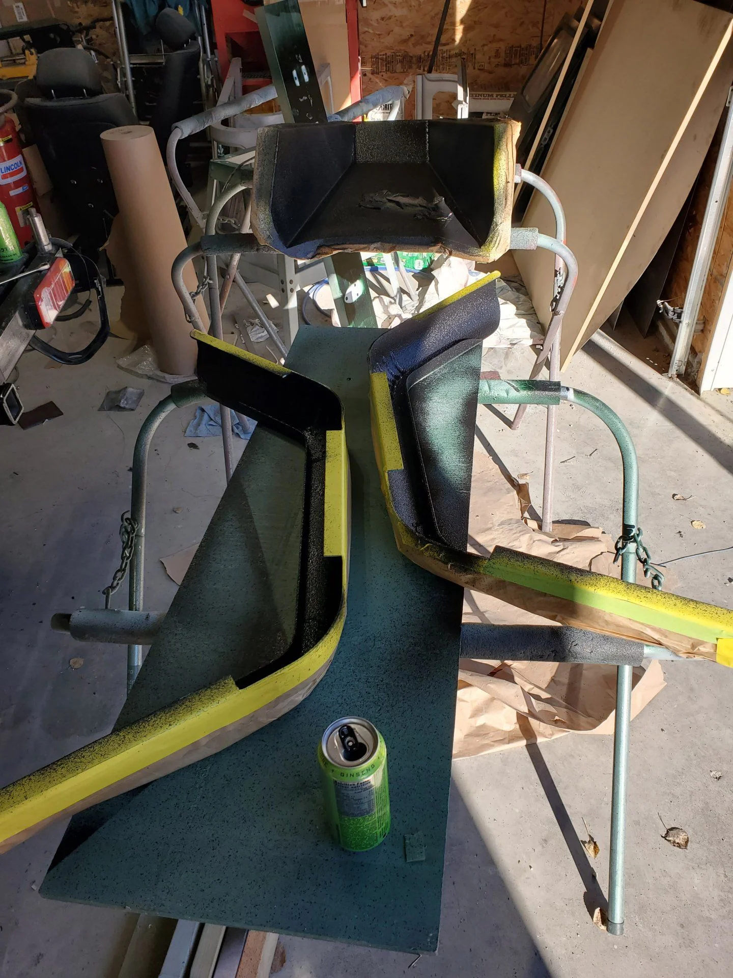

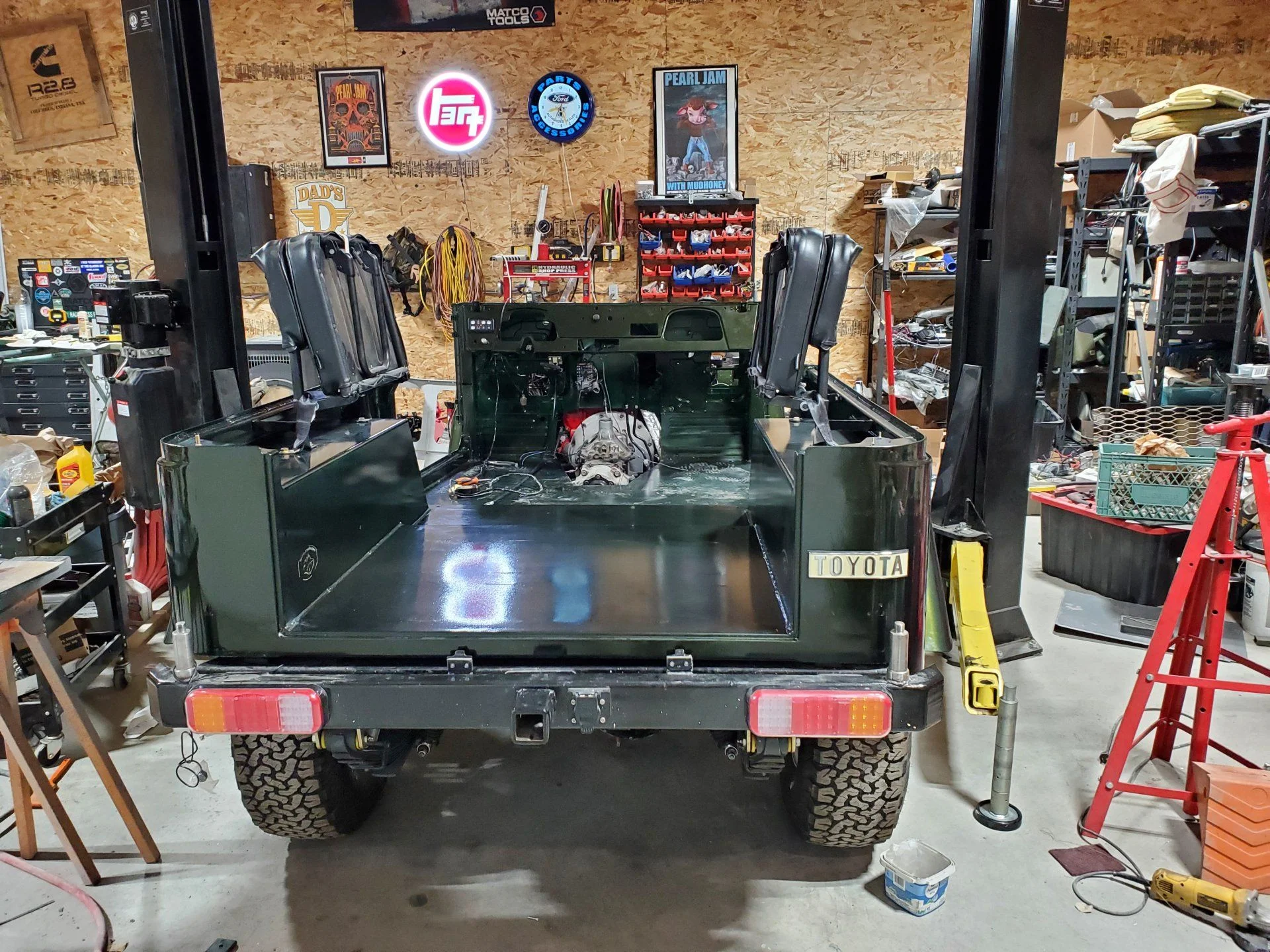

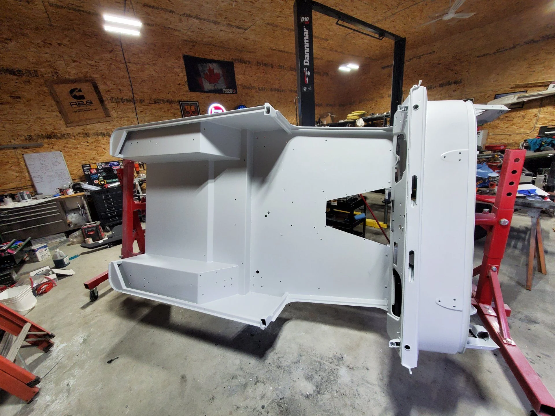

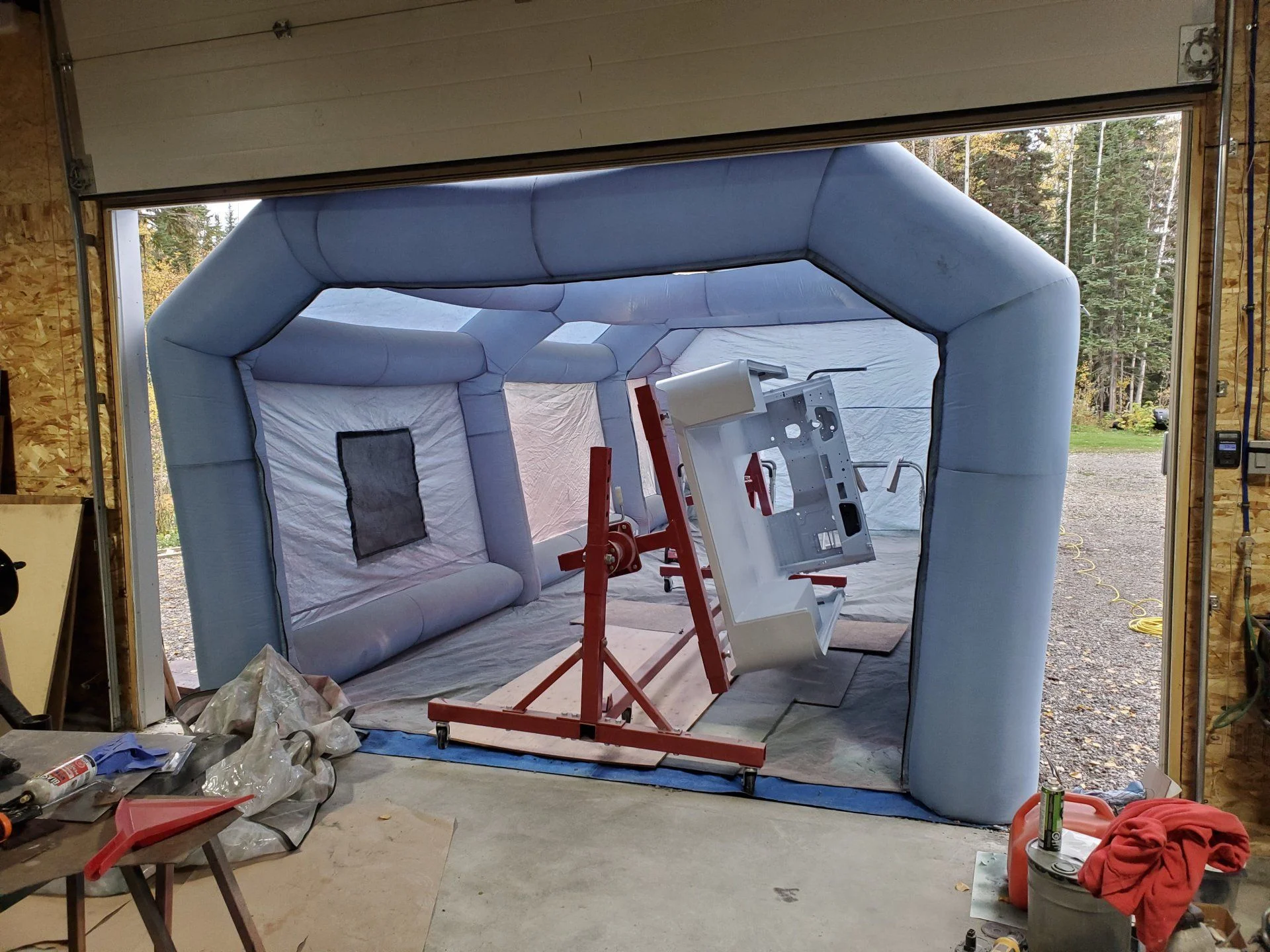

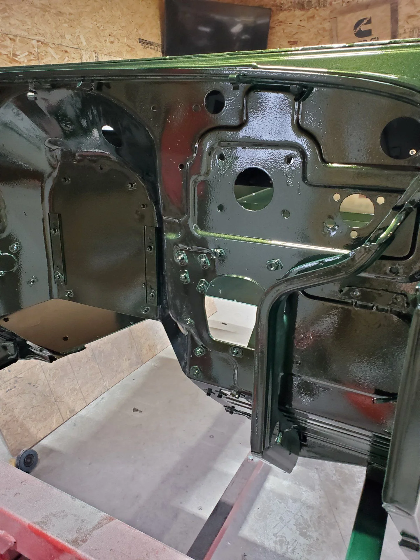

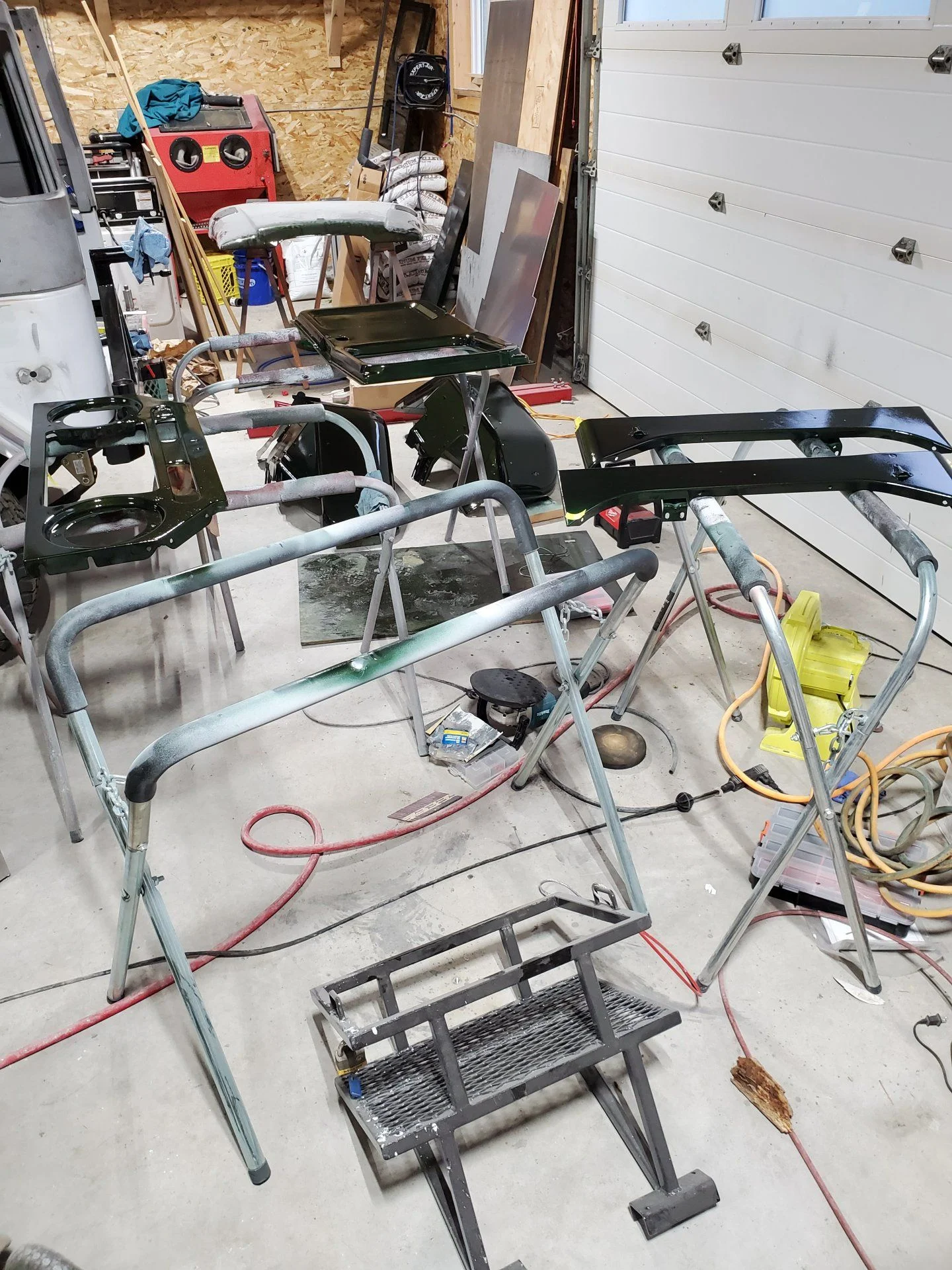

My big goal when I came back from the mine in September for a week was to get the main body of the truck finished on mods, welded where needed, bodyworked, primed and painted. My spraybooth is inflatable and if I didn't get decent weather (>10 C and dry) for a couple of days I would have to do it in the shop or wait till spring.
Luckily I got just enough dry and warm to prime and paint!
I would up with a lot of junk in the drivers side area. It must have been facing up when I was finishing so all the debris got stuck there.
