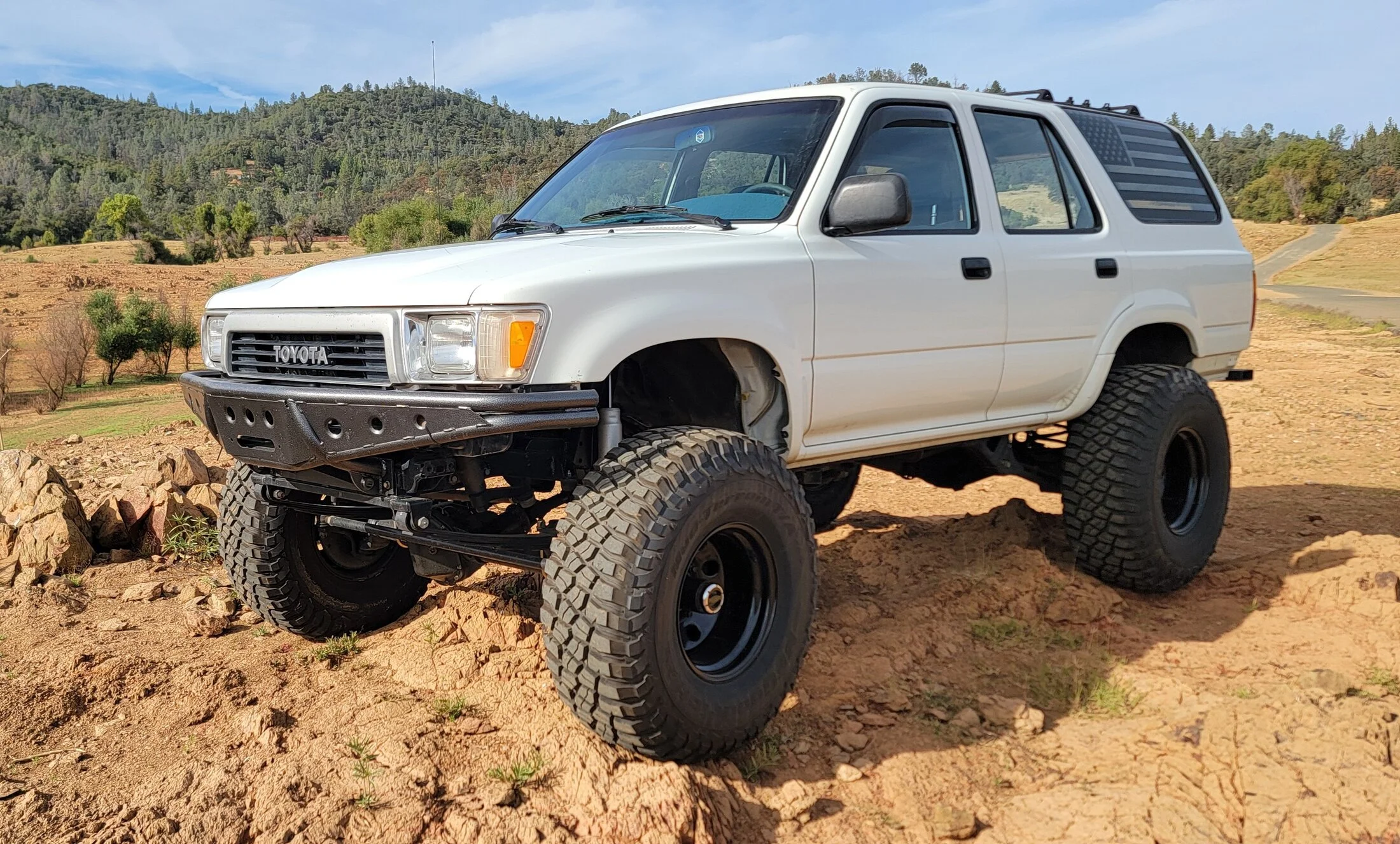

Love the stance of this thing. Can't stand seeing tall narrow toyotas.

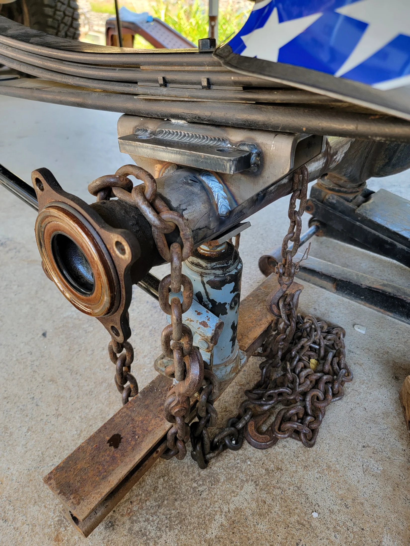

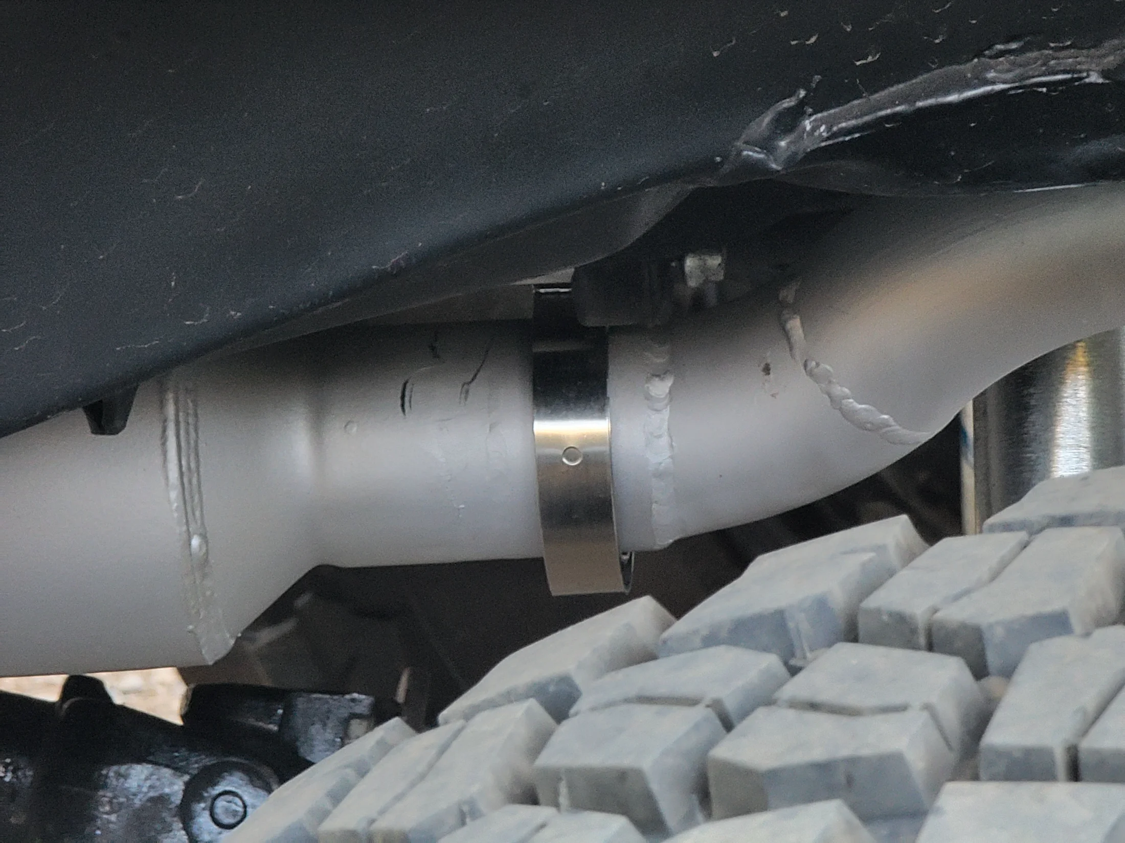

So after you cut up the front axle, did you just cut off a corresponding amount of the the axle shafts? I'm interested in doing this myself, I currently have a d44. I am saving up some money for a truss, coilovers, and a 4link. But I'm a little bit concerned about how much of the axle is going to be sticking out and how it'll look.
With some many manufacturers using the Dana 44 with different lengths I was able to cut my housing to match a 80's jeep wagoneer long side and a dodge truck short side. Makes it super slick and there are a lot of combos you can run the get the axle width you want while retaining a stock shaft length.
Then I ordered a yukon chromo shafts for each.
You can also cut down the stock shafts as well and have them resplined as long as you are going short enough to get past the necked down section in the stock shaft.

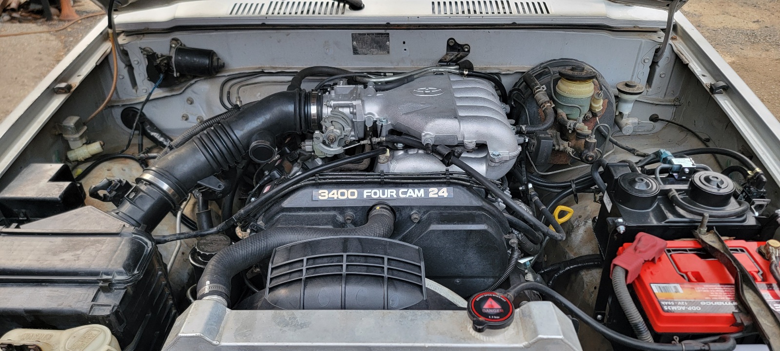

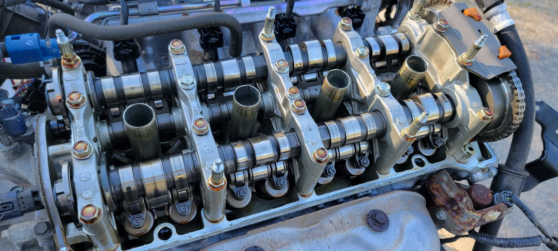

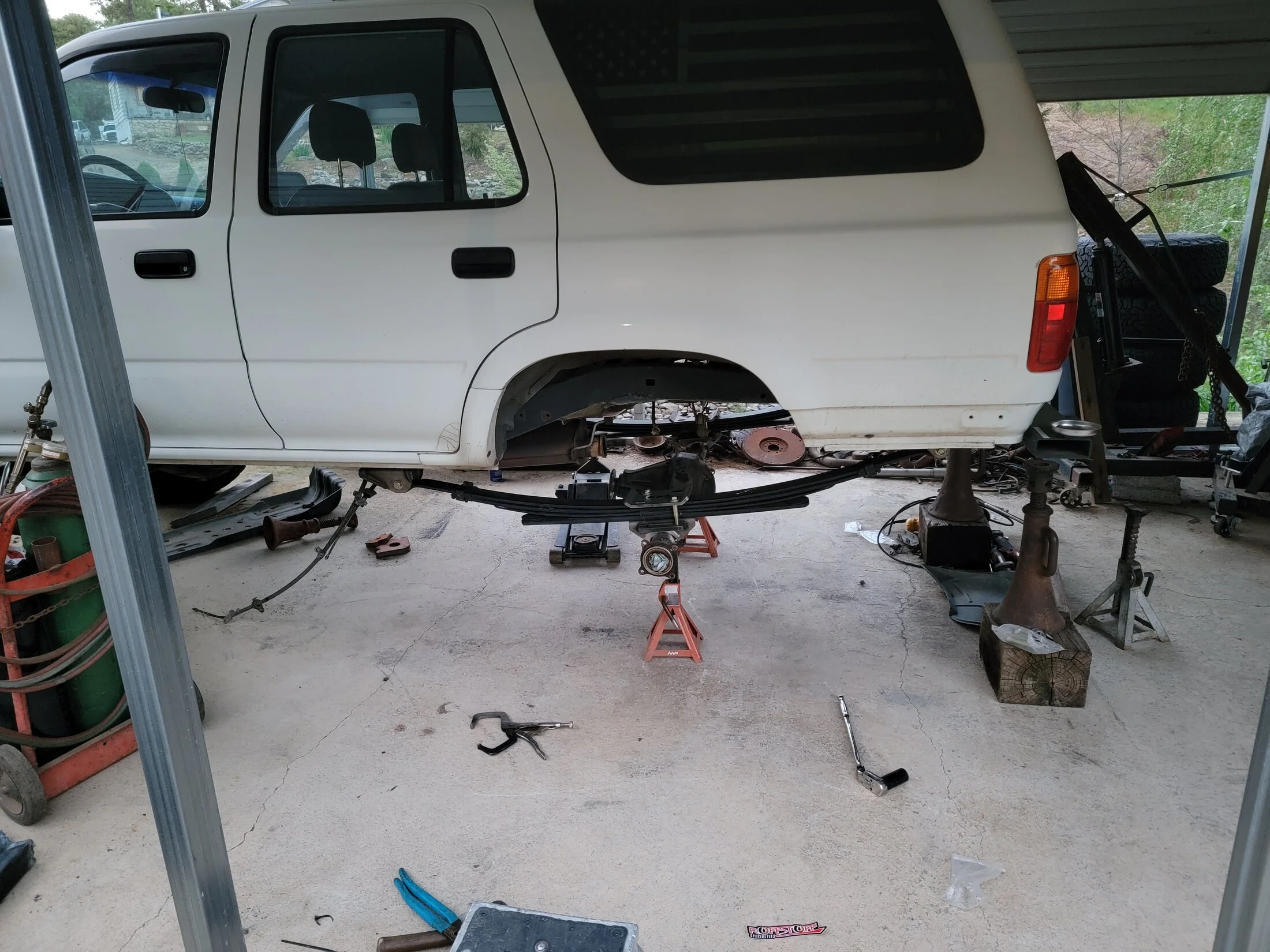

Have taken a long lay off from working on the 4runner. I did start building a rear bumper though. And I do have almost everything to do chevy rear springs. I sold off the Honda stuff too. The more I thought about it this rig deserves a V8. So time will tell.
I also picked up a 88 single cab 3.0. I added a 3.4 to it. Wow what a fun little truck. Runs phenomenal!!

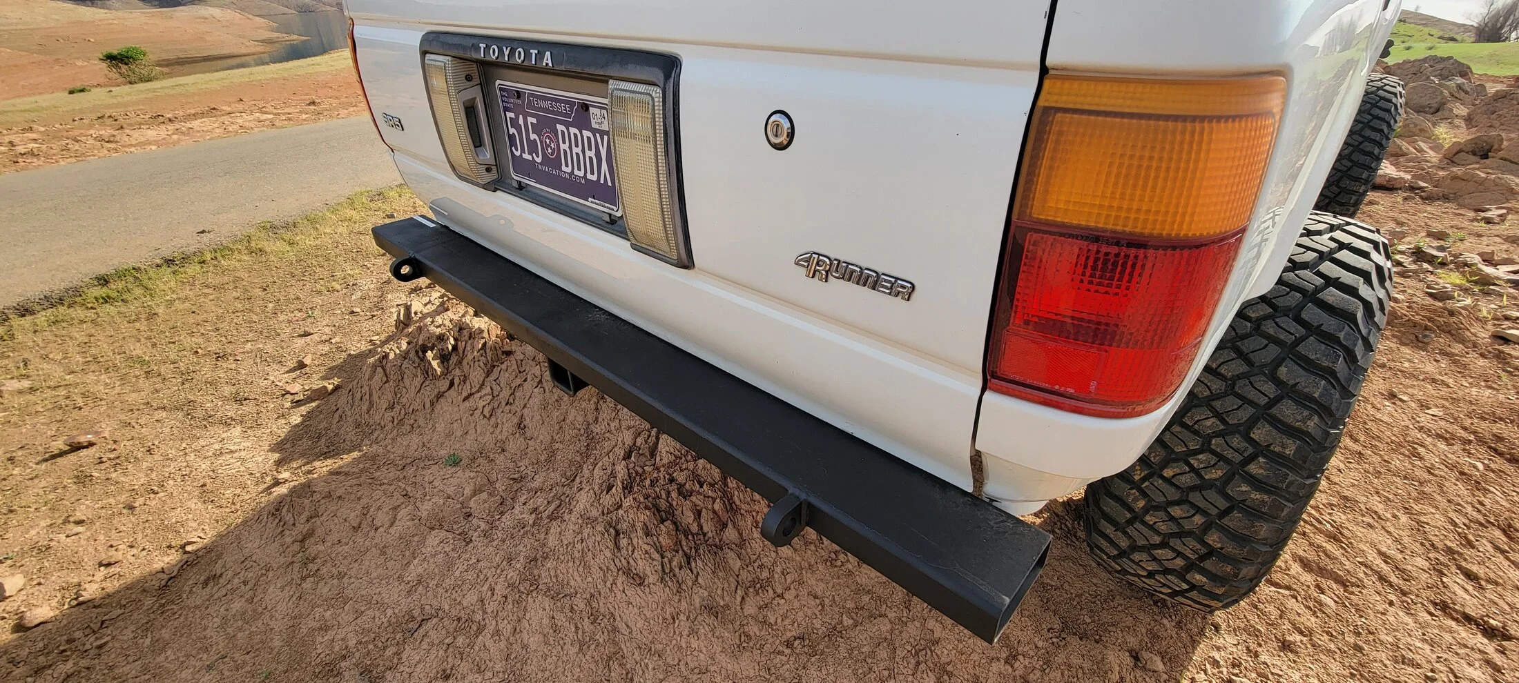

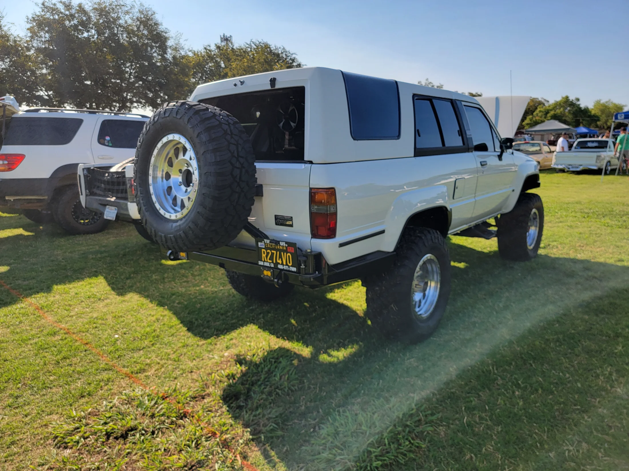

Started my Bumper sides. VERY time consuming. I am thinking dimple die hopes on the side? Going back and forth at least. Like the clean sides but like the dimple dies too and it would match my front bumper with so in there, and of course make it a little lighter and more rigid. Also the main section of the bumper will be trimmed so a ways to go to the final product.
Nice. Looks a lot like the one I built for my dad's 60.
I'm not sure about the dimple dies. I like smooth.
Although keeping nice minimal gaps looks good, it doesn't work out great when the bumper takes a big impact and contacts the body. Ask me how I know 🤣
Nice! Yea have been going back and forth for sure on the dimples. But i have the dies :) hahaha
