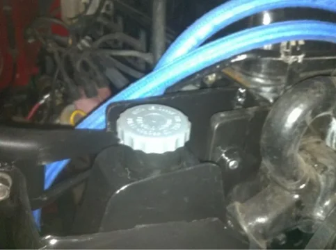

Here's how I did my bracket , made a plate out of 1/4 a ran the belt to bottom pulley
