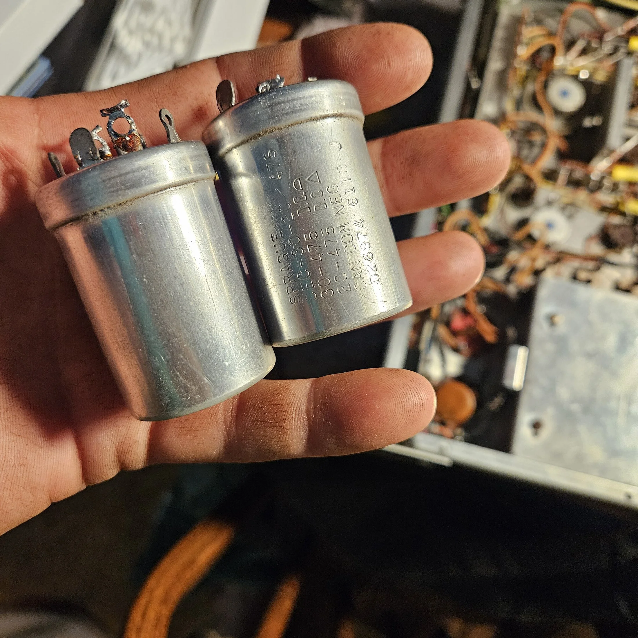

The custom can capacitors arrived a few days ago. My landmate has been gone so i just yesterday found a few minutes between chores to drop the first 2 cans in.
They came out really nice as always.

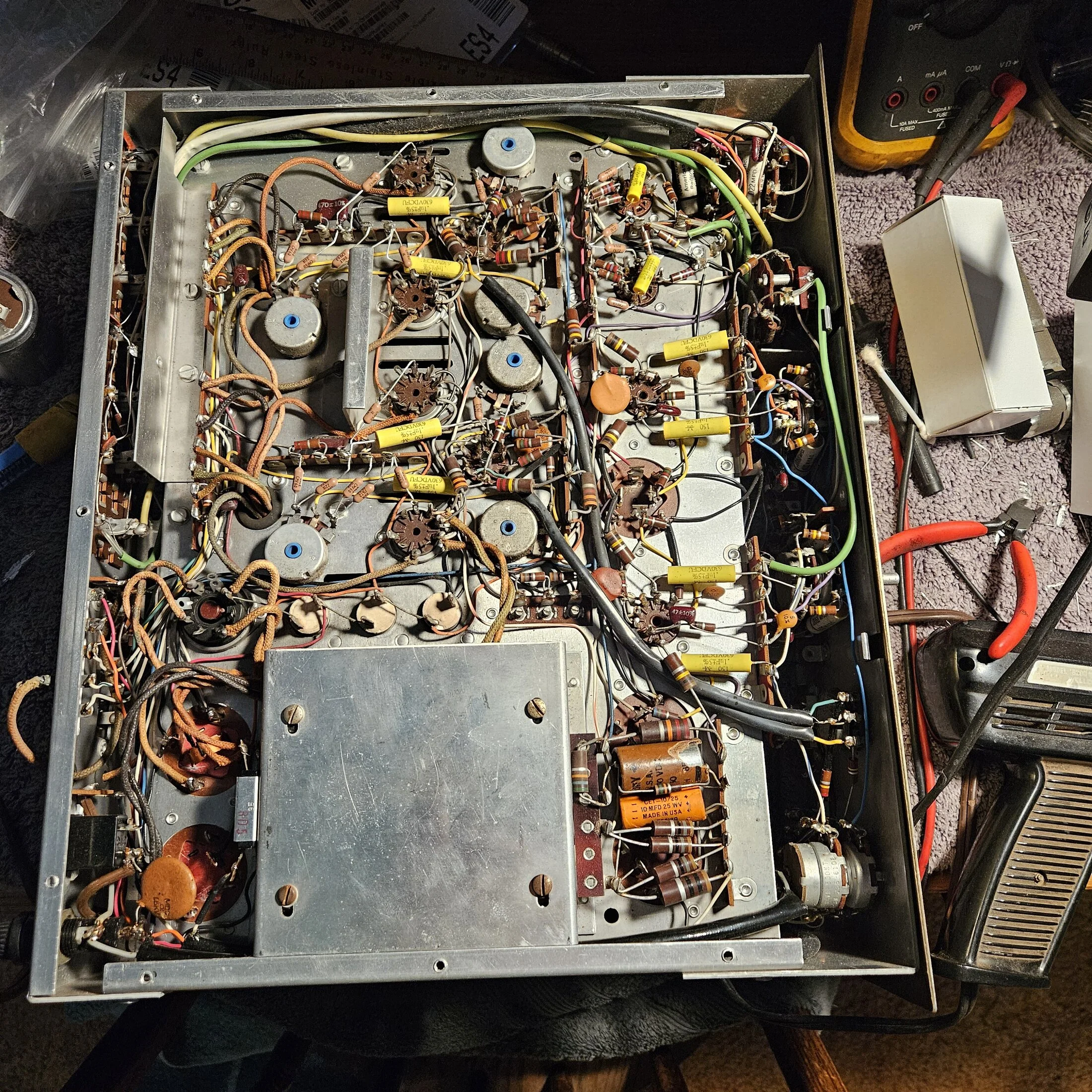

I got some time to dig back in this morning.
Today's work was to overhaul the filament and fixed bias supply.
One brilliant aspect of the HH Scott design is the stout DC bias supply which runs at ~50 volts dc.
Its very well filtered and a very robust supply because theyve used it not only as a bias supply but also to light up the filaments of the preamp tubes which can run on 6.3 or 12.6v ac or dc.
Corresponding to the voltages of a fully charged lead acid battery which was the technology of the time.
Dc provides the quietest mode of operation.
So in their brilliance, the engineers at HH SCOTT company wired all 4 in serries and fed them 50v dc which, conveniently enough the bias supply was already supplying.

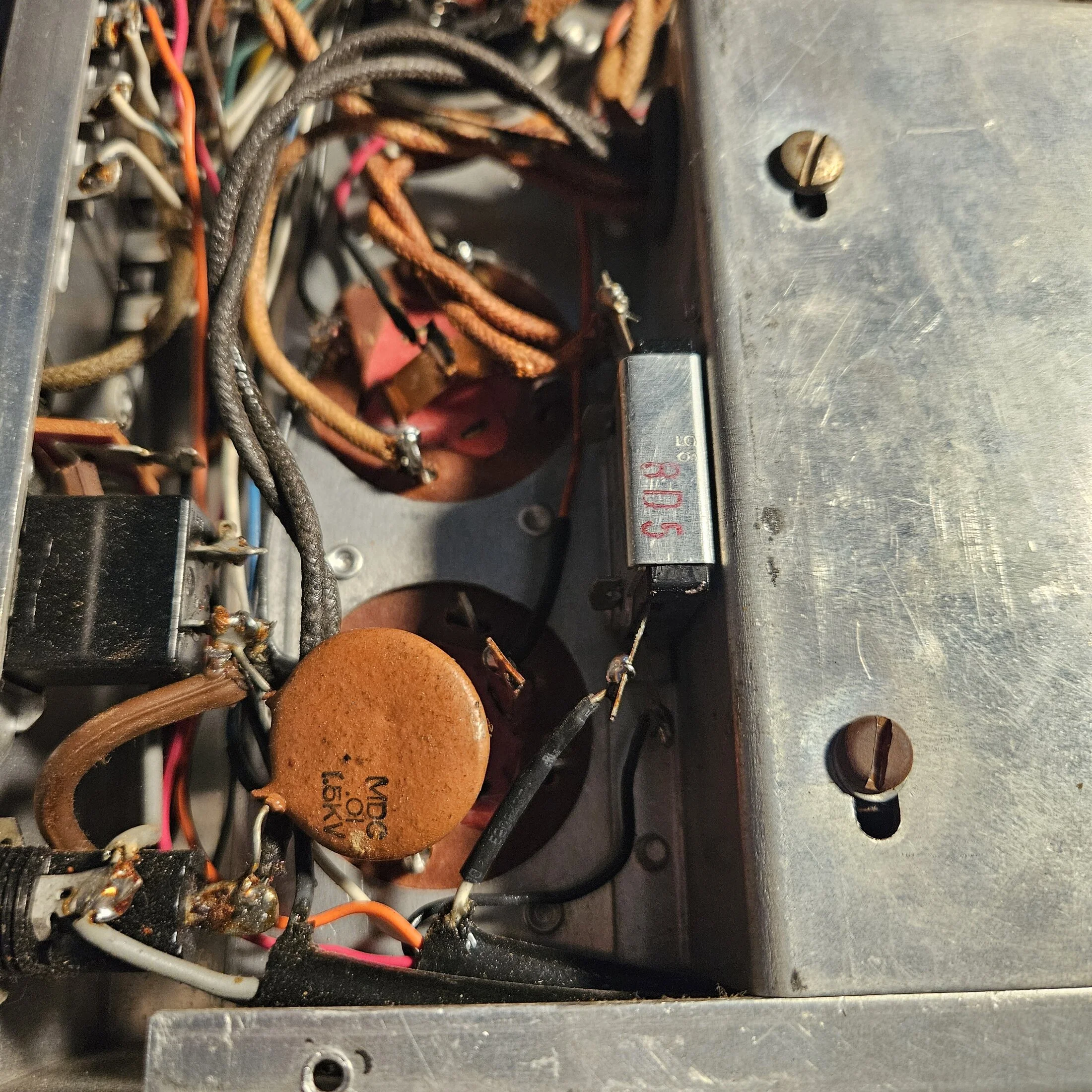

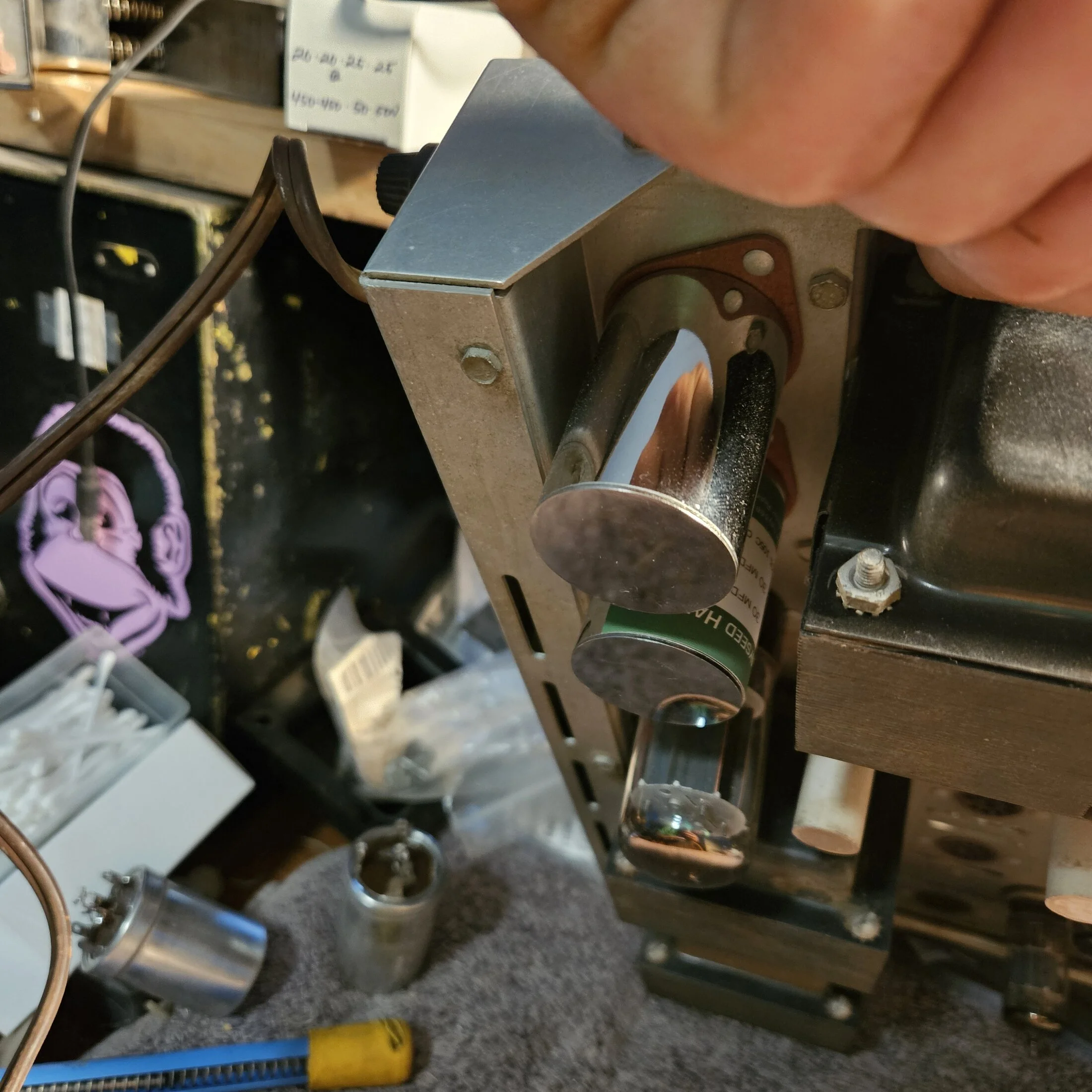

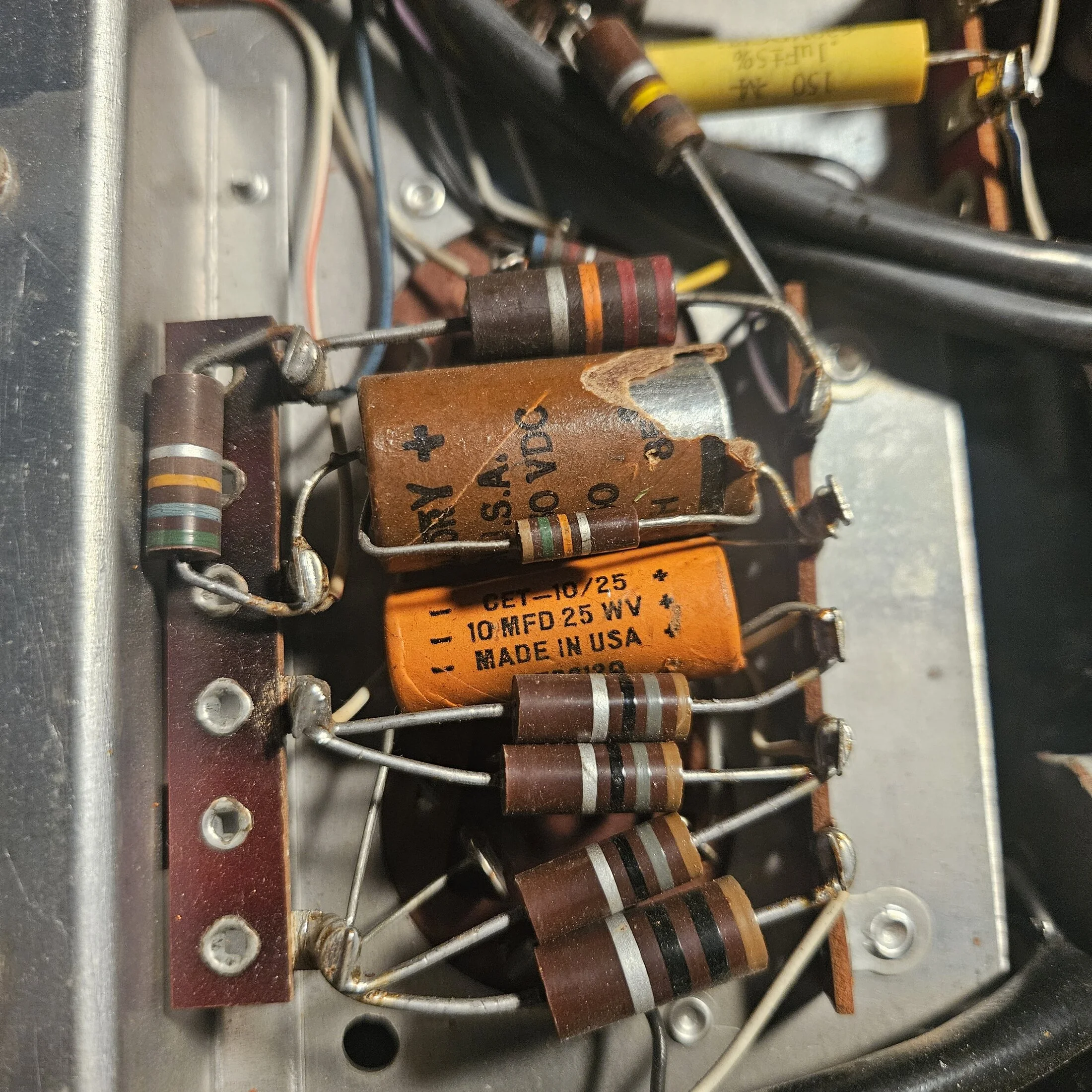

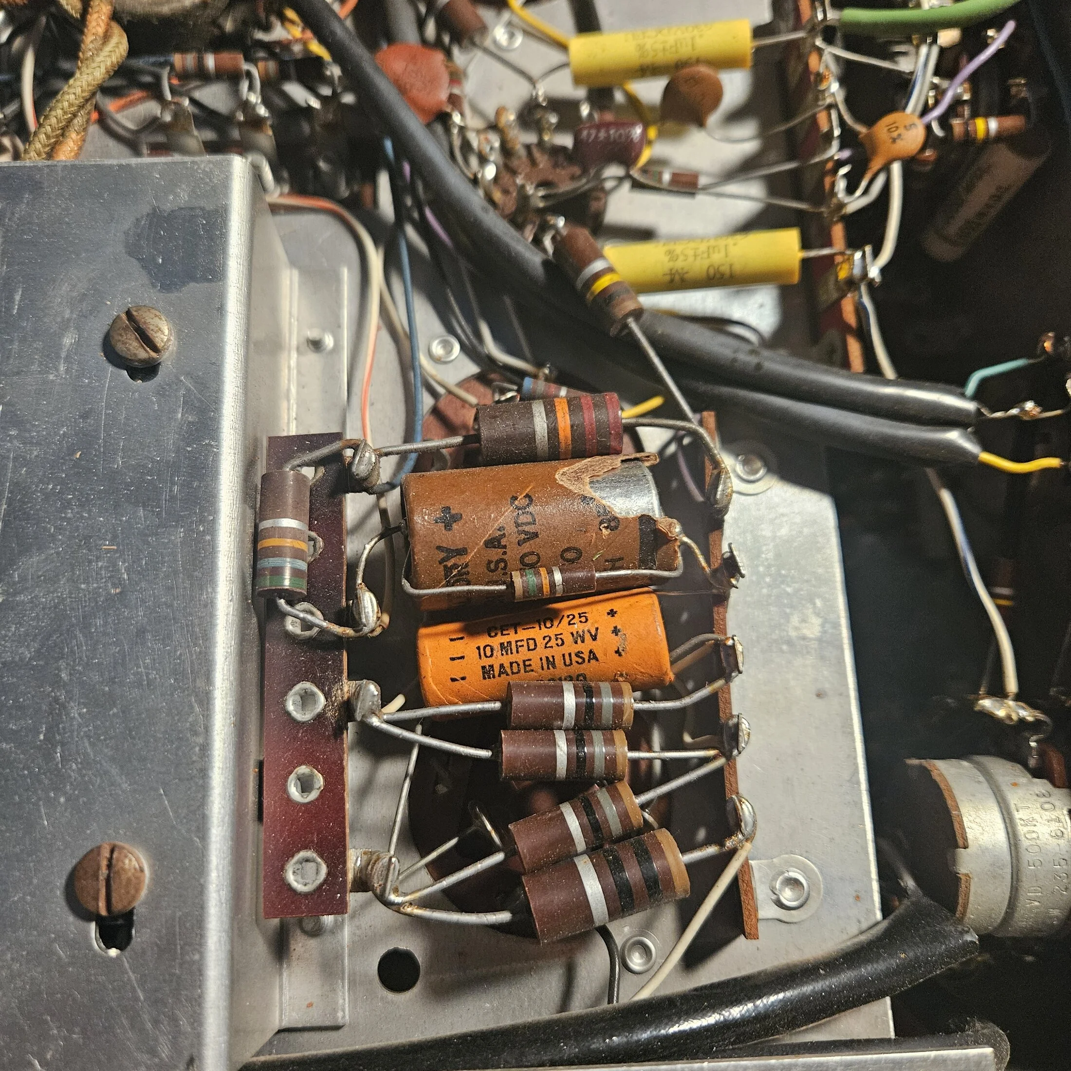

In order to chenge the caps i had to lift one terminal strip.
In order to lift it i had to drill 2 rivets and replace them with screws.
The terminal strip broke and i had to replace the terminal strip too.
65 year old plastic often doesn't like to be moved. No surprise there.
Put it all back together and im one step closer to firing this thing up.
Next step is to try and find some tubes.

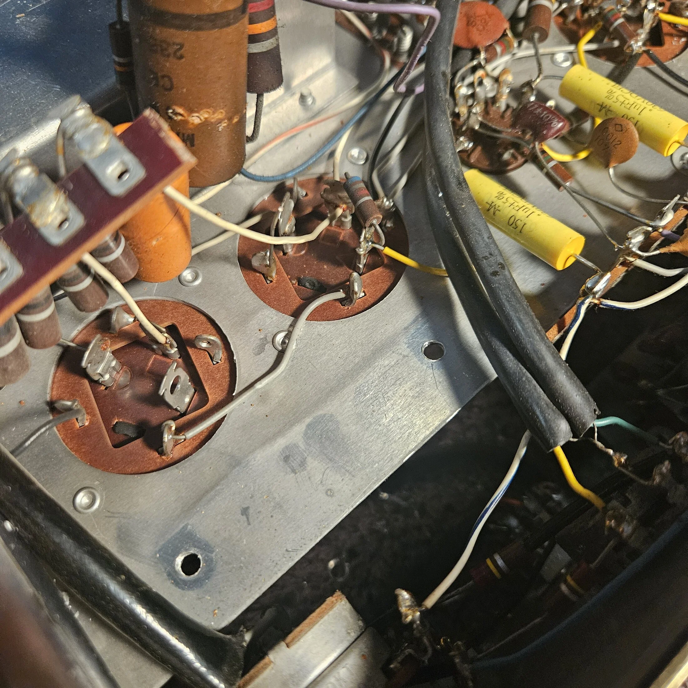

Tubes arrived yesterday and i got them in and fired up the amplifier.
With a load, on it the filament supply reaches 40v which should be about 50v
Due to the same supply being responsible for biasing the tubes the output tube bias adjustment is all the way one direction to get the tubes to bias correctly and they aren't quite where i want them.
I need to replace the old rectifier which i believe is a selenium stack with a modern silicon bridge rectifier and once thats done i may need to shift a few resistor values around to get to my desired result of 50v at the filament string and a bias supply where the pots operate near center.
Progress is being made.
I sure love to see an old set like this fire up and all of the bottles are glowing and things are looking reasonably correct voltage wise.
Its a good feeling.

Bias voltage was low due to the old solid state rectifier going high resistance.
It went in the trash, replaced it with a new silicon unit and bias voltage is on the money at 50v.
4x 12.6v filament tubes with the filaments in serries should in fact make a 50.2v string in operation right.
Its at 50v even, im not going to sweat that. The power tubes bias up nicely with even current and no red plates. Functionally things look good but right now I've got a pair of home brew, mono 6l6 ultralinear amps in my system right now, and after some more playing on the bench, the HH Scott will go in the system in a week or 2.

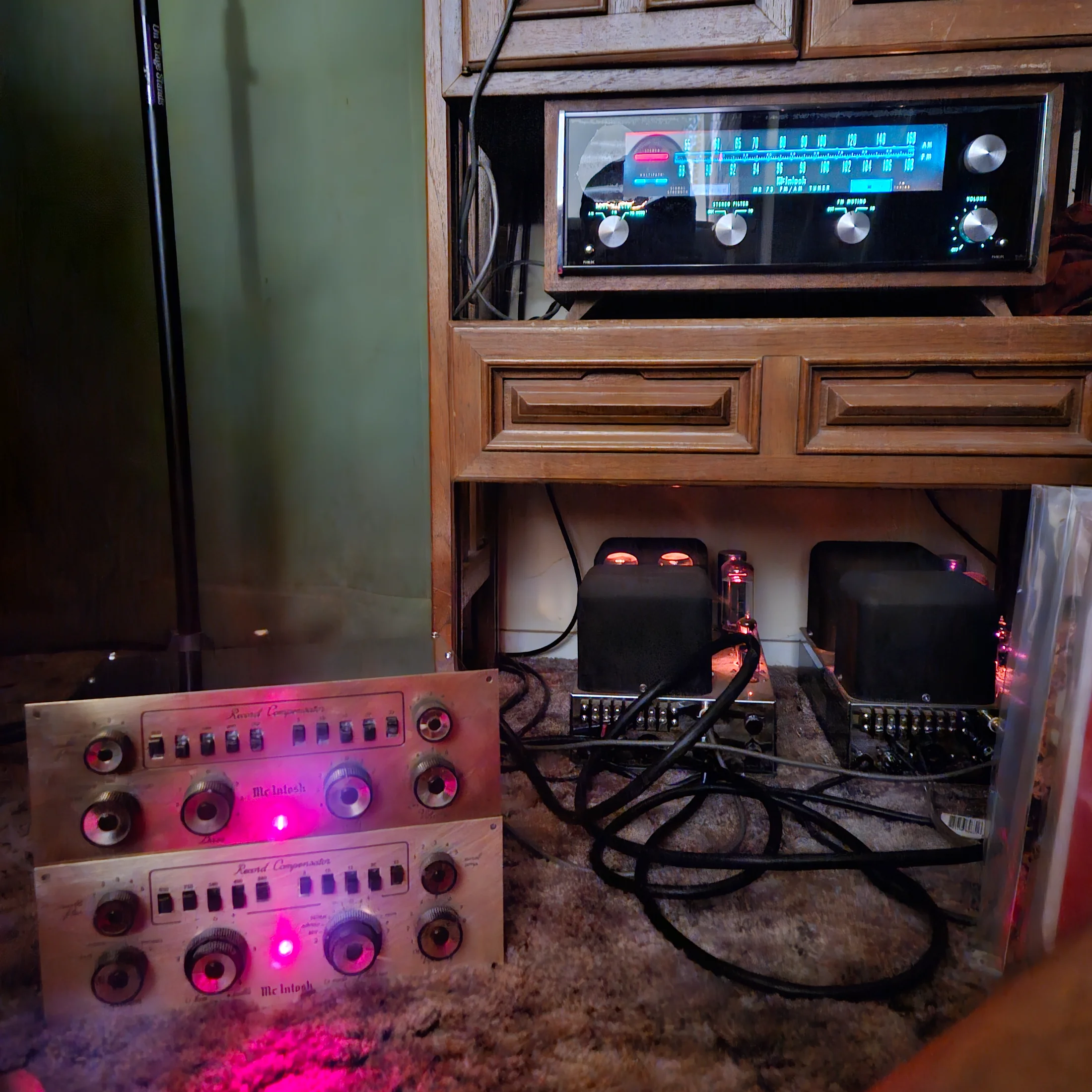

Yesterday my landmate came home to me sitting in my chair staring at the wall catatonic, water pipe in hand...
After 2 or 3 hours in the scott i decided to swap out the old board in my Mcintosh c8 for a new one id made.
5 hours later: this is your brain on drugs.
Sizzle....
Seriously working through something as complicated as a Mcintosh c8 or c8s will be like putting your brain through a chicken plucker after a few hours of it.
Its never insurmountable.
I always get it done
Once they're done and Ill have a completely rebuilt set of Mcintosh 30s with the correct preamps for stereo reproduction which actually predates the agreed upon 1958 "invention/addoption" of stereophonic sound.
Not only that, these were about as good as you could get in terms of hi fidelity equipment in the mid 1950s, and of course its all made in the USA.
Not many folks can say that about their gear
Mcintosh equipment is still made in America to this day and is still on the top of the heap in terms of overall build quality.
