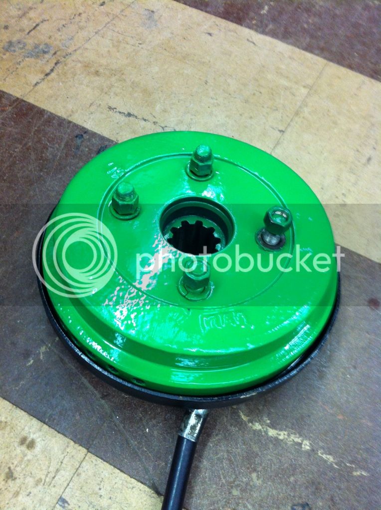

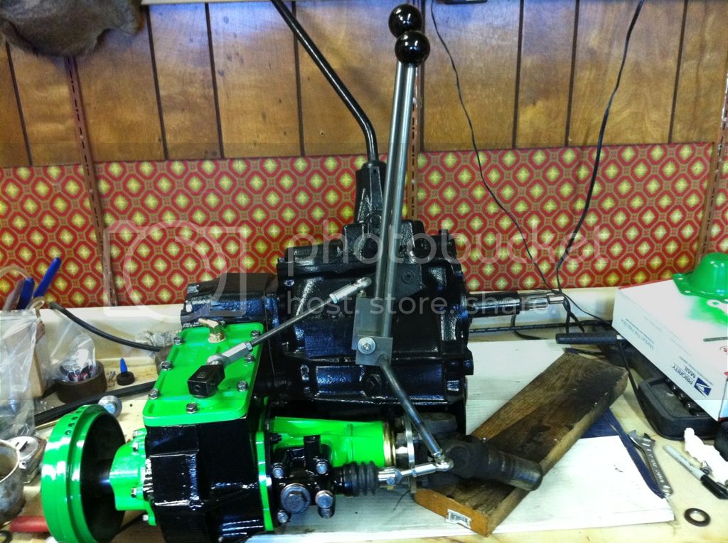

Well after a lot of thought and homework on this forum decided to go with a new TC from Orion with 4-1 gears, got it installed over the past week and wow its a big difference from the stock three speed 2-1 to the 4-1 orion, and also got from George, the twin stick set up, and that is going to be sweet also, heres a couple of pictds of the build
the sm420
the E brake
the Orion
and all together with twin sticks
bling!
thanks again rick, i appreciate the business! :cool:
i'm glad you posted the pics of the combo. now i know why you're having a hard time shifting the orion from high to low. your geometry for the upper link isn't great. you'be be way better off lowering the mounting location for the picot bolt. realistically you'd want the rod going from the top of the t-case to the shifter as close to horizontal as possible. that is especially true for the orion since the detent for the range selector is soo firm. the 2-4 is much softer and not as much of an issue.
hth
georg @ valley hybrids
