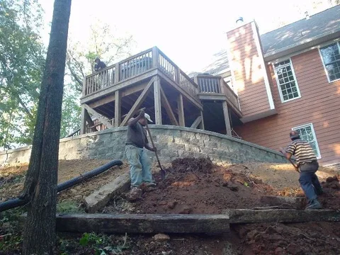

Some jurisdictions will not allow railroad tie walls anymore. Mine lasted about 2.5 years and I replaced it with concrete block. No dead mans. It is 5 feet tall at its tallest. There is a french drain behind it. I went ahead and had it done by professionals simply because the amount of money was worth the time it would have taken me. I figure it would have taken me several months of Sundays. It was done for me in 2 days. $4500.
Can't seem to find the finished pi :hhmm:
They did a great job.
