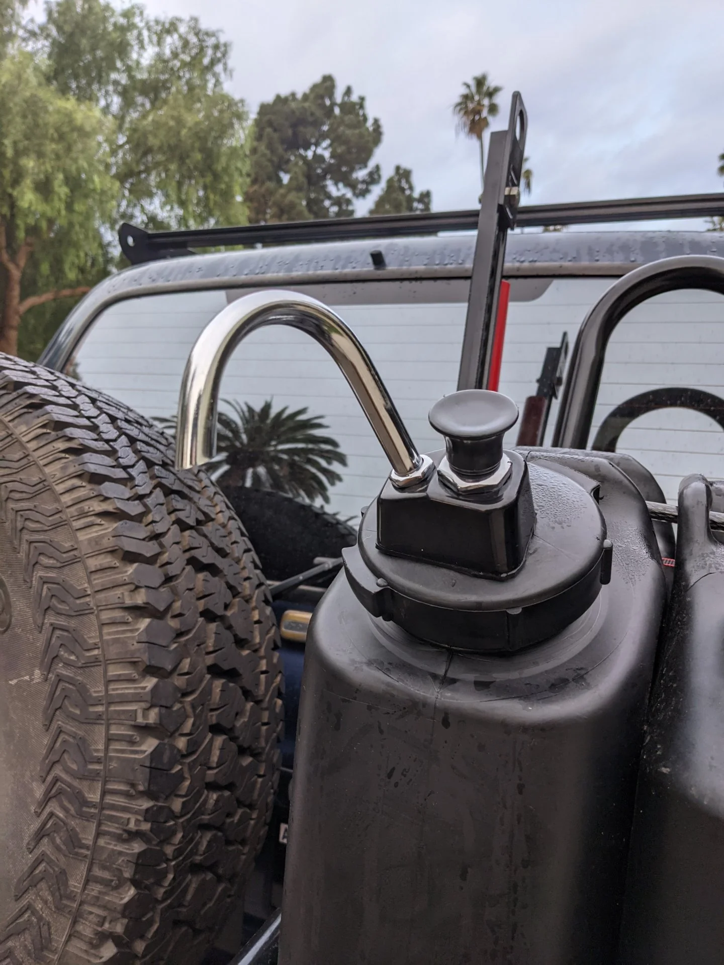

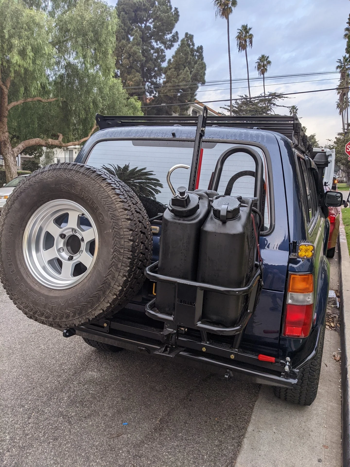

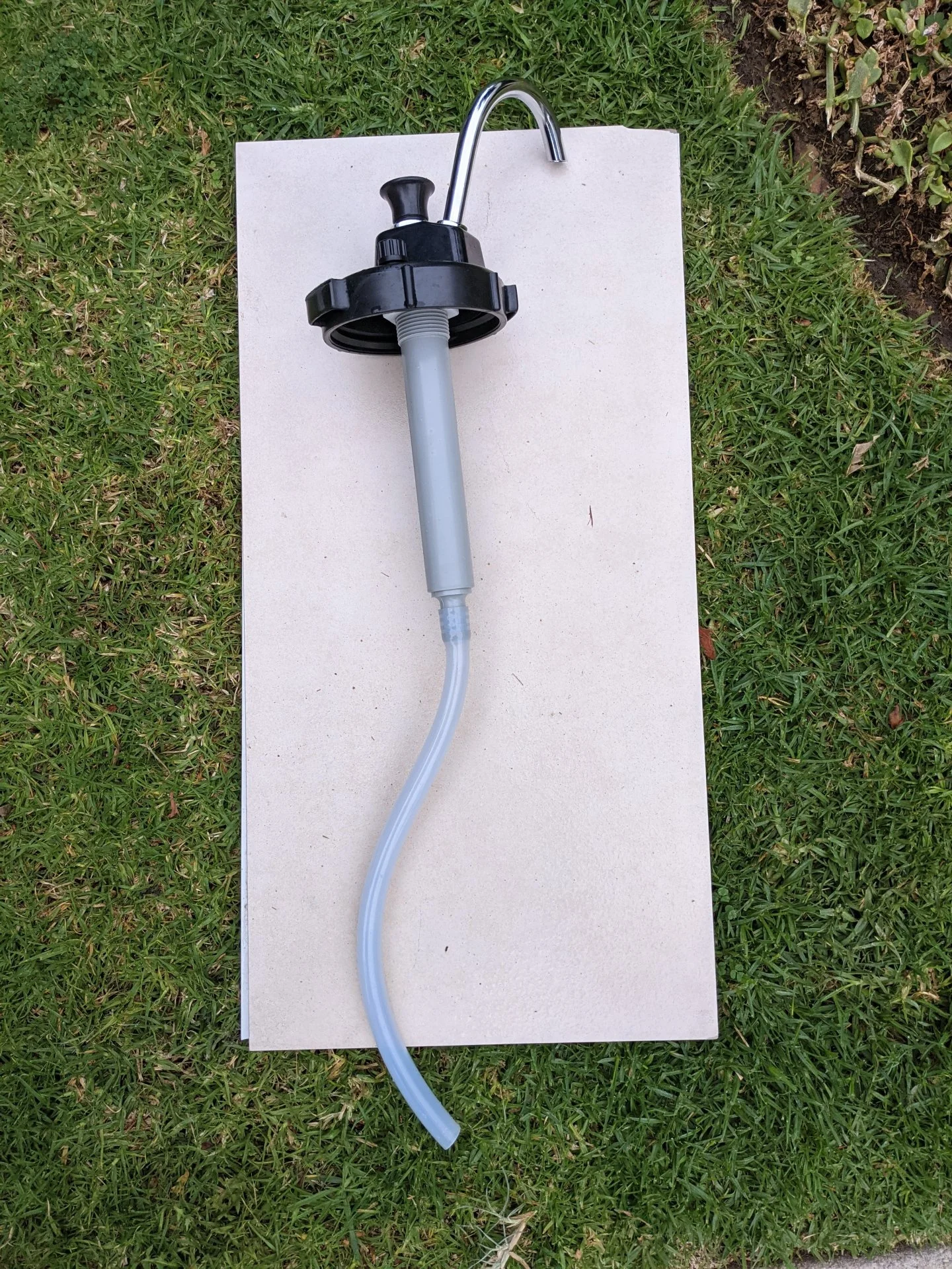

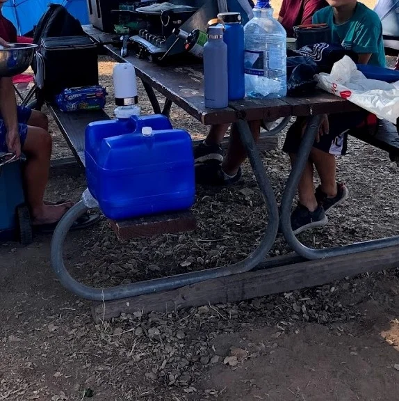

Scepter Water Jerry Can - Modified the cap to accept a hand pump, which I use all the time and it works great.
I've had this going since December of 2020 - It remains one of my favorite little additions that I use frequently.
Nice thing the Scepter water can top has the vent already incorporated - just unscrew to vent while pumping.

Heres the article that lines out exactly how to do it and what you need - Also pictures of my installation. Its been working great for me. Enjoy!

A few years ago I used the same web site/instructions and it's worked out great. It just fits in my double decker fuel can swing out - unfortunately I don't get full throw of the pump lever but it still works plenty good enough with what I do have.
Recently did it again for my 74. Nice to have rear and side access here.

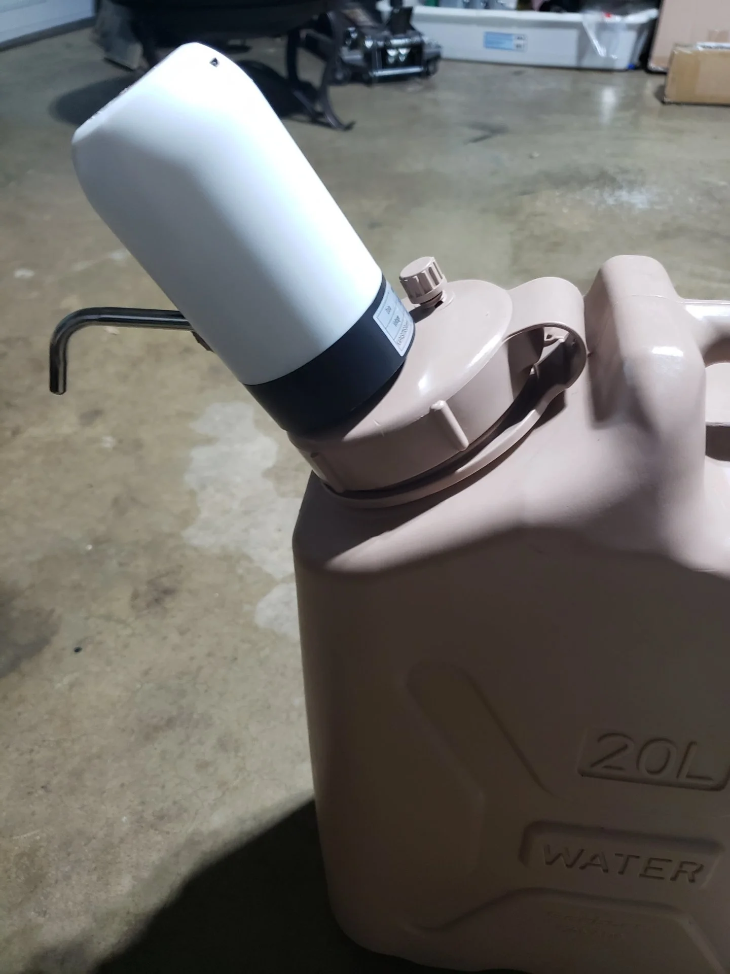

Are you saying that the OD of this pump fits snugly with the ID of the Scepter spout? That would be very cool if that's the case.
Yup, snug fit. Occasionally it'll pop off if there's temp changes over a weekend or so of camping. But for $10 or $15 I'm fine with that
I would also like to know if that pump fits directly?
I bought this one and it requires mods to the spout to work…
What are you using to store water? I'm pretty sure all the 5gal pumps are the same fit

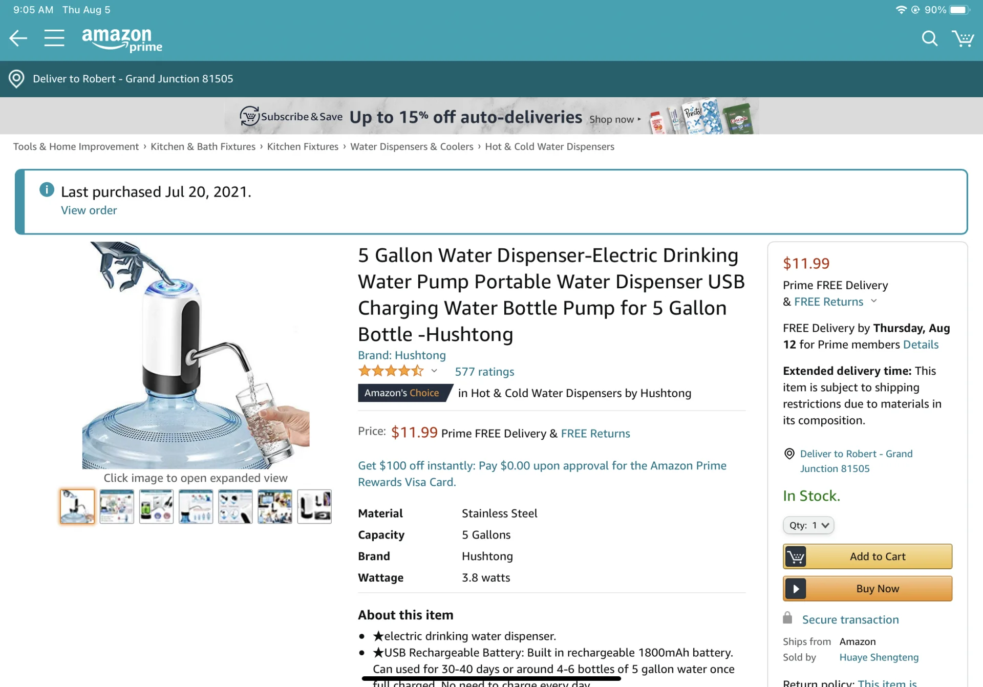

I use a similar amazon pump adapted to an aquatainer with a 1/2" plumbing fitting from home depot. After using it I gave up the idea of using air pressure or RV pumps. Being self contained, It's much easier than dealing with air or electrical pumps, just attach it and you're done. The battery is supposed to last for about 40 gallons of water, so more than enough for a few trips and easy to recharge from any USB source
The only minor downside is that it's not high pressure, but it's more than enough for hand washing and cleaning. I actually prefer having low volume/low flow because when I used a RV style pump my water consumption went way up because it's overkill for most things like washing hands.
