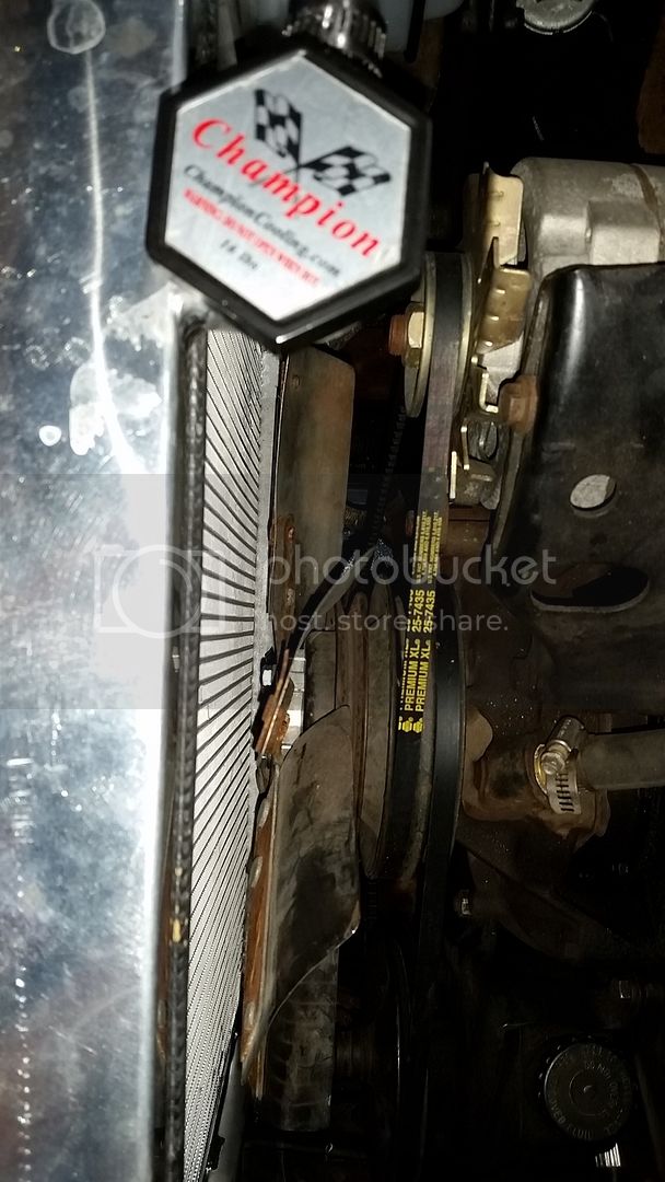

In my situation I have (not trying to have diagnosed, just offering my info/findings as I go):
earlier (late 70's) SBC with rebuilt quadrajet, MSD ignition, unknown (guessing 180) t-stat to be replaced, PS and trans cooler out front, Champion 2 core aluminum rad, and the smallest (all I have room for) Flexalite fan possible within 1" of the radiator, no shroud, engine placed far forward, fenders cut for over-frame headers. Radiator had to be moved as low and to the passenger side as possible (due to clearance issues between fan and trans cooler built into the Champion rad). Sensor is in the head, for a new Stewart Warner gauge. Carb is yet to be adjusted (picking up a vacuum gauge to do that today) and timing is set based on idle alone - since there's no pointer (useful). V-Belt system. 16psi cap on the radiator, no boiling over, no leaks. In fact the cap never opened to release/pull water from the overflow tank.
I used an IR sensor - I was reading 225 at the sensor in the head and 203 at the inlet. I had a very low reading at the lower part of the radiator, so I'm not going to post it as I don't completely trust that reading.

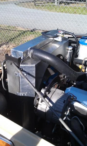

You've hit on the most important issues. I've applied most of them to my 40.
  • Engine placement in typical AA/Downey recommended location.
  • OEM GM mechanical fan
  • 19x26 Aluminum cross flow radiator
  • 195 t-stat.
  • 14-16 psi rad cap
  • Custom aluminum shroud
  • Trans cooler in front of radiator
  • Good running 5.7 TBI
Zero overheating issues.

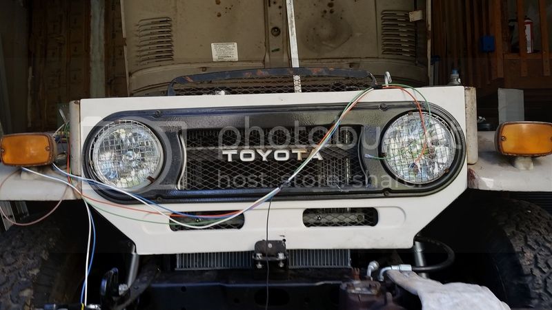

If wanted/needing high res photos I'll put the S5 down and get out a real camera....
As for my rig, as I said above:
I did not place this engine.... and had I done the research on this issue a couple years ago things would be different, but.... the plan is to do what I need with it in it's current place.

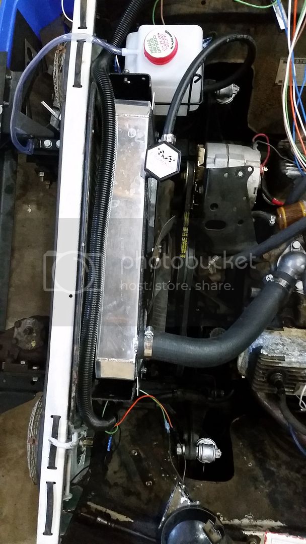

Update:

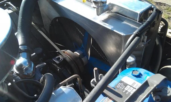

Yesterday I bought a 195 t-stat.... pulled the 'newer' (almost zero miles) tstat out, it was already a 195... swapped it out anyways just in case. Picked up the vacuum gauge and plan to tune the idle AFR's today.
Measured the fan - it's a 15"... I *might* be able to fit a 16" with the new radiator placement, but it's close to the lower cooling tank. I may consider seeing about finding some 1" strip foam to place against the radiator brackets so that air can't go around through the grill, but other than that the radiator is still well placed in front of the grill and the fan is less than 1" from the radiator.
I've literally only driven it around the block (up/downhill) about 1/2 mile, but it gets up to temp quite fast (been in the 80's here lately) and it's been around 220 +/- a few degrees per the gauge at idle. Never boiled over, but just trying to ensure bases are covered.

Now that I've seen your photos I think you have real problems.
(1) Normally you'd mount the Rad lower so that fan does not cut through path of the lower radiator hose.
(2) Normally you'd be better off with a big 17" or 18" air conditioning fan blade, 7 or 8 blades, heavy pitch on the blades (fan thickness).
(3) Yep, your engine is way too far forward, won't allow use of bitchin fan choice, this will plague you until corrected.
If your's is the long water pump you could go to the short water pump for more fan clearance, but then you'd also have to change alternator mounting brackets, and probably pulley pac as well.

Your truck looks like it had the engine installed by whoever put the 283 in my truck. It is way too far forward, as outlined in this thread:
https://forum.ih8mud.com/threads/at...-worms-v8-location-clutch-replacement.818767/
I'm in about the same boat. The truck runs cool enough (about 200-210, usually, 225 in traffic) but not as cool as I'd like it. I'm running a stock FJ40 radiator (brass, 3-core, I believe) and a 180 degree thermostat. I'm running a rigid, belt-driven 16" fan that's about 1/2 in from the radiator with no shroud.
My plan is to yank the engine next spring and re-do everything. I'll be dropping the radiator lower, as @Downey mentioned, to center a larger (17") clutch fan with a heavy duty clutch and proper clearance from the lower radiator hose. A heavy duty clutch will cause the fan to spin at about 80-90% of the water pump shaft speed when active, and shut the fan down (free-wheel) when not needed. The engine will be getting moved back in the engine bay to the generally recommended mounting location. Seems like the general rule of thumb is to leave an inch or two of clearance at the closes point (passenger side valve cover) to allow for proper airflow around the engine. This should allow for both use of the clutch fan (with a short water pump) and a fan shroud. I'm still debating whether to use the 50/50 rule, or go completely out of the shroud per Downey's comment.
I am either going to re-core and repaint the existing radiator, if I can find a decent shop in the area, or replace it. I haven't figured out yet if I will replace it with a Champion or another OEM one. My understanding is that if everything else is set up properly, either will work.

to be fair - regarding a bigger fan, there was/is clearance to the lower hose.... When I had a stock radiator it did clear everything (with that fan) in the radiators stock location/mounts - it was the Champion fan wit the added 1/2" or so that juts out for the added cooler that is causing a clearance issue.
What I *might* be able to do.... is find a 17" fan and lose the 1/2 spacer.... but that may be too close to call....

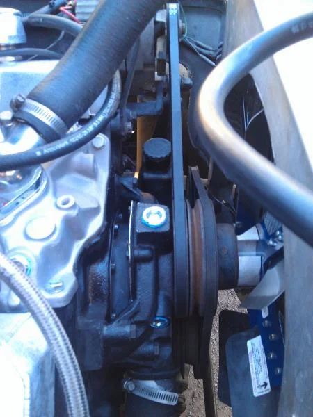

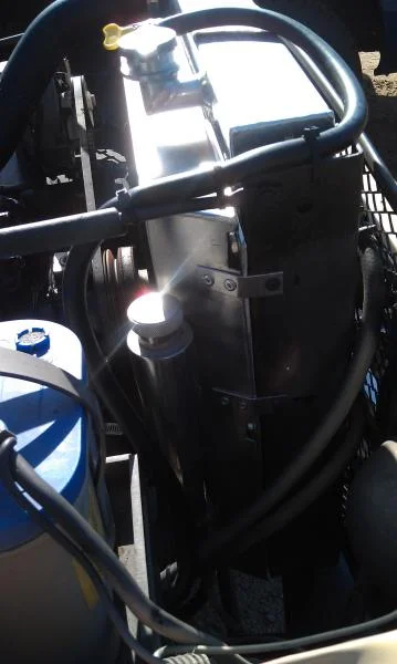

Well I'll throw my 2 cents in....This is what I am running currently and everything is running good.
Fan: Flex-a-lite 7-Blade Fans 1817
Water Pump: FlowKooler Hi Flow Mechanical Water Pumps 1668
Fan Shroud: Speedway Motors Aluminum Fan Shroud Kit
Radiator: Ebay Aluminum Radiator 3 core
160 degree thermostat.
Around town in the hot summer months I average around 195 degrees.
