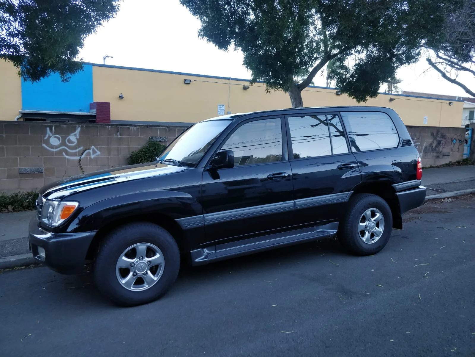

After months of research and years of wanting to buy a LC. I found a great looking 100 series(2001) with 175k miles for $9400 in the mid west with a clean title, clean interiors and 9/10 body(It looked beautiful).
Unfortunately I am in California and couldn't travel to see the car due to Covid.
I did get it inspected at a local mechanic chain and was told the car looked in great shape apart for some under body rust, needing all brake pads, rotors, wheel bearings, valve cover gasket and stabilizer links.(estimate of $2k). And based on what i was finding around me, i couldn't find an LC with those miles under $16k-$17k. So, i went ahead and bought the car.
But after receiving the car, i got it looked at by a local mechanic and his inspection came back really bad. Mainly to do with the rust and issues caused by the rust(front control arms, ball joints, bushings, all shocks and struts). All in all an estimate of about $5-$7k not including saving the under body from the rust.
My knowledge in cars is minimal but i was looking forward to building it with the help of an LC and to turn this into an Overlander. But is this a lost cause?

Thanks for the suggestions. The body has a couple of dings but nothing bad at all, very little bubbling right behind the front driver side wheel well and some rust on the inside of the liftgate.
paint is in great shape.
