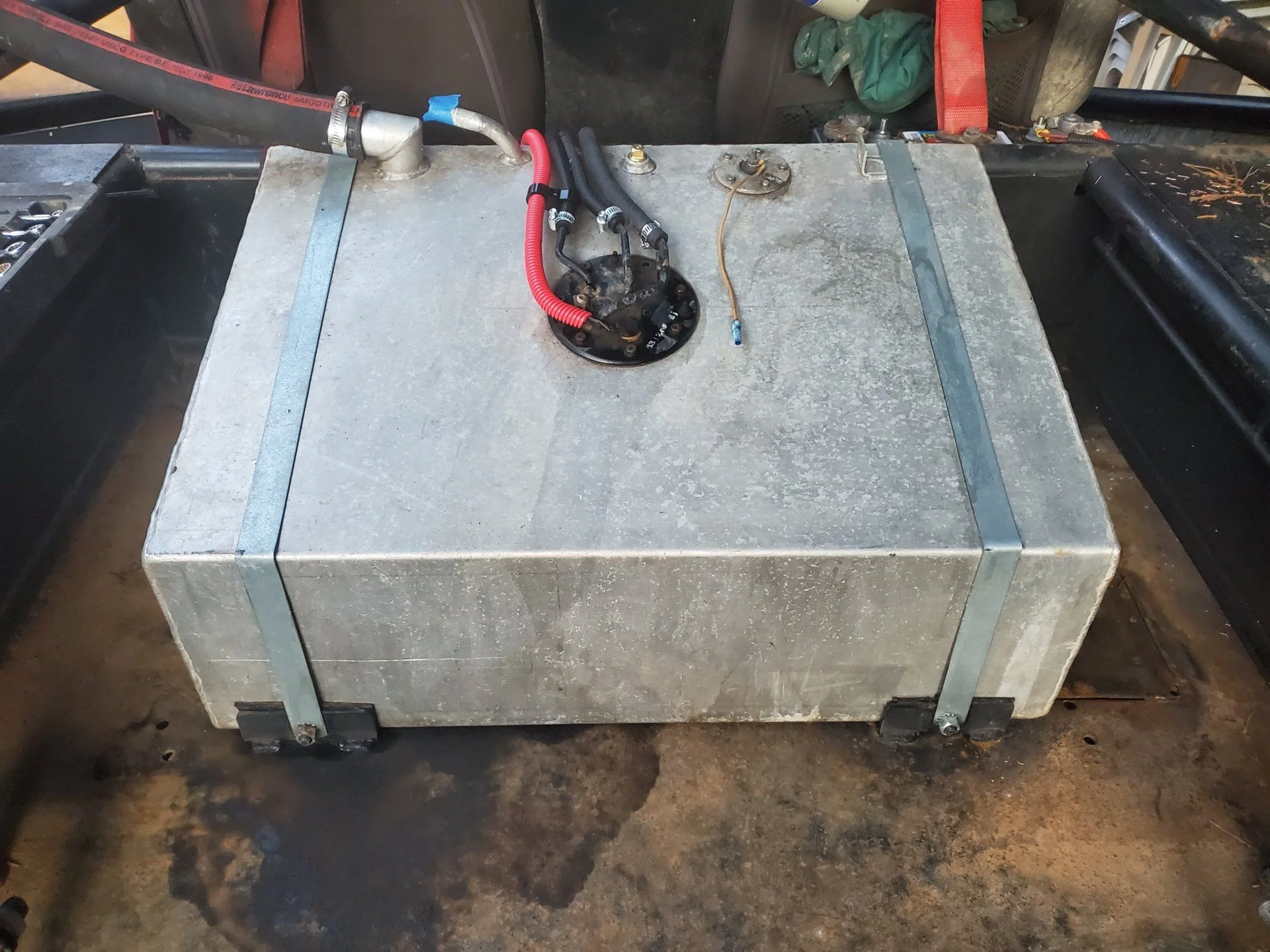

probably the last major component left untouched was the fuel system, that had to change. The factory tank had been beaten into submission and the bottom was, lets just say less than flat. No pic but the bottom had been so badly indented that the fuel pump bracket sat about 2 inches higher than normal.
So, did this.

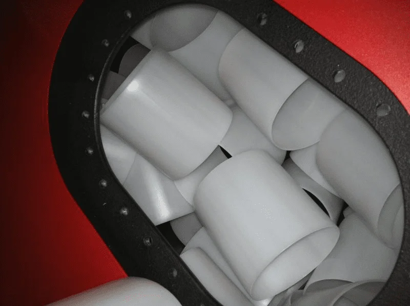

There are no baffles in the tank which i have major concerns with, been thinking about adding in some form of these. Shown below is Alltech's fuel cell baffles but these puppies are $200. From research pretty much anything made of HDPE plastic will stand up to the constant submersion in gas. Have heard of wiffle balls, gatorade bottles etc. being used, kinda runs the gambit.

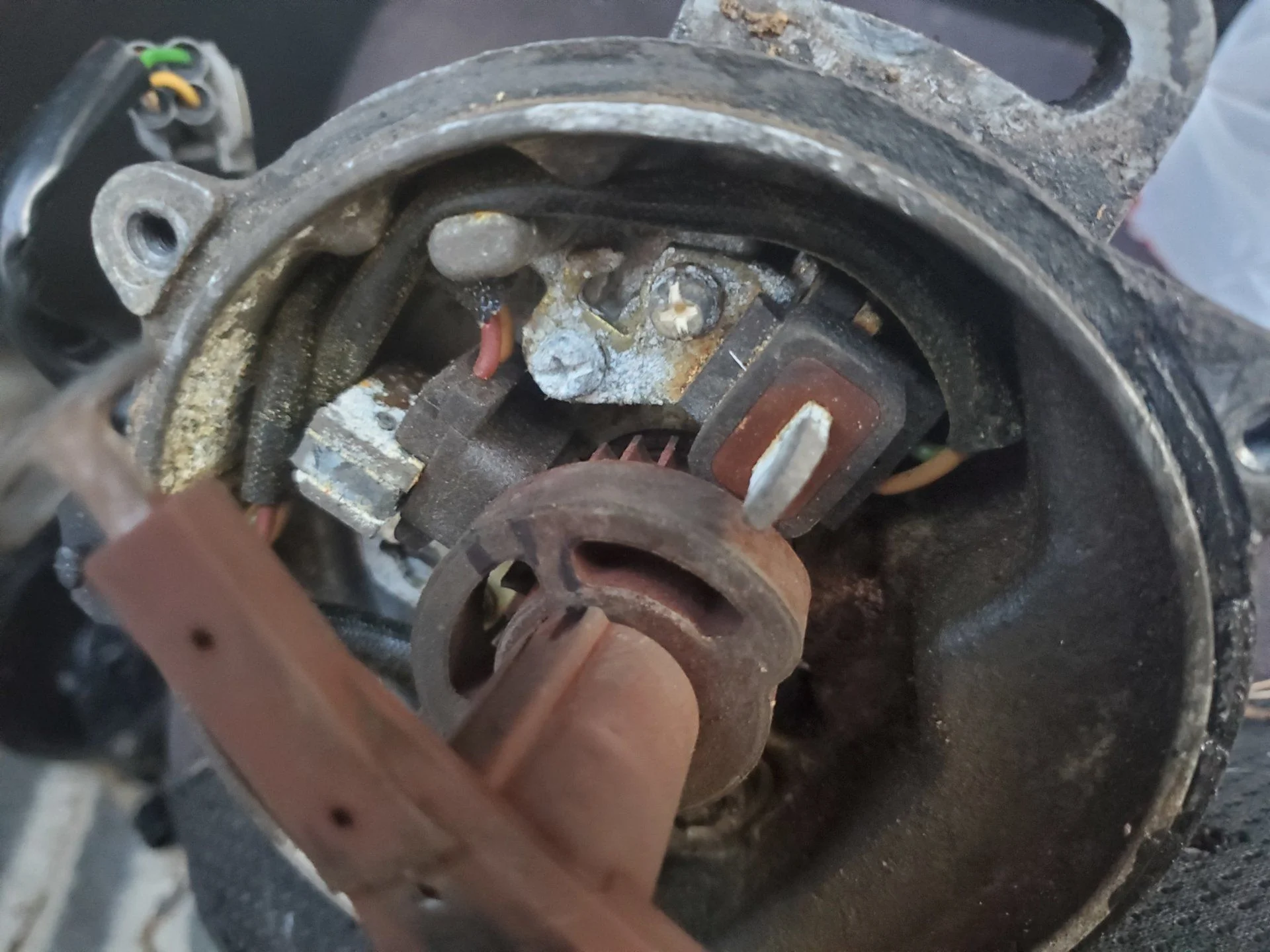

  • distributor (last night - motor runs but dont know yet)
Here's the old one
If that fails gonna pull the entire EFI system and intake off my spare motor and install and cross my fingers.

What about just using fuel cell foam in the cell ? It is relatively cheap and reduces sloshing a lot
looked at it, read about it but no first hand expereince. While I'm sure there are varying degrees of foam quality overall it seamed to have a reputation for breaking down over time and clogging fuel filters. Since I've already stuffed it with a bunch of HDPE plastic baffles I'm gonna give it a go and see what happens, if it fails I'll let ya know.
