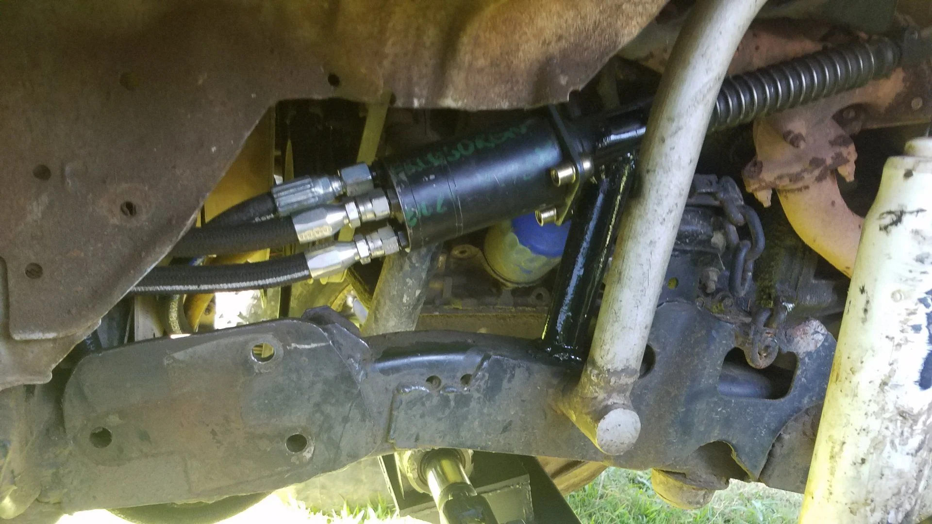

WOW..... That ram maybe to small. Might should think about getting something bigger. :moon:
Bigger is better, ask your my wife. :smokin:
Besides, it retains the Toyota authenticity, came off a Toyota Fork lift.
Are you running the stock pump? Might not be enough considering it's original intention...
running stock pump right now, well an aftermarket stock pump anyway. It should be sufficient, i know John is running an 80 pump and it works well with his and I believe the V6 pump is of similar specs. I'm hoping mine will work as well but won't know for sure until it's all hooked up.
If not, there is a plan B in the form of a Saginaw pump replacement. I have a link buried somewhere in this build thread but can't find it right now.
Orbital never did show up so why have one when you can have 2 for twice the price
Anyway, hydro fully functional and love it!! Now just need to strap the hoses down and clean it up a little, probably add guard to the axles housing too.
