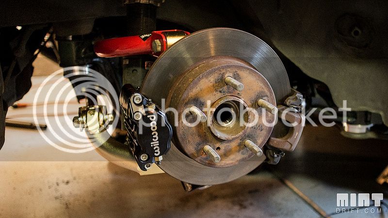

How are the rear brakes working out? I know they are better then what you had before but can you actually stop now without downshifting?
The disc conversion has been a good upgrade and they're working far better than before.
But, I think I still have work to do, the pedal still seems a little soft. The MC is only 3-4 years old and was new when installed, have new brake lines front and rear so I'm thinking brake booster maybe(?)
