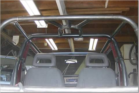

got the cage all put together and it is very nice.
47b8da29b3127ccea87715db494200000016108AYsmLJs1auQ
47b8da29b3127ccea87715d9494000000016108AYsmLJs1auQ
Nice build. As far as pre-fab tubing work goes, that is a very nice cage.

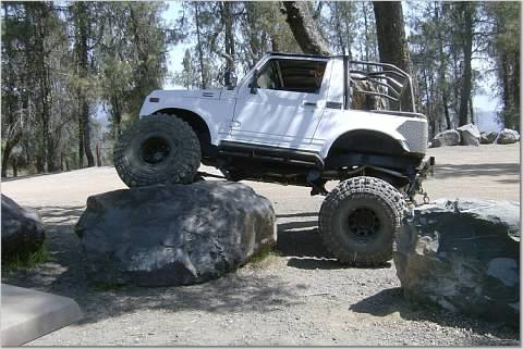

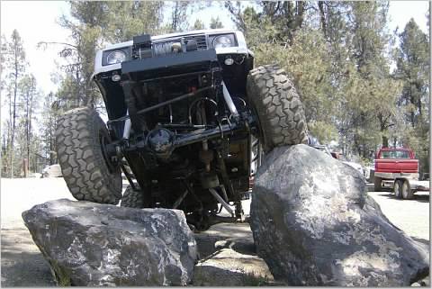

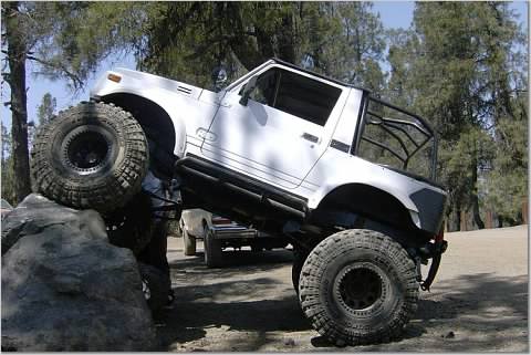

Went up to Cow Mountain for the day. Here are some pics. I'll get some video soon.
