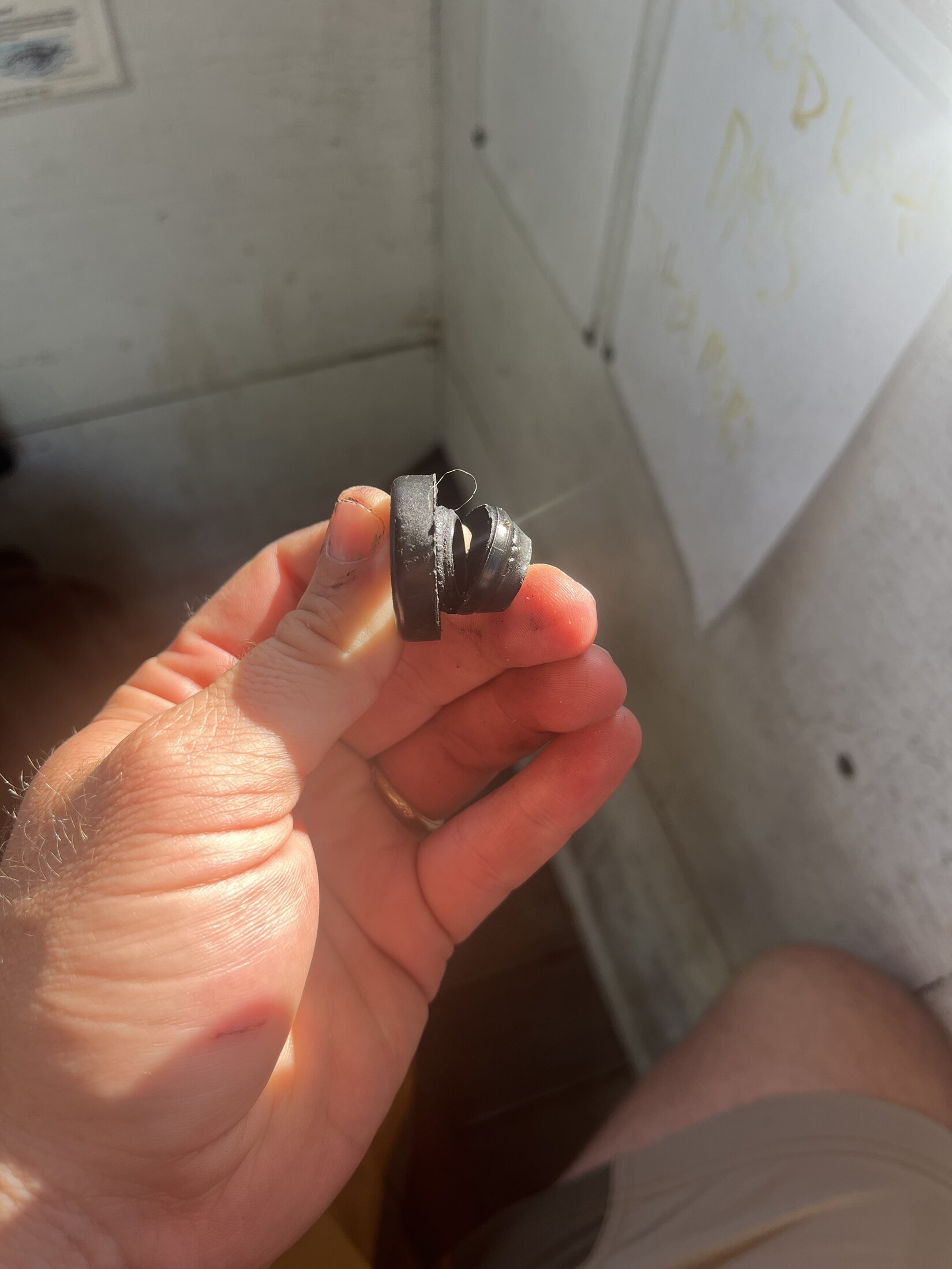

So a few small updates: I wanted to share how bad this pcv valve grommet was. Its actually Idling much more consistant now. I was having a hard time with idle adjustment and for the life of me could not get it to be consistant. one day it would Idle perfect and the next day it would struggle. I sprayed flammable break clean everywhere to find a vaccume leak or somthing too and nothing stood out. From the looks of this grommet I dont think it was doing much.

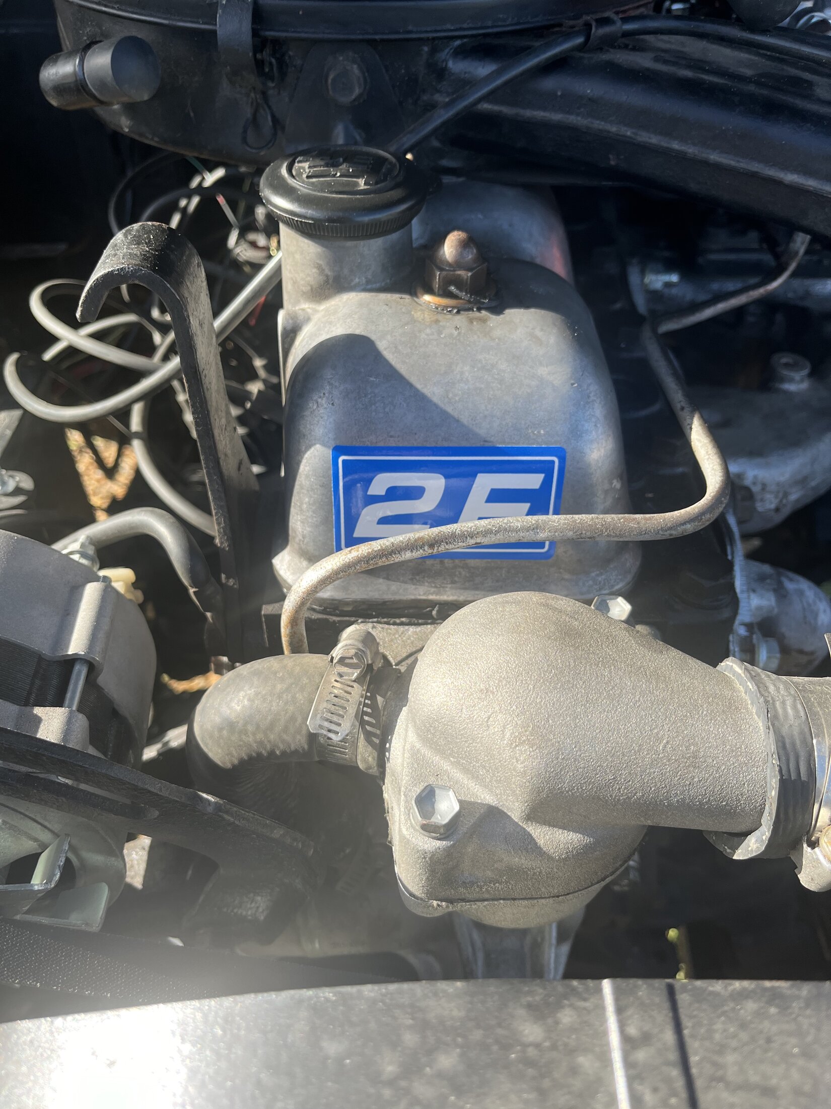

Stuck the 2f sticker back on... the old one I pealed off to put the valve adjustment specs sticker on. Additionally I have a new grommet for the valve cover coming. The age old story of I should have bought oem. these valve cover bolt grommets came in a kit and started to dissentagrate as soon as I did the first valve adjustment. I have new ones coming.

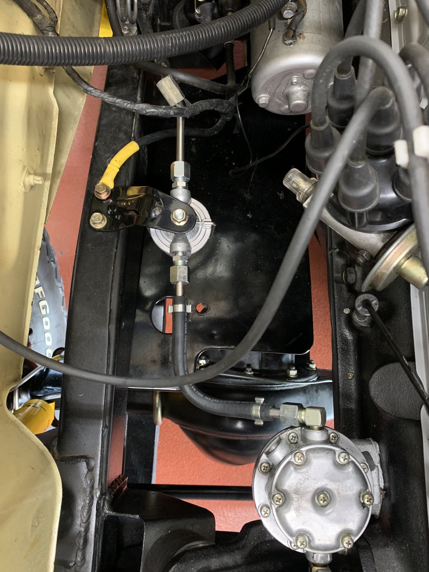

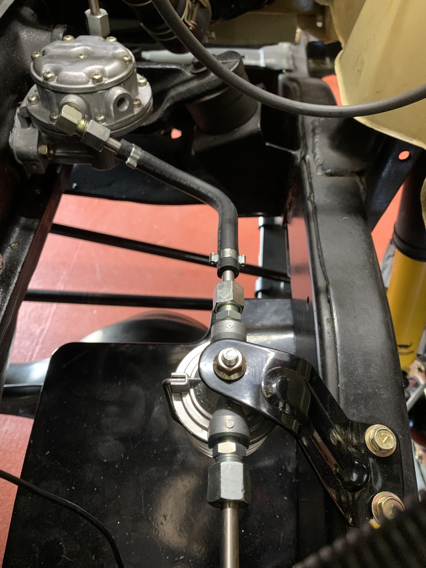

other notes: I want to put an older style glass bowl type fuel filter in. (might go with the one with the metal bowl because they are cheep) I found the bracket that hangs off the battery trey. but I am wondering what everyone is doing for the fittings to the filter? I dont really want to buy the redline ranch clear tubes because $$$.

I believe that @ToyotaMatt has the fittings for conversion to the glass bowl fuel filter.
I think I found some fittings on amazon in 1/8 bsp that should work. to run a ruber line to the glass bowl filter. will report back when I get all the parts in. if not I think I have some left over fuel line that was return carb line that I did not use that I might be able to flair and make work.
Photos courtesy of @Blastservices , his personal skill-set bench-mark work i can say is top-shelf ./.........:wrench::wrench::wrench:
this is the most up-date / modern materials with a purist based mind-set approach i have ever seen to date in my little toyota world , :)
safe , factory fit form and function ,,,
