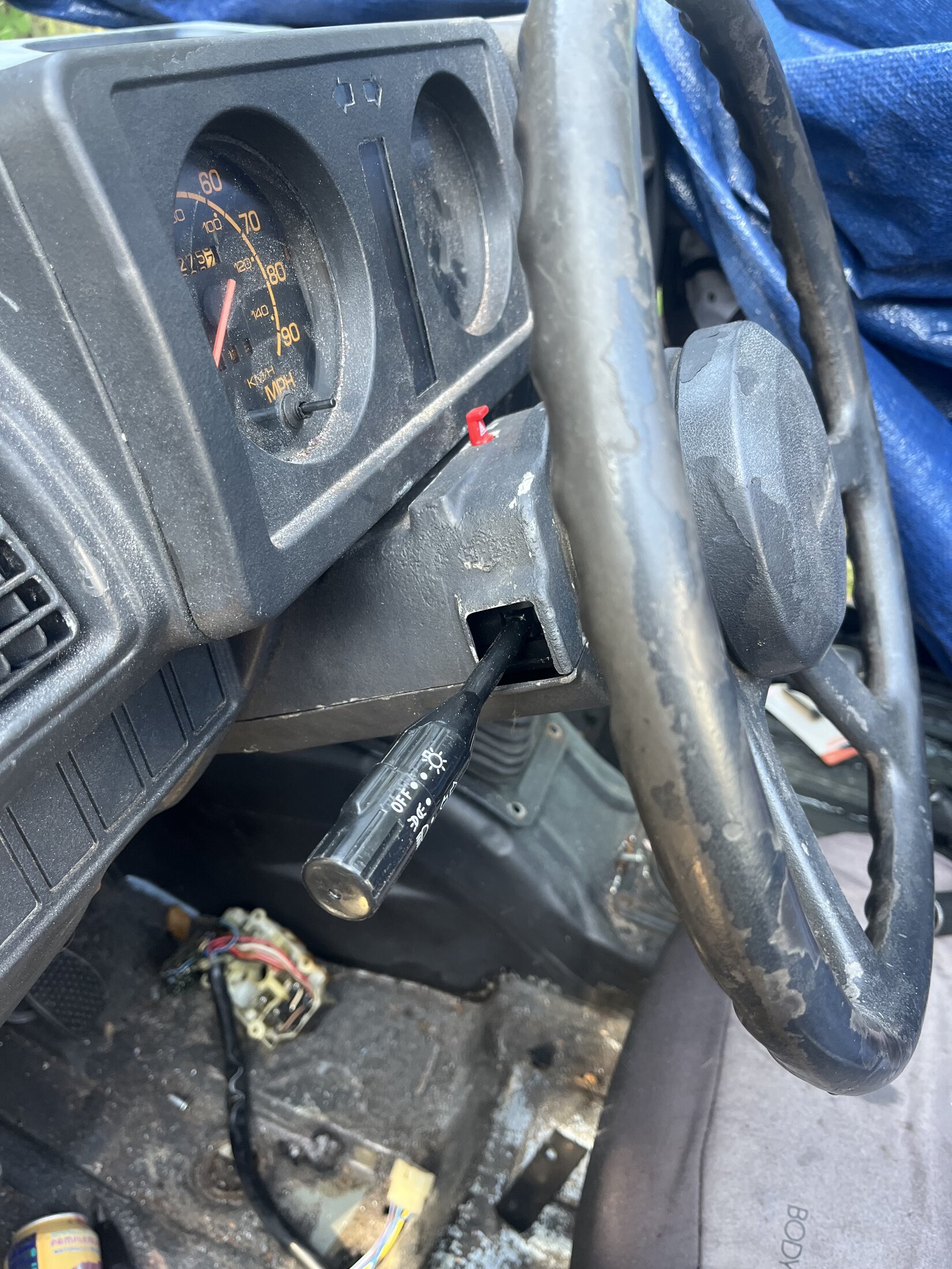

yesterday I reinstalled a new blinker and wiper switch. Honestly looking at it I should get a new steering wheel. its pretty gross looking. IDK if I can strip whatever dash paint sombody threw on it or not. The dash was painted too but I think I can live with it. maybe even sand and repaint the dash and it may look better. also the column cover will be a good candidate to replace as well. Luckly fleebay is littered with steering wheels for these. thinking a basic one from the prior pre 1988.5 dash.
