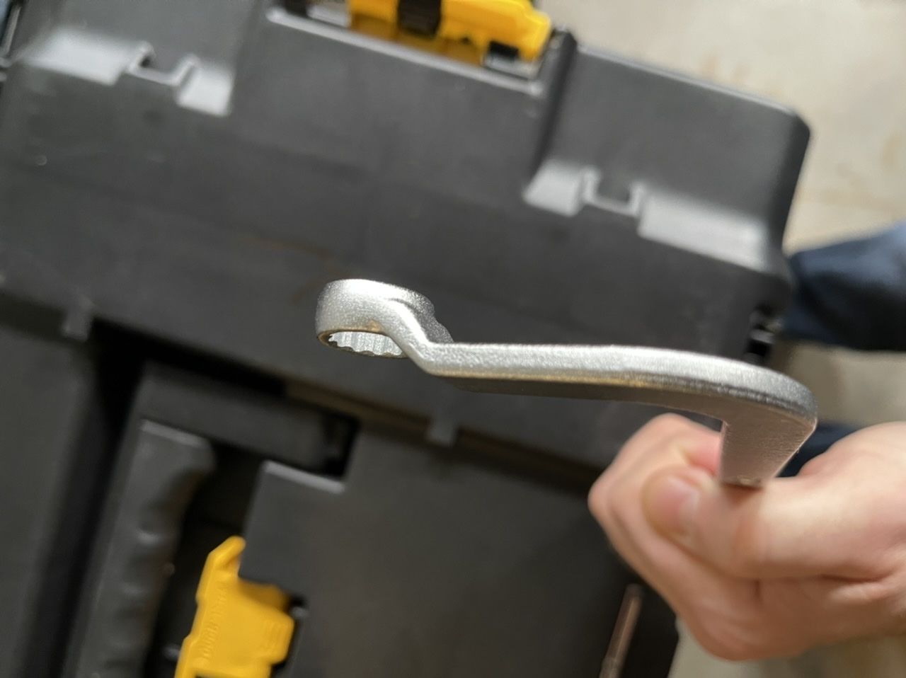

The wrench @Ayune linked is 11” long, just used it today. Felt just about right to me, and can’t see adjusting the body side bolts without it (or something similar).
EDIT: And from a failure mode analysis angle, I bet the door starts to sag from people pulling themselves up or down from the cab, which eventually misaligns the striker, and that’s what ends up causing the pins to get sloppy. Caught mine in time, it’s still tight and was just moving the door a bit each time I closed it.
EDIT 2: And the thing about the full size tool that makes this so easy is that the head is offset out of plane with the body of the wrench (different offset on each side, for driver and passenger doors), so it clears the hinge easily. A flat s-type wrench or fan clutch tool wouldn’t be so easy to use.

I'd imagine the offset would make this job much easier. The short wrench is long enough for the most part but it hits the hinge lip because there it's no offset...
The sunex wrench set on Amazon's 12/13 s-wrench is 6.5 inches long

I assume yours is the JTC 4093 $40 12mm both end?

Yep, thats the model I have. Longer would work too, but find something with an offset head if you can.
Has anyone used the longer wrench mentioned above to adjust the lower hinge without removing the door? The lower hinge bolt closer to the front of the car is deep in there and feel like accessing this bolt might not be possible even with the longer wrench due to inadequate clearance. With the shorter 6.5 inch long wrench it is not possible to get to that bolt with the door on.
my adjustment with the 11” wrench was all made with the door still mounted. But, Similar to @Ayune I didn’t even touch the lower hinge.
EDIT: Just checked, the 11” tool also reaches both lower hinge body-side bolts with no issues.
