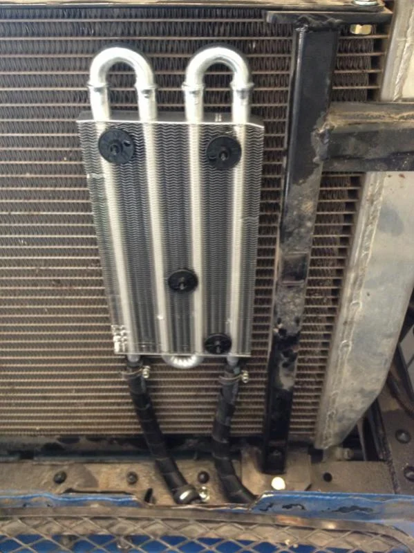

Had some time today and went over to summit to take a look at some coolers... Seems that I WILL be able to make a radiator cooler work. Dropped the bib and measured. If I got a 3/4 in thick cooler, it'll work.

Got the cooler mounted in front of the rad. Today, now just trying to find the cleanest and safest way to run the lines.
It would figure... I have a fellow cruiser head my roll of spiral wrap (that I haven't used in the last year) and of course NEED IT for this project!!! DUMB!!!

Once, in the driveway, moving it around, the PS pump puked fluid (ATF) out the top. Only once, but I've heard about fj60 pumps doing that. No issues during Rubithon after adding a cooler. I only did it for something to do. I had noticed my PS lines had color from being hot before. Since I did it, the PS gearbox output line has been cool enough to touch any time I checked.

Not that anyone really cares to see my "hardcore" power steering cooler install, but here are a few pics just for the sake of thread completion! :)
