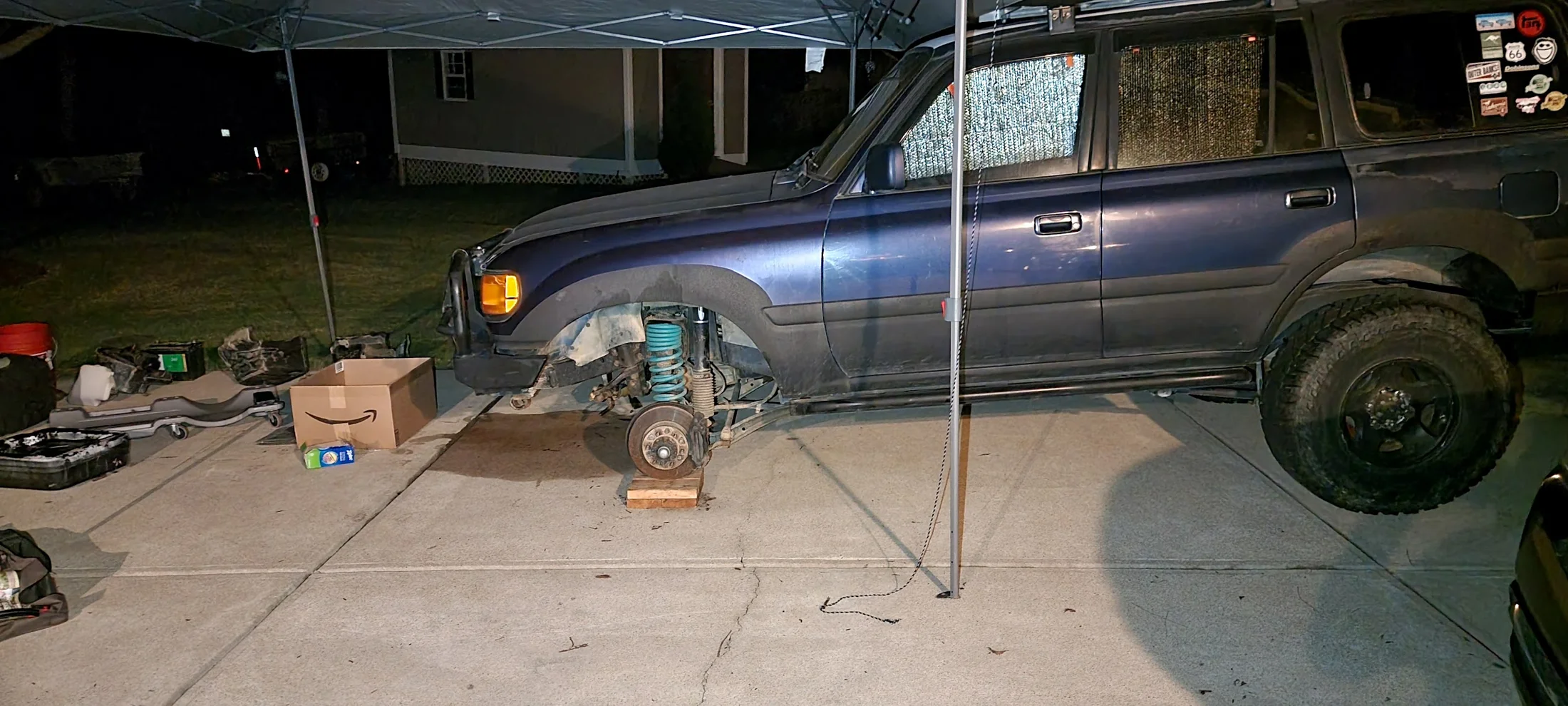

I just lowered mine down on the rotors. I cut my dust shields on the very bottom to allow rocks to fall out. Tire is just sitting beside the wheel well in the pic. BTW, this made doing the headgasket even for a 6'2" person so much easier.
I often say that I learn something every day. It never occurred to me to cut the bottom of the dust shields. This is today's enlightenment. ;)
I have had to pull tires and pry dust shields out more than once to remove rocks. Once on the trail even as the squeaking was so loud it was unbearable! On my older rigs that see more time on the trails than on the roads, I just remove them. But for the '80... I like this approach.

I got the idea after we picked up some rocks behind the dust shields while in Arizona. We were 2200 miles from home and the front end on the Cruiser was making a god awful noise. I thought for sure I was going to have to abandon the trip and have the Cruiser towed all the way back home.
I don't have a picture but I only removed about an inch from the bottom. Enough to remove the lip that holds the rocks in and make the rotor the lowest point.
