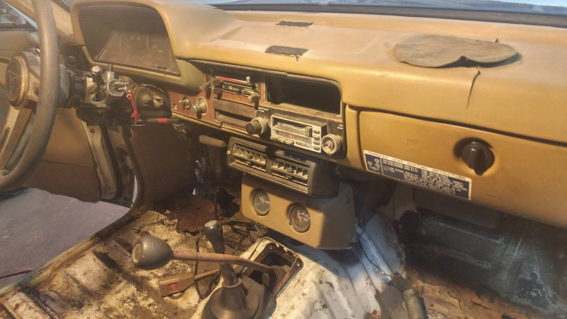

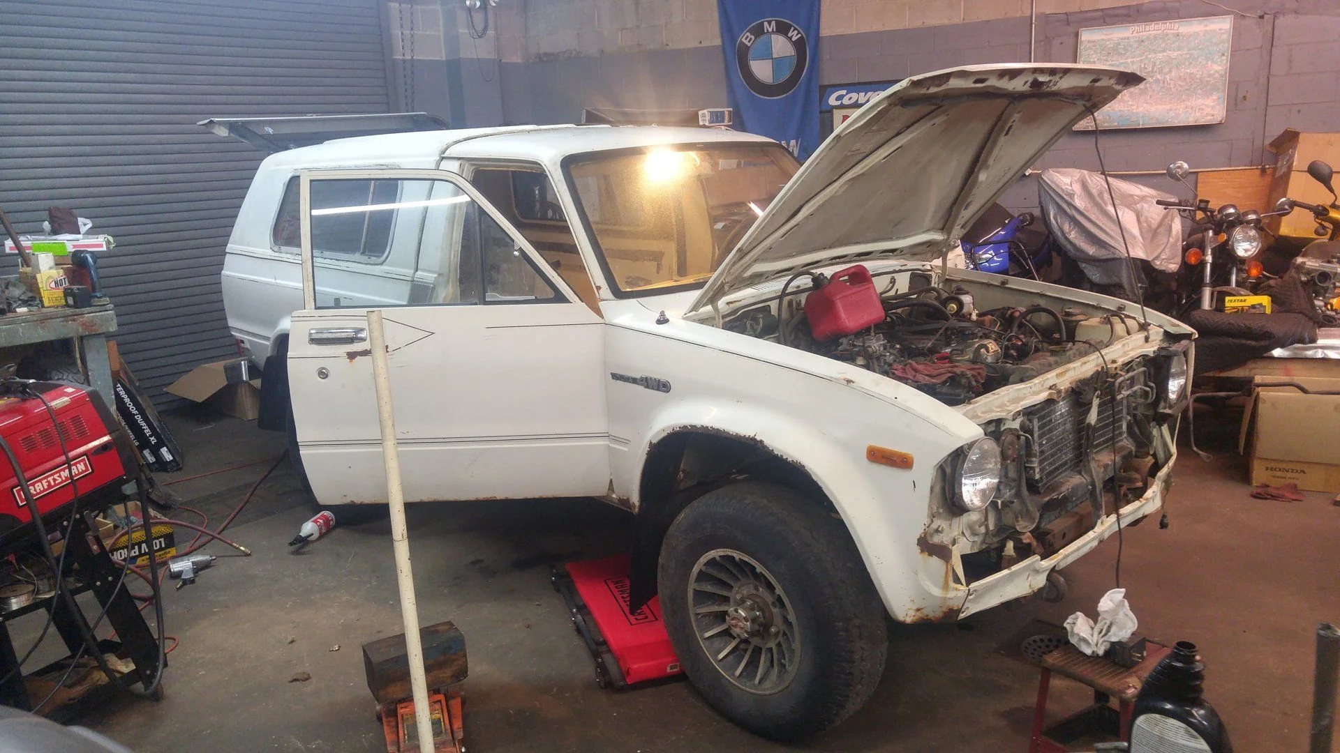

So, I bought a rusty Trekker a few years back.
I got it to run, got it to move and stop and then I tore it apart.
Floors were completely shot!
The sliding rear windows in the cap must'a leaked from the factory, this truck spent its entire life with a soggy carpet. Other than that, the frame is solid and it's a legitimate Trekker with dash plaque and all.

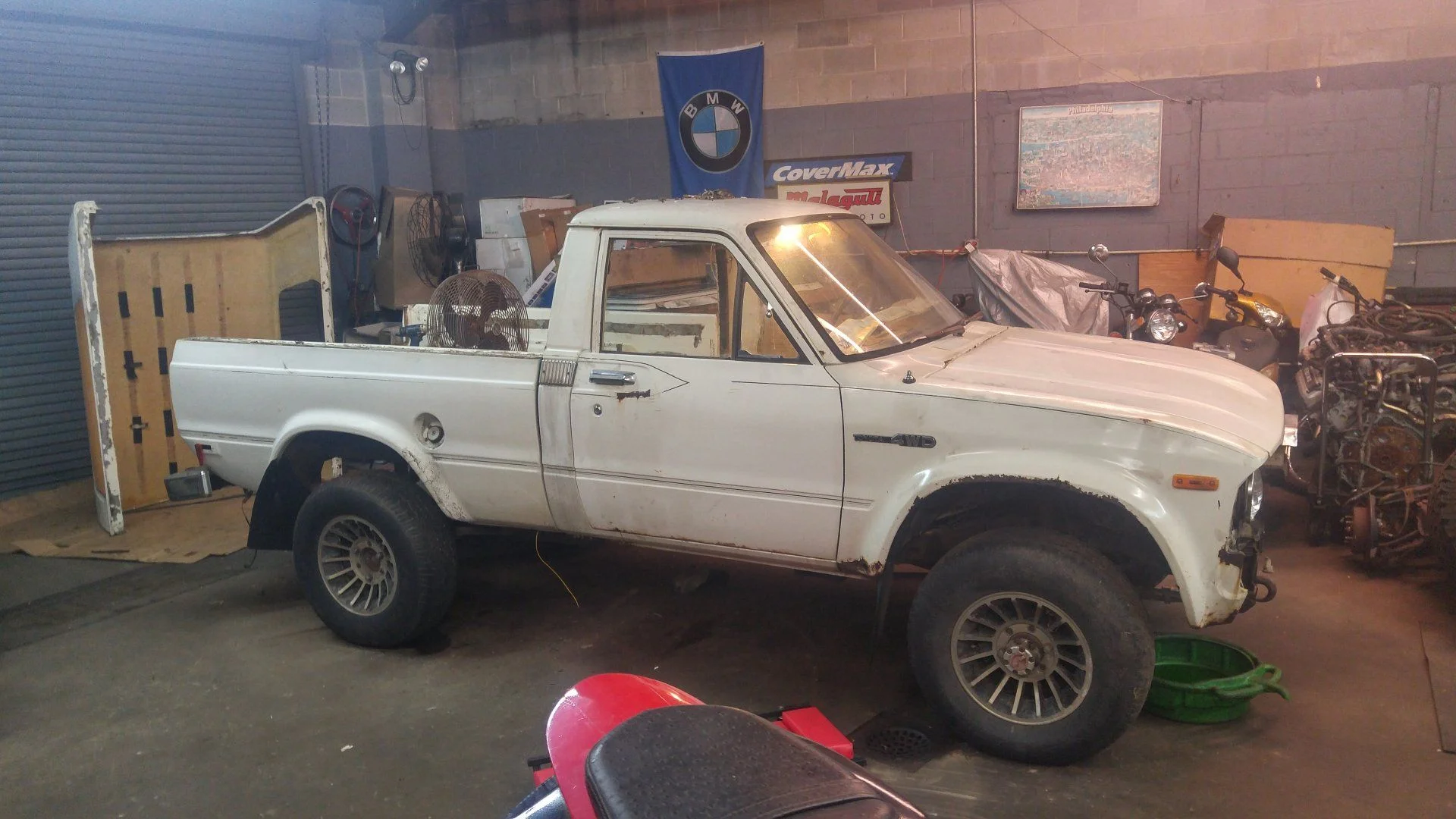

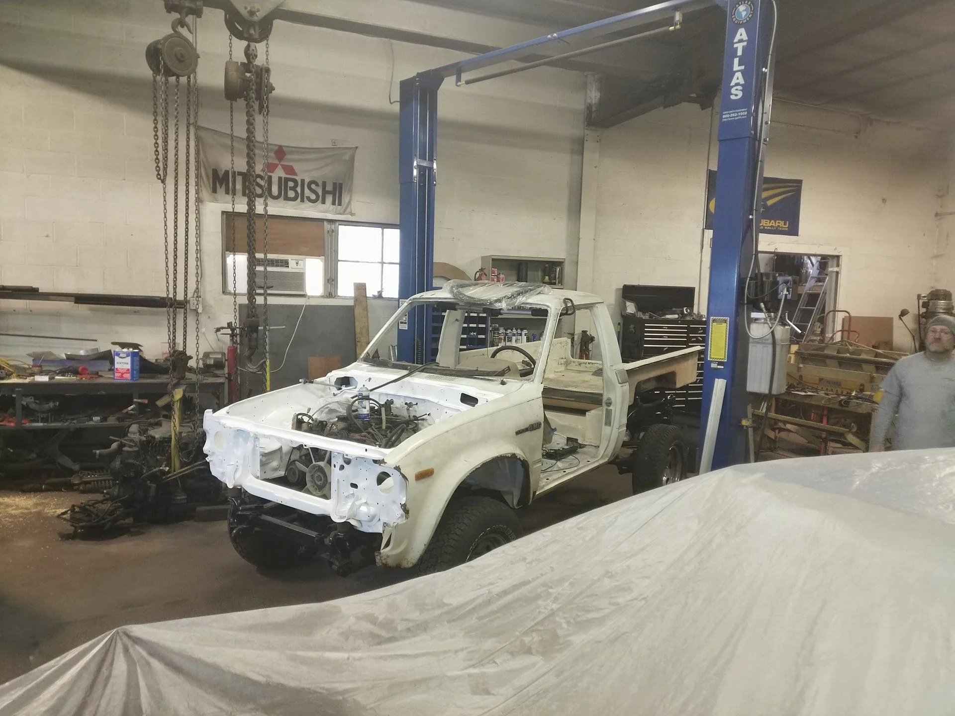

Here is how it sits today, with a new floor and cab corners and all.
I want to wheel it!
I am also hesitent to chop it up and put a cage on it as it has become "nice" as work has progressed.
Basically, if I'm gonna wheel it, it gets a cage, if it can't become a wheeler, I don't really want it....
What say the Mini Truck fans?

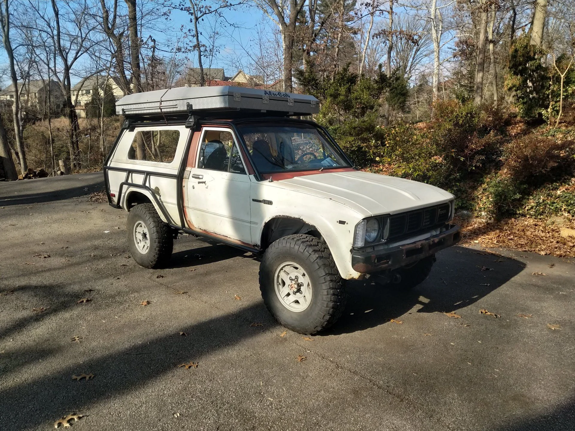

But it shall get a minimalist exo-cage, winch bumper and 33s for now. See how it goes.

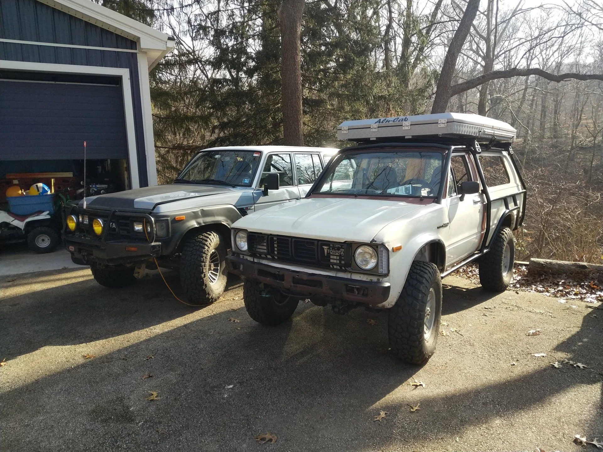

Lots of progress on this since I last updated here.
Please follow along:
