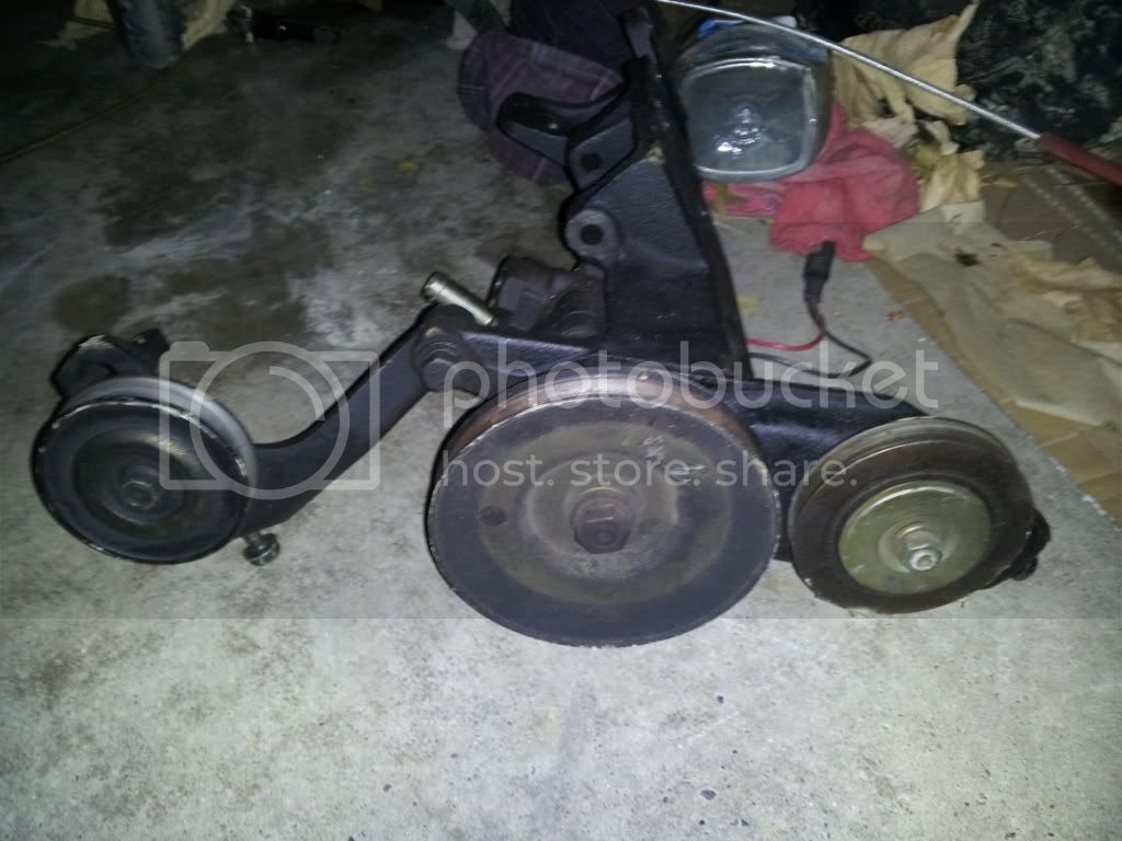

I'm still at home, due to some meetings, etc. we had to take care of concerning our new house. Anyway, I took my extra time to finish the addition of the right hand drive to left hand drive power steering setup. It's so nice to finally have the power steering back. Although, I ended up having to make my own lines and I had to weld another power steering pulley to my crank pulley to make the spacing come out right.
I'll finally be leaving for GSMTR early tomorrow morning with a quick stop in Indiana to drop my daughter off at Grandma's.
Here's a couple of pics...
