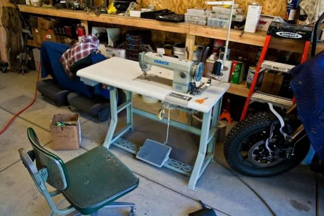

He welds, he bends metal, he sews.....its Superwrench!
Real men know how to sew! :grinpimp:
