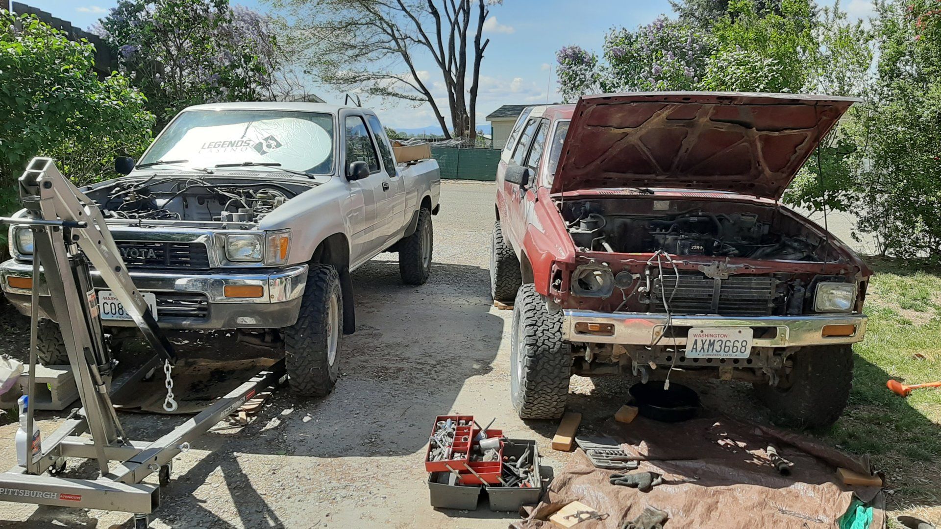

So I bought an engine hoist and engine stand (to store the 91' motor until i can work on it). Since we dont have smog here I decide to do an EGR delete and eliminate the air injection. I kept the exhaust manifold on the 87' motor, it didnt have the air tube coming off the exhaust like my 91, this saved me from having to plug off the hole were the tube was. I used some 1/4" thick steel plate and made the 2 egr block plates. Here's a couple pics of them installed.
