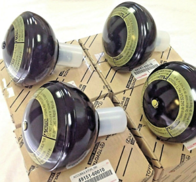

Care to share the listing you bought the globes from? Wondering why you went with that vs ordering from amayama or any of those other overseas places that have legit OEM.
Speed of shipping was the main reason. Amayama lists 1-3 months for delivery. I don't always trust eBay, but the listing and reviews seemed legit. The parts came quick (5 days) and were in the right OEM Toyota packaging, and looked to be OEM parts. This is my family cruiser and having it out of commission for more than a day is rough. My other vehicle is an 89 Ford F-150 single cab (bench seat), its hard to fit a wife 3 kids and a dog in there.
Completely understandable. The ebay link you sent says it ships from Japan though. You got it within 5 days of ordering? I wonder why Amayama is 1-3 months.. I've been thinking of taking the plunge on new globes myself. In my case it's a nice to have, not a need to have thing, so it's hard to justify $600 yet.
Do you have any pics of markings on the globes and of the packaging? I know there are pics in the ad, but I'd love to see pics of what you received so we can let the mind trust here suss it out!
Also this is a great tip about how you removed the globes! Thank you.

That Park Tool looks great, that could have been a lifesaver. I attached Pics of the box th accumulators came in.
Mine just arrived from JDM Planet (Japan) but without the original boxes. The labels had been removed and taped to the bubble wrap.
Should I be worried? They certainly look legit.
I had ordered globes for my 570 from the same source last year and they were shipped in the original boxes. I suppose they could have removed the boxes to simplify shipping, but the original boxes were so tight fitting that it wouldn't have made much difference.
img_4134-jpeg.3740094
@terrapin - how long did JDM Planet take to ship them? How much was shipping? Their price seems to beat even Amayama.
For this order (LX470), I placed the order Sept 16, it was processed (shipped?) Sept 25 and arrived Oct 1. So the actual shipping time was just under a week, but the overall time was two weeks. Fortunately I was not in a hurry.
My previous order last December for my 570 took just a week total. Shipping this time was just under $200 and the total cost was $709. I paid the premium because I wanted genuine Toyota parts. I hope that is what I received since they were not in the original box.
