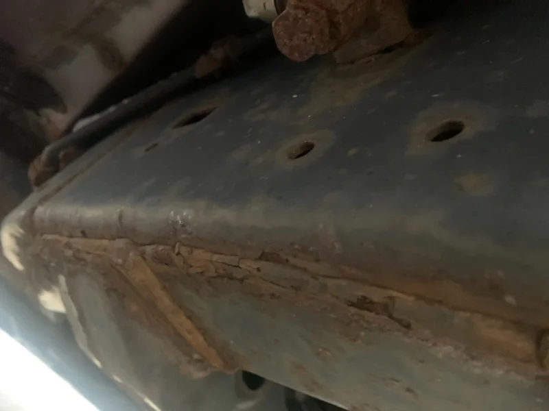

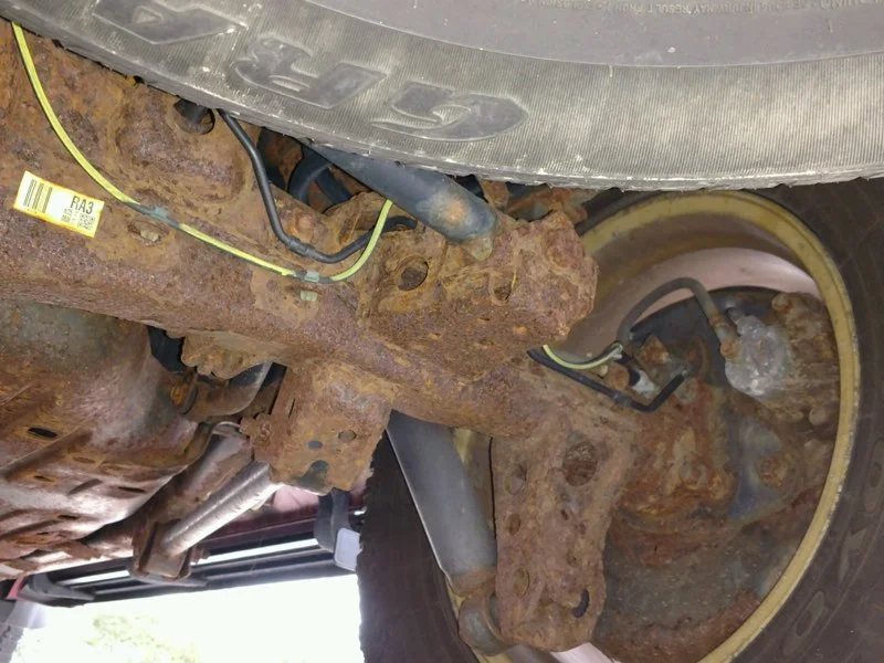

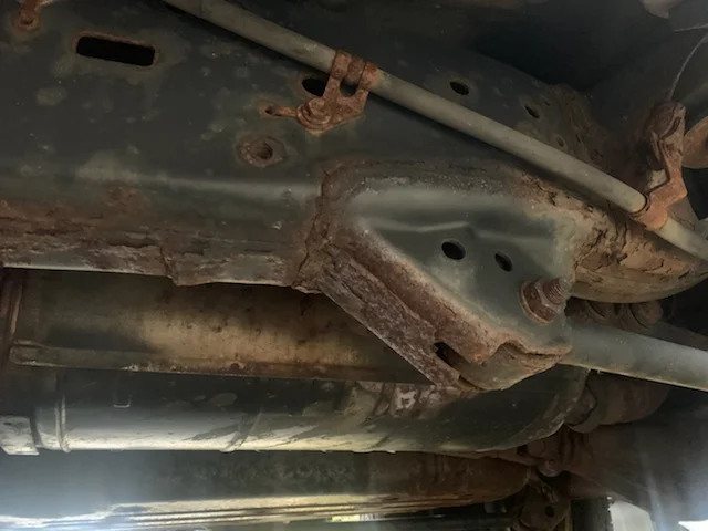

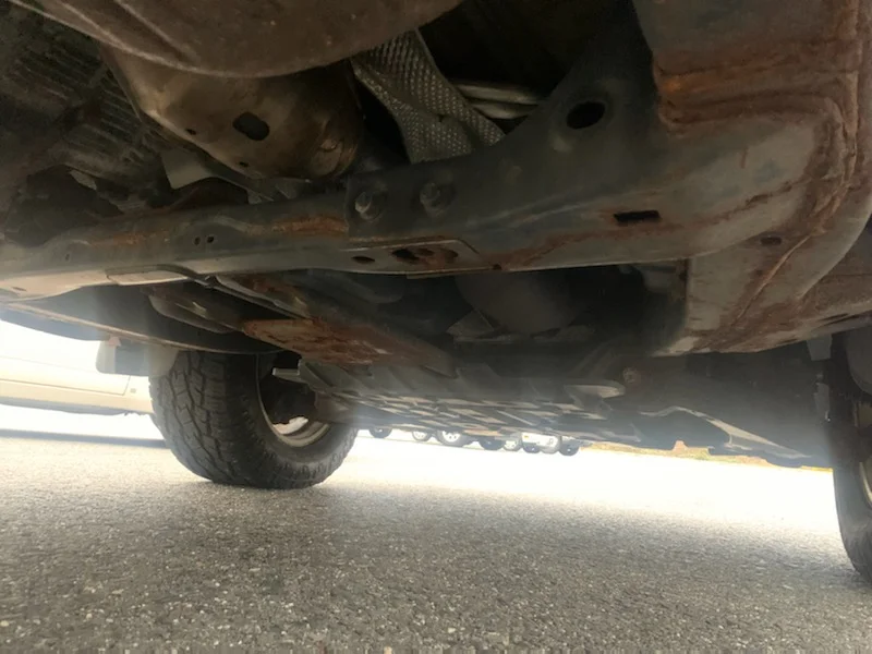

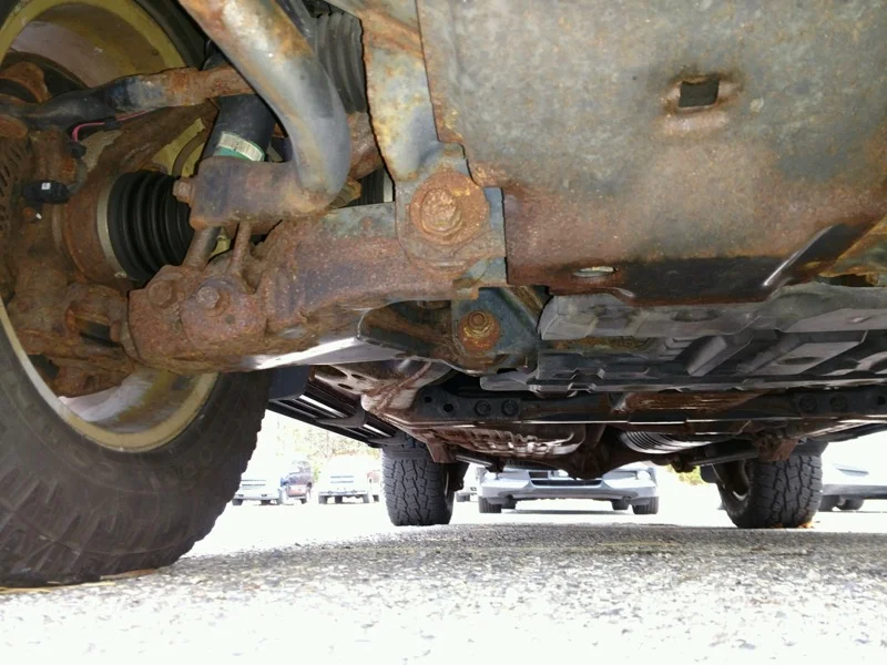

Hello guys, I am considering a 2008 200 series in the northeast with 120k on it. It seems to have some rust on the underbody and I was wondering if it's worth the trouble to buy it and clean up the rust? I live in the northeast and plan on it being my daily to save putting miles on my 80 series. It's selling for 30k. Thanks!
Oh no, that is nothing. Take a look at Dodge, Chevy, and Ford pickup trucks. Ive seen holes and snapped frames within 7-10 years.
Pretty significant for miles and year. I'd wait for something else. Your patience will pay off in the long run.

Even if a mechanic is dealing with all the work on it, you're going to spend thousands of dollars more dealing with rusted parts. Case in point - if your LCA cam bolts are rusted (which I am virtually certain they are based on those photos) it's not just the $600 for a pair of LCAs but also several hours of labor for the shop to sawzall the old ones off. So my $100 alignment will cost you $1000+ ($100 for the alignment, $600 for LCAs, at least $300 for labor to replace them... possibly double that)
In short, it's likely cheaper in the long run to pay more for a rust-free vehicle from the south than to buy a rusted northern truck
