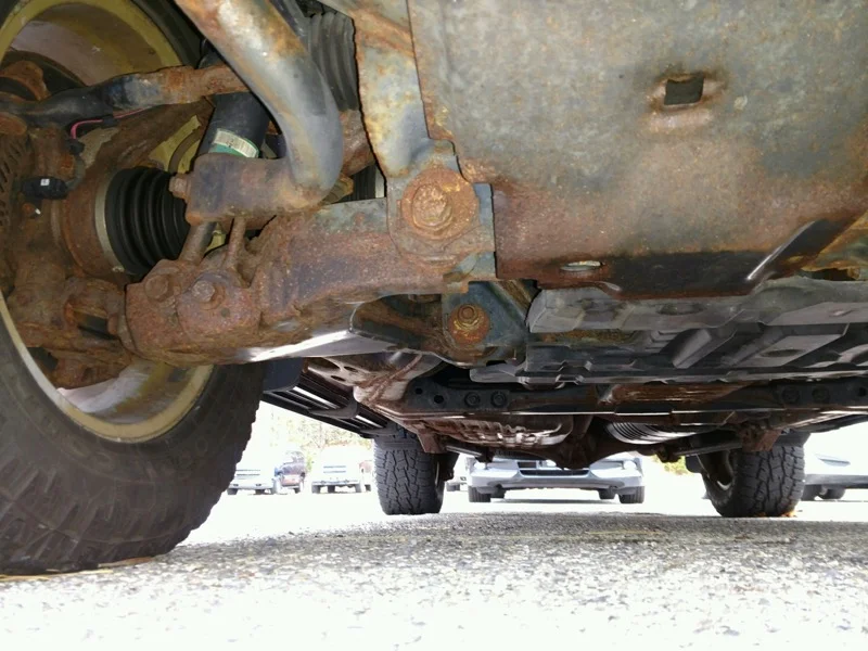

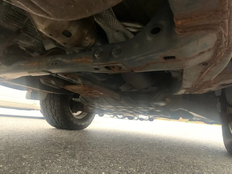

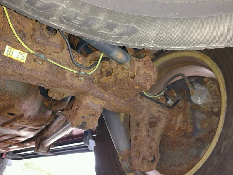

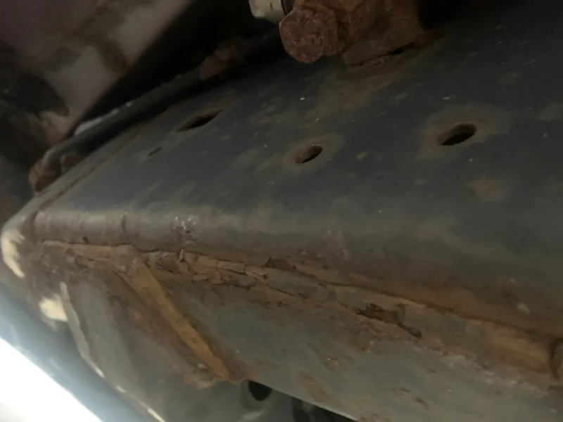

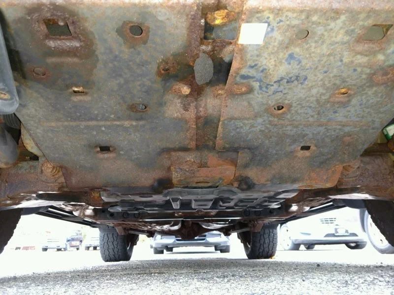

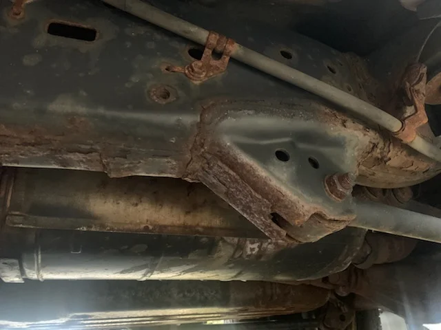

Hello guys, I am considering a 2008 200 series in the northeast with 120k on it. It seems to have some rust on the underbody and I was wondering if it's worth the trouble to buy it and clean up the rust? I live in the northeast and plan on it being my daily to save putting miles on my 80 series. It's selling for 30k. Thanks!

If your not in a hurry wait for a better one. The rust has taken over the front end pretty good.

Yes I agree it has. It seemed like upper and lower control arms are pretty cheap and I have been looking in my area for a while and prices are ridiculously especially for 2011+.
I would say that’s a bit rusty for miles and year. Closer to the ocean? I’m in Maine and My 08 has 260k on it and not nearly as bad. I’ve taken care of it though. $30k would be hard to swallow for me but market is crazy.
I live in the Northeast and am used to rust - I would pass on that one, unless you never plan to work on it or have it worked on. It looks too far gone to be an economical choice in the long run.
I've looked at 50 year old 40 series in better shape!

Yes its right by the ocean. My 97 has 200k and almost no rust. I'm looking for a cheaper 200 series so I can not daily my 80 and restore/ modify it. But yes the market is ridiculous

Thanks for that feedback. I think I'll pass on this land cruiser and keep searching.
I might pass on that. You can see brake lines that where replaced. It's not that your foot will go thru the floor but any kind of maintenance or mods are going to be a Kroil pain in the butt. 30K is also steep for that amount of rust regardless of how clean the interior is. It looks like every dang bolt is rusted solid. I'm in the NE as well and that looks bad for a 2008. I just see broken bolt, broken bolt, replace all of that, torch, bloody knuckles, bolt extractor, tap set and many hard hours cursing. Keep up the search.

I would hard pass on that. That’s an incredible amount of corrosion.

I have seen rust like this many times and the thing keeps going strong. It's just the bill can be 2x-3x the labor if something needs repair. 4 hours vs. 12 hours. That's the real problem with LC's and rust. The frame is fine, the components are fine, the KDDS bolts are gone (if your not doing a lift who cares). It's just any work is exacerbated with the rust.
I bet someone will buy it for 25K if it does not sell soon. Not touch a damn thing on it besides the oil, plugs, fresh calipers and the thing will run just fine for the next 150K.

I agree. My 100, which has spent most of it’s life in coastal Alaska and coastal Baja, looks a lot worse underneath than these pictures and it gives me zero issues. It is pretty much stock and needs little work so rusty nuts and bolt are irrelevant. It just keeps on trucking and most likely will for years to come.
Since you're in VA, I would also pass. I feel like the cars around here usually don't rust too bad unless you just don't take care of them at all. In reality, it would be fine for several years, but I would pass and see what comes up.
I would 100% pass on this one. My 08 LX was close to this amount of rust after 11 years. None of the shops in my area wanted to touch it to fix the rust, so when a clean 2018 LX showed up I traded it in.

No, I don't have pictures of the engine bay but it's for sale for 30k and they are really set at that price. I had a conversation with the salesmen when I was asking for a lower price and I said that the only person paying 30k for a 13-year-old car with 120k would be an LC enthusiast and he agreed. I then told him an LC enthusiast isn't going to pay 30 for a 200 series with this much rust and they then told me it's not that bad and "it's not like the frame is rotted through". The car has a decent service history but clearly, they never did any rust protection.
