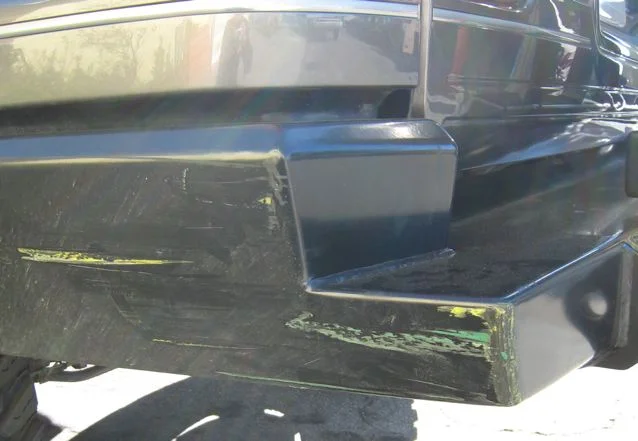

I just went outside to check and didn't see any rust except a 2" bead of weld by the spindle. However, I did notice my 100 was hit recently by something painted green and yellow. Hmm, a John Deer tractor? Albeit minor, chalk up another save for the Slee bumper.
