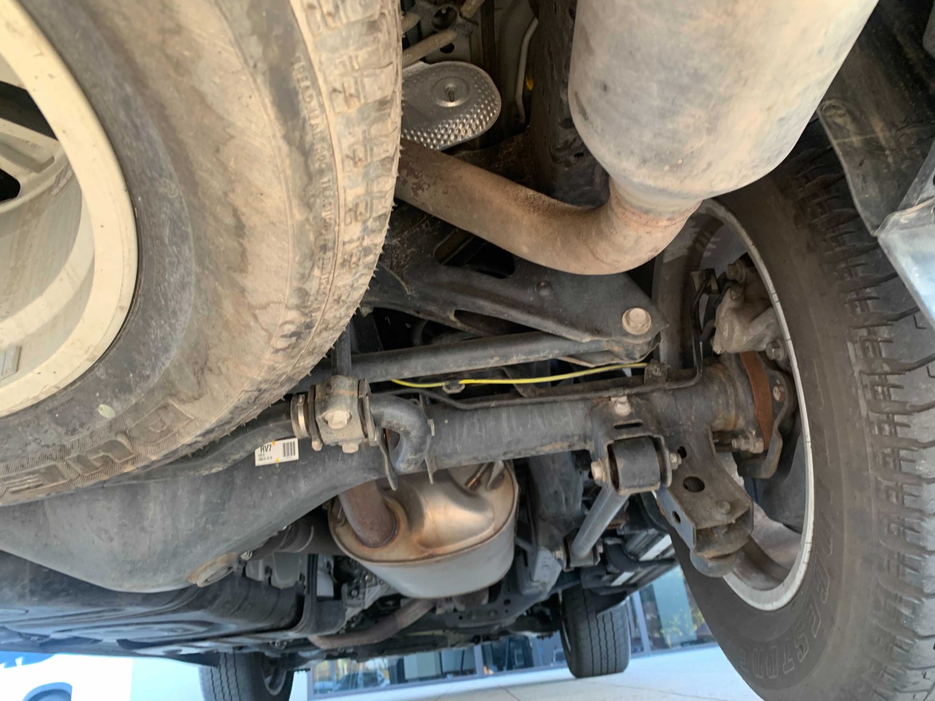

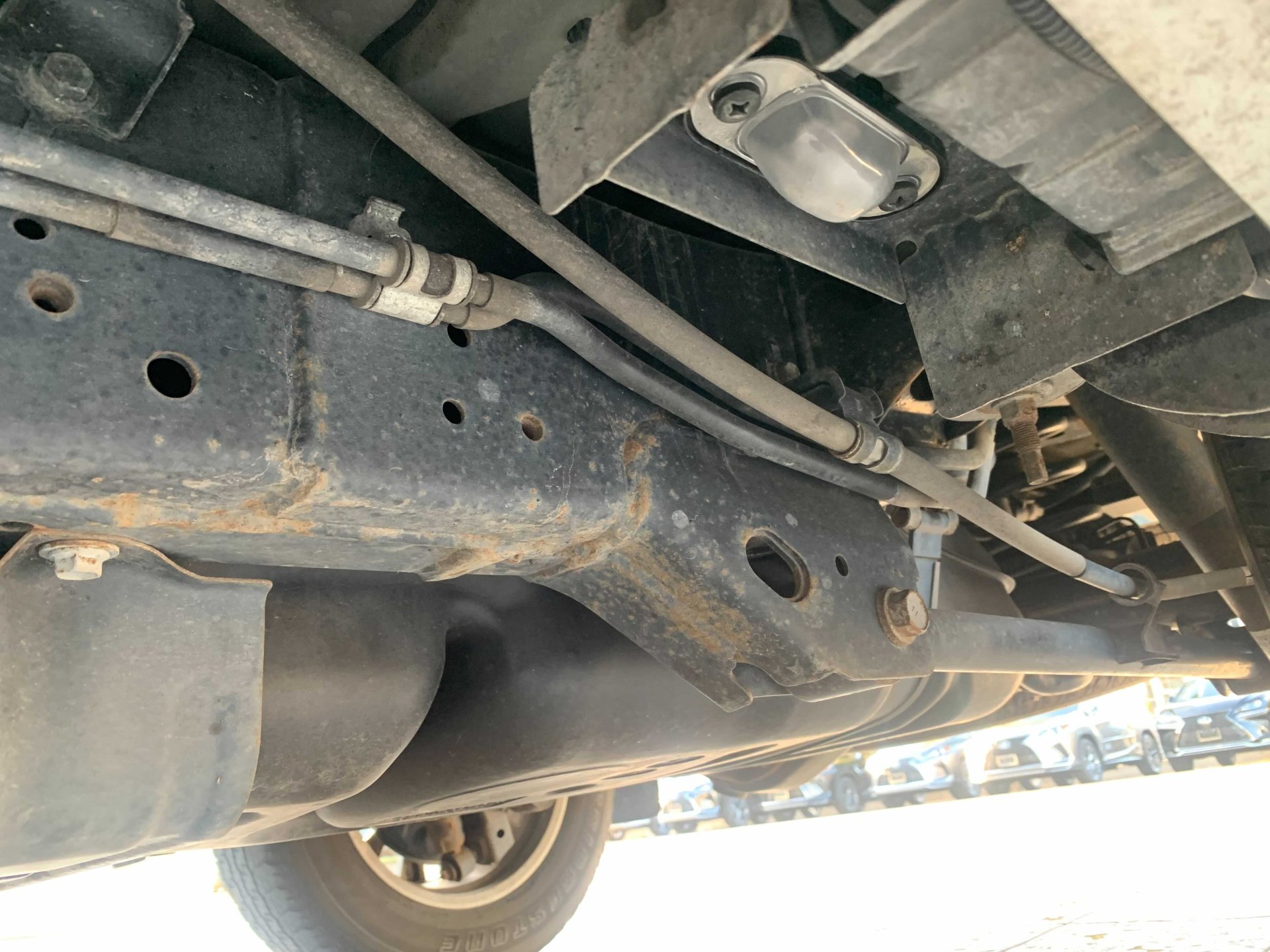

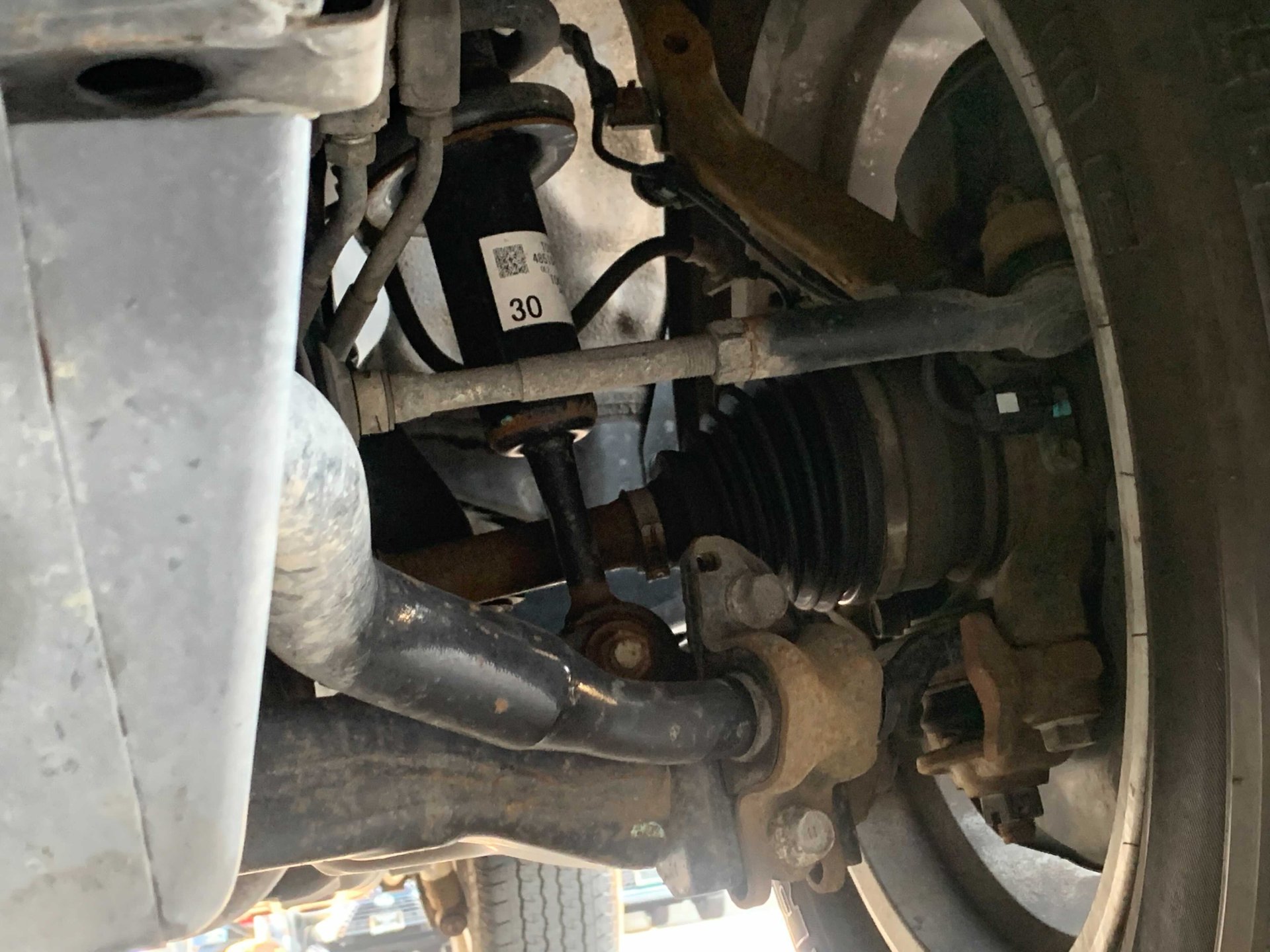

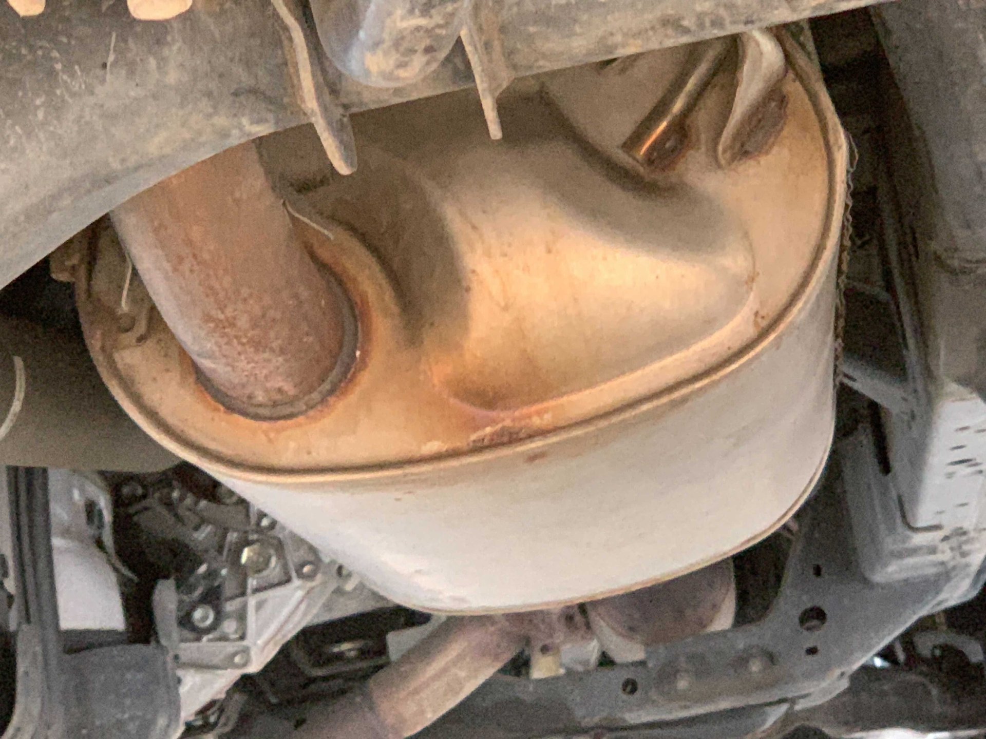

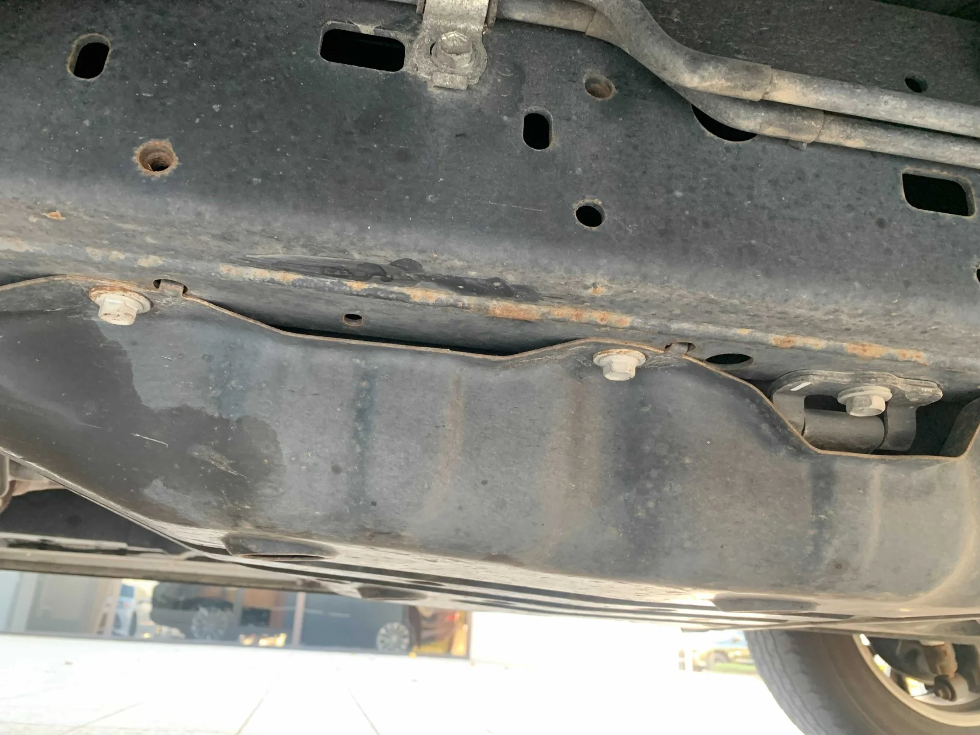

Hi All,
I am looking to purchase a 2018 GX 460. I have noticed some rust undercarriage . I would like to know your feedback if this is ignorable rust or should i pass on this car. Thanks in advance.
I have posted the same concern in the paint and body forum as well : Rust on 2018 GX - https://forum.ih8mud.com/threads/rust-on-2018-gx.1267276/
Thanks in advance.
That’s very minor surface rust. Where are you located? Look along the rear where the tire meets the back bumper as well as under the front near the radiator supports. These two locations are typically where you’ll find the worst of it. Personally I’d be fine with what is shown in the photos. They make some great products to deal with this as well as prevent future corrosion.
That’s extremely minor. Wouldn’t stop me at all.

Looks very, very minor and what would be expected with anything close to the coast.
As long as there aren't any rusted bolts, which I didn't see any in your pic's, you're golden!
If you do pull the trigger on it and the rust is still bothering you, just get a brass wire brush or brass wire wheel on the end of your drill and take off all the rust, then spray with WD40 or equal.
That rust is not bad at all and could easily be stopped with an annual application of Fluid Film or Woolwax undercoating.
Thanks everyone for the inputs. I agree the rust is not a big deal but i had to let this GX pass along. Some of the bolts are rusted as well which i didn't capture in the pictures thinking its not a big deal. but after reading other inputs and i myself experienced rusted bolts on a subaru, its pain if the bolts get broken.
