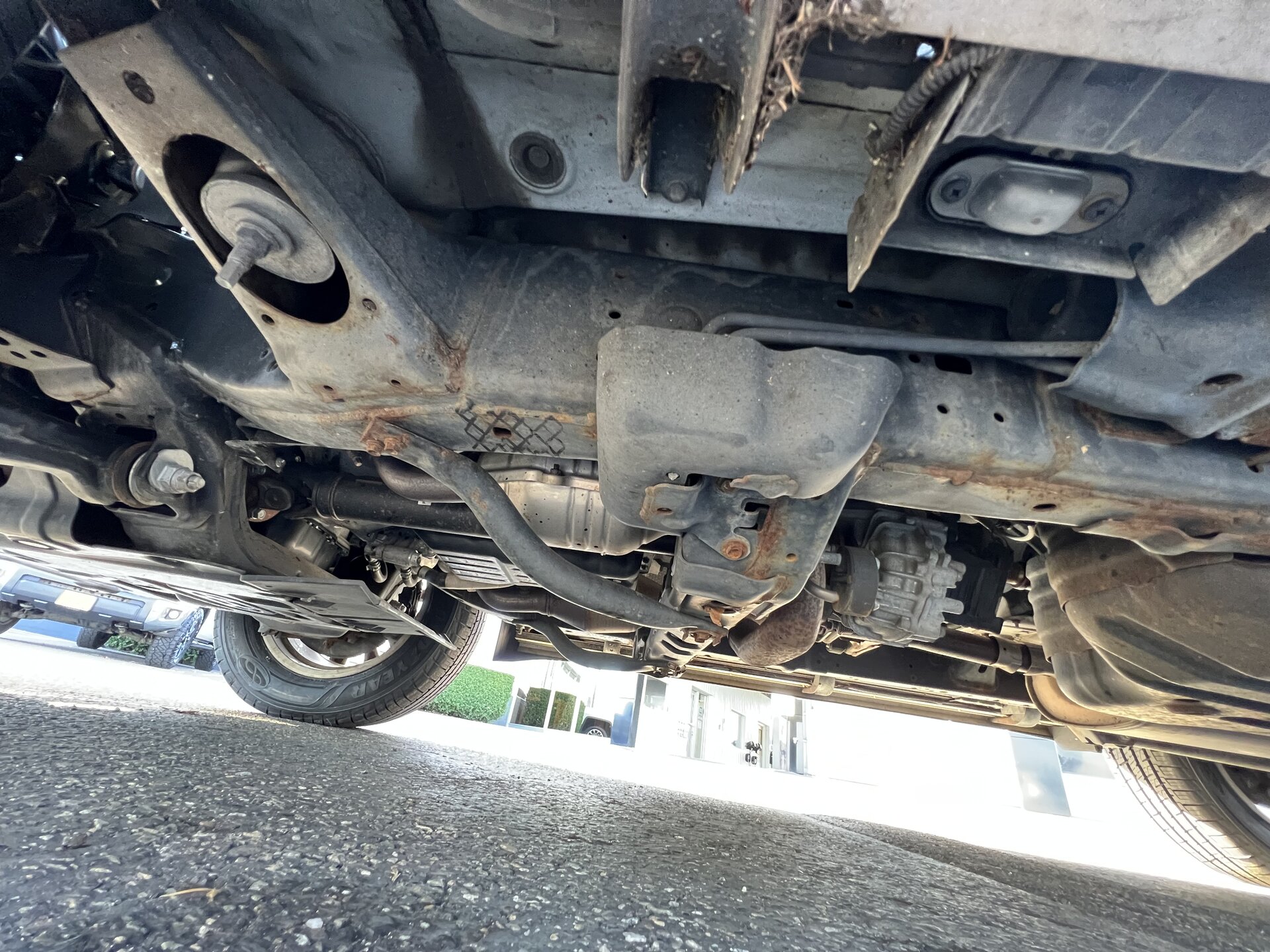

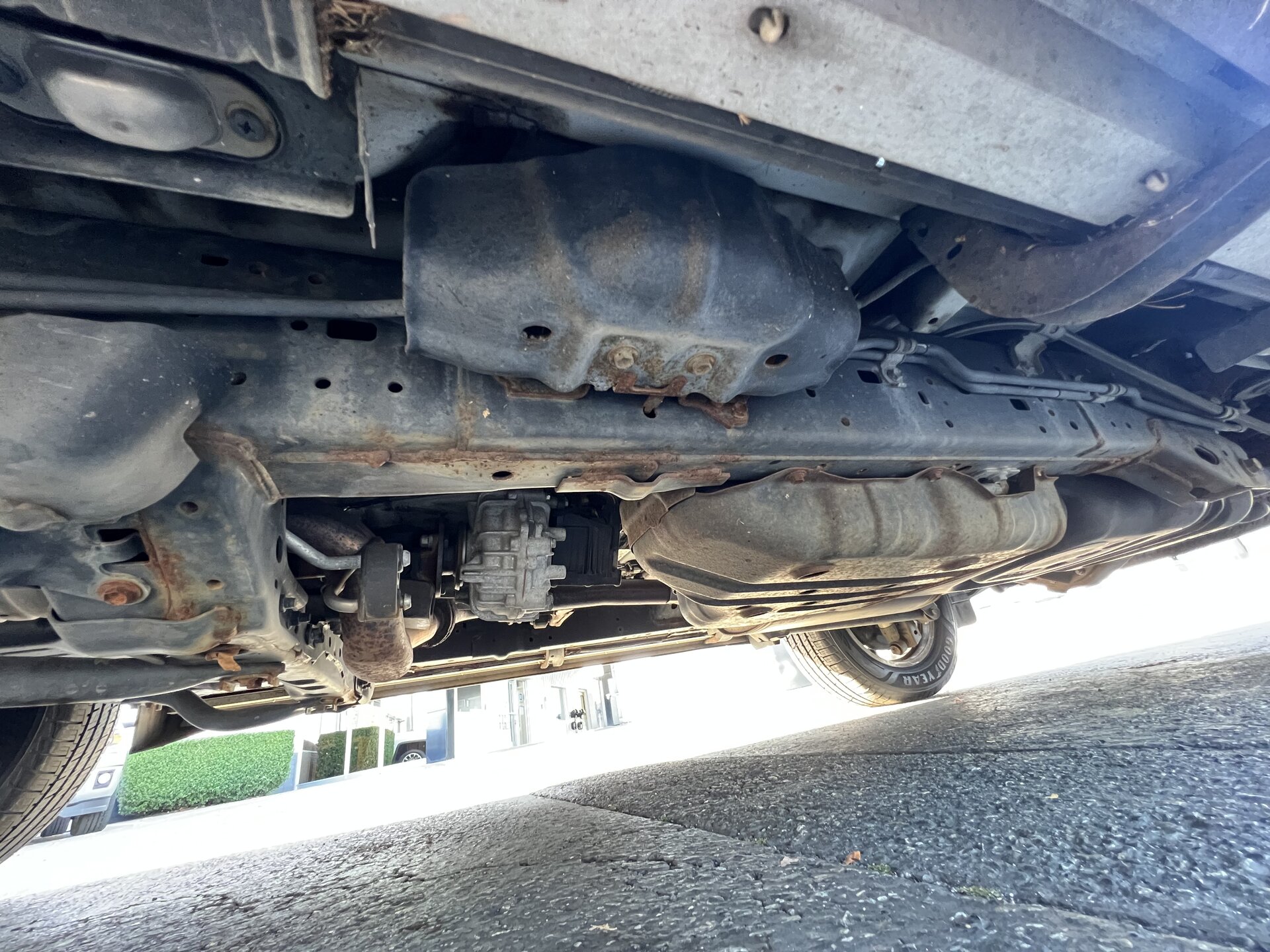

Looking at a 2015 GX460. What are y’all’s opinions on this rust?
Priced at $29k with 64k miles. Not sure if I should look for a rust free one for more $$$ or buy this one for less. I plan to use as a side vehicle for family forest trail runs.

Having restored mine as best as I could with similar rust...if you can walk and find less rust do it. Mine was at 103k miles with equal or less rust. It's not impossible to fix frame wise. What is impossible to fix is rust on the KDSS system lines which they do. If you pull that KDSS skid off and pull the driver splash guard off you can see how good/bad it is. Also the front bottom radiator support is a huge rust magnet. It's not always worth the hassle plus for $29k with a declining economy and high interest rates if I'm paying that much it's going to be rust free. My 2 cents is walk and find rust free if able. It took me roughly 2 weekends of corroseal/rustoleum painting to get the frame somewhat rust free. Even then you still need bi-yearly fluid film treatments in the rust belt.

The rust on that GX isn't too bad, but for $29K, it should be rust free :)

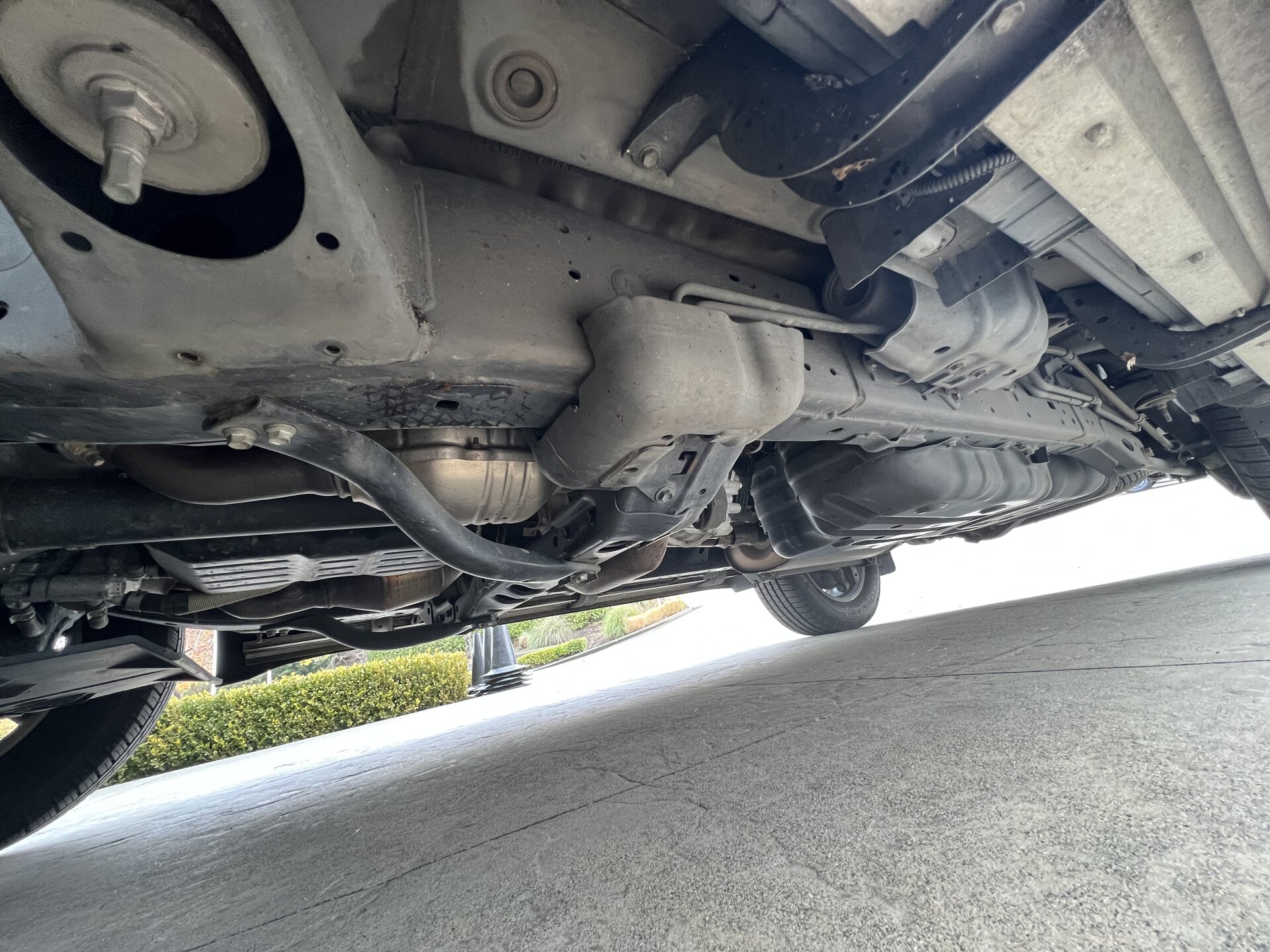

Saw two others:
2016 with 115k miles for $26k
2018 with 45k miles for $40k
Both looked great underneath.

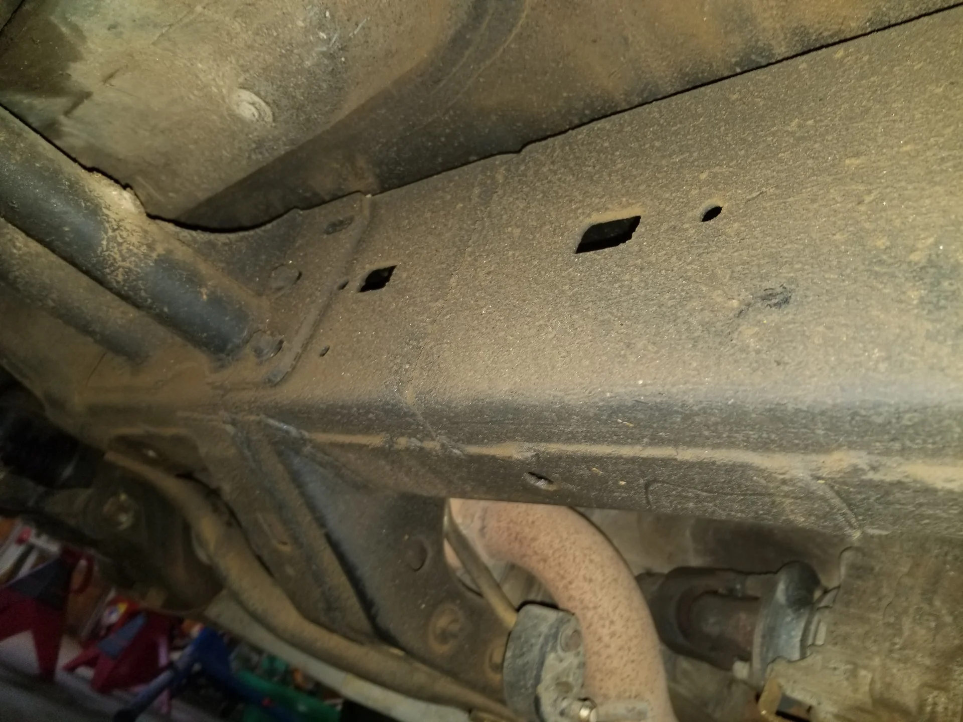

Personally I searched High and low for a rust free GX470 in Kansas. In the end it was more of a compromise instead of rust free. I have what you have pictured and have spent the last week doing a lift on it. As I'm adding new components I'm wire wheeling brake clean blowing then treating with POR 15 in essential areas. I also used High temp primer after rust removal. It's just to get me through till the spring and summer months where I'll spend weeks disassembling components and parts to do the entire undercarriage in POR 15. Any GX you will buy will have to eventually have this done. Consider it preventative Maintenance. I got an outstanding deal on my GX because of the known issues. Next up is the secondary air injection. I've got all the parts just waiting on gaskets. It's a compromise of how much are you as a enthusiast willing to get hands on with these sought after vehicles. They all will require a more advanced level of hands on to keep them good to go. It's the trade off IMO. These can nickle and dime a guy to death if not willing to do most yourself. Much like Big Horsepower builds they need constant attention and in most cases is a game of finding the next weakest link.
