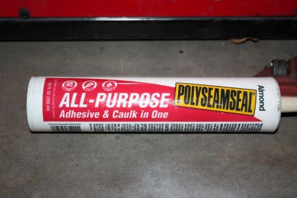

Heres a photo of the stuff I used. Its not silicone. its an adhesive and sealant combo. Its strong stuff and acts like glue and sealer. After it dries it is still a bit plyable...much like the 20 plus year old stuff your pulling out of your gutters. Take the time to get all that old junk out too. I will pay off when you put the new stuff in.
I picked it up at home depot.
GL! :smokin:
